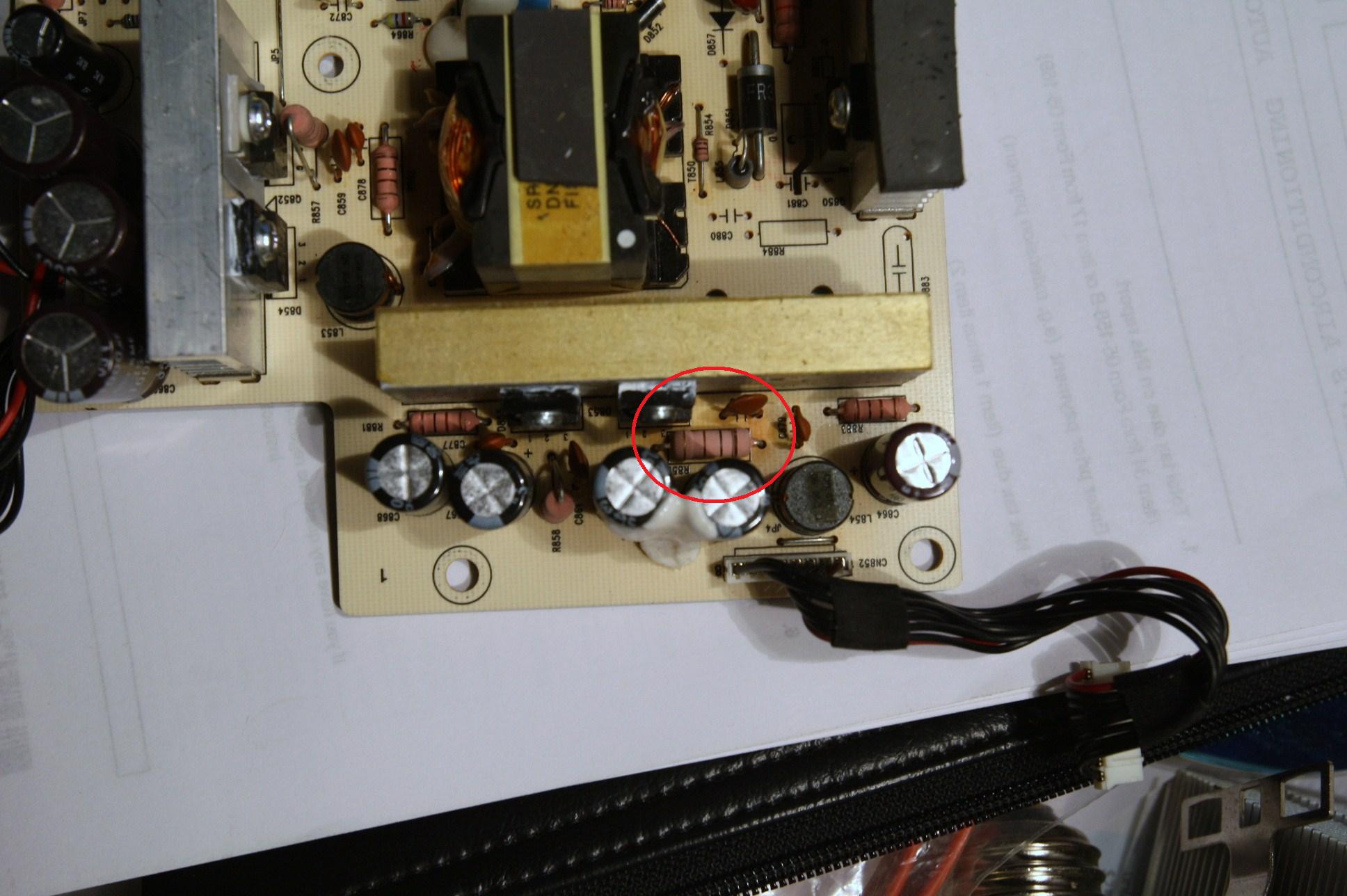

    Hi Guys,

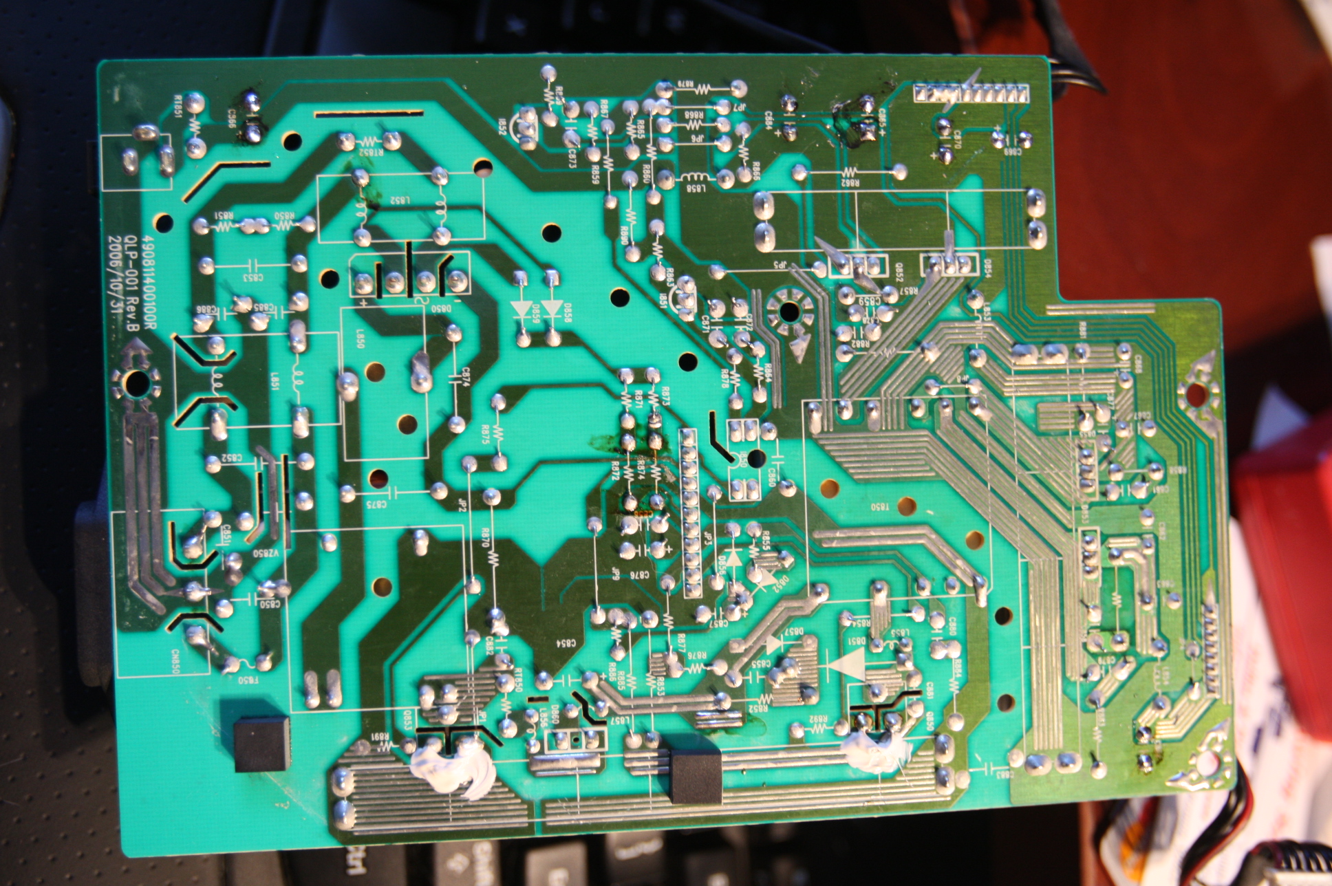

    I went dumpster diving yesterday and came home with two large LCD monitors, one of which was the LP2407. I pulled the power board and found a bunch of caps bulging so I went ahead and replaced them. After plugging it in, I still got nothing. I looked in some other threads and based on the info there, have come to determine that there's no voltage coming out of the board at JP4. Everything pin shows no voltage. I checked the fuse and it seems fine. I was wondering where I should start looking.
    It looks like someone has already replace R874 and R872. I have replaced C884, C865, C870, C869, C866, C864.
    Are there some test points in between that would help me narrow down the culprit?
    Thanks in advance!

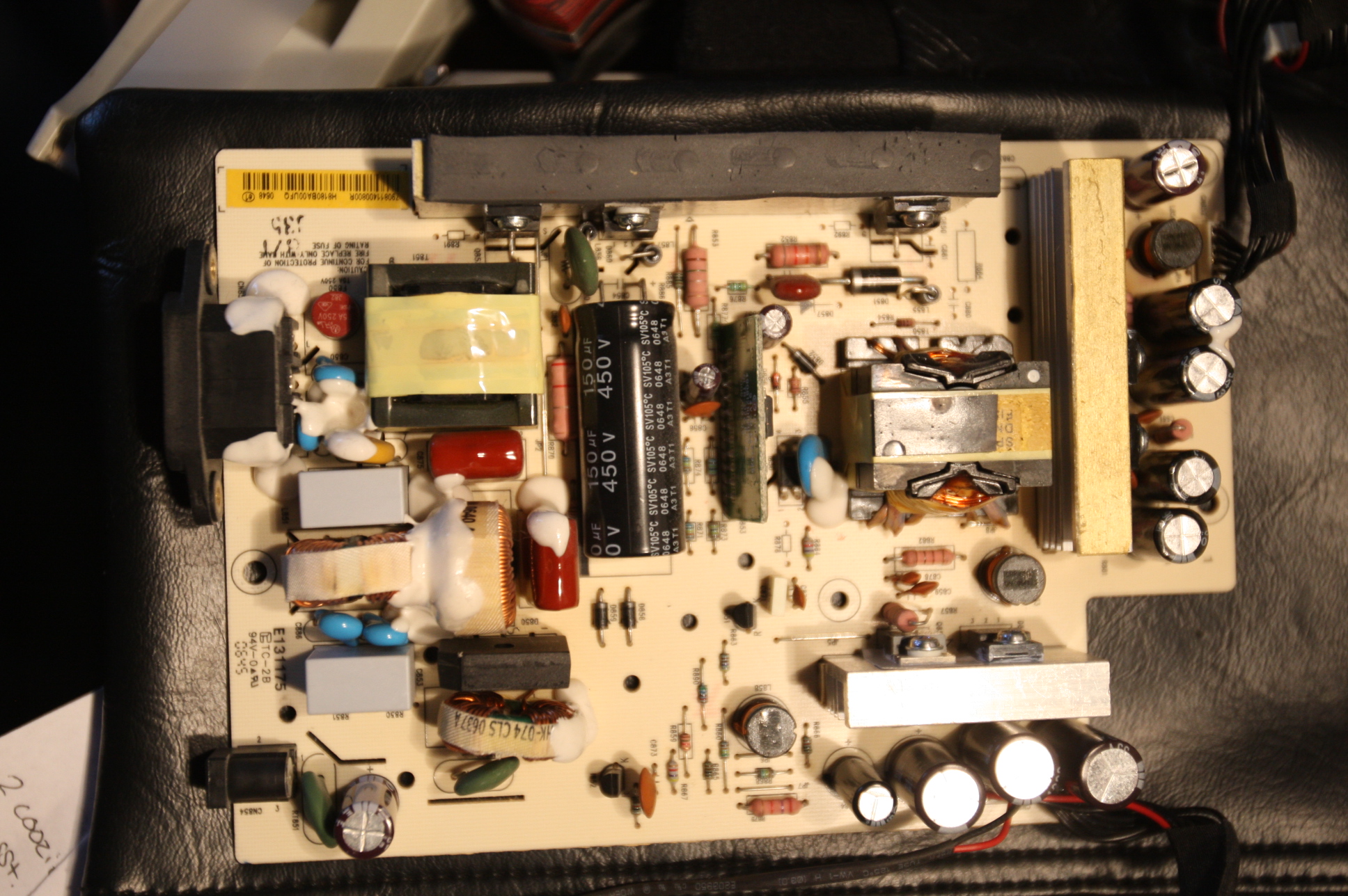

      Now that I look at it, T851, the transformer in the top left of the board (component side pic) looks to have an open secondary winding. Is this typical?

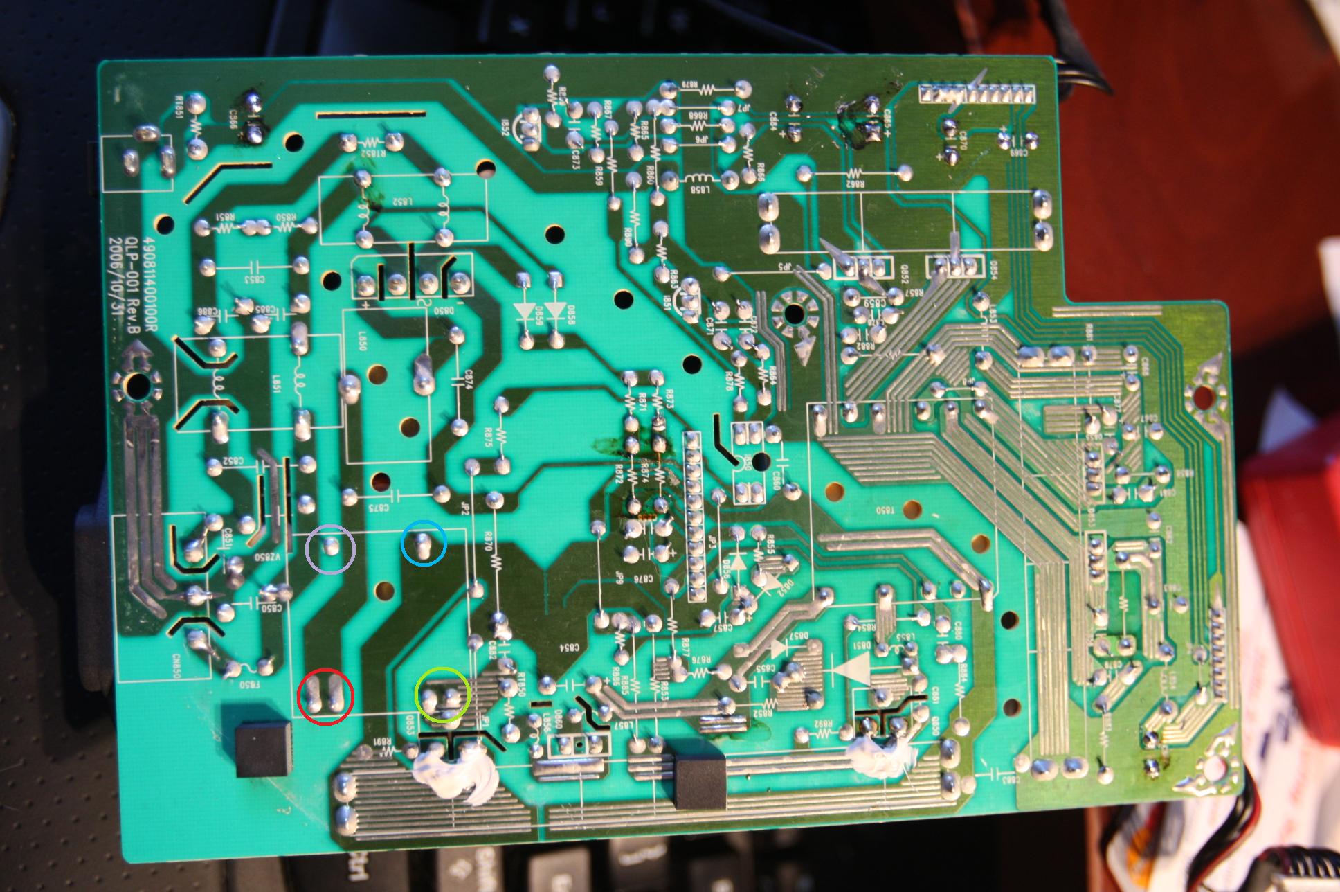

        Okay, so this is what I've got.
        Red to Green: .5 ohms
        Green to Blue: 2.3M
        Blue to Purple: Open
        Purple to Red: Open
        That should confirm that the transformer is dead, right? If so, does anyone know where I can get a replacement?

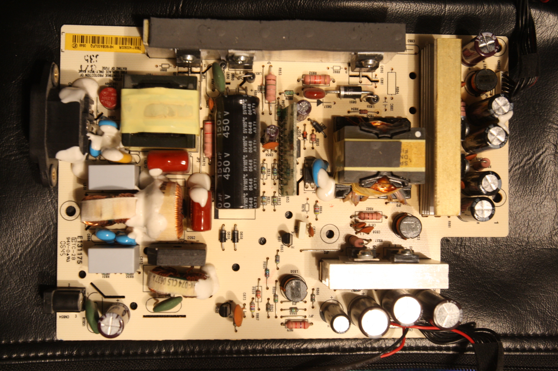

          Re: Gateway LP2407 Power Board dead
          T851 is the PFC Voltage booster inductor, it only has one winding, if the PFC Voltage booster is working you will get about 400VDC on the two legs of the main filter cap.
          We need to find out which pins are what for that white connector that goes to the logic board.
          What dcV do you get at each pin of that white connector? All show 0V?
          At this point you have to have at least the standby power supply working, without that nothing else will matter at this point.
          "It looks like someone has already replace R874 and R872" The pictures are too out of focus to see.
          That PCB with 11 pins sitting vertically is the heart of the power supply, it probably contain circuit for the PFC and the circuit for the standby/main supply.

              I based that on the flux residue on the backside of the board. Maybe this pic will be more in focus. I had the aperture set too low.
                If 5V standby is missing, check that little stand up board just above the large filter capacitor. edit: Oops, I see budm edited his post to say the same thing.
                Look at the pwc IC on that board, find its datasheet and see which pin is VCC. The voltage on VCC probably has to be in the 16V range for it to start.

                    Check R853 (Source resistor for power MOSFET Q850 which drive the power transformer T850) to see if it shows < 1 Ohm.
                    • bryanchan
                      • Jan 2015
                      • 13
                      In circuit, it measures .3 Ohms.

                              I just noticed a discolored spot, the resistor has a brown/black/brown stripe which should be a 100 ohm resistor and it measures as such. Would this be indicative of any known problems? Should i just replace all the rest of the caps or is this something bigger than just a capacitor problem?

                                Are you aware that the caps have polarity? or perhaps someone pre working it did not?
                                In your picture in post 7 the cap in the bottom left corner is/appears to be the wrong way round. If so perhaps check all the others.
                                • bryanchan
                                  • Jan 2015
                                  • 13
                                  Selldoor, you are right, that cap is in backwards. I was aware they have polarity, but I mistakenly put it in backwards. Thanks for that catch.
