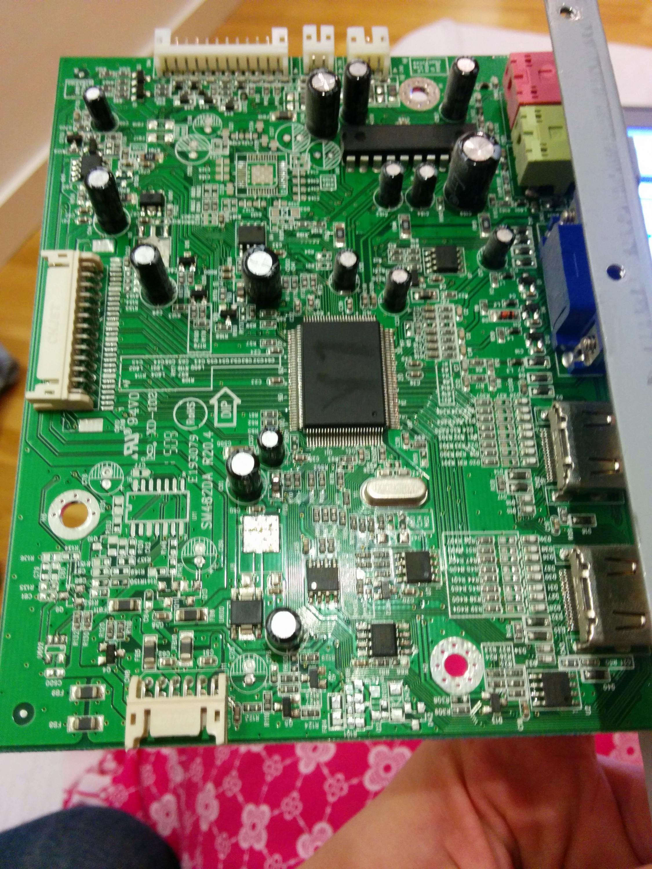

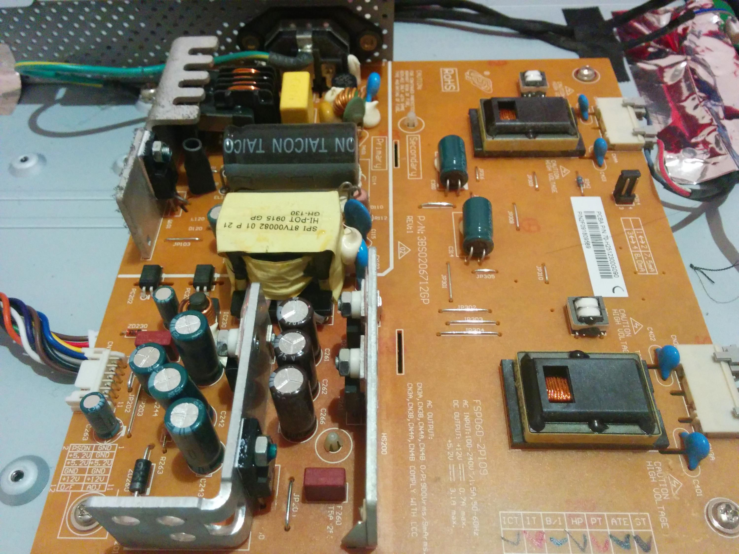

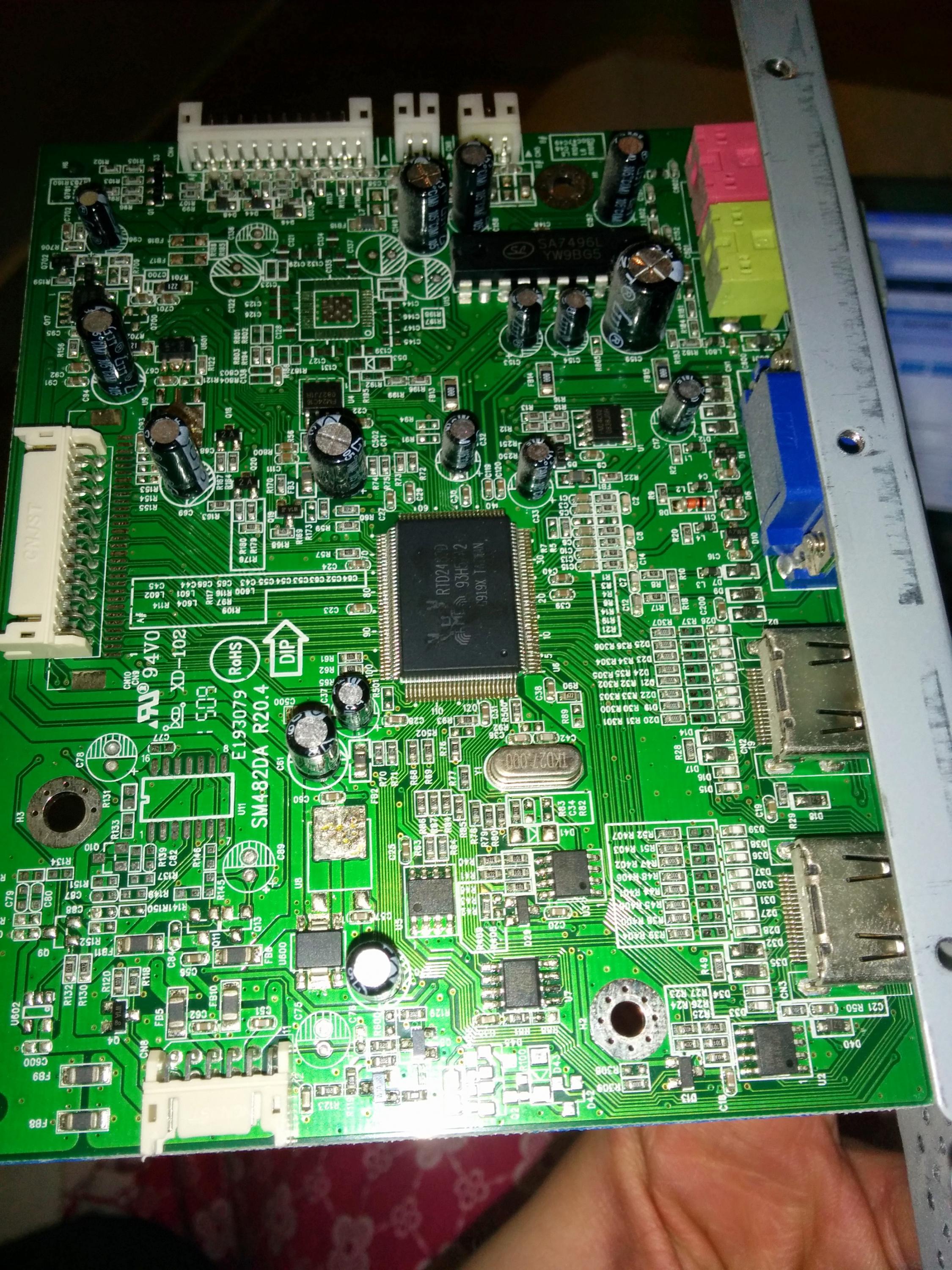

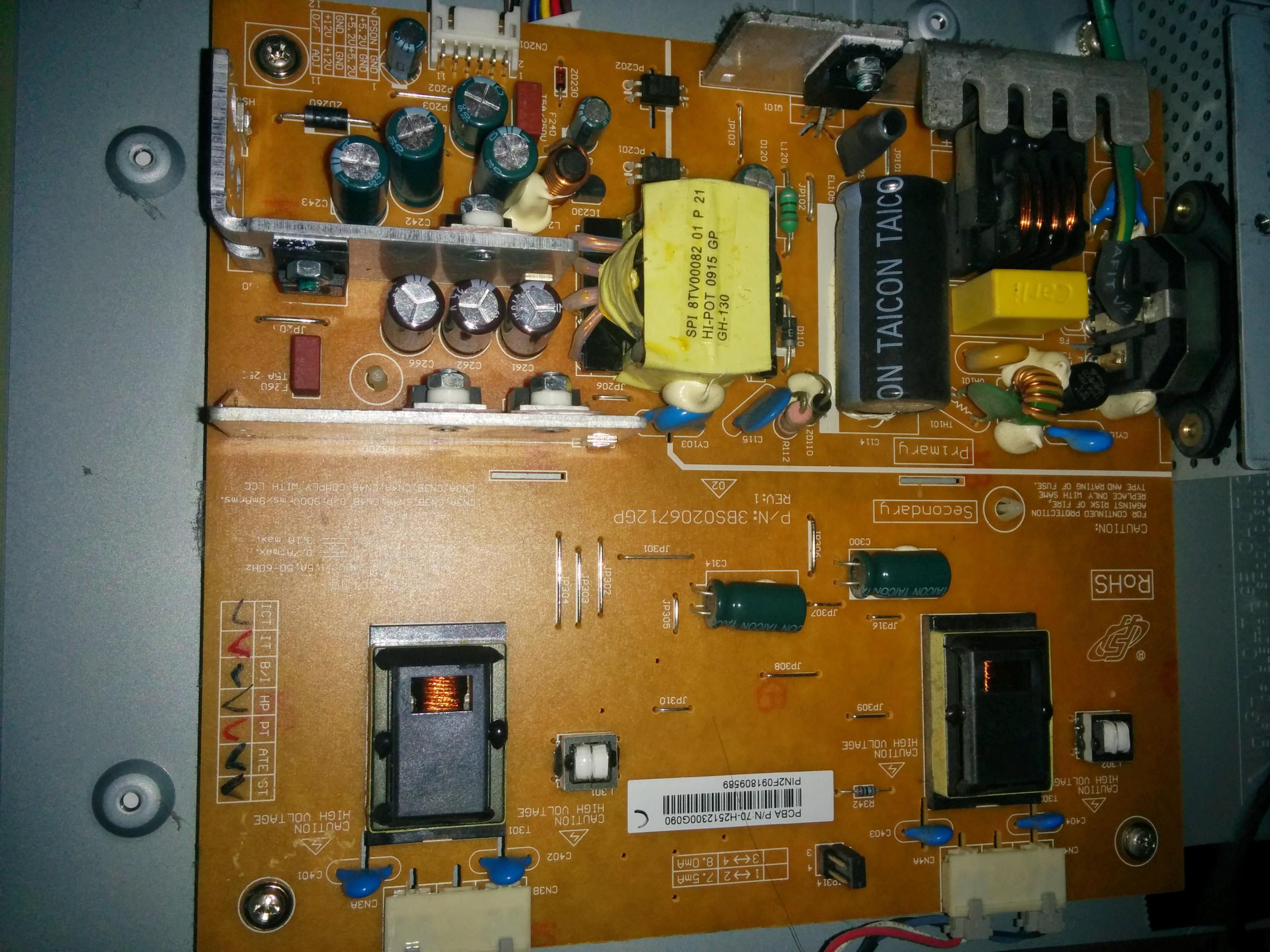

    Hi all!
    I'm having the 2 seconds to black issue, I think, with my Hannspree HF257.
    I know, I should refer to: https://www.badcaps.net/forum/showthread.php?t=10419
    BUT! I just want to check that that's my specific problem, because there's no image on the screen even if I shine a light on it. Furthermore, the screen has started crackling before shutting off. Any thoughts, or should I just go ahead and follow the above thread?
    Many thanks,
    Tom

              P.s. Photos hopefully attached.
