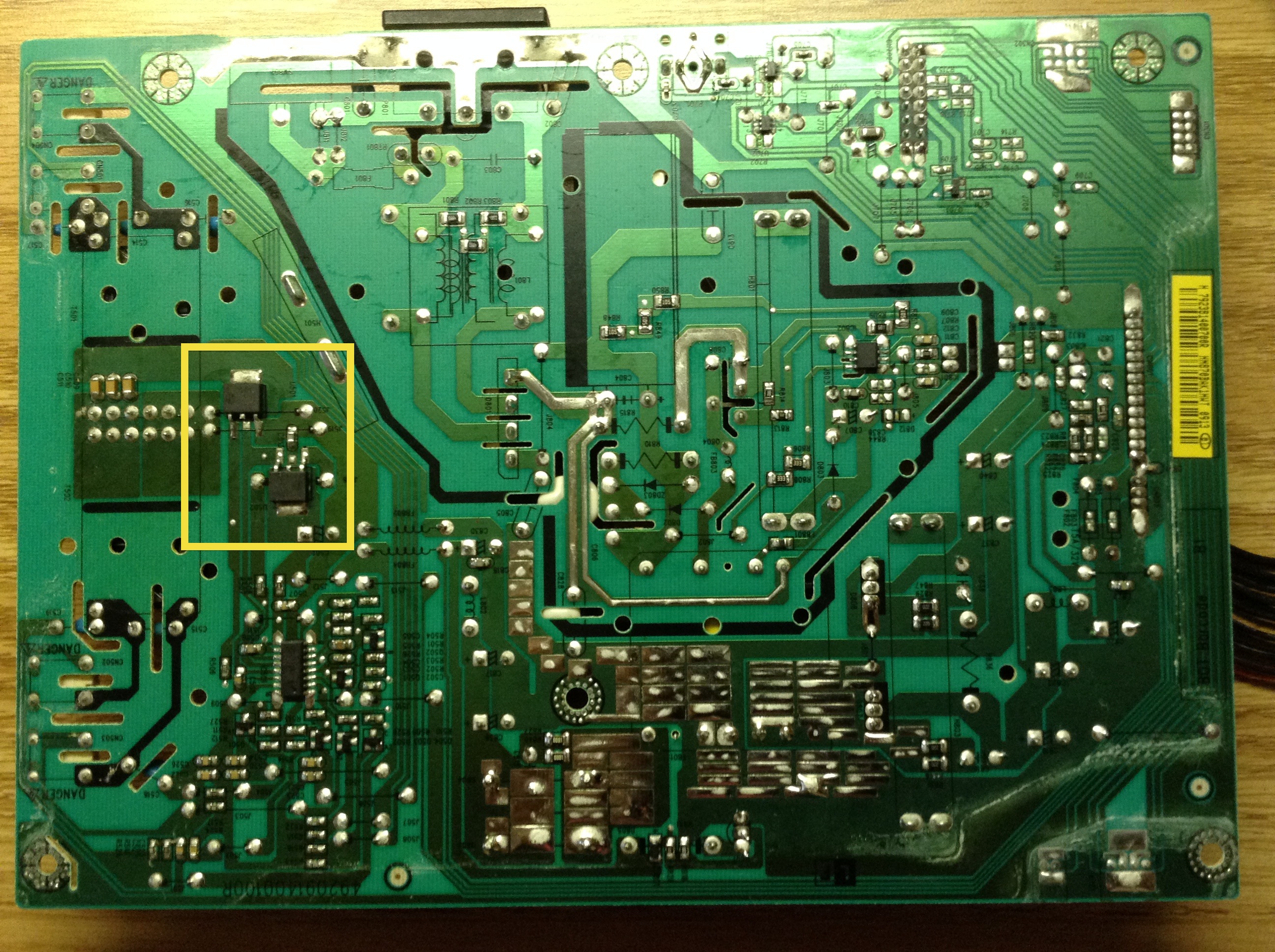

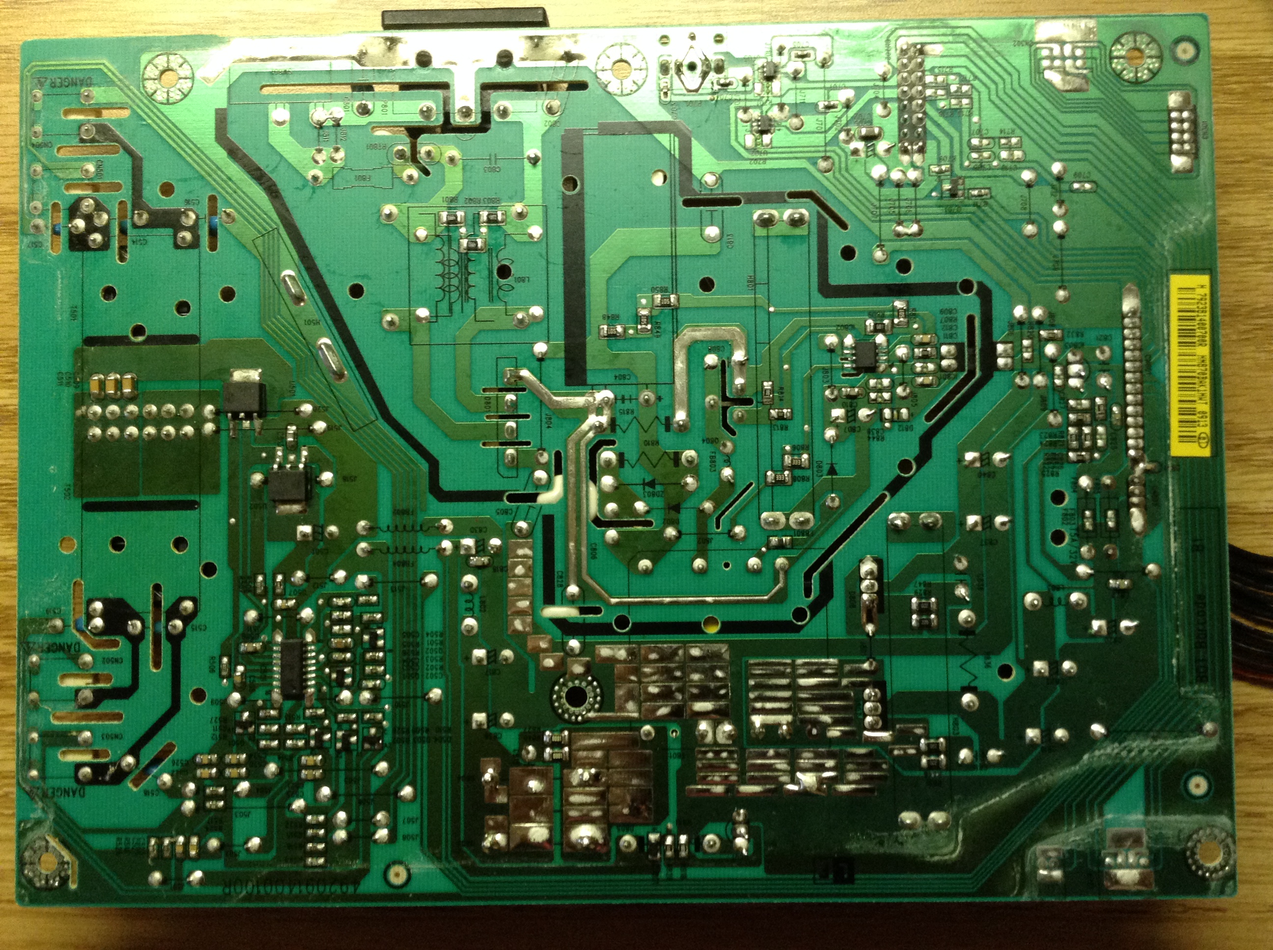

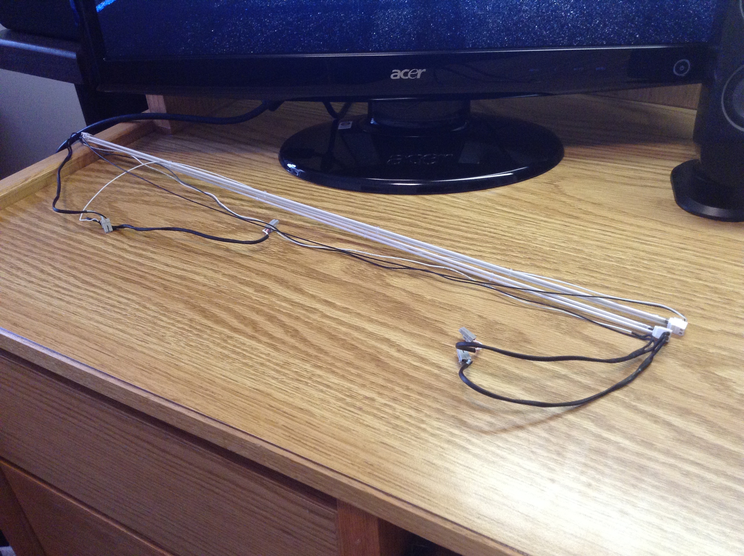

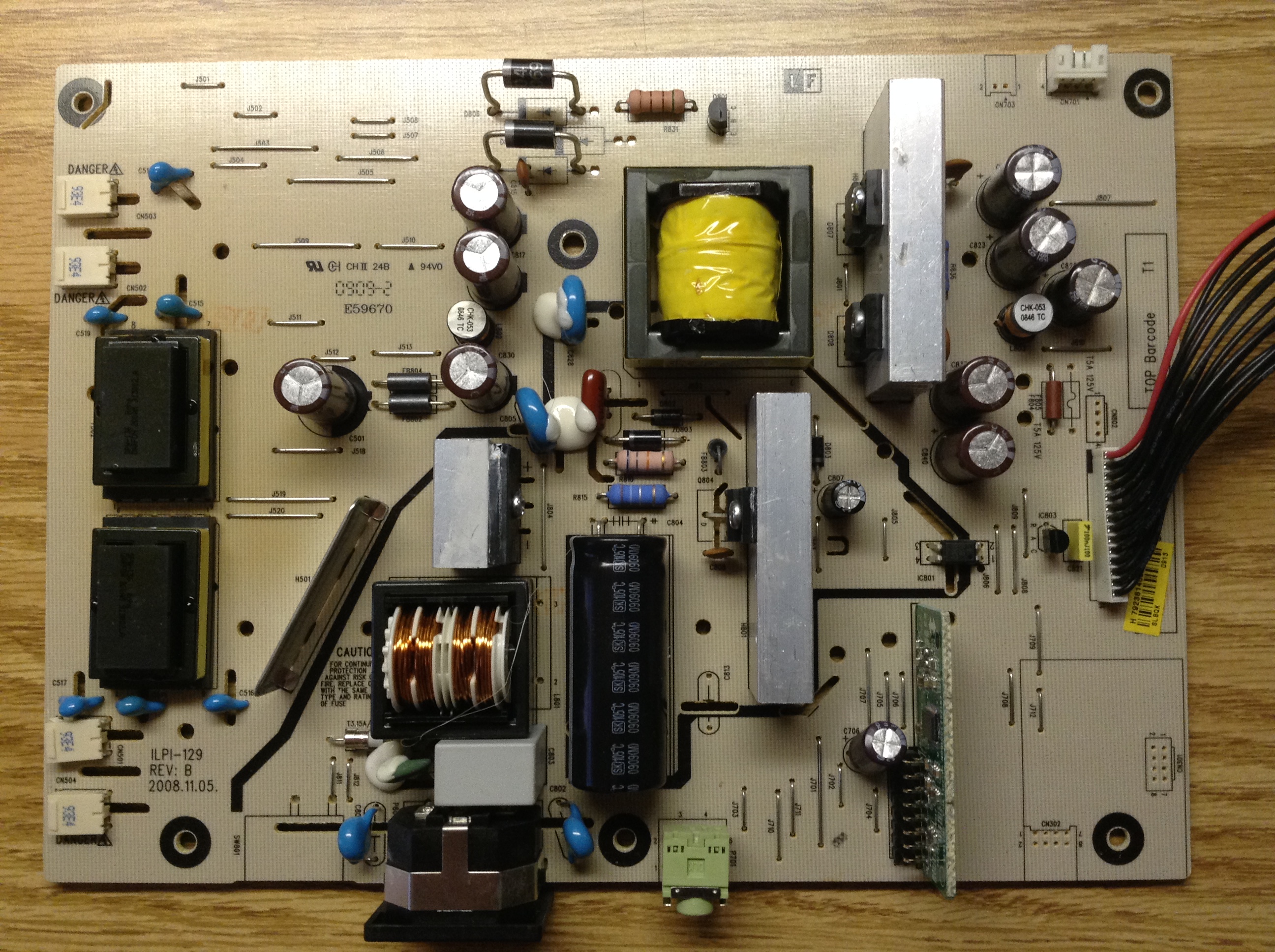

    I have an Acer H243H that the backlighting went out on. After disassembly it was confirmed that the backlights are indeed bad. The plan now is to replace the ccfls with leds. The problem is that the led lights require a new/separate inverter board that has four wires that need soldered to the power circuit board. Many other power boards are labeled where the brightness, on/off, GND, and positive power are located. This board has none of that labeled. Does anyone know how to locate these four spots? Is it even possible?
    1)GND
    2)Postive power
    3)Brightness
    4)On/Off
    Pictures of the board are attached.

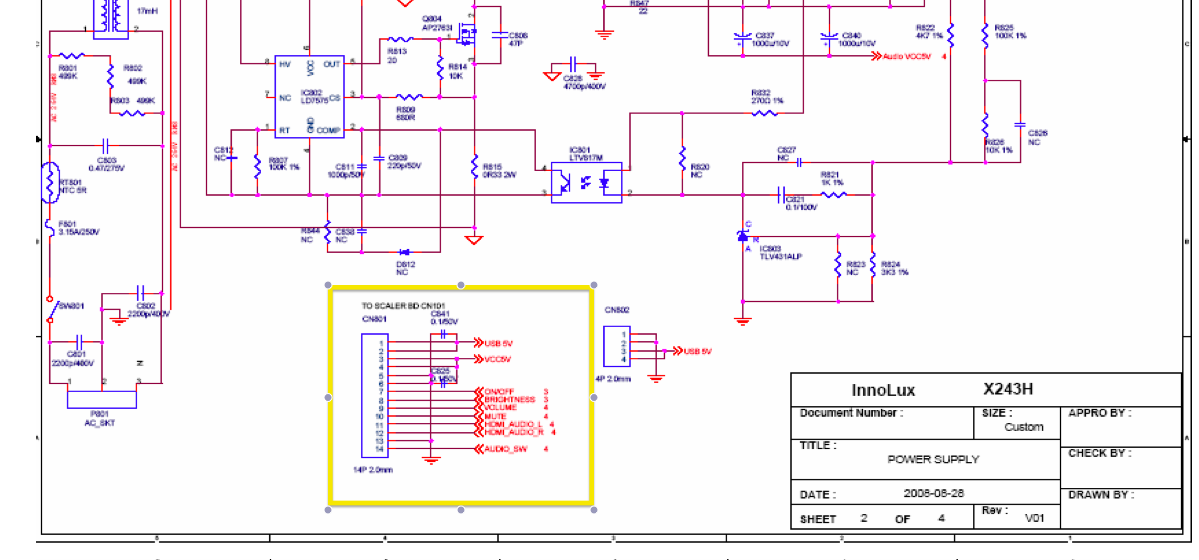

    Re: Acer H243H Power Board
    Here is the service manual that shows the pin out.
    • Ipodder77
      • Jul 2011
      • 14
      I found the brightness and on/off pin on page 47, though I'm having trouble finding the pin out for power.
        What is the input Voltage requirement of the LED controller/driver board? The one in you loink can support up to 30V so the ACER should be able to do it easily, just have to tap off the Inverter power supply section, at the two legs of the 24VDC output filter cap C830 (around the top right section of the diagram).
        You should also remove the two power MOSFETs that drive the Inverter transformers.
          The voltage requirement is 10-30V.
          The MOSFETs in the attached picture?
          Also, am I correct in the placement of the "brightness" and "on/off"?
          I greatly appreciate your help!
            "The MOSFETs in the attached picture?" Yes.
            "Also, am I correct in the placement of the "brightness" and "on/off"?" The brightness on this may be PWM (Variable pulse width 10%-90%, 90% = max brightness) instead or analog (0~+5VDC, +5 = MAX brightness). You will have to check that line to see when you make the brightness adjustment.
            Same thing for the ON/OFF, you need to find out if ON = >2.5VDC (active HIGH) or 0V (<1v) = ON for active LOW.
                  My initial symptoms were that a picture would show up for a split second and then disappear. With the use of a flashlight I could see that the picture was still there. I believe it did make a slight humming sound. I was initially hoping that the backlight problem was due to bad capacitors as it had been with previous monitors in the past (different models), but after I opened up the lcd panel I found that the backlighting ccfls were black where they had burned out and one was in fact broken.
                  My choices to fix this were either buy new ccfls or leds. I ultimately decided to order leds since they were cheaper and more readily available. I'm now waiting for the parts to come in.

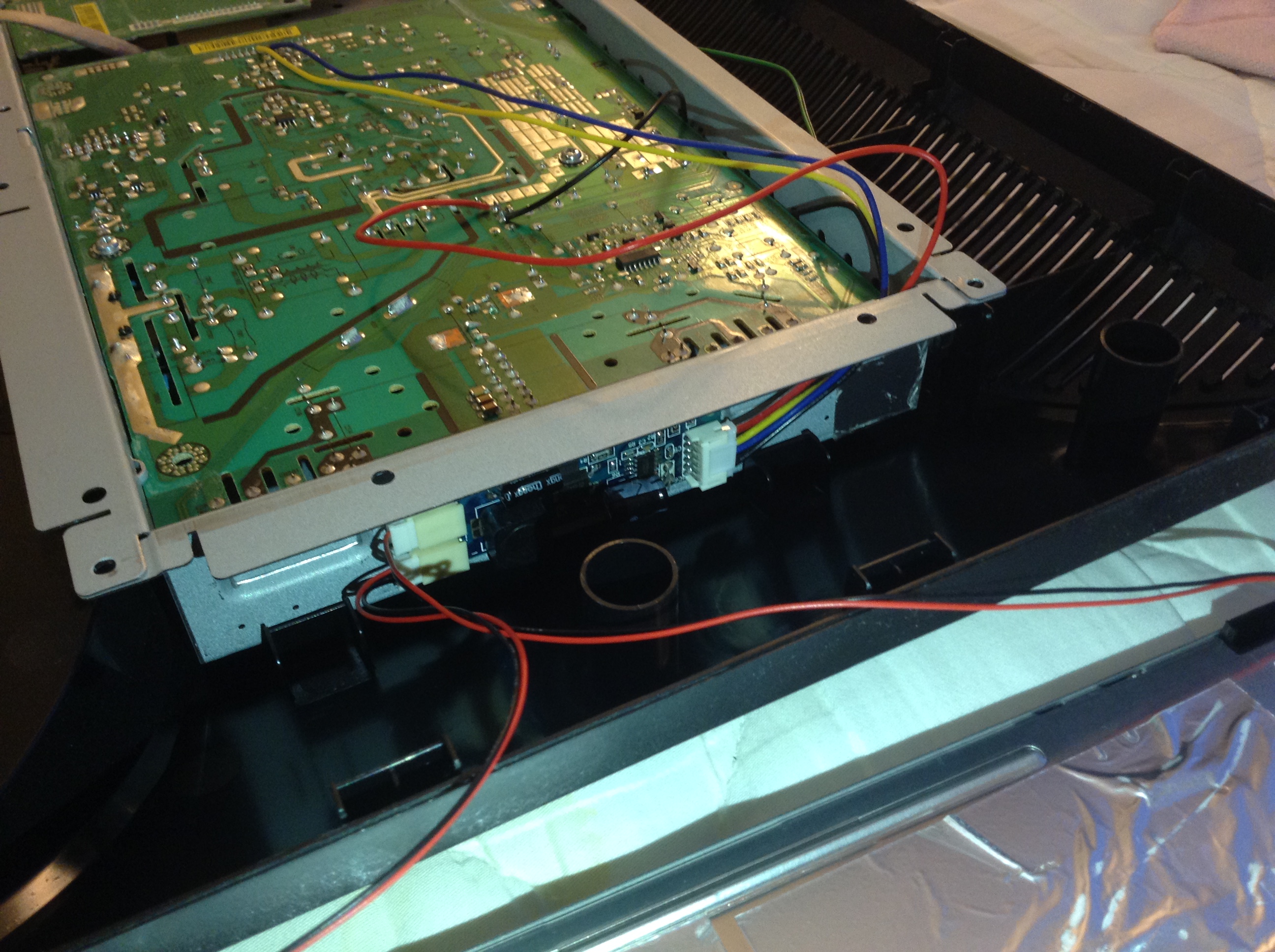

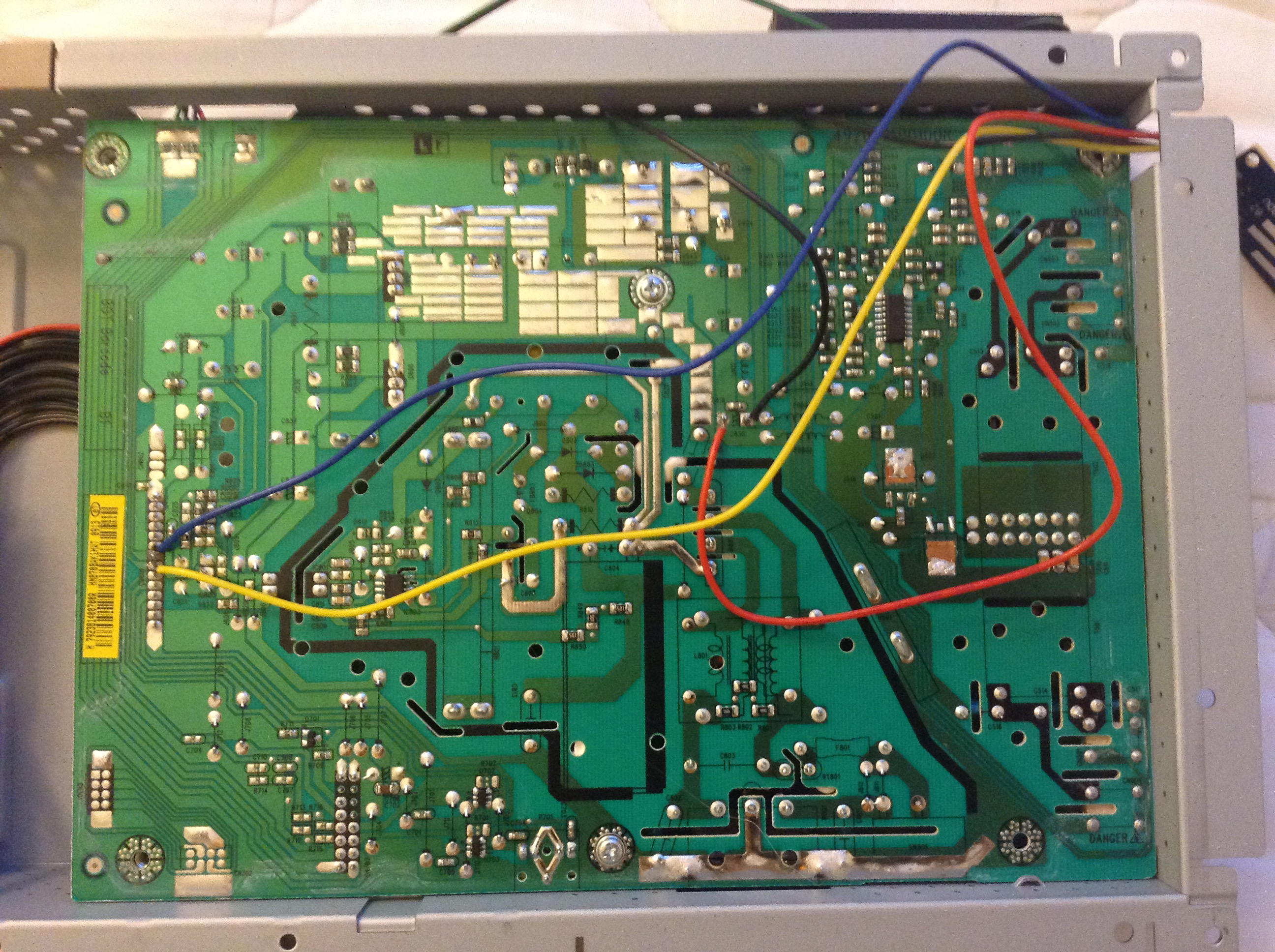

                    The parts came in and the project was a success!
                    I ordered the LEDs and inverter board from ebay very similar to my link above. An attached picture shows my board after the wiring. Though I purchased a less expensive item, the pictures in the following link helped me greatly.
                    http://www.ebay.com/itm/Monitor-CCFL...item35dcae6ab3
                    One thing I found out the hard way was that you should never just rely on the wire colors for the wire placement. It ended up every wire was opposite of what it should be. Black was actually wired positive and red was negative on the inverter. By the time I figured that out there was some resoldering to be done.
                    The On/Off is functional as well as the brightness. I had them switched as well initially, though out of the 14 pins in that location they are soldered onto pin 7 and 8. (I honestly forget right now which one was which, sorry)
                    I placed the inverter on the side as seen in another one of the pictures.
                    In all I now a great working monitor. I couldn't have completed this without the community here. Many thanks.

                                are the wires on the pic inverted
                                • Ipodder77
                                  • Jul 2011
                                  • 14
                                  The picture shows the correct position of the wires. The black wire was positive on my inverter and the red wire was negative.
                                  • temppy
                                    • Jan 2016
                                    • 4
                                    • canada
                                    Which pin is the blue wire on
                                    • Ipodder77
                                      • Jul 2011
                                      • 14
                                      The blue is on pin 7 which is the on/off and the yellow is on pin 8 which is the brightness.
