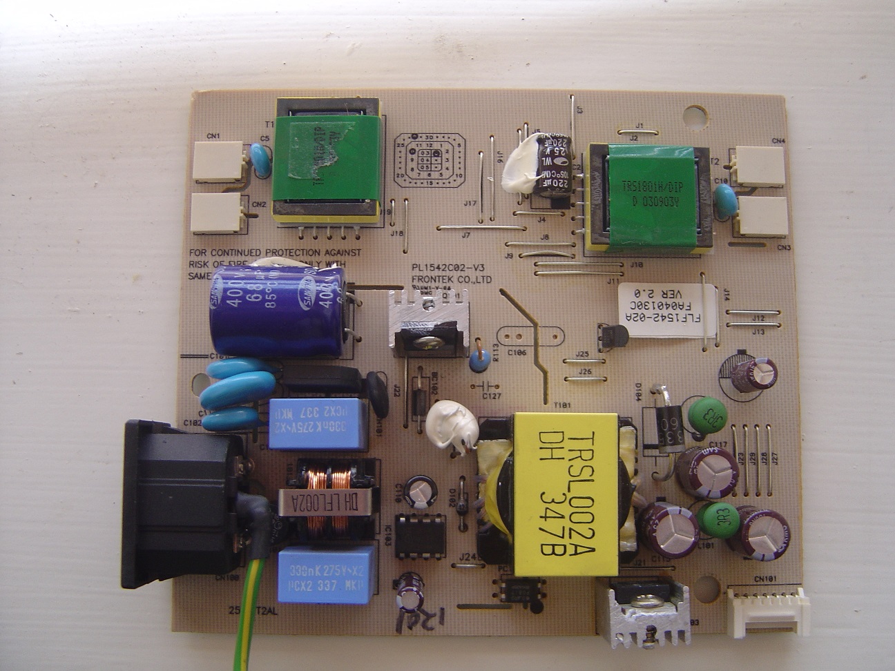

    I've had this monitor for several years, used several times a month at most. I was using it a few days ago, and left it on, came back 30 mins later, and it was dead, no light (green or orange) showing on the LED.
    Power board has the following markings:
    Frontek PL1542C02-V3 (on circuit board)
    FLF1542-02A FA040130C VER 2.0 (on a sticker)
    Voltages on CN101 are as follows (7 is the pin nearest the edge of the board):
    1 0
    2 0.35
    3 0.35
    4 0
    5 0
    6 0.22
    7 0.35
    The fuse F101 near the power connector is ok.
    The thermistor TH101 has continuity through it.
    I've replaced the capacitors C110 and C121 with new Panasonic and Nichicon (PW(M)) caps (though the original Sam Youngs tested ok on ESR meter). Monitor is still dead after changing the caps.
    I'm getting around 120V at the big blue cap. It seems to retain it's charge when power is removed.
    The bridge rectifier tested as expected in circuit, so I didn't remove to test.
    D102 tests ok too in circuit (open one direction, 0.505 the other way).
    D104 tested ok too out of circuit. I haven't changed the caps down that area yet, as when I tested for voltage on the downstream side of the transformer, I didn't see any voltage on any of it's 5 pins there.
    What to try next?

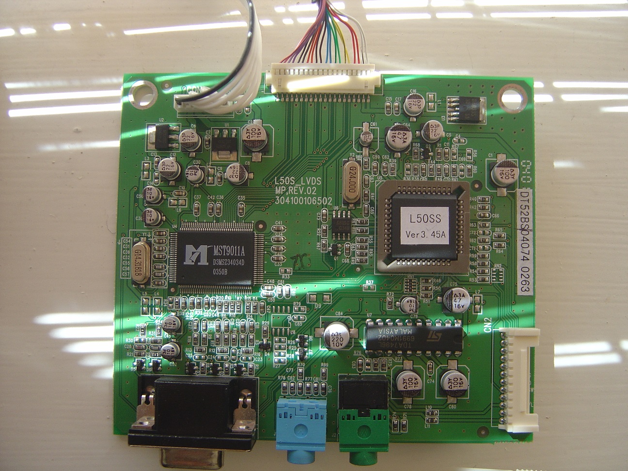

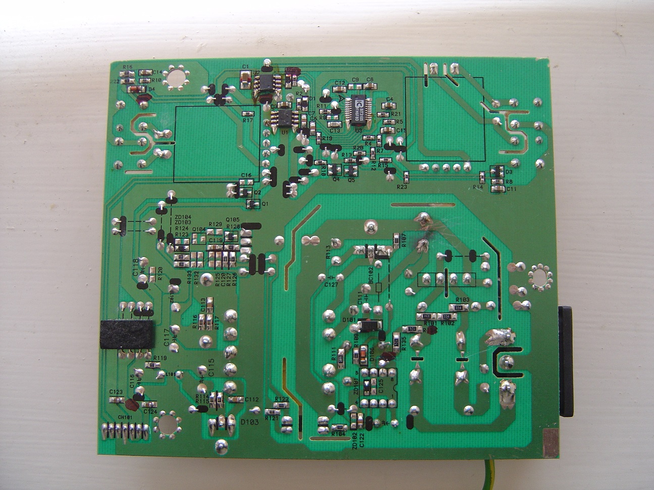

    Thats a nice dinky little board can you post a picture of the other side.
    and some of the main board
    Is your meter ok and new battery - you should get around 350vDC on the BIG Cap - Did you test on VDC
    What is under the white blob in the middle
    Did you have the boards connected it may not start without a signal from the main

      Had trouble with uploading images earlier, here's the other side.
      Have uploaded a pic of the mainboard, nothing on the other side, other than tru-hole soldering and traces, no components.

        Ok the caps you replaced - you got the same uf and voltage? and put them in the right way round? what values were they V & uf
        Working on a non conductive surface?
        Big cap - you only need the power board connected to the mains - I usually suggest via an RCD socket/adapter. Meter on 600vDC and just test across the legs - keep in position for 5-10 seconds to see if it is stable. Use aligater clips on your probes if you have them.

          There seems to be issues with the server for uploading images, I'm getting "internal server 500" messages.
          I'll upload the picture of the main board when it works.
          EDIT: Finally got the pic of the mainboard up, nothing on the other side, other than tru-hole soldering and traces, no components.

              I've tested the big cap, and it's giving 323V, pretty steady too, only around 0.5V fluctuations.
              I've been putting the boards back into the monitor chassis when appying power.
              The 2 caps I replaced with the same voltage and uF, one was 1uF/50V, the other 47uF/50V. Both were Sam Young, but I think they were ok, capacitance is fairly close to stated, and ESR similar to the Nichicon and Panasonic I put in. In the correct way too, the component side is silk-screened with the polarity, so difficult to get wrong.

                What is the part number on the ic between the two caps you replaced
                  • 31214
                  Re: Hyundai l50s - dead
                  check the fet on the heatsink and tell us what caused the flashover under the main cap!

                    It's a ICE2AS01
                    I get around -120V on pin 6 of that IC, supply should be around 8.5-21V according to datasheet. Could that be right? I checked with both AC and DC and it was roughly the same 110 and 120V.

                        Can you measure the resistor under the white blob what should it be - what colour are the
                        stripes

                            Also if look on the back I think that pin 6 is connected to the transformer via
                            two resistors R135 and another of the same value under a stain - can you clean the stain off - any idea what it is?
                            I think that striped resistor is not the one I wanted - its the ones on the back.
                            Its best to use a large resistor to discharge the big cap or just wait a bit then test it with meter.

                                The 2 resistors are R135 and R134.
                                They both have "124" on them. One is reading 116.2K ohms, the other 120.5K ohms.
