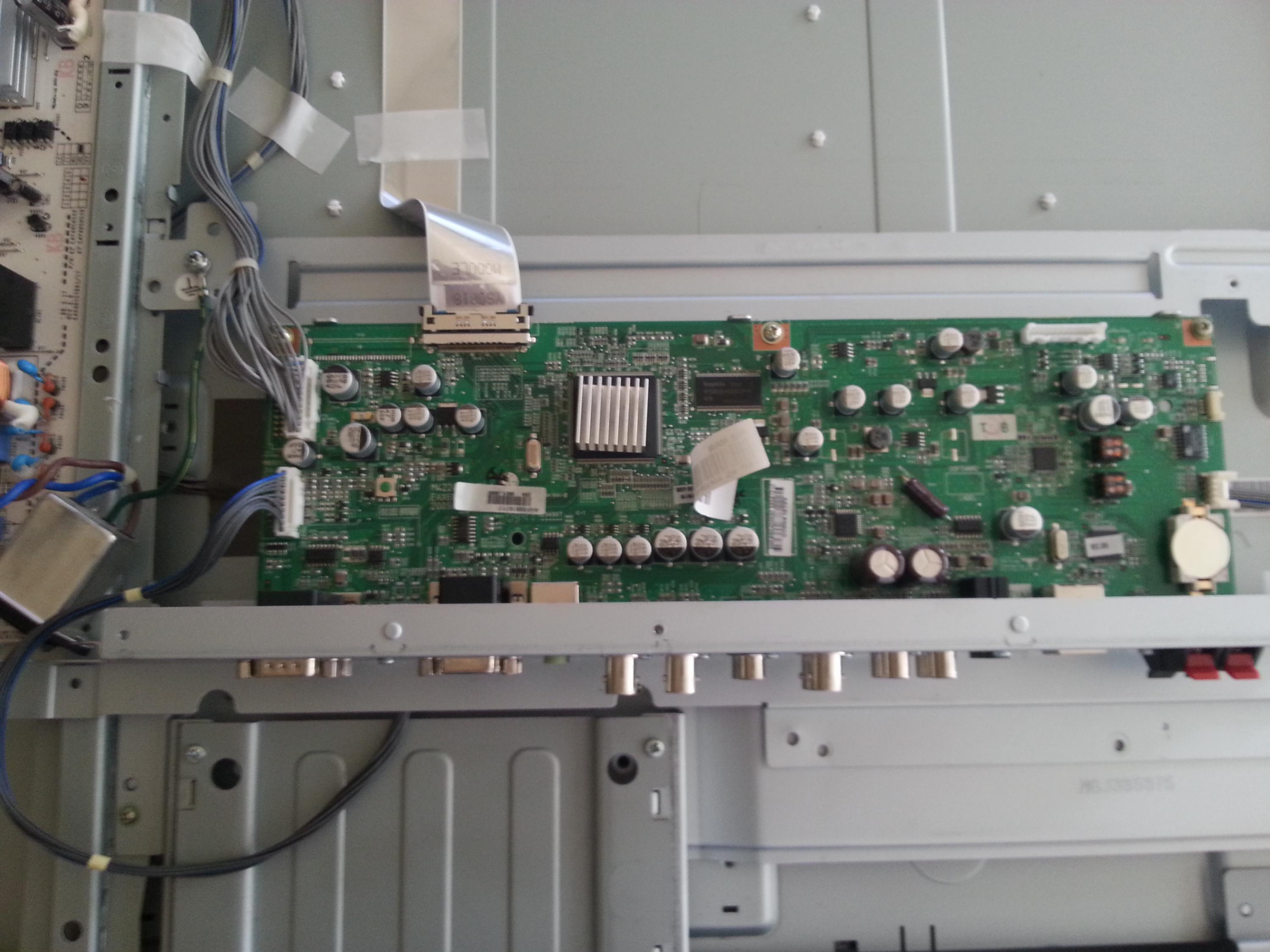

        Ok - it happens- This is more like a TV without a tuner than a monitor. Do you have a multimeter and soldering equipment. If your "insides" are the same as in the thread you refer to it is often the inverter boards that fail ( In Televisions). Without doing some tests it is hard to tell what might be wrong.
        If you post pictures please post using manage attachments - will take jpgs up to 3mb

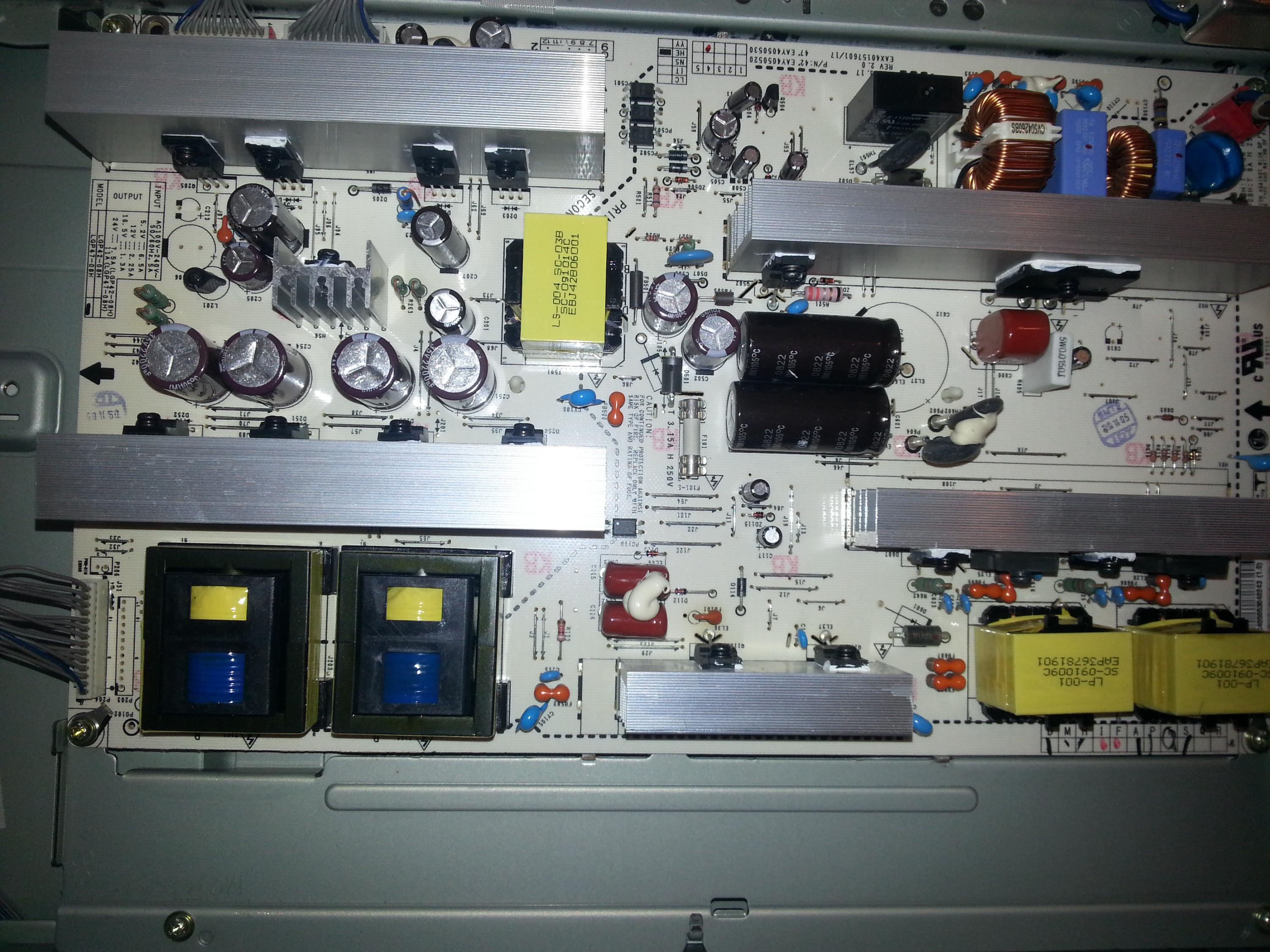

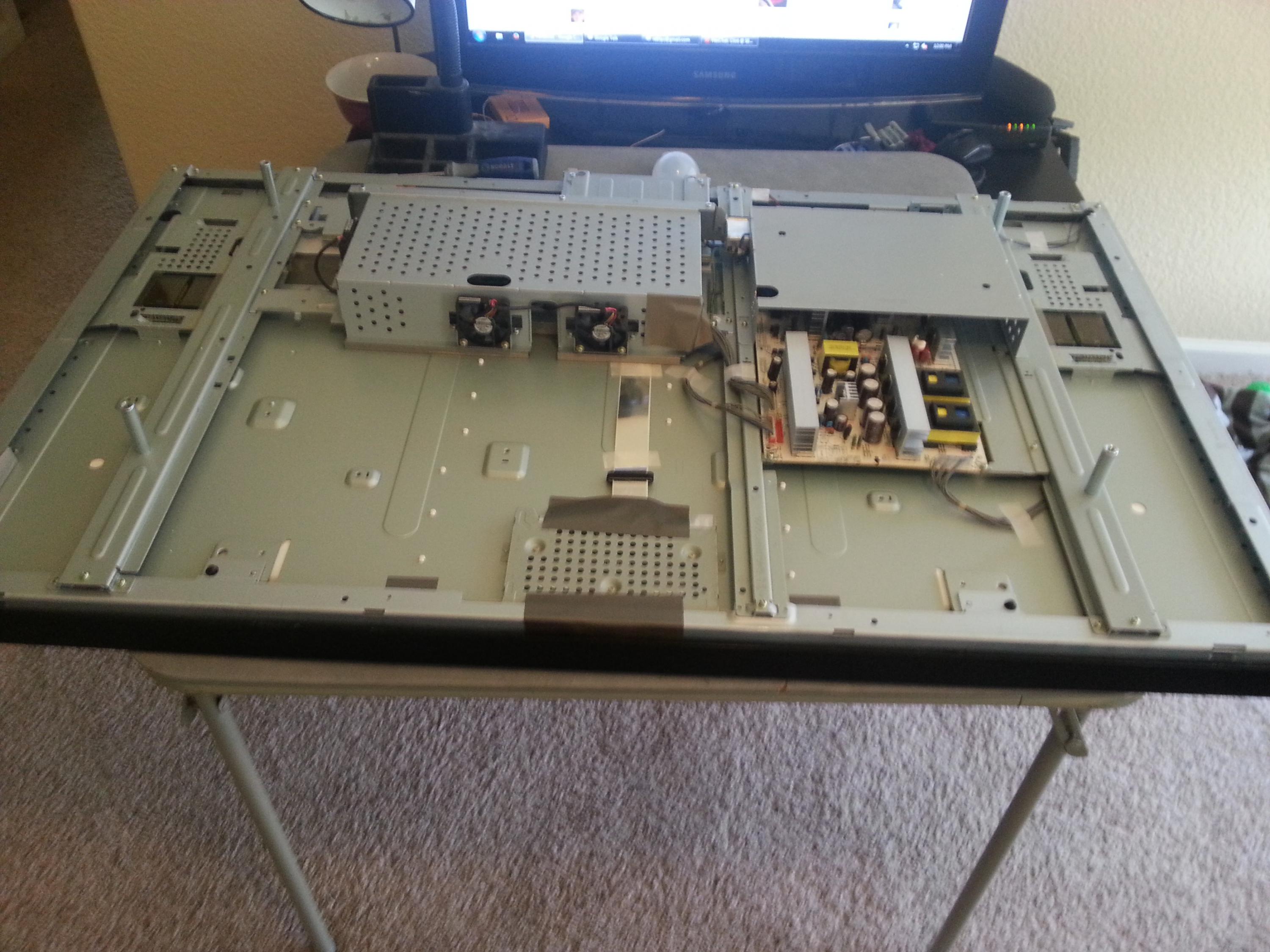

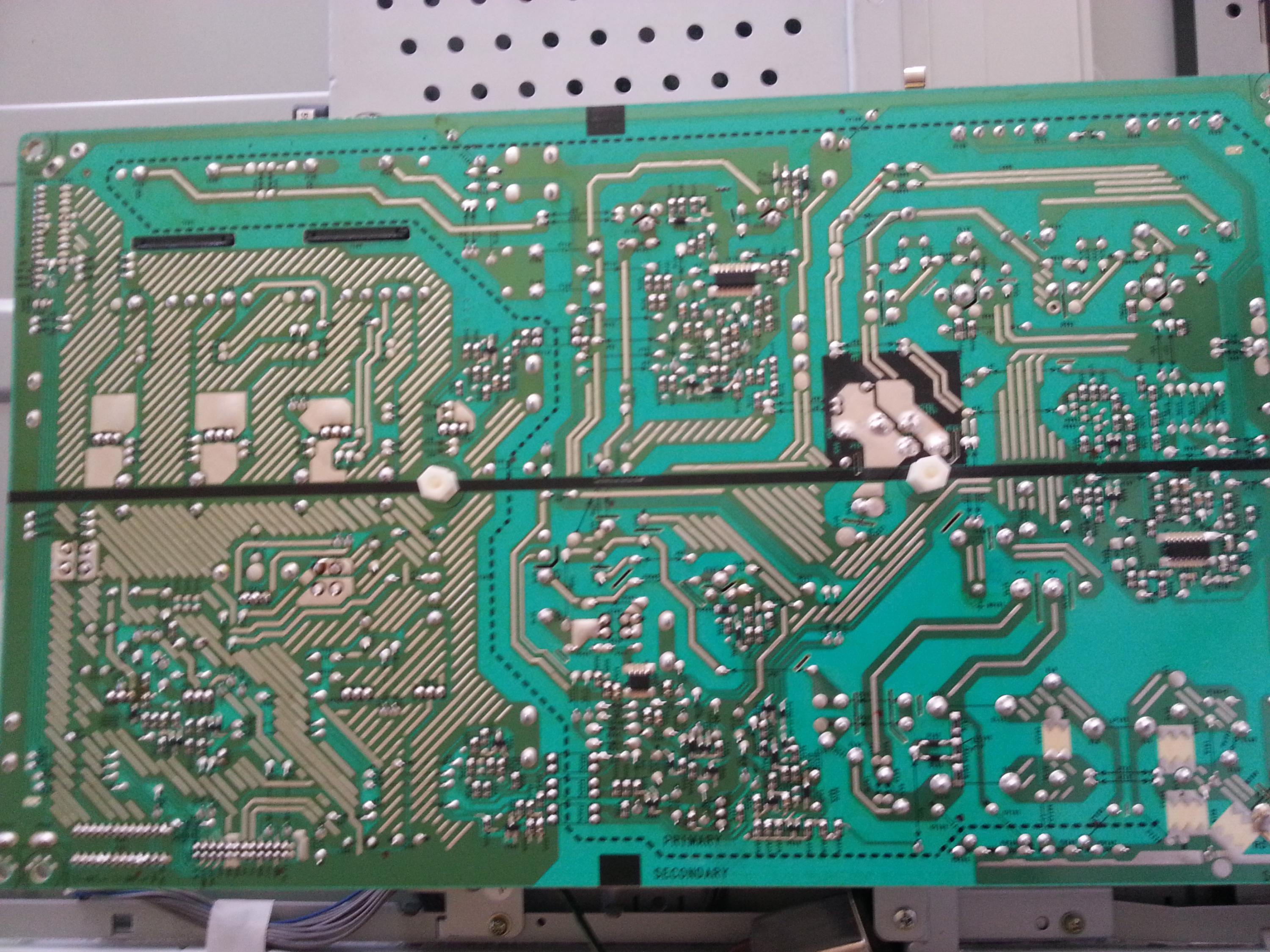

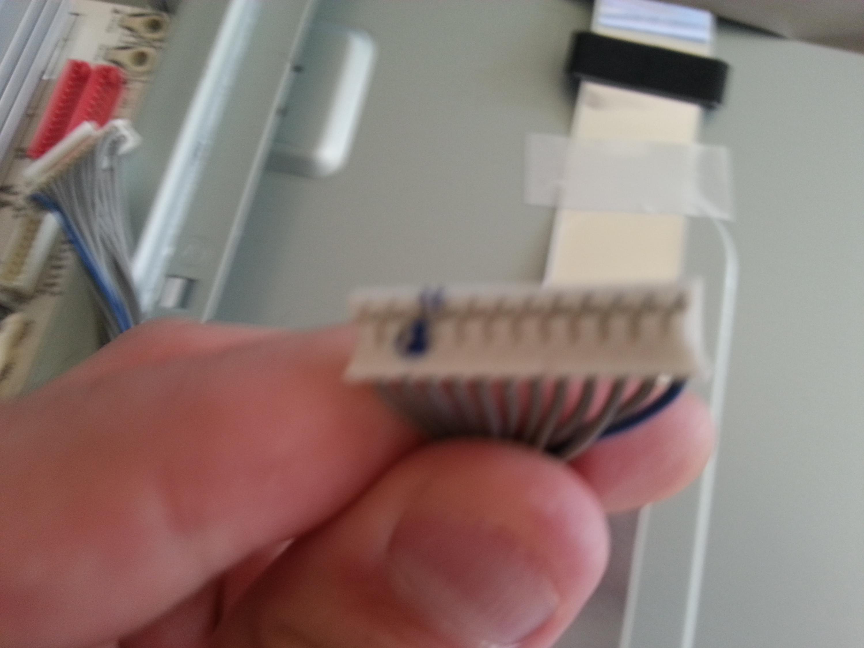

          Attached are some photos. First photo is the layout of all the boards. The rest are all pictures of the power board. The last picture is the connector in which I found some corrosion on.. I didn't see any burns on the board or any bulging/leaking capacitors.
          Although, I did find some white silicon/glue or something on some of the capacitors/resistors.. not sure if that was intentional or if that's leakage?
          I do not have a multimeter to be able to test. I could however go buy one.
          the corrosion/burn on the pin connector is on the ground side. if that helps.

              I cant tell which socket/pin has the corrosion - what do you mean by "the ground side"
              is that what it says on the board?. You need to clean it up and make sure you have connectivity.

                On the board where that socket/pin goes, it is labeled |_Ground_||_xxx_|
                (xxx) for whatever it may say, I don't remember off the top of my head.
                The second pin location on the socket is green/black in and surrounding the pin. It's the only thing I saw that didn't look right on either board. I haven't taken the inverter boards out yet to inspect.

                  Could it be that it has been marked to help establish which way in it goes?
                  Does it look burnt or corroded or could it be dye/felt tip

                    Can we get good clear and focused straight shot picture of the whole power supply board both side? Also close up pictures of the connectors on the power supply board, it looks like there are some labels on the connectors to tell use the pin out of the connectors. You will have to report the DC Voltage readings with label of each pin of those connectors when the TV is off and when TV power switch is activated.
                    It looks similar to this one:
                    http://www.shopjimmy.com/lg-eay40505...wer-supply.htm
