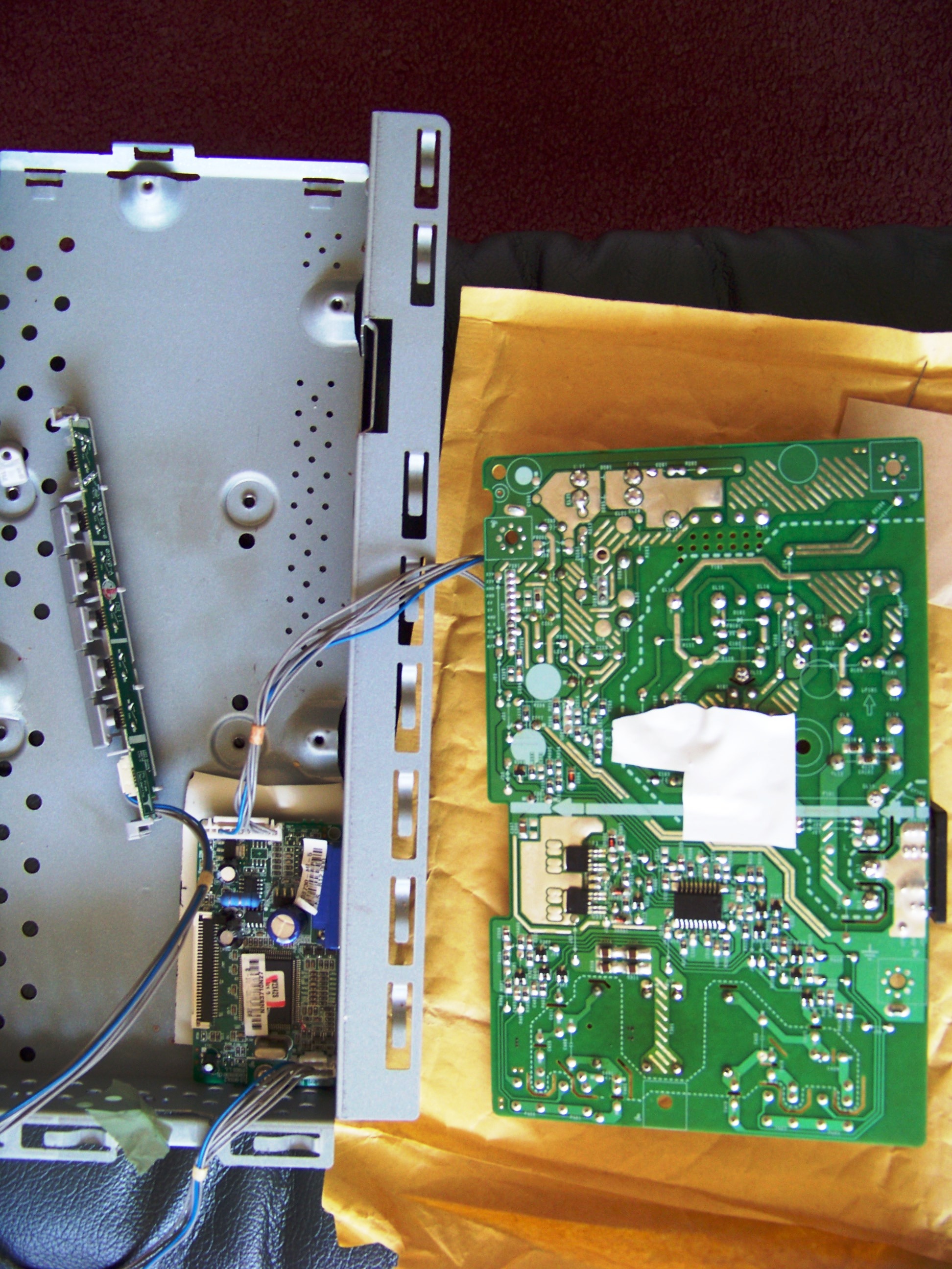

        Here is my board - I know its a mess - I have to say I have half given up on it as I dont need another monitor. Repaired it once with a new inverter transformer and replacing all the caps then 18months or so it just upped and died q101 blew taking out some diodes and the fuse. Replaced Q101 but couldnt bring myself to buying packs of 10 of each diode so I was waiting till I found some on other boards but project got shelved
        So I would just set it up like this with the panel plugged in. Sheets of card between boards (including the button board - missed the card out on the picture though I would probably take the logic board off the frame as well.
        I have put a tape on this board to highlight where C103 is - at least its the easier of the two to get at.
        Pic 1 is out of focus sorry but you will get the general idea in pic 2 you could cover the bottom half of the board up to the white line with a bit of card
        as you will be working above it.

          That white connector is on the cold side which the circuit ground is also connected to the chassis, so yeah, do not touch anything in the primary hot side. I myself use outlet with GFI and Isolation transformer on what I am working on.
          BTW, do you have the spec sheet of that SMPS IC u101 LAF0001?
          Never mind, it is the same as FAIRCHILD FAN7601.
          Startup cap connected to VCC pin shows 0V?
