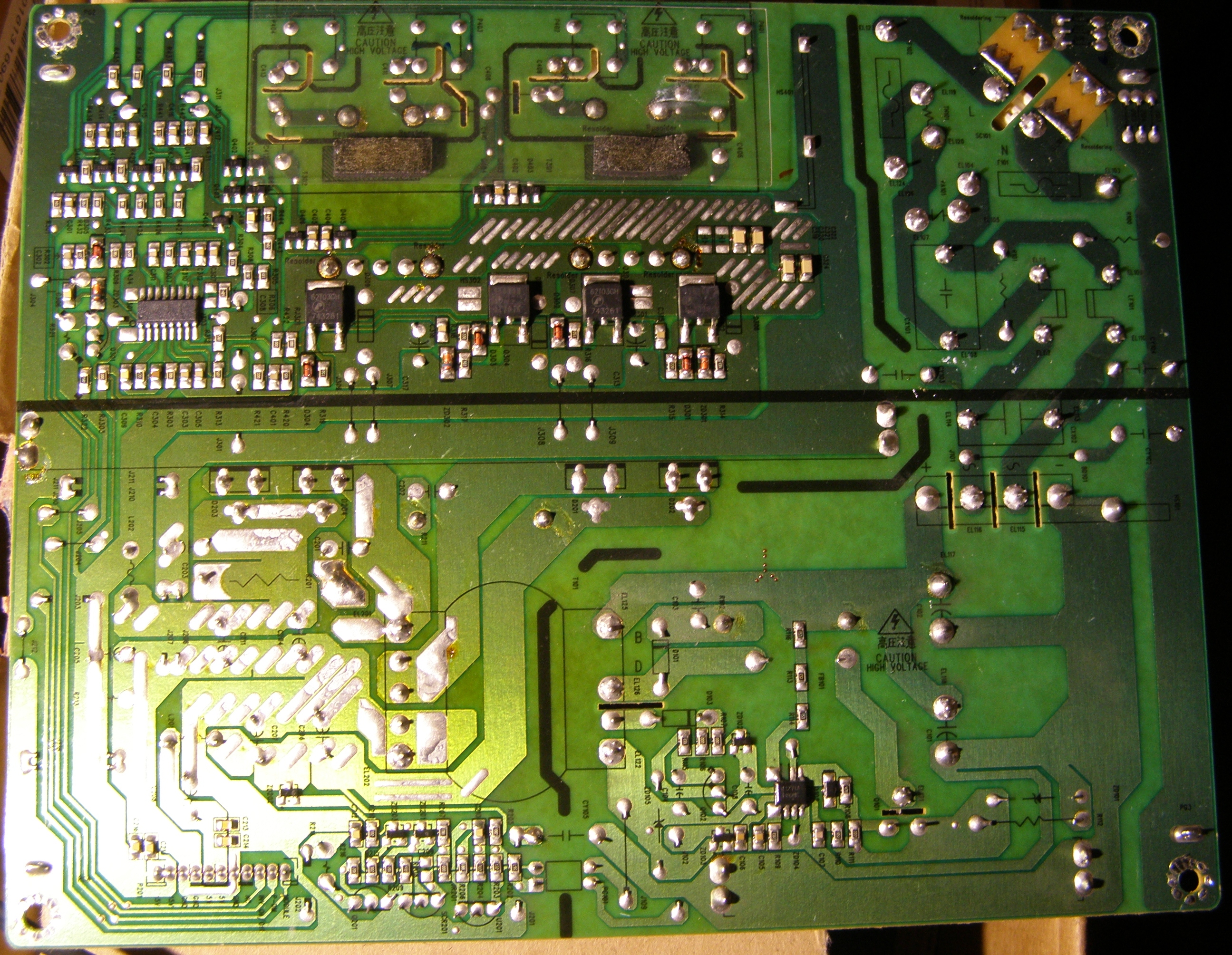

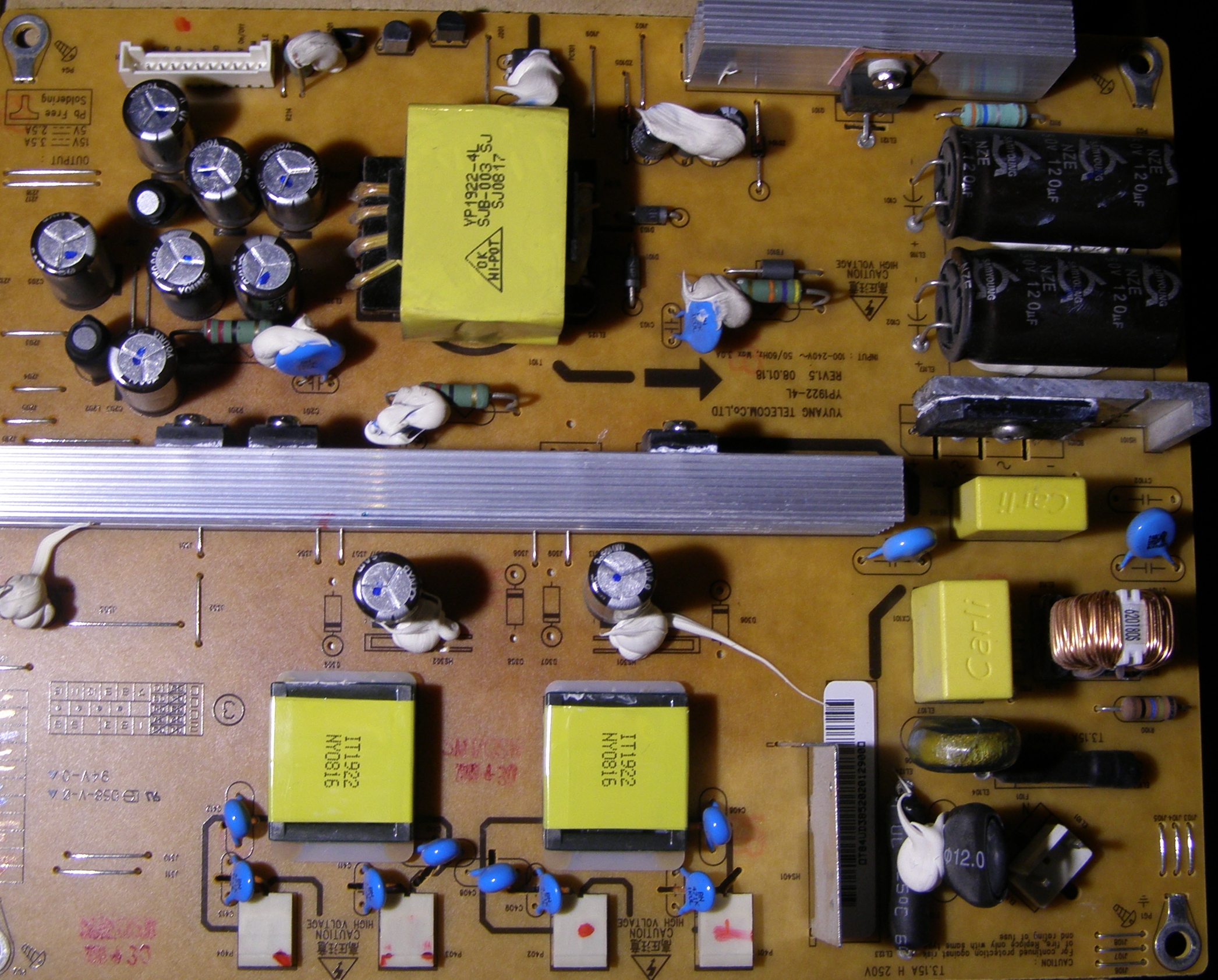

    I have LG LCD TV. When I turn on the TV backlight turns on for 1 sec and then goes back off. I think it is bad invertor. But i dont know, which of components is bat. MOSFETs and caps seems OK.
    Help me, please.
    Thanks.

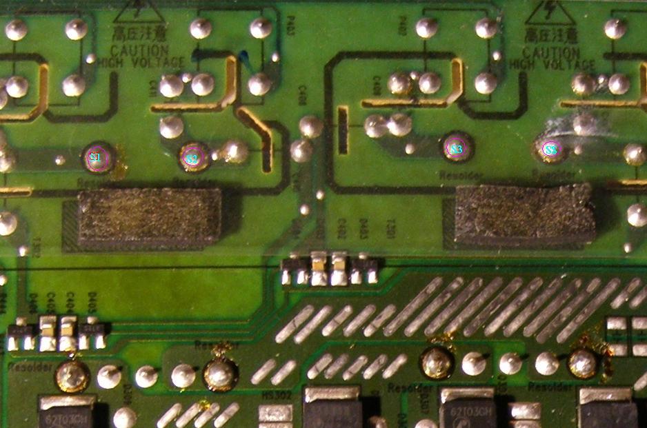

    Ok you need to test the inverter transformers secondary windings.
    No Power to Board
    Meter on Ohms 2000 test S1 to S2 and S3 to S4 and post the results

      S1 to S2 - 1080 Ohm
      S2 to S3 - 1092 Ohm

          Ok they look alright. Are the leads on the lamps long enough for you swap each pair over.
          Often the bulbas at the top age faster and developa a higher resistance.
          Do you have any spare bulbs /another faulty ,even broken monitor or laptop screen.

            Thanks,
            i try to swap tubes with one laptop screen tube.
            One of the top tubes is bad. When laptop screen is connected TV running always.
