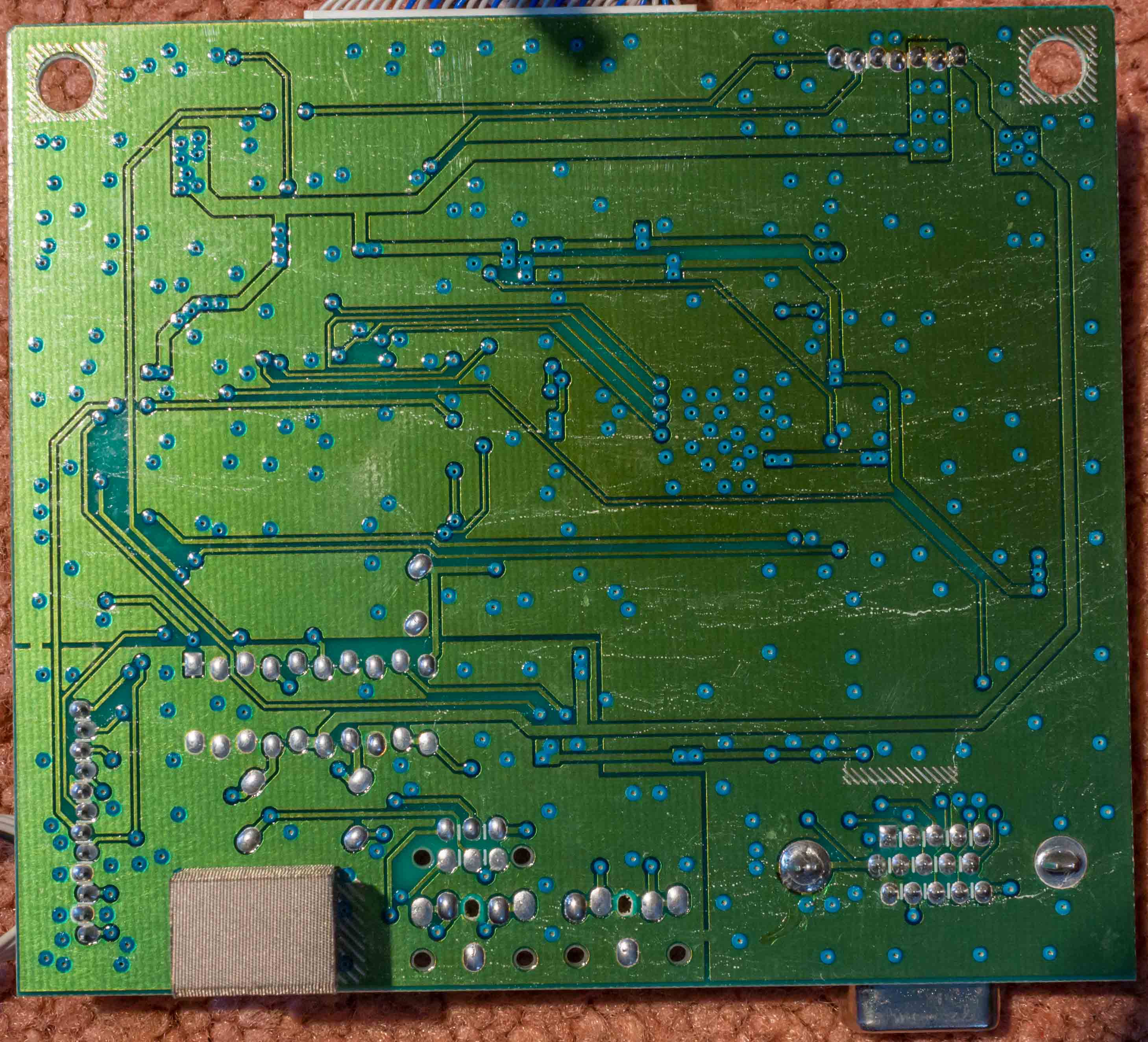

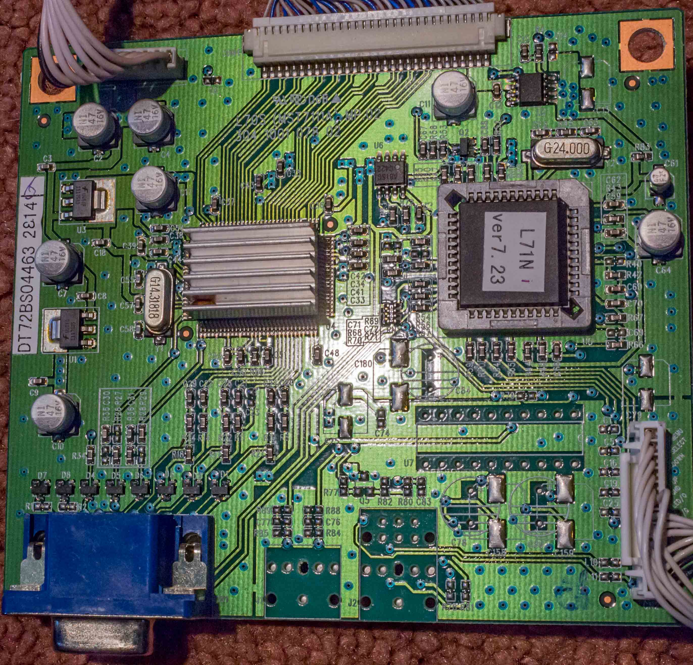

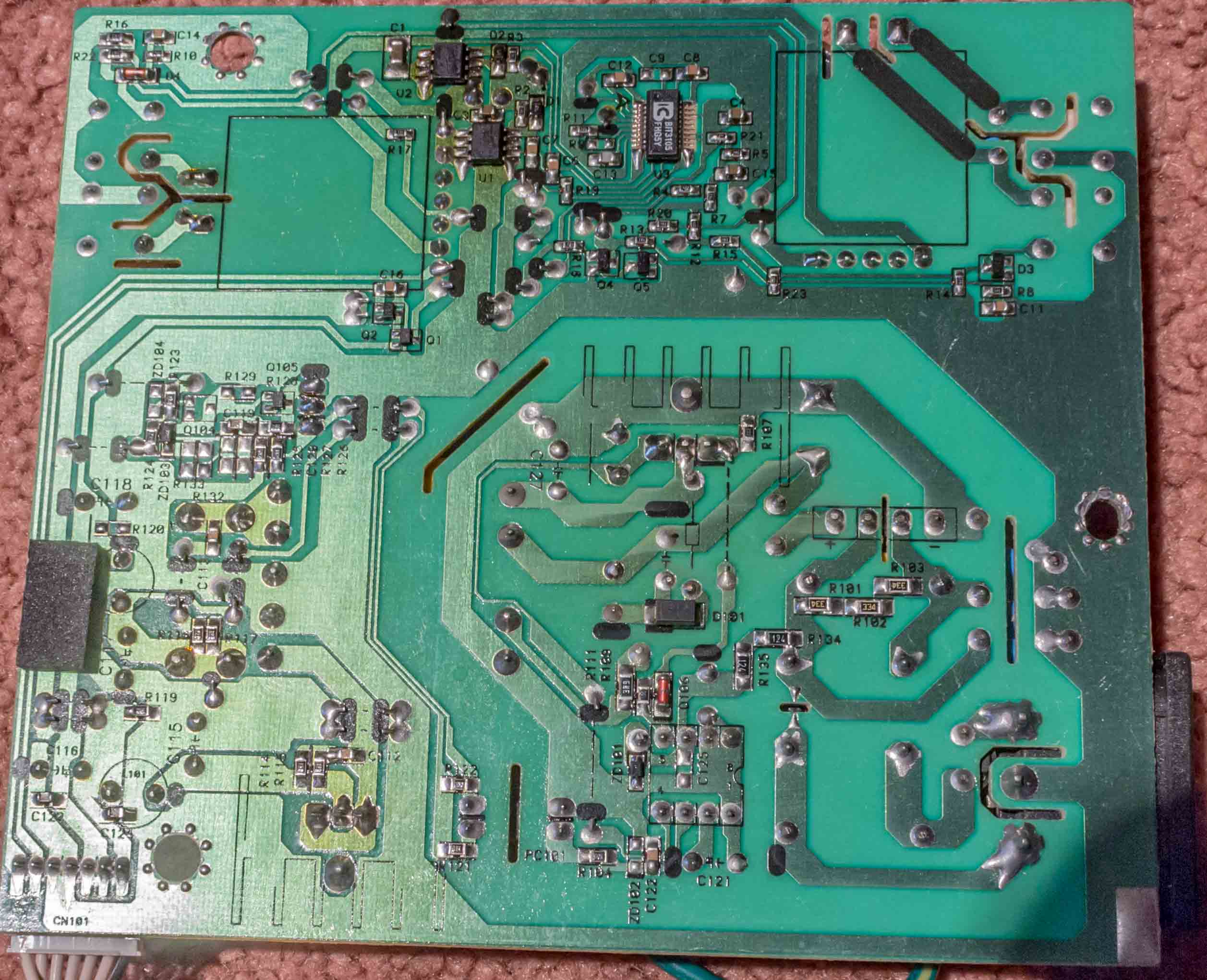

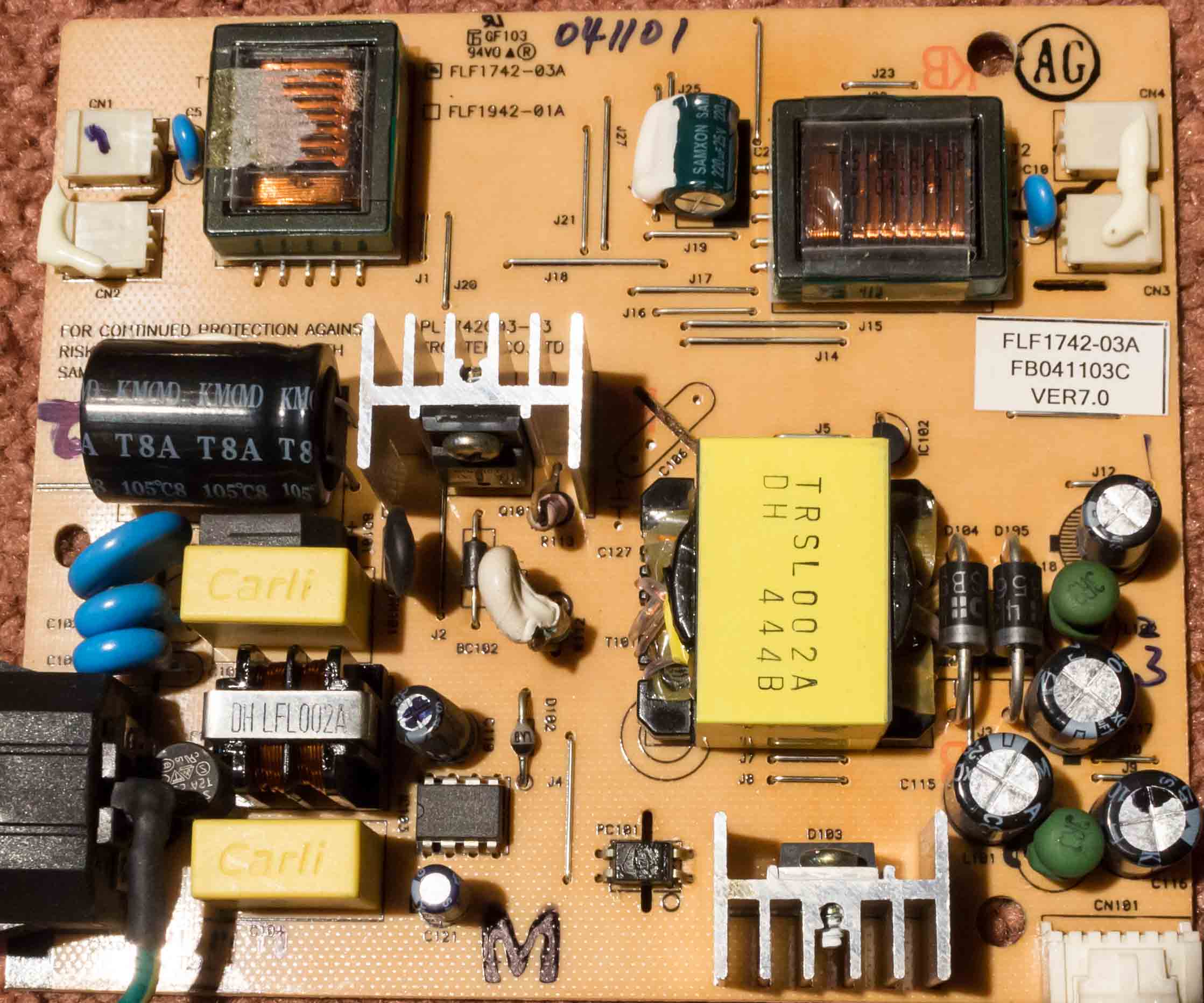

      Attached is front and back of both inverter board and logic board.
      hope they are good enough quality, had the settings amiss on my camera, came out super dark and had to brighten up.

        on the invertor/psu board:
        optoisolator pc101 looks like it went up in flames!
        and there is a huge amount of cracked solder joints on both boards.

            pc101 looks burnt = you need to tell us if it is it is a common part easy to replce
            Solder joints can be reflowed if you can handle a soldering iron.
            So dependson how much effort you want to put in - there may be other faults.
            On the back in the centre about an inch up what is on the board next to the description
            zd181
            If you decide to scrap it offer it on freecycle as someone may need the parts
              zd181
              ... a tiny black box that looks like zd103 and q105. dont know what it is though. doesnt seem to have any markings, but i dont have a telescope to check closer.

                    What DC voltages do get on those filter caps on the bottom right of the board? I doubt that the Opto is bad, it is used for feedback to regulate the output voltages. If you do have 5V and 12V then the opto is OK.
                    If I troubleshoot this monitor, I will use test lamps to find out if I have inverter board problem or backlights problem.

                        " using my dmm to emitter/collector and analogue to anode and cathode." How do you have the analog meter connected to the LED side, which probe of you analog meter has positive polarity, the red or the black probe, and your analog meter may not have voltage or current to provide forward bias to turn on the LED inside the Opto. Did you verify that you you do have 5V and 12V on those filter caps, if the opto is bad you will no longer have regulation for the circuit to maintain 5V/12V output.

                          i would seriously recommend you DONT power that monitor up till you resolder all the joints that look cracked or have a visible shadow-ring around them!

                            Hi all, i don't think the look of that opto tend to bad since there's no brown around it on the pcb, the dirt on it can be a laquer/flux residue, very common on pcb's.. stj i don't see any cracked joint, Jason you can measure high voltage transformers outputs in ohm and compare them or report here, test also those 2 8pin ICs on the back as mosfets or doublemosfets for shorts (chek first their datasheet). If you don't understand make a turn on this message board you can fast learn something more.

                              there are loads of cracked joints on both boards - look again!
                              specially on connectors and large parts like transformers.

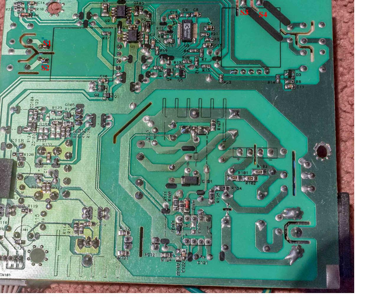

                                Try this
                                No power to the board Meter on Ohms 2000 test S1 to S2 and S3 to S4
                                as marked on pic

                                  On power board i see 5-6 only suspectable dry joints in the psu primary zone, a picture like this can be clear enough due to reflections and shadows..

                                    i must have a better monitor and video-driver/renderer.

                                      Resolder the joints and see if it will stop buzzing and the lamps stay on, if not, check the transformer resistance to see they are within the range of each other. I think its time to use the test lamps, otherwise you can spend lots of time on the board if the problem is the bad lamps, buzzing sound can come from bad wiring at the end of the lamps.
