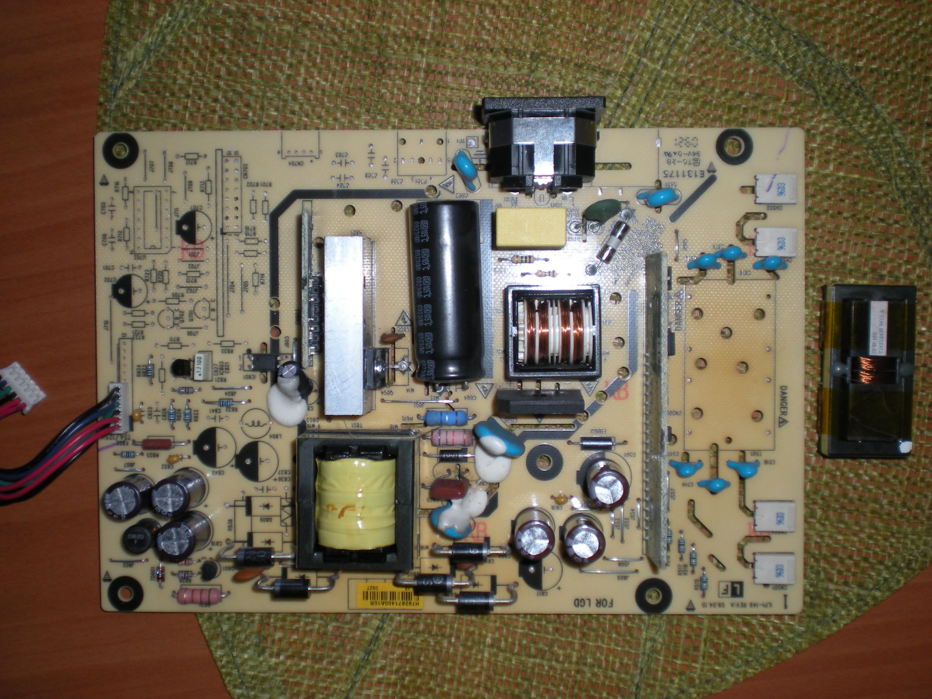

    This LG W2243T-P has about 4 years now. The 1st signs of failing were a minor buzz and a top screen flicker in intensity. The following day these two got stronger and after 2-3 oscillation of buzzing and flickering it went off completely and still does that every time I turn it off and back on again.
    Before I found some similar issues on this forum I've removed the SPW-102 transformer that's sitting next to the board in the picture. I've done this because it seems it's the buzz source and while nudging it while buzzing modified the sound that it made.
    Can anyone please advise where I should start looking?

    It may have been buzzing as a symptom rather than a cause.

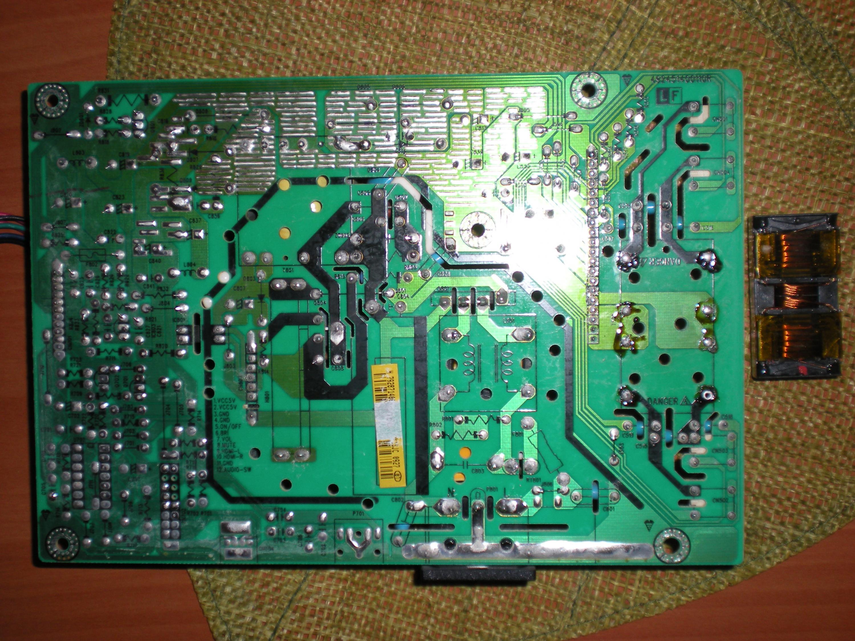

    It looks like all the high voltage solder joints between the ends of the transformer and the bulb sockets need reflowing some on the blue caps look a bit off , but may be the picture.
    Tested the Transformer?
    Problem may be bulbs or the wires to them - have you any spares - old laptop
    screen or another monitor you are prepared to open up

      Re: LG W2243T-PF buzzes and shuts down a few times, then goes black
      Resolder the connections circled in red and any others that look like they are bad.

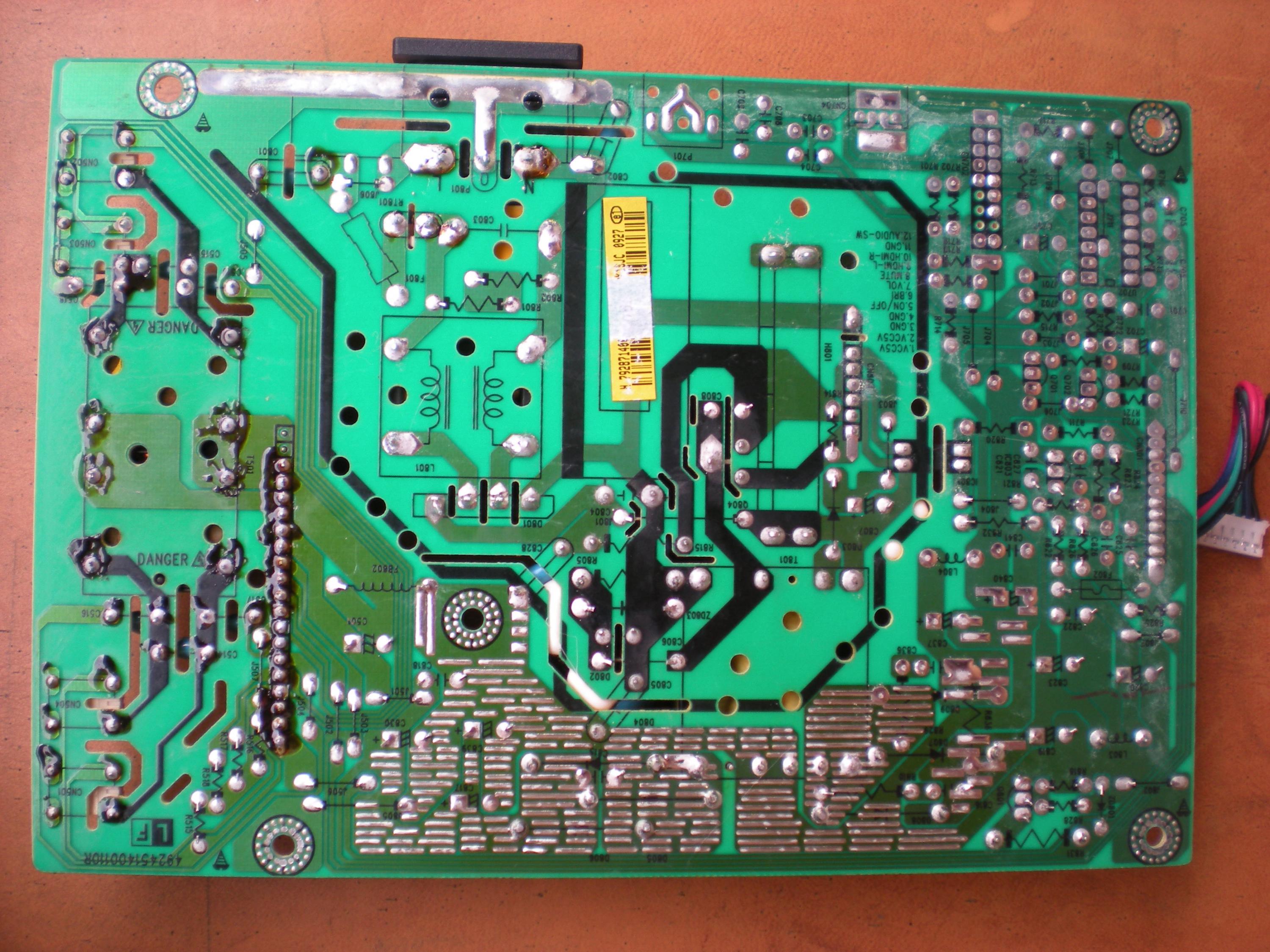

        On the picture some connections are quite different than in reality.
        I've resolder some as you can see in the new picture.
        In the meantime I decided to check the lamps, I've disassembled everything and connected the lamps. I even moved the wires a bit to see if it affects something. They seem fine.
        After that I've connected just the top or the bottom lamp alone.
        When just the top one is connected it makes the buzz 2 times and shuts down.
        When just the bottom lamp is connect it makes a barley noticeable high pitch noise and it goes off the same way after lighting up 2 times.
        From my point of view there's something wrong with the power circuit for both lamps. I'm gonna buy a multimeter this Monday to check the spw-102 transformer and the capacitors along it's circuit.
        Please let me know if you have more ideas or see something in the new picture.
        Thank you.

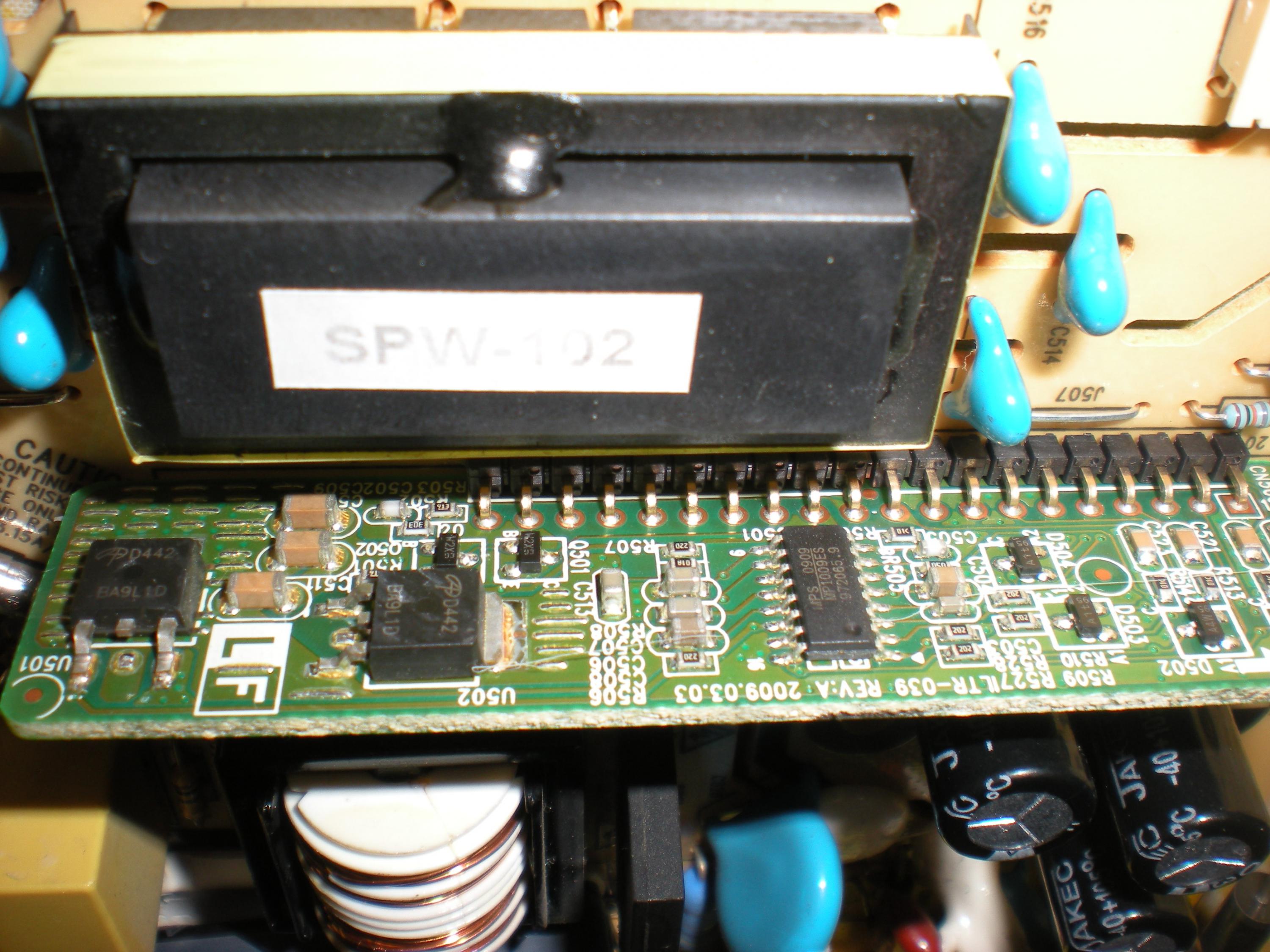

          Take a picture of that small driver board.
            Ok - perhaps clean the flux off the joints with IPA and an old toothbrush.
            Testing one lamp or two at a time shows the bulbs are not totally broken but
            you HAVE to have all for for them to stay lit. One could still be causing the shut down. I you have a 14w or less cfl lamp you can make tester bulb
            As above - picture of the riser board and if you cant read the part numbers
            on the components on the picture please list them.

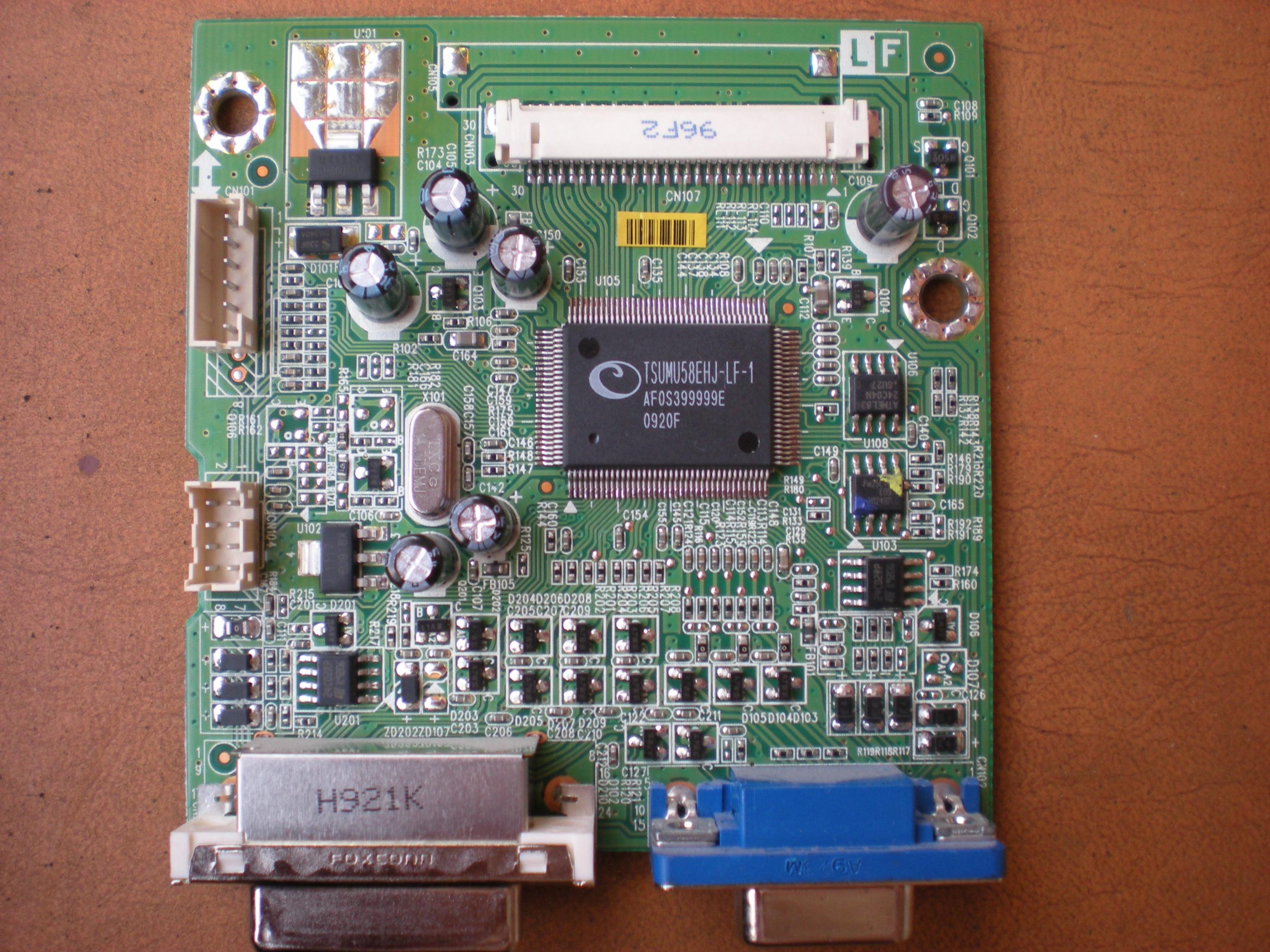

                mscserbia: I've added a picture of the other board.
                  Not that board the small one at right angles to the power supply next to the inverter transformer
                    Sorry about that, here's the requested picture.
