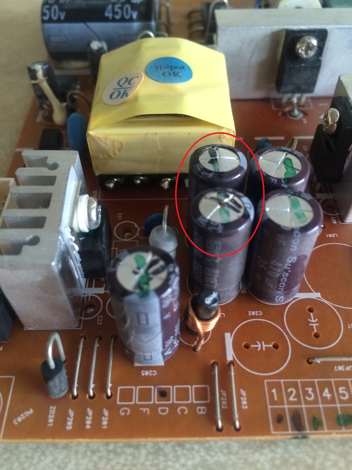

    Basically in the middle of the night I could hear a high pitch sound coming from the monitor, so I pulled out the power cord directly from the monitor. Fast forward to this morning, I plugged the cord back in, and now it won't turn on at all.

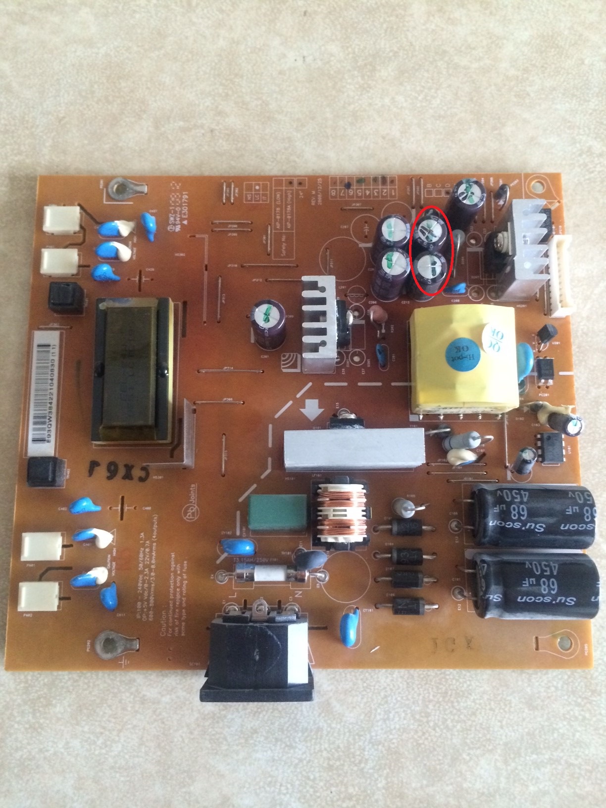

    I have taken it to bits, Tested the fuse with a multimeter which seems fine. I have noticed that 2 of the 1000uf 16v capacitors seem to be bulging at the top as circled in the attachments.
    My questions are -
    How can I test these with the multimeter?
    Are they even worth testing if they're bulging or should I just replace?
    Should I replace just the bulging ones or all of them to be safe?
    Luckily I have done some soldering in the past so that part shouldn't be a problem!

    1 You cant really test them with a multimeter
    2 Not worth testing if bulged
    3 Replace all of that size/series to start with
    Use low ESR caps for that purpose not caps from maplins
    Suggest cpc.com panasonic FR FM or FC in that order you need to be careful
    on physical size some values in some series may not fit.
    I cant see the ends of the bigger caps just check they look ok.
    Also as there are only 2 other small ones and one is the start up cap I would replace them as well
    Caps may not be the only problem. When you say it doesnt come on do you mean doesnt light up - is the power light on?
    There is another fuse at the back right corner Black rectangular job.

      Bigger caps look to be ok.
      Yes doesn't light up at all. Have tried with another power lead etc so I know that isn't the problem.
      Other fuse seems ok too, Getting a reading from it.

                Replaced 3 of the 1000uf capacitors (only 2 were bulging)
                All working fine now

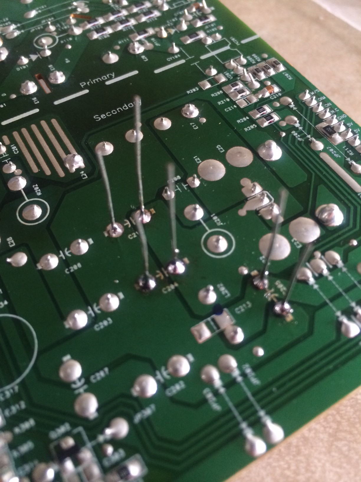

                        And here's my dodgy soldering
                          That's fine, as long as the solder adhere tightly to the leads and flow around the through hole area...
