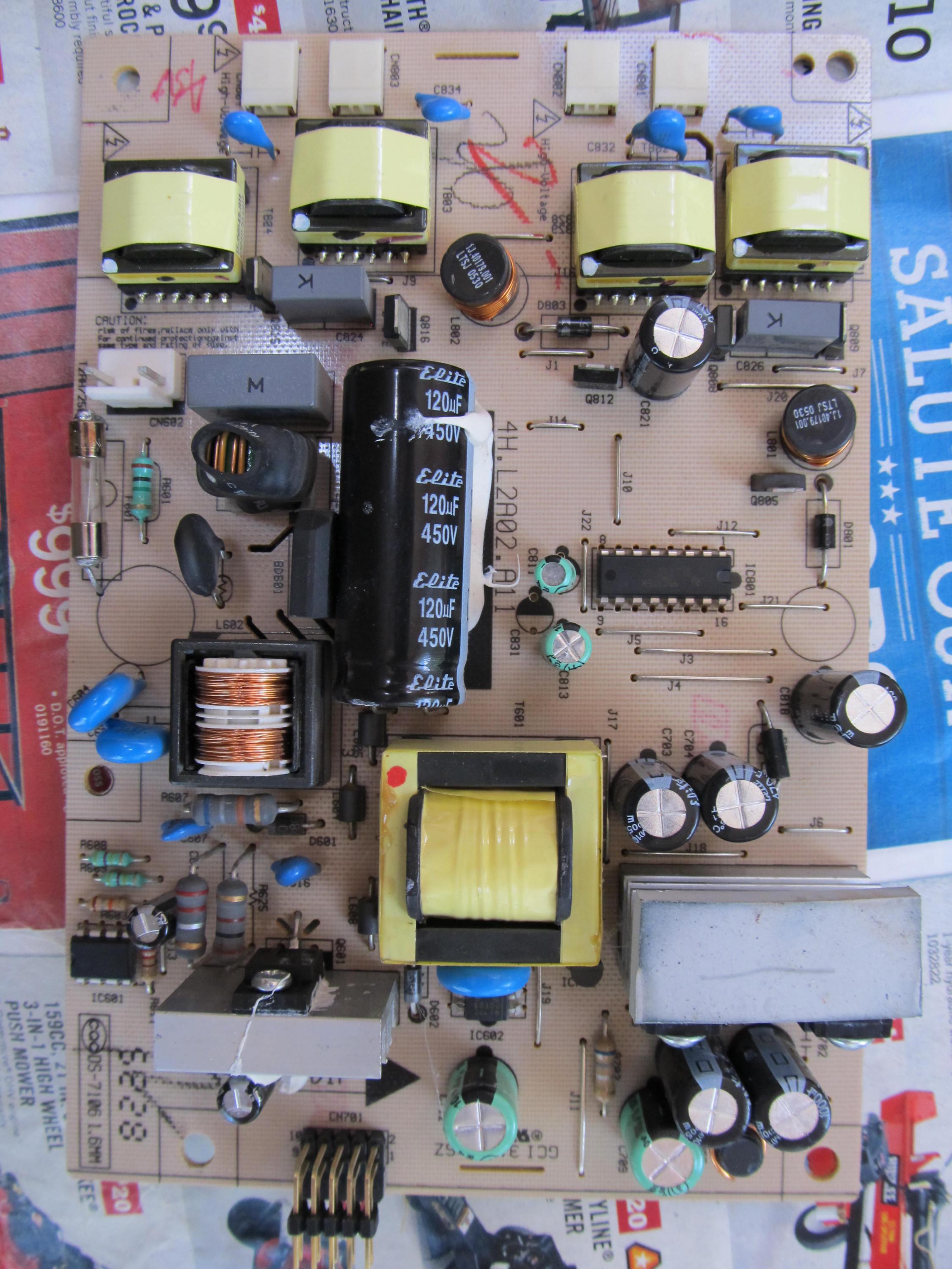

    Yes, It is a pain. I don't see how you guys can show the patience you do when helping people. Ok,,,,,,,,,the resistance between 1 & 2 is 11.0 ohms on the 200 meter scale. The resistance between 3 & 4 is 01.1 ohms on the 200 meter scale. Not sure if you wanted me to check anything else you had marked on the board or not. Do you still need another pic? What section of the board?
      #62
      Re: Dell Monitor has "No Power"!!
      OK, #1 marking (LINE IN) is connected to the Thermistor (10 Ohms Thermistor?, you have to look) and line filters and then to the AC in (#2 marking) in of the bridge, the #3 marking (NEUTRAL IN) is connected to the Line filters and then to the Bridge AC in. So you should have 120VAC right at the AC1, AC2 pins of the bridge, verify that, then you should have 165VDC right at the two legs of the main filter cap, NOTES that, when you work int he primary side of the circuits, you cannot use chassis ground as the ground ref point for measuring DC voltage of the primary side of the circuit, the negative leg of the main filter cap is the DC ground ref point.
        #63
        OK, I have 125V across ac1 & ac2.
        I have 172V dc at both the caps

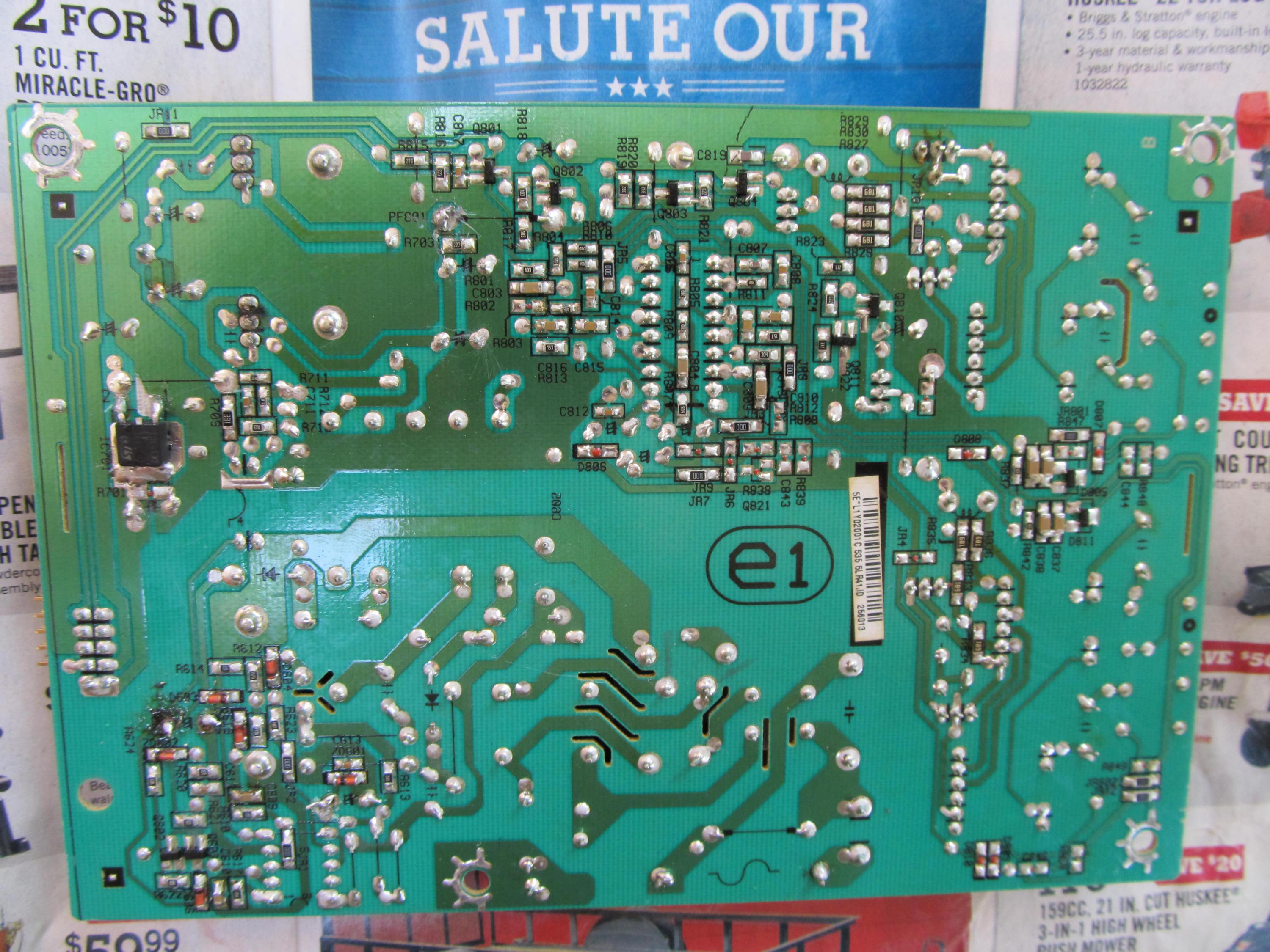

          still no updated bottom picture ?
            #65
            I don't understand what you want, bottom picture?
              #66
              HI
              I asked if you could post a new picture of the bottom of the power supply in post 39
              I am trying to see what you soldered and if you might have possibly caused an arc of some kind somewhere that may have popped the fuse
                #67
                Ok,,,,,I couldn't get a ceramic AC fuse in the right range, so I purchased a glass fuse and soldered wires on the end of the fuse, to attach to the board. It seems to work ok. On the other fuse, I just unsoldered the end towards the heat sink,,,,,,,,checked for voltages as you told me, finding none, I resoldered that end back into the board, as you told me. You can also see where I changed the two caps, they are now black, and the regulator. That is everything that I touched.
                  #68
                  there is an arcing mark on that 16volt diode
                  Recheck that with the ohm meter from center pin to outer pin
                  Please clean the residue around your soldering
                  alchohol may work
                  lacquer thinner might work better.
                  did you use flux ??
                  or was you iron a weak one ??
                  I ask because the solder does not look like it flowed well
