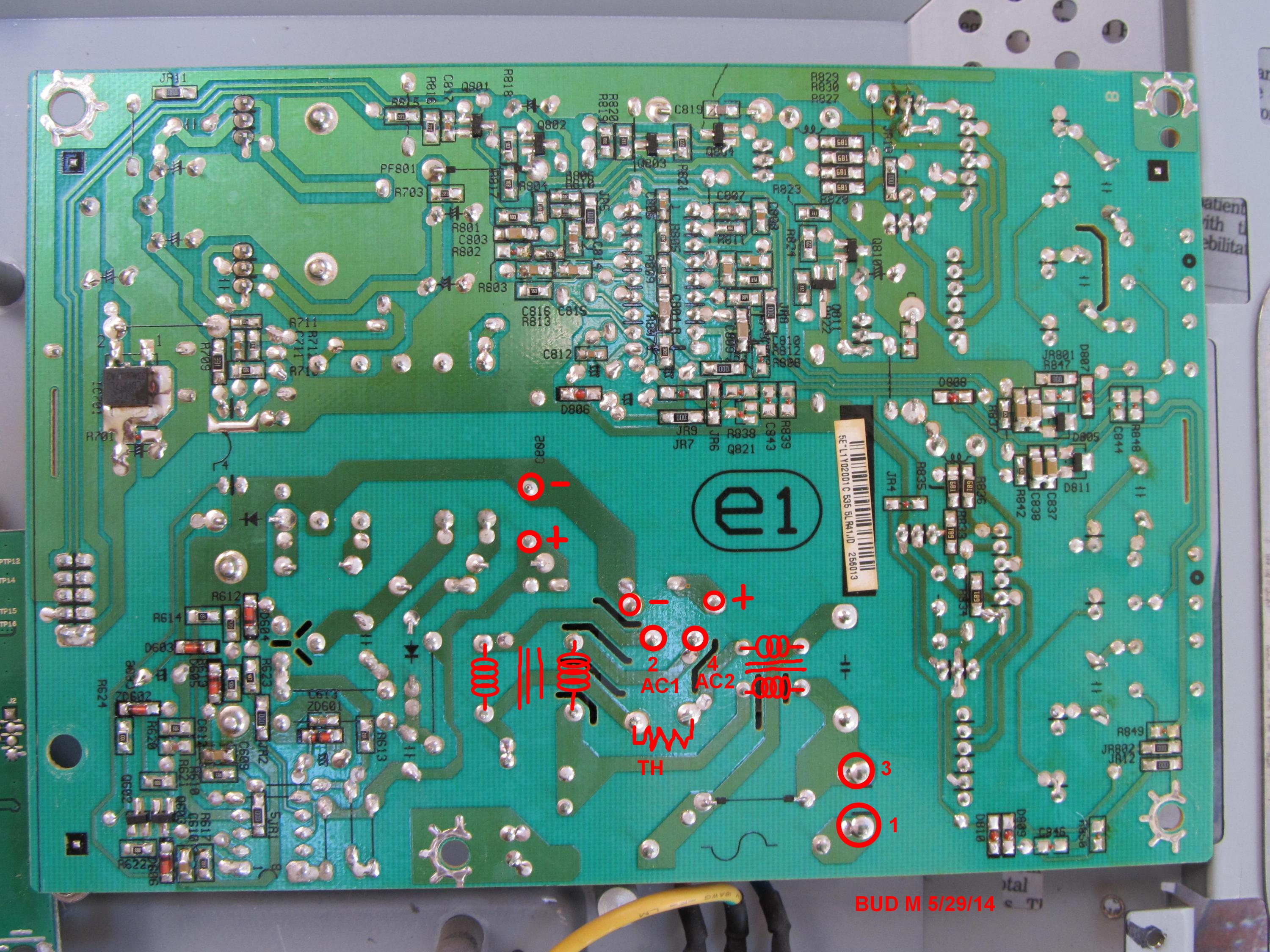

    OK,,,,,with boards disconnected. The five pins that go to the second board, 1st pin 3.3V, 2nd pin 5V, #3, 4, 5 zero V. The 3 caps, #1 5V, #2 15V, #3 3.2V. Between pin #1 and #2 on IC701 5V. The two diodes on the big heat sink now show 5V, and 16V.
    With the boards connected, on the 5 pins to the second board, I got .4V on the first pin and zero on 2, 3, 4,and 5. On the 3 caps, I got zero on #1, 54V on #2 (rechecked a couple times), and .3V on #3. between #1 and #2 on IC701 was still 5V. Now, I'm not sure I believe this, but the diodes on the big heat sink shows zero and 55V. There are 4 separate plug ins that go around the edge of the monitor, I guess those are to the back lights? I've had these disconnected ever since I took the monitor apart. Does that hurt anything with the voltage measurements? I see the wiring harness (bunch of wires together) going from the small board to one spot on the back of the lcd, I guess this is the the harness from the VGA board? It's been plugged in while I was testing voltage.

            OK guys,,,,,I told you I'm a amateur. My Bad! I have everything laying out on a table and I just realized that I had been turning the small board "upside down" when I connected the two boards together. That might explain the weird voltage. OK, I did it right this time, I think. Power board disconnected from the small board. 2 diodes on the big heat sink - 5V and 16V. Voltage on the three caps - #1 5V #2 15.9V #3 3.3V. Voltage between #1 and #2 pins on the IC701 - 5V. Voltage where boards connect. #9 & #10 3.3V, #7 & #8 5V #5 &#6 zero #3 & #4 zero and #1 & #2 zero
            Now with the boards connected "the right way"! 2 diodes on heat sink 5V and 30.7V, the 3 caps #1 5V #2 3.8V & #3 3.3V. IC701 voltage between #1 & #2 pins 4.7V. Now voltage where boards connect #9 & #10 3.3V, #7 & #8 5V, #5 & #6 zero, #3 & #4 zero, and #1 3.3V & #2 1.8V Don't know why the last two pins were different when all the others were the same. Finally, I think this should be the right voltage. Sorry for screwing you guys around, but didn't realize the mistake until I started looking closer at the pins connecting the two boards

                well, flipping the board over was shorting out the 5 volts and shuuting it down
                But it does not appear to have killed anything
                No the issue seems to be on the pin 2 voltage of 16 volts jumping to 30 ??
                "2 diodes on heat sink 5V and 30.7V, the 3 caps #1 5V #2 3.8V & #3 3.3V"
                SOMETHING WRONG HERE 30.7 on diode and 3.8 on # 2 cap ???.. They should be almost identical
                on the two pins that are different 1 & 2(these are supposed to be different) one is the dim and the other is on off and the on off
                DID YOU EVER REMOVE THE pf801 FUSE THAT I MENTIONED in post 39 ???

                          Well
                          You may have accidentally popped the main fuse at F601 ?
                          set your tester to 200 ac and check the two wires on the power plug with the blue and red wire. Should read 110-120. If it read negative, reverse your test pins. Then leave the black test lead where it is and use the red probe to check the fuse at each end.
                          OR, disconnect power plug and use the ohmmeter function ar 20K and probe both sides of the fuse to see if you get zero.
                          If the fuse is ok, there is a chance that pulling the fuse made the one diode that was showing 16 then 30 finally give out ?
                          Again with power unplugged
                          This you would take a look at with the ohmmeter with the red tester plug on the center pin and the black one one of the outer pins. If zero, it shorted out, if it builds up resistance that should not be shorted.

                                        can you post another picture of the bottom of the power supply
                                        Maybe I can see what may have happened
                                          #60
                                          Re: Dell Monitor has "No Power"!!
                                          OK, check and report the resistances between 1 & 2, 3 & 4. Make sure to report if it is in OHMS, K OHMS, or M OHMS as shown on your meter.
