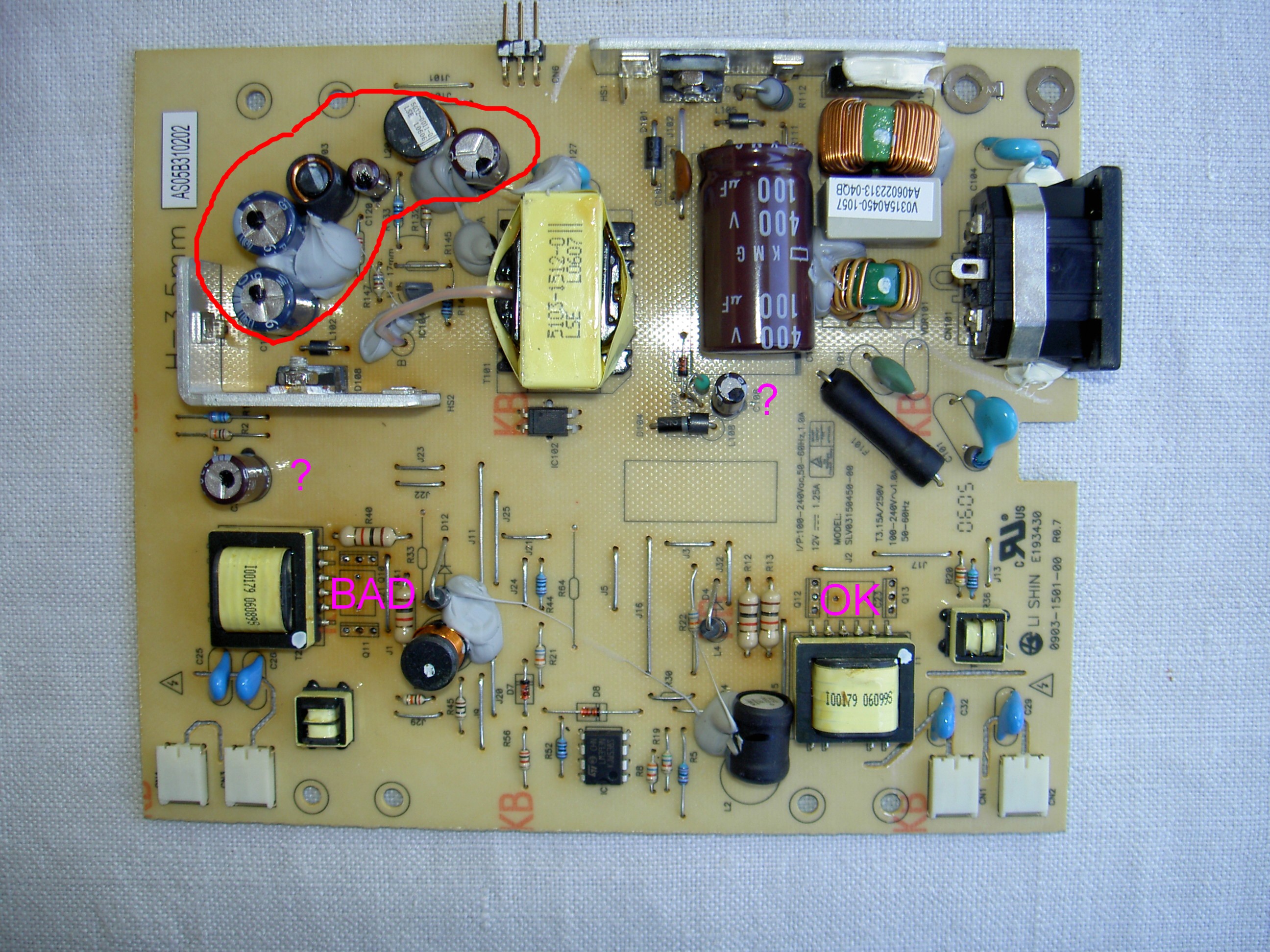

        Ok Budm,
        I made a photo
        In red the condensers which are before D108. It is a s à high voltage power rectifier. He has to feed both Royer Oscillator (inverters).
        Transistors on the right was OK. Those on the left not
        Normally caps in the red circle must be good
        Rest C3 and C108 has to change
        I am clear ?
        It is right ?
        Thank's for you answer.
        RGB
          Re: Wiewsonic VE710b black screen Flashing
          Please also check 0.22uf condensers between the 2 C5707 transistors.Defective capacitor will cause transistors to overheat.

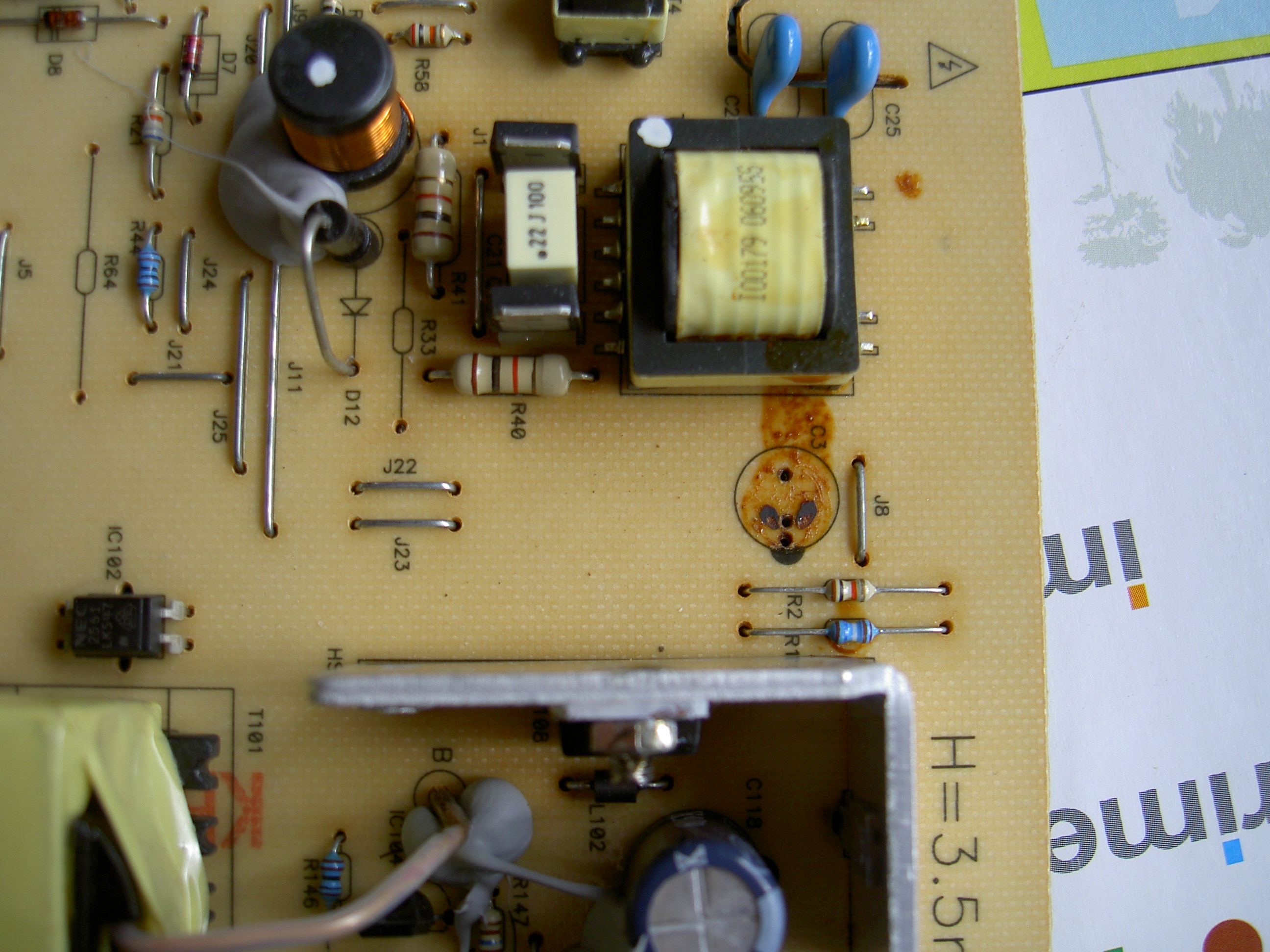

                I resoldered the two inverter transformers.
                I measured the two yellow caps: 0.211 (scale 2uF).
                I changed C3.
                Good day for you.
                RGB
