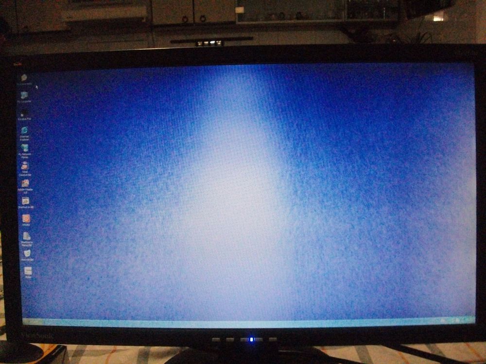

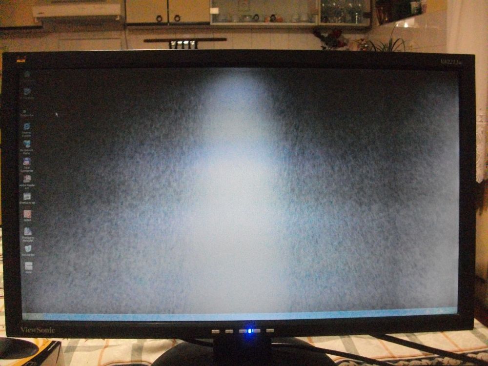

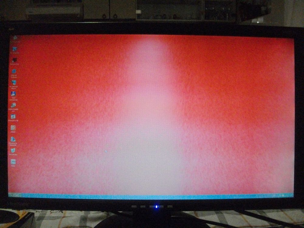

    Viewsonic VA2213W, there is an illumination problem, in the middle of the screen, images attached.
    I visualy checked the power board and main board, there is no bulged capacitors, no burnings, everything looks normal, and quite good.
    I dont have ESR meter, only digital multimeter, but I didnt measured any voltages.
    I found service manual, also in attachment.
    Where to start looking for the problem ?

    Did you have the set before the fault
    Have you tried it on another cable vga/ dvi
    Have you tried another screen on the pc
    Remove clean and replace the cable to the tcon (if it has one)
    Post Good clear picture of the boards invluding tcon or panel board
    May be a faulty panel

      Re: Viewsonic va2213w illumination problem
      I dont understand what You mean
      I tried both in first place
      I will post images later

        I meant
        Did you own the set before the fault - have you seen it working correctly.
        Did it just come on like that one day - just a history of how the fault developed.
        • ciki022
          • Nov 2013
          • 48
          • Serbia
          No, I dont own it, it is my friends property, and I will ask him about the fault

            I've never seen this defect. with all hooked up and monitor opened detach the lvds ribbon conn. and see if the white light is uniform, 90% is not lamp problem, but sadly, if is not that i think is a panel defect very much difficult to repair (since i don't see very much knowledge about panel problems here, documents in the web are few).
