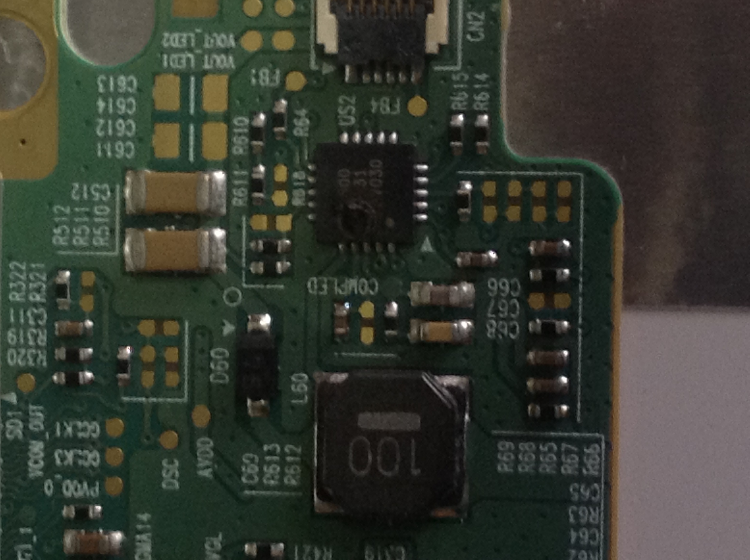

    need help identifying a component please
    Hi this is a 15.6" LED laptop screen LP156WH$ (TL) (CL1).
    Pno: 6870s-1128a
    lp156wh4-tla1
    Ic: US2.
    The screes is working but no backlight.
    Any help would be much appreciated

    Re: need help identifying a component please
    What laptop is it off?
      Its from a hpg6 but this is the screens pcb not the motherboard, the schematics dont show the LED screens pcb.
        Ok thats where I was going - Is it burnt? Can you clean it up with Isopropyl Alcohol and
        read any more numbers off it?
          Unfortunately no its already cleaned with IPA.
            It may be a proprietary part anyway but can you list the numbers you can see.
            in the same grouping eg
            Top line *****
            nextline ***** and so on
              Sorted I had an almost identical board I had cut from smashed led screen and its a Sm4500 (da1116) QFN20 Power IC Chip Chipset I repaired the damaged track and transplanted the chip and Backlight working again..Result
                  It blew again after about 20mins so not sure if its the led backlights or laptop itself, back to the drawing board on this one.
