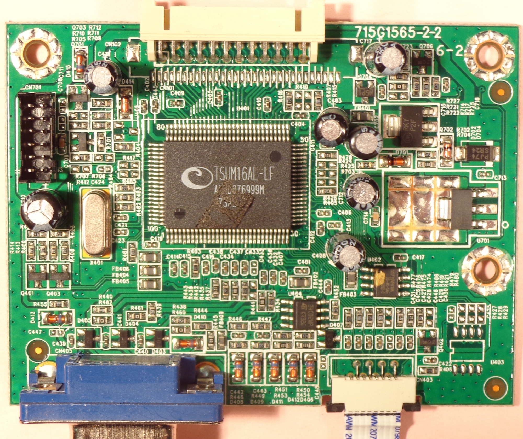

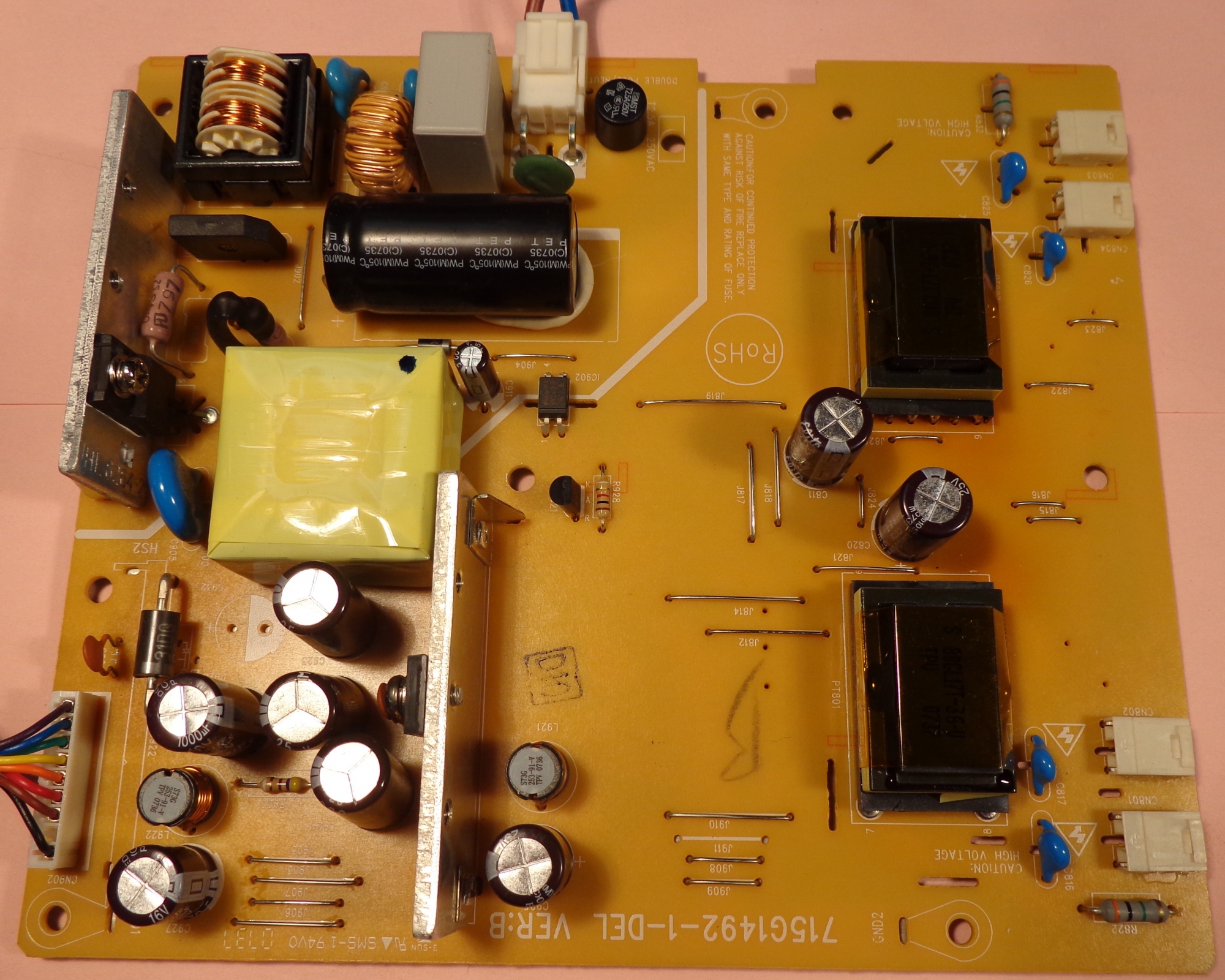

    I have a Dell E178FPc Rev A00.
    The only thing that visually works is the green Power LED. It cycles on/off correctly as button is cycled manually. I have the monitor connected to a known good PC. Screen never changes from black and I even tried the flashlight thing I read about here and see nothing.
    I have attached photos of the boards and one of connector CN902 on the Power board. All the capacitors look fine and I checked all of them with my "blue" meter and the values look ok to me. I will repeat and report all values if advised and am willing to replace all the caps, but I don't want to unless necessary.

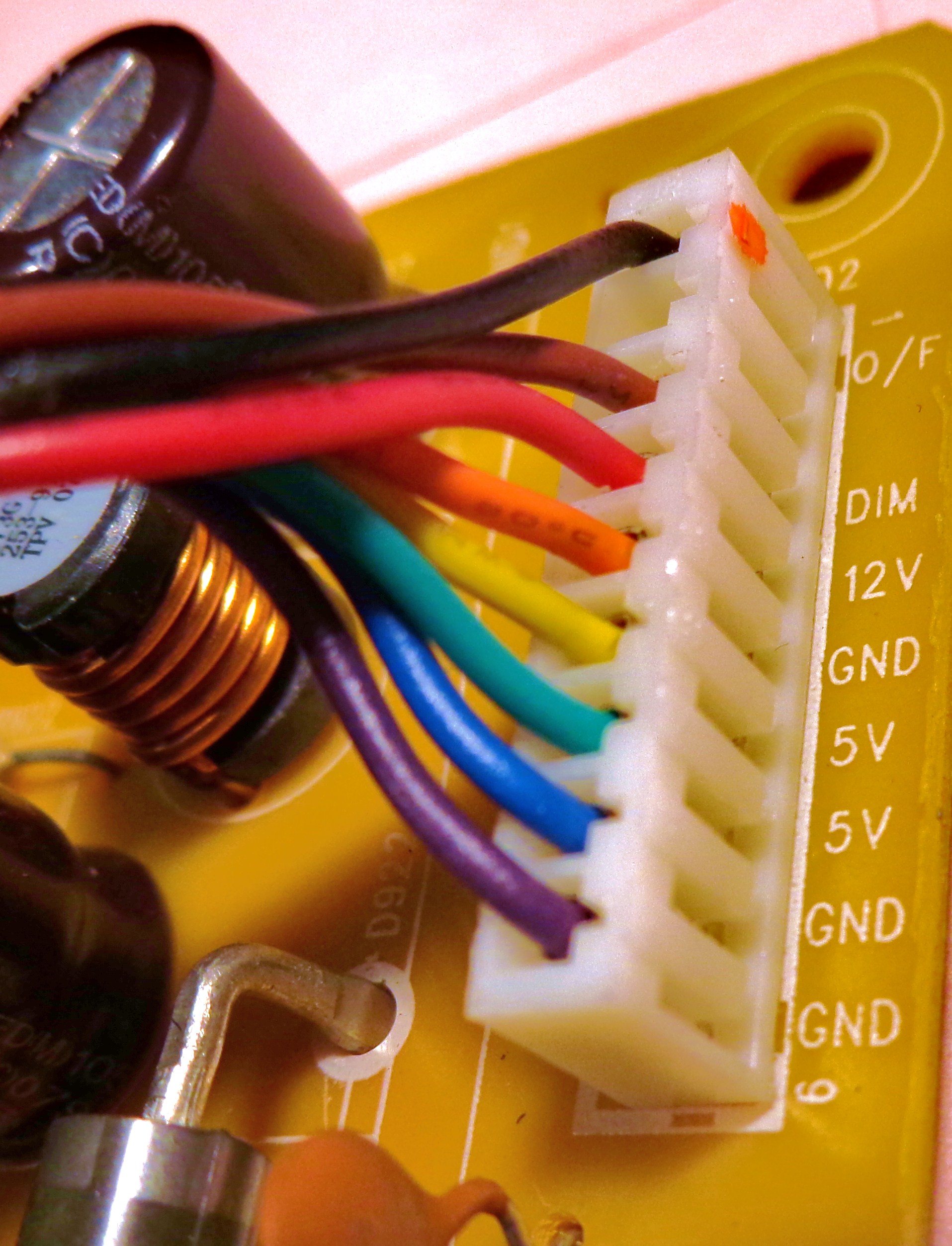

    I have measured DC voltages at CN902 and will list them. Pin 1 is O/F and Pin 3 is DIM and I do not know what O/F and DIM mean, so would appreciate knowing.
    Pin 1 - O/F - 2.795V DC
    Pin 2 - Blank
    Pin 3 - DIM - 4.360V DC
    Pin 4 - 12V - 14.60V DC
    Pin 5 - GND
    Pin 6 - 5V - 4.892V DC
    Pin 7 - 5V - 4.892V DC
    Pin 8 - GND
    Pin 9 - GND

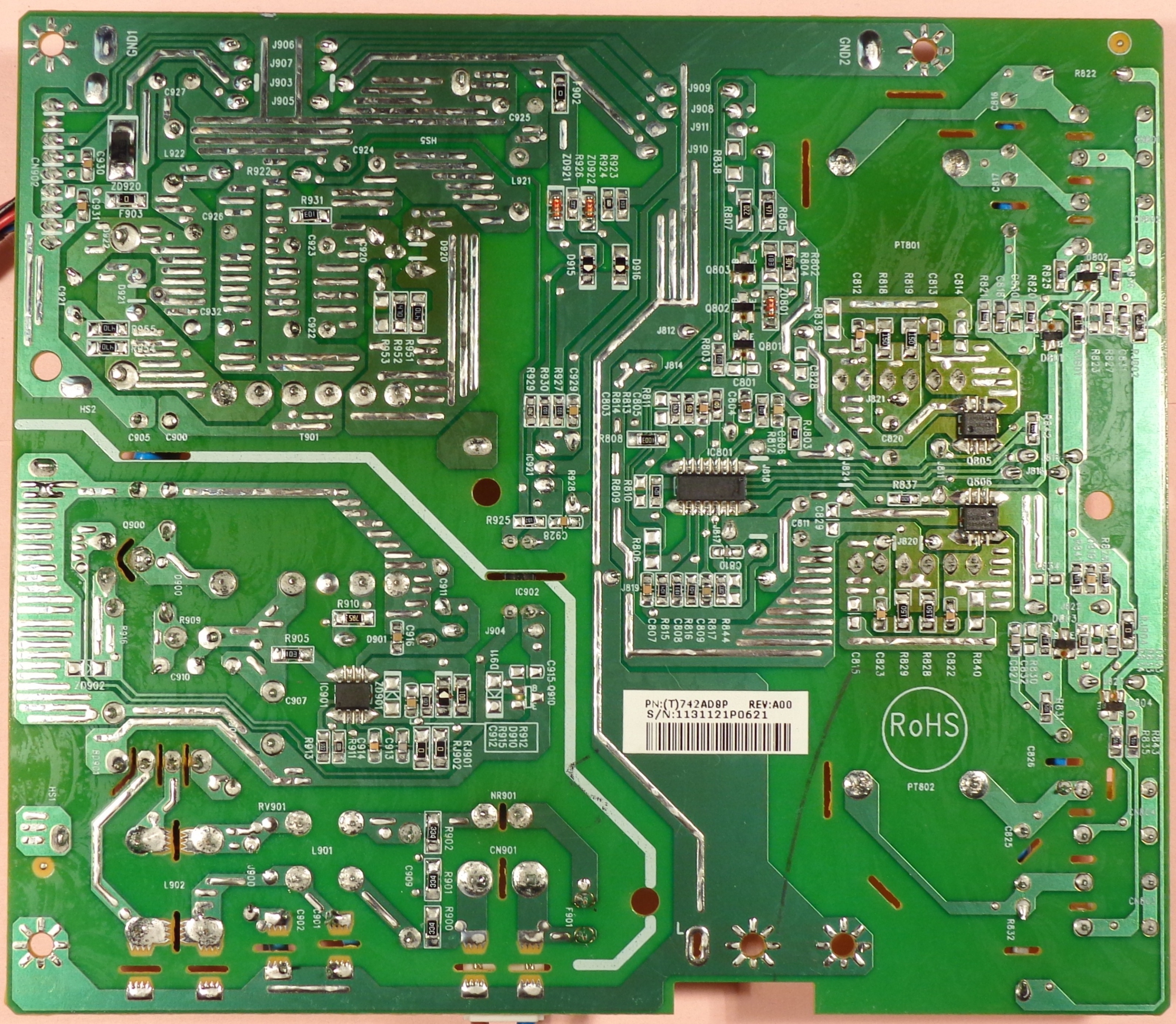

    Hmm-- On the back of the power board there are two items labelled F902 and F903 they are actually zero rated
    resistors but can you test them as you would a fuse. Power off Meter on ohms 200
    one lead on each end of fuse. May also be a an F901 but havent found it yet.
    One is at top left corner then scroll across halfway is the other

                    I will have to look over the pictures of your board, more likely the problem will be in the inverter section.
                    Base your post:
                    Pin 2 - Blank
                    Pin 5 - GND
                    Pin 8 - GND
                    Pin 9 - GND
                    All the signals are correct.

                      Q805 and Q806 are APM9945.
                        Re: Dell E178FPc-Only Power LED
                        OK, check the resistance reading on betweem S1 (pin 1) and D1 (pin 8), S2 (pin 3) and D2 (pin 5).
                        See the spec sheet.
                            OK, you are just see the caps being charge, what we are looking for is resistance of less than 200 Ohms. So the MOSFETs are OK. I need to look further on your board. There is the PWM IC (IC801, close to the MOSFETs) that drive the MOSFETs, can you read the numbers?
