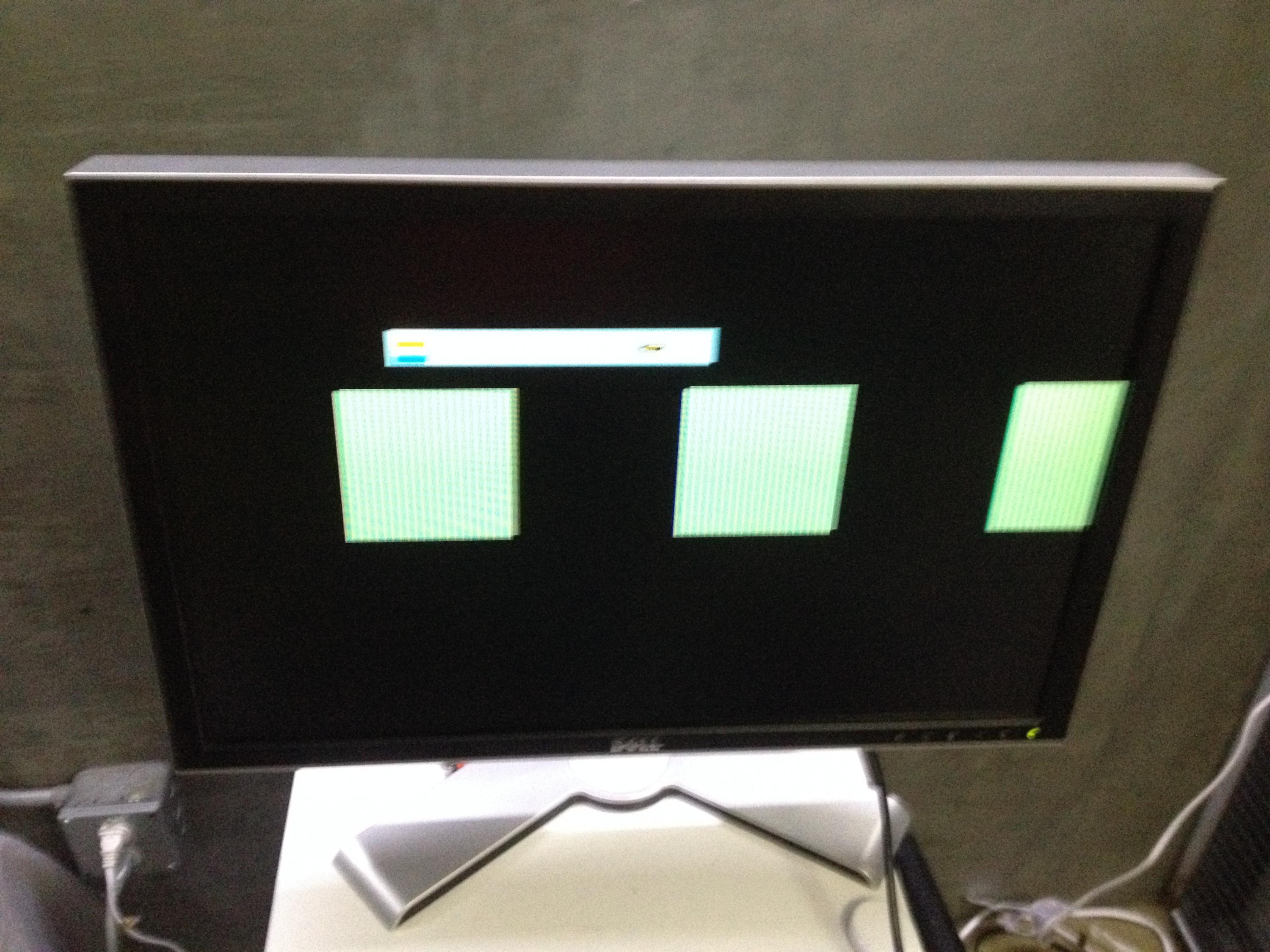

    My monitor has these boxes on it. I took it apart and looked at the capacitors I don't see anything wrong... Any help would be appreciated!

    Perhaps a picture of the insides would be useful to us?
    The one you have provided is out of focus.
    Try the monitor on another source/PC/Laptop
    Try with a different cable vga/hdmi/dvi
    Try a different monitor on the current source
    What were you doing before it went like that.
    Have you soldering eqipmment and multimeter and can you use them.
    Which threads have you already read?

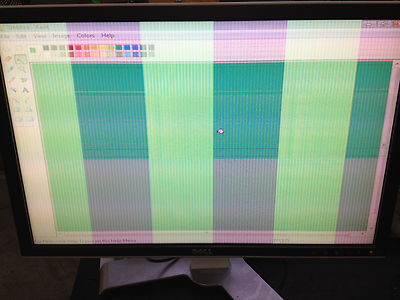

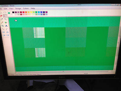

      I repaired 2 of these Dell 2408wfp's with a similar looking problem about a year ago. In both instances it was the T-Con board. Basically the lcd screen showed blocks, and distorted vertical lines. I'll post the pics of them. I had to get the part number from the T-Con board. Managed to find some place in China that sold them (can't remember which outfit). And they took 3 weeks to arrive. I think they were $35 each new. Maybe they are more readily available now.

        Hi, do you find that one of the few ic's on the tcon board seems to warmup too much?

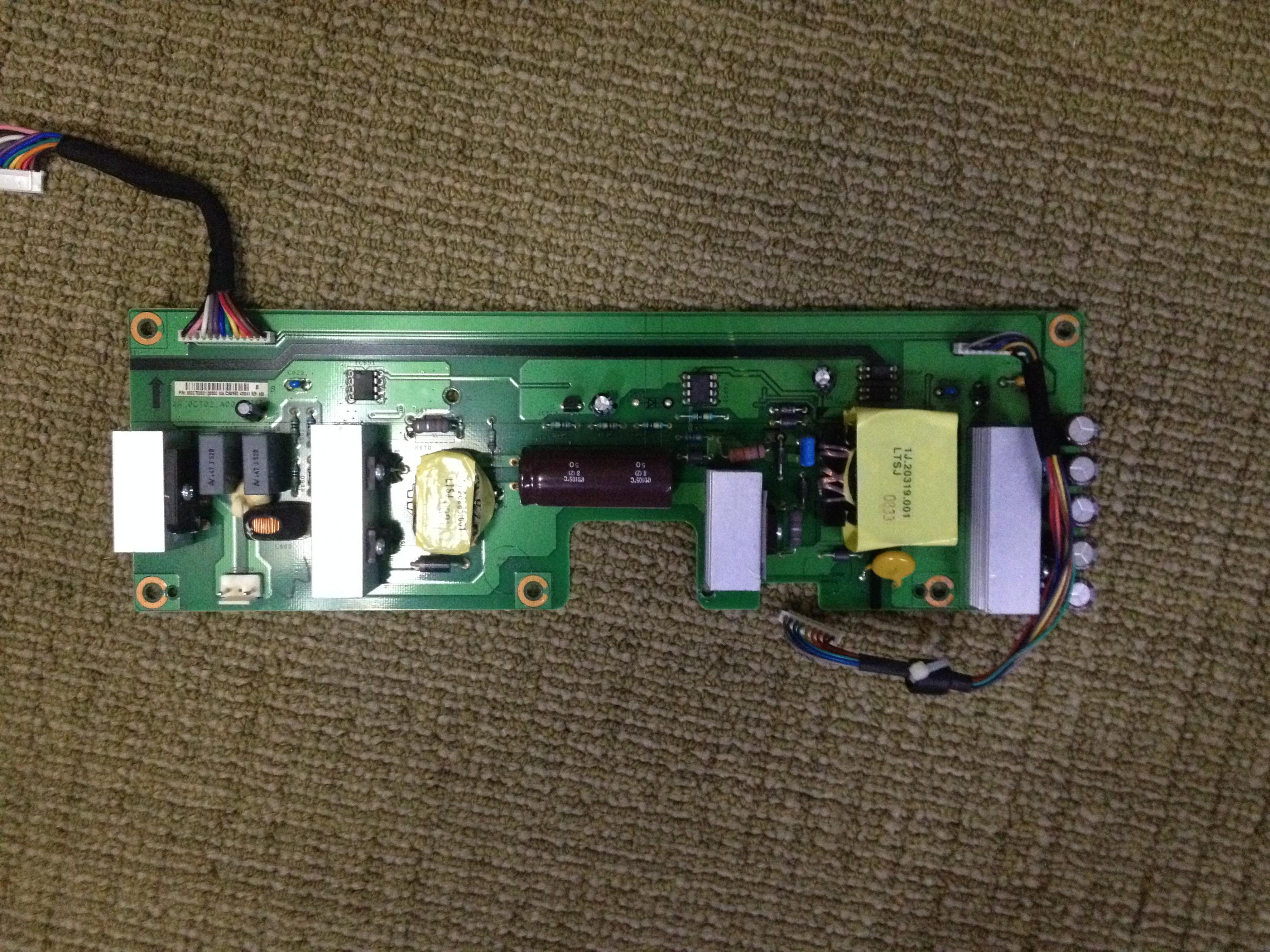

                Here is a picture of what I think is the t-con board.

                    Okay I found the tcon board LTM240CS05FFCC4LV0.4
