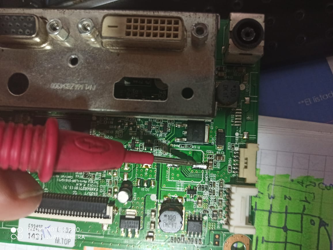

            Good morning, I received this plate without the capacitor it brings and aside from the raised track, could you specify where the positive of the capacitor is connected to? since I don't have the schematic

              The clipped corners is the positive, if you look close near the white outline there is also a "+" mark
