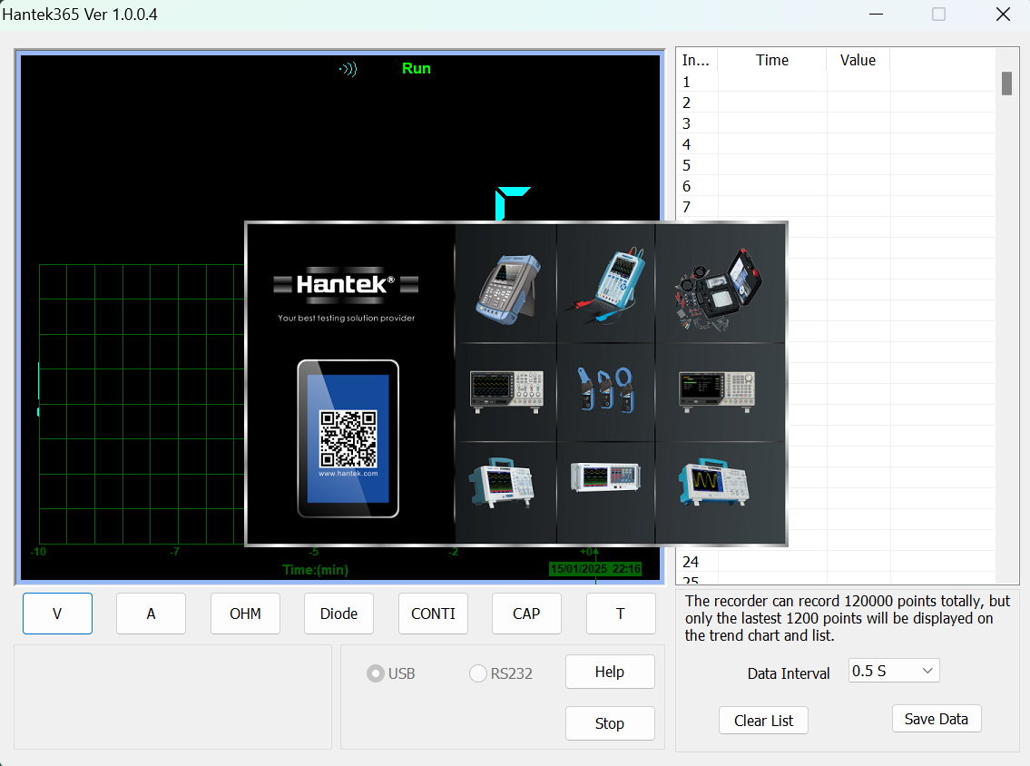

    every time I open the tool, I have the screen that appears
    and I am always in a hurry to use it so I click and it automatically sends me a link to the manufacturer.
    It annoys me lol.

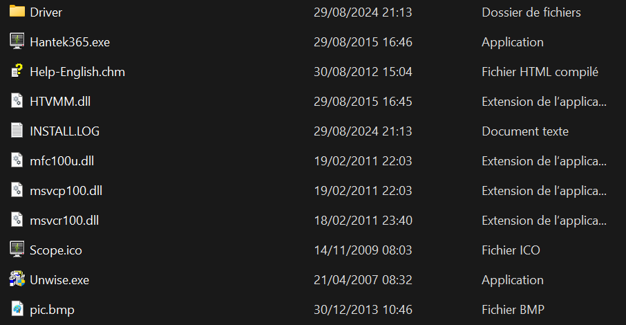

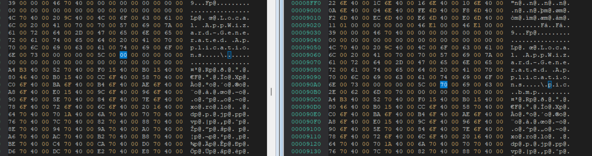

    2 solutions to remove it.
    Either you remove pic.bmp and it no longer appears so no more links when clicking.
