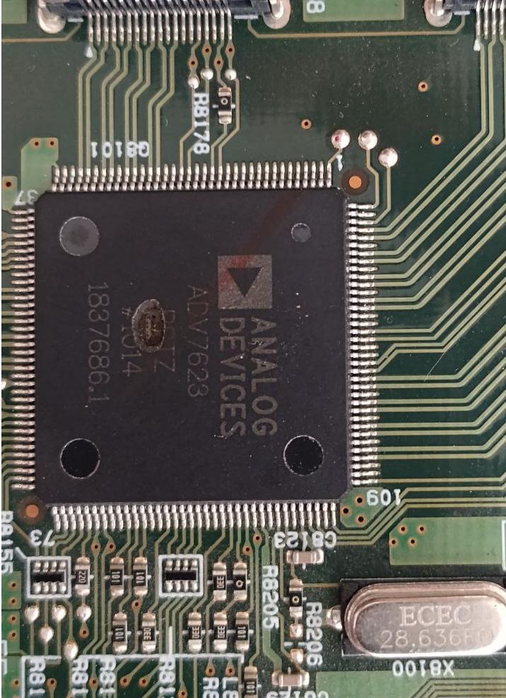

                            I found some chips on the old MB and it was much better (although I'm still not satisfied). I am adding a few photos

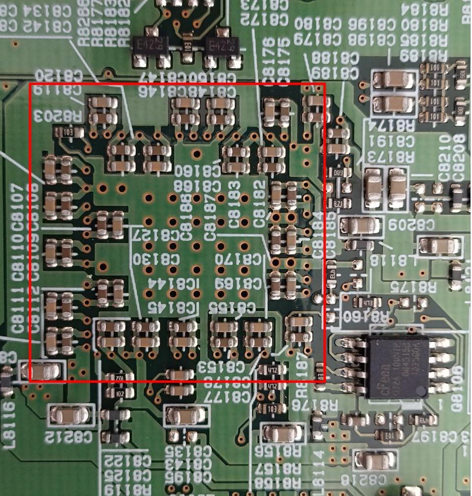

                                As you can see in the picture, I really need to replace this chip, but there are some SMD resistors and capacitors on the other side of the board. I'm afraid that when I heat the chip, the SMD components can be removed from the board. Is it necessary to secure the parts with some kind of tape, or will the heat on the other side of the board not be at such a temperature that the parts will fall out of the board?

                                  Whenever you see the bunch of via grupped behind chip, it indicate that that ic probably have ground plane pad on center connected to board... so you expect trouble. Make a very good photos of that area, and do some measurements, note, say value od caps, shorts and soic8 all leg in diode mode and write that on picture... this value can use to compare it after work was done.................. When solder liquified, its surface tension hold component on place. In that state you must be very careful to do not touch any component, run hotair excessively on it or shake the board. If the board lay on desk on component side, you have to do some support that lift board from desk to not interference with bottom component. Do not cover it with anything on back side, but from heating side protect with metal shield (can of cola) electrolitic caps and connector and other valuable stuff.

                                    I already bought a replacement chip (2x to be sure) and it doesn't have a grounding pad.

                                      I don't like it at all
                                      I heat the chip with hot air and nothing happens. I set the temperature to 380°C and heated for 10 minutes. Then I increased the temperature to 400°C and heated for another 10 minutes. I don't see any solder melting. I increased the temperature to 420°C and nothing even after 10 minutes.
                                      After 30 minutes I resigned.
                                      Am I making a mistake somewhere?
                                      I was already warned that the metal surface can be soldered to the board from below. However, I have bought new chips and there is no metal surface on the chip.
                                      Specifically, it is a chip (see picture above) ADV 7623. It is an onkyo home theater page number. 13

                                        Can you confirm that a thin wire like 0.1mm go from one corner to another diagonaly, like red drawing. If you have trouble putting it after chip, drag it behind legs like green drawing and pull up it to straight. You can determine if on center has barier observing lenght of wire.
