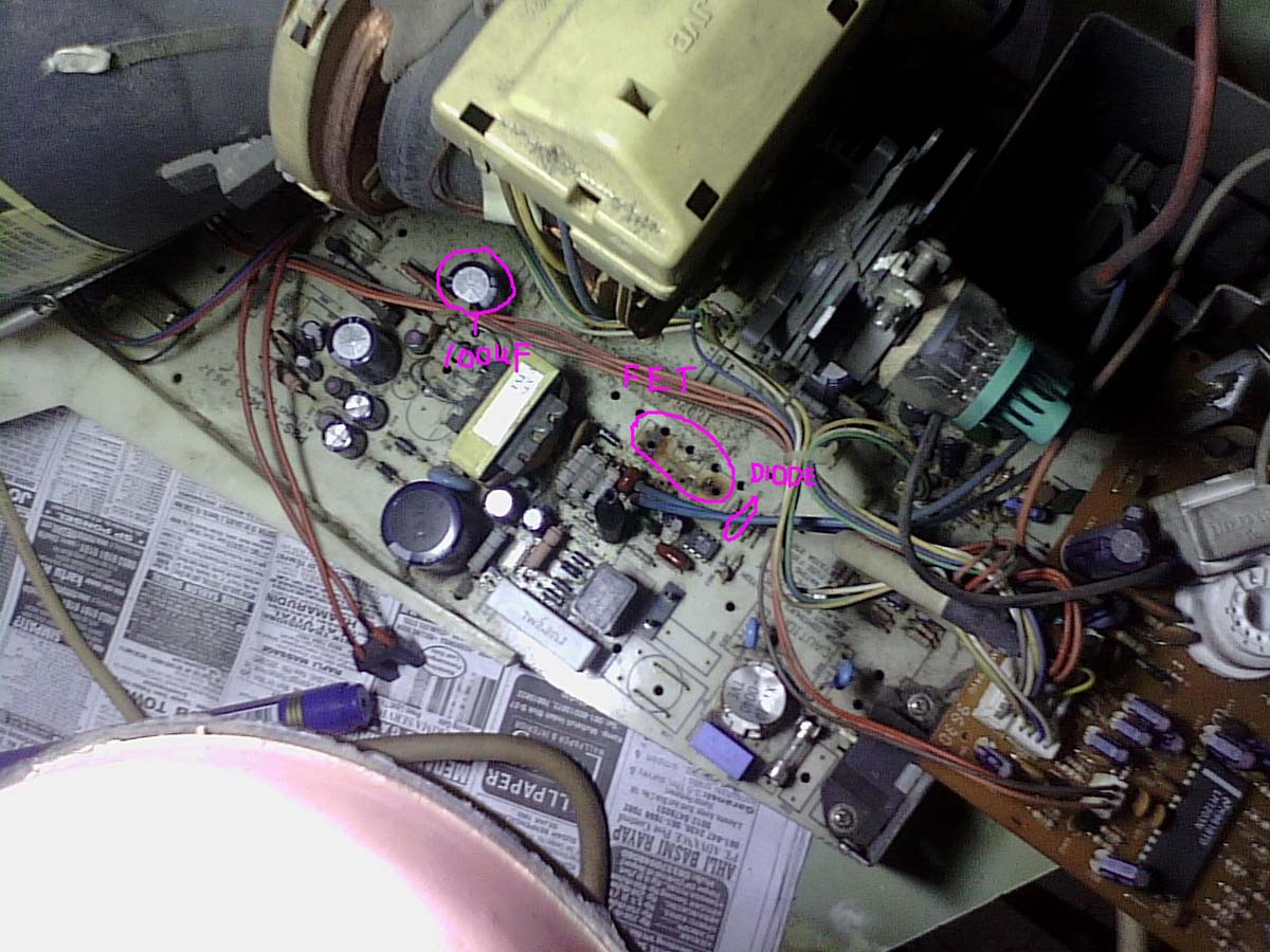

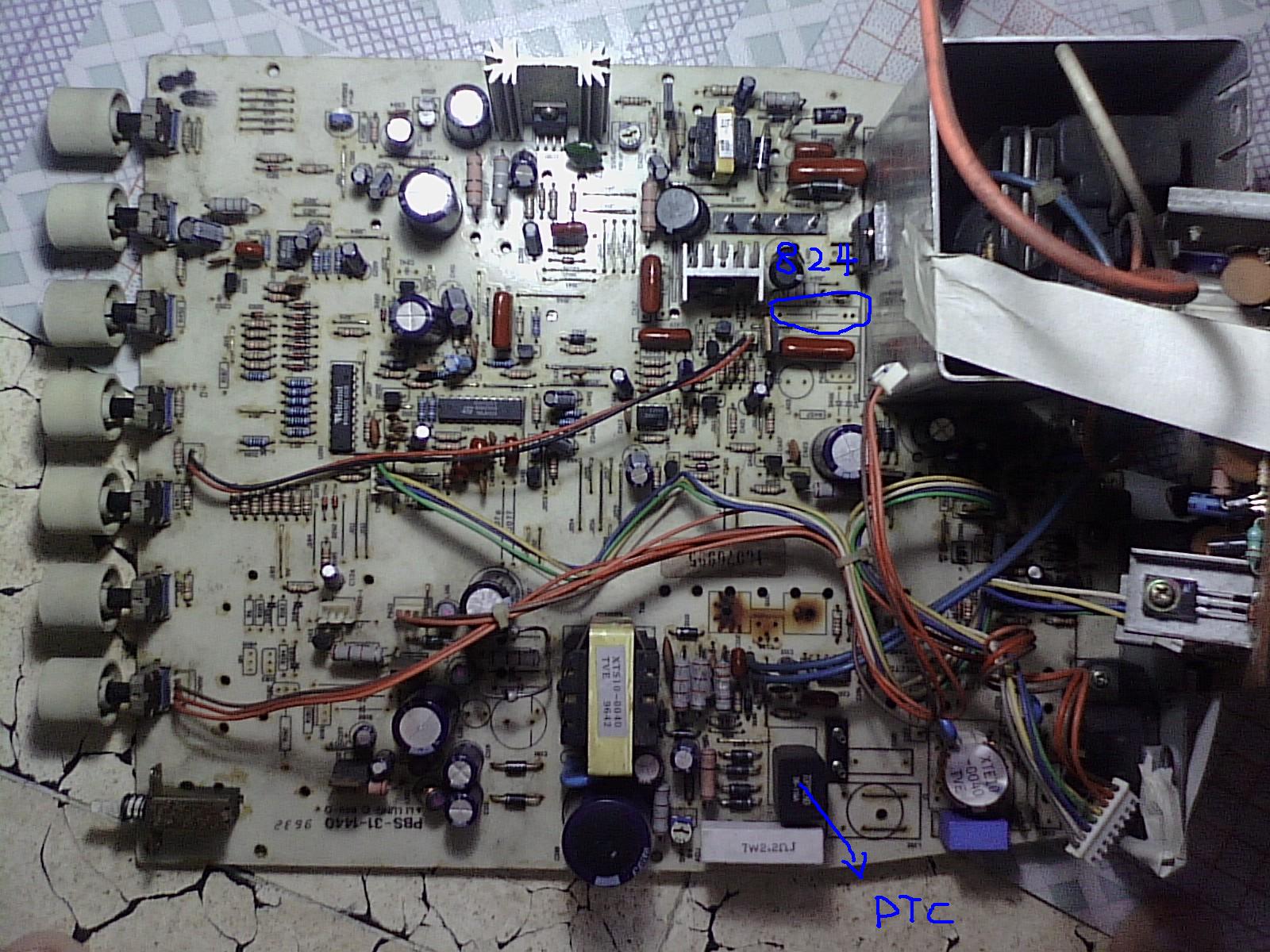

    Good day everyone.
    I have this CRT monitor laying down in my warehouse so I am just try to fix it, after makes some effort to dig into CRT monitor troubleshooting knowledge, I am open it up , discharge tube and looking around mainboard and RGB board.
    The symptom of monitor : no picture, no sound, not even led on power button lit.
    After open it, found these :
    1. Open Fuse
    2. Fryed FET = MTP6N…. (can't see rest number ,cracked on right side) on primary PSU
    3. Burned and changes color almost black, polyester caps = 842J 400VMpp right beside HOT
    4. Shorted 1N4148 diode on primary PSU
    5. High ESR value lytic 100uF 160V
    6. Nothing else were look abnormal include good physic of flyback transformer.
    What I have done because it just look like a PSU symptom but not to overlook :
    1. Changes diode and fuse with same rating and number also buy new replacement.
    2. Changes badcaps with Rubycon 220uF 160V.
    3. Checks all component near fryed FET trace include 4 mains diode rectifier, others is okay.
    4. Checks primary winding PSU transformer and near HOT (didn't know exactly function of this circuit) with flyback tester no problem.
    5. Checks HOT and flyback B+ and Collector (primary winding) with flyback tester no problem.
    I have buy FET with number code FQP6N60A because guess it was MTP6N60, couldn't find 824J 400V caps on my town.
    So after this, I want to ask question from this amazing forum members.
    a. Could I changes with this FQP6N60A FET?
    b. Instead 824J caps, I have two 474J caps, is this okay if I am make it paralel to change this caps?
    c. I have read about X-ray Radiation dangerous and haven't HV probe to measure the anode cup.
    How to avoid and adjust this X-ray Radiation with decent tester?
    d. Is there a problem changes badcaps with 220uF value (haven't experience on Monitor PSU)?
    e. Is there any chance on this case the PTC has failed? It couldn't measured with VOM.
    sorry for blurry picts from Android 2MP camera. any advice and suggest very appreciated please

      okay, since i read about fet replacement, it seems like i have to get a lower Rds, also lower input capacitance for replacement, but voltage and ampere is better to higher.
      i compare this 2 fet datasheet and it has 0,8 ohm difference and higher (not good), more resistance more power has to dissipate..
      I think this is not too bad since i am attach a new thermal grease on the heatsink, so i am soldering it in and replace all bad components. turn it on and power button led doesn't lit nor picture tube. try to figure out what happens....
      measure voltage across two diodes rectifier before rectifiering, got ~220VAC. so it looks my filtering and new fuse is okay. next step were trying measure across filter caps get ~290-310VDC so it looks like fine, tracing next from this caps, get a DC voltage on Drain Fet, Gate and Source no voltage, but after B+ caps it has series 100k 2W resistor and just ~0,7VDC i got and the trace is connected to pin 7 Vcc UC3842 PWM IC. I don't know exactly what Vcc voltage should i get for make output from this PWM IC.
      also try to measure secondary diodes, no voltage !! so it stuck on primary, didn't know exactly is PWM IC failed or not, so I am trying to draw this schema, i'll post this diagram later. question in my head is mosfet didn't matched or the PWM IC has failed? what do you think?

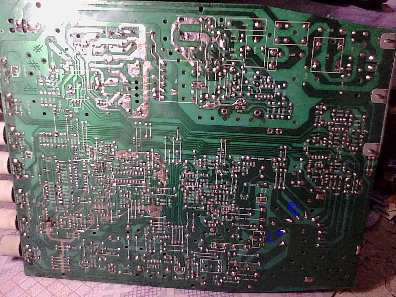

                        Yes. With the monitor switched ON of course. Test voltage output of those diodes. There could be negative rails depending on the design. The voltages are usually marked somewhere on the silkscreen on most monitors, can't see the pictures clearly so i don't know about yours.

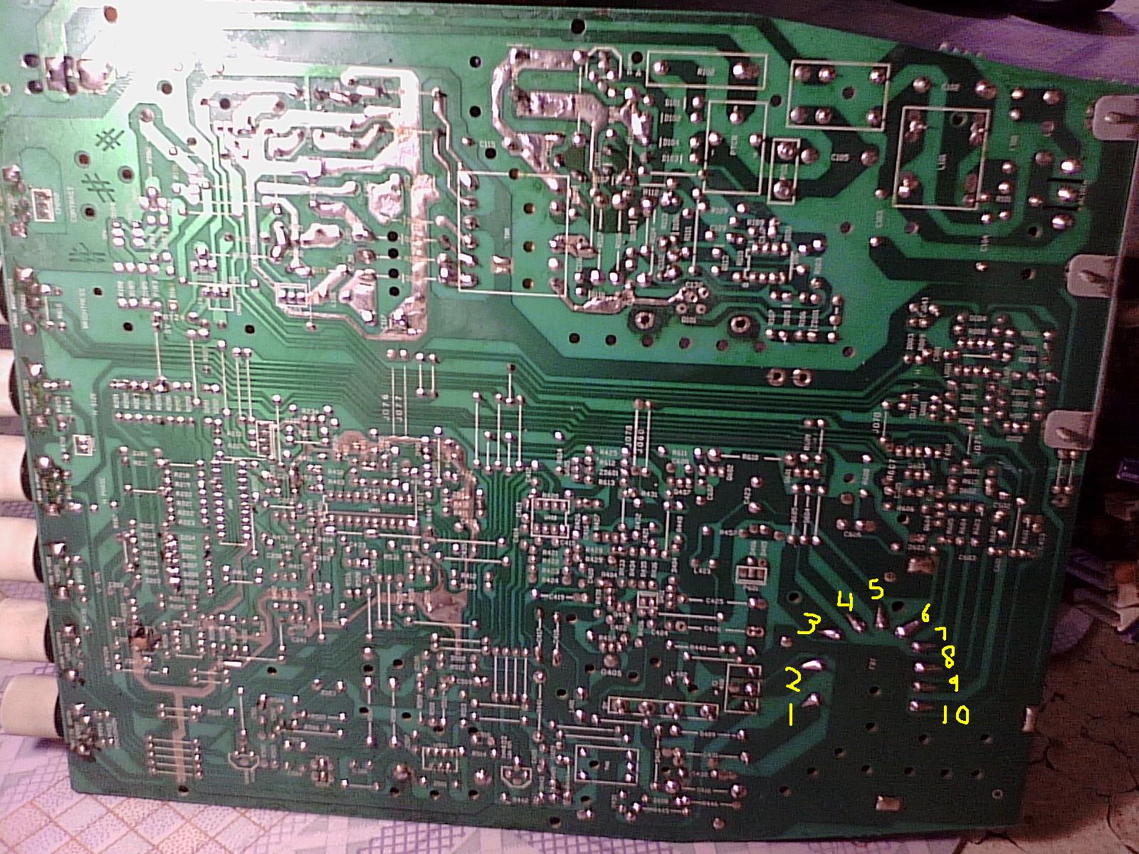

                        thank you for reply, well, i got this result friend as i upload the picture, I know this is dumb action, I am just measure all of pins and this is the result(maybe damage my meter, fortunately nothing was happened), some pins just connected to resistor so i think the no voltage pins have a trouble?:
                        pin 1 connected to C431, D409 and IRF630 = 100VDC
                        pin 2 Collector H.O.T= 100VDC
                        pin 3 connected to D605, tip127 = 100VDC
                        pin 4 B+, D604 = 100VDC
                        pin 5 (anode side) so it seems like no problem? = no voltage
                        pin 6 connected to VR Brightness (cathode side) = no voltage
                        pin 7 connected to R604 = no voltage
                        pin 8 = GND
                        pin 9 connected to R602, C601 = no voltage
                        pin 10 connected to R601, C453, R436 = no voltage
                        how do you think? I am just googling and that is many site mention about horizontal side when we have no picture symptom. any advice ?
                        I don't see any voltage marked on silkscreen. but i'll checks it again. sorry for blurry picture, but i don't have a good camera. just android camera or handphone camera.

                                    Just asking, did you plug in a signal source when testing? These monitors will not power on unless there is a signal input to them, and will stay off with power light on. The 820n capacitor needs to be exact value, as it sets a flyback value. The neon lamp trick will tell you if it is running with a signal input. Resolder the LOPT pins and the line output transistor, along with the connections along the base and the line driver side along with the low value resistors connected there. With the new chopper chip did you change the 100uF 25V capacitor that provides the supply to the chip, it will likely be close to dead now.

                                      Originally posted by jts1957
                                      Hold by means of insulated leads a bare bulb NEON lamp near flyback winding and see if it glows. That will safely tell if set has (AC) High Voltage or not. Hairs standing up on back of your hand/arm placed near the face of CRT as set is first turned on will tell if the set has (DC) High voltage.
                                      ok, because of language barrier, i didn't understand clear how to connect the bulb. would u give me a rough schematic? and what pins of flyback winding to connect with bulb?
                                      about back hand placed, I will test it..
                                      yes, I am plug this monitor vga cable to my CPU and nothing happened. It looks hard to find this caps on my town, but i'll try.
                                      where pins of LOPT pins and where pins of H.O.T to connects bulb? Collector or Base? Emitter is common ground as i see.. where is line driver side? I have see a low value resistor 0,33 ohm 2W near the heatsink. 100uF caps on secondary?
                                      sorry for this dumb question, it's hard to understand for me because im really new to this TV and have a bad english..
                                      thank you for your help

                                      • jts1957
                                        • Dec 2008
                                        • 38
                                        Re: Old school Fortune Magic Green 14" S/N 96097669 CRT
                                        NO actual physical connection. A quarter inch away should do (The closer to flyback the brighter it will light - IF AC high voltage is present. Many electrical supply stores sell these to test for AC at electrical outlet pins. Just separate the metal pins and insulate them with electrical tape
