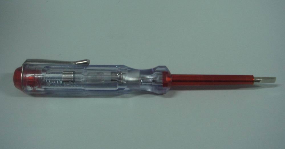

    On my town, when we want to test AC mains electrical socket HOT line use this tester pen.
    this could be use to connects it to anode cup to make sure it has a high voltage AC? I don't know this anode cup has a DC or AC, sorry for my ignorance..

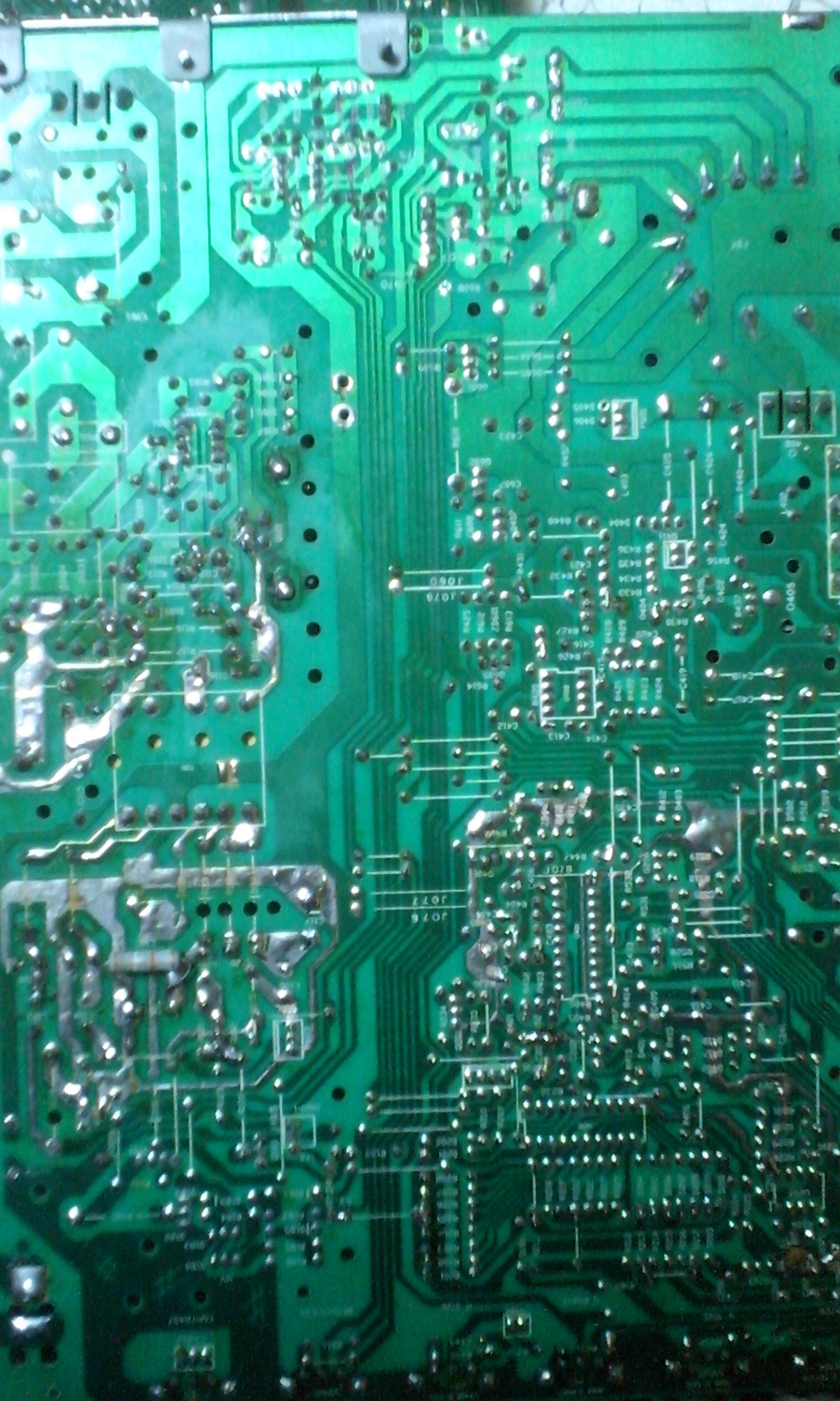

    and I am notice that trace before LM358 has a symbol I don't know what it means exactly. it has symbol = V, H, IN, OUT
    and i get the 12V voltage at IN trace directly from secondary PSU connected to Vcc LM358, but i measure the OUT trace and get no voltage.
    I am also measure 7812 voltage regulator at secondary PSU and get a 12V exactly.

      that pen may do the trick.
      i still have one i made from a plastic drink stirrer and neon glow lamp.
      the fully insulated handle is so you dont get bit if your fly or lopt has bad insulation and you draw an arc with it.

            The question in my head is nothing voltage to Vcc TDA9102 that connected from OUT mark on board LM358 circuit, but surrounding components were checked good, probably I miss something.
            I can't see any number model for this monitor on his case.
            but this main board has a code
            PBS-31-1440
            Li Lung C 04-0
            maybe this could give you any ideas? I have checked this number on googling, unfortunately I get nothing..

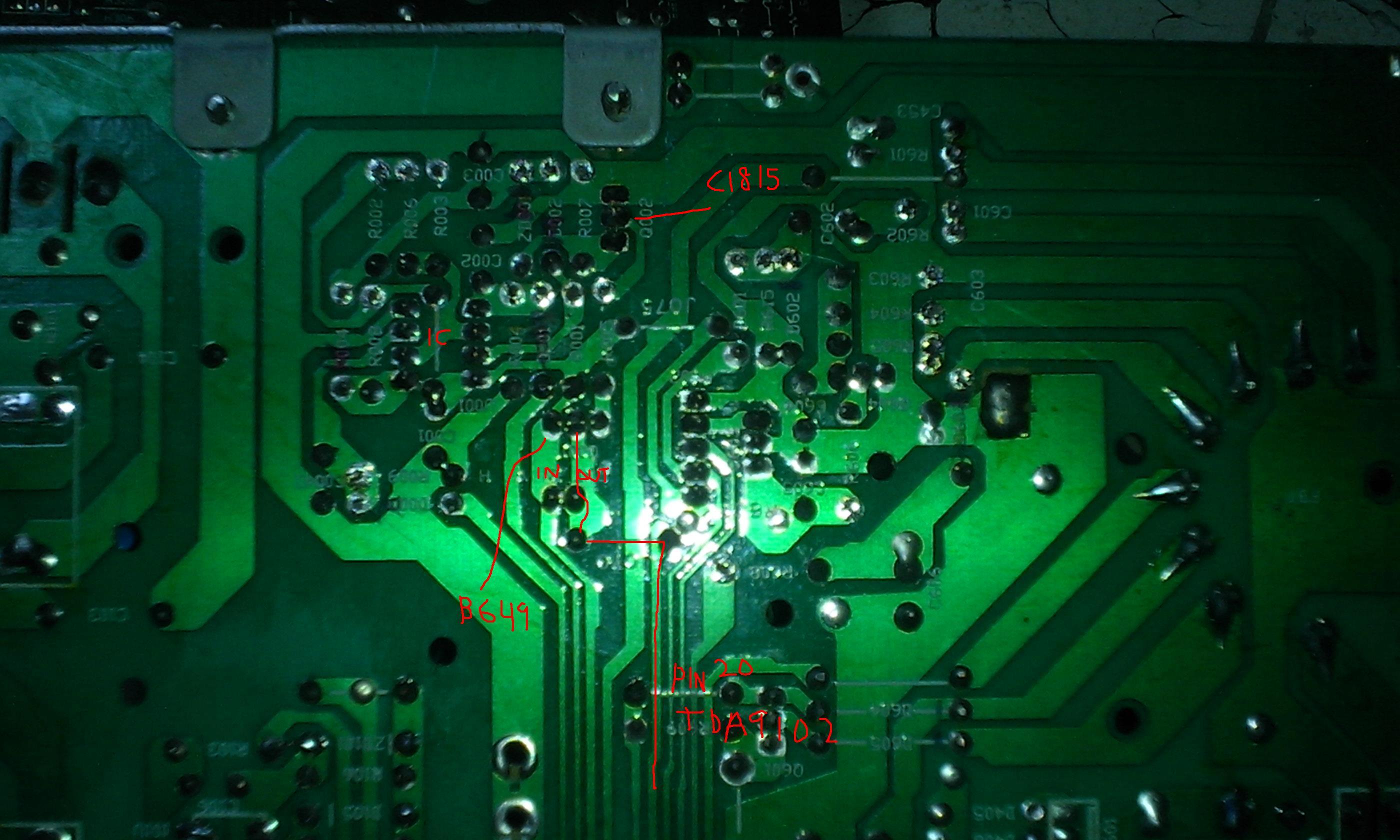

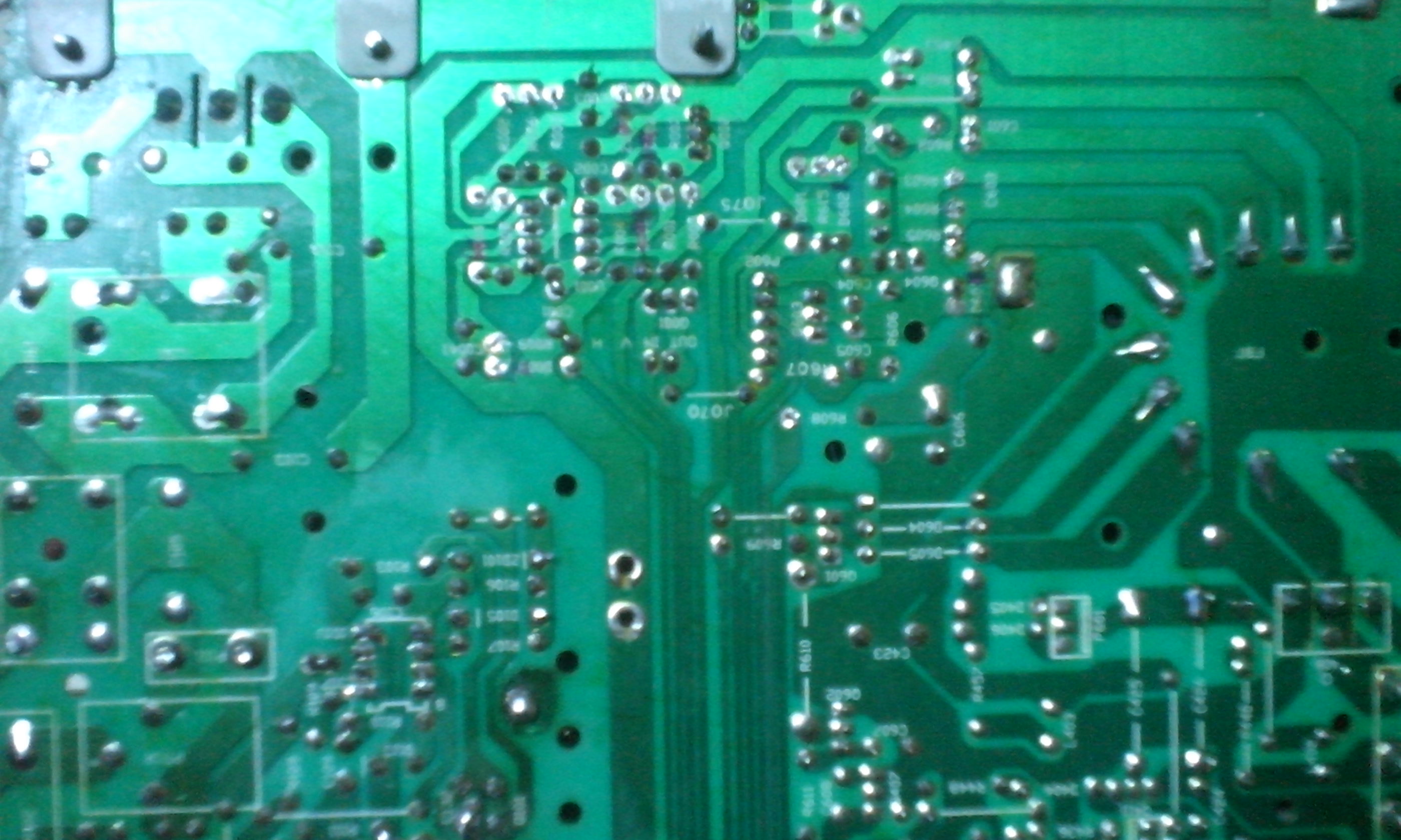

                  this is the schema on pdf, not complete.. I am sorry.. I am too busy to draw all surrounding components, but I am checks B649A and C1815 transistor good.
                  and some picture, I have try to makes a good picture and hope you can see it..
                  D2 is zener diode = ZD001 on board mark
                  D1 = D002 on board mark
                  R1 = R005
                  R2 = R001
                  any ideas?

                    Does set fire up if 12V is connected momentarily to pin #20 of TDA9102?
                      #30
                      Re: Old school Fortune Magic Green 14" S/N 96097669 CRT
                      Vcc pin LM358 has 12V, but TDA9102 no voltage.
                      I have checked the trace and parallel connected to PSU connector to power button led.
                      it has 5V marked on the board before TDA9102 from power supply trace that connected to power button led. but i just get around 1.5 V DC. This is normal for Vf led, but this TDA9102 IC need 12-18 volts to active right? I have checked this parallel trace too that has 1 ceramic caps, 1 electrolytic, and zener diode but checks good..this gonna crack my brain. lol
                      did you mean I makes a jumper 12V for this IC?

                        YES ... see next sentence...
                        MOMENTARILY! short the 'IN' & 'OUT' stakes in your drawing on picture.

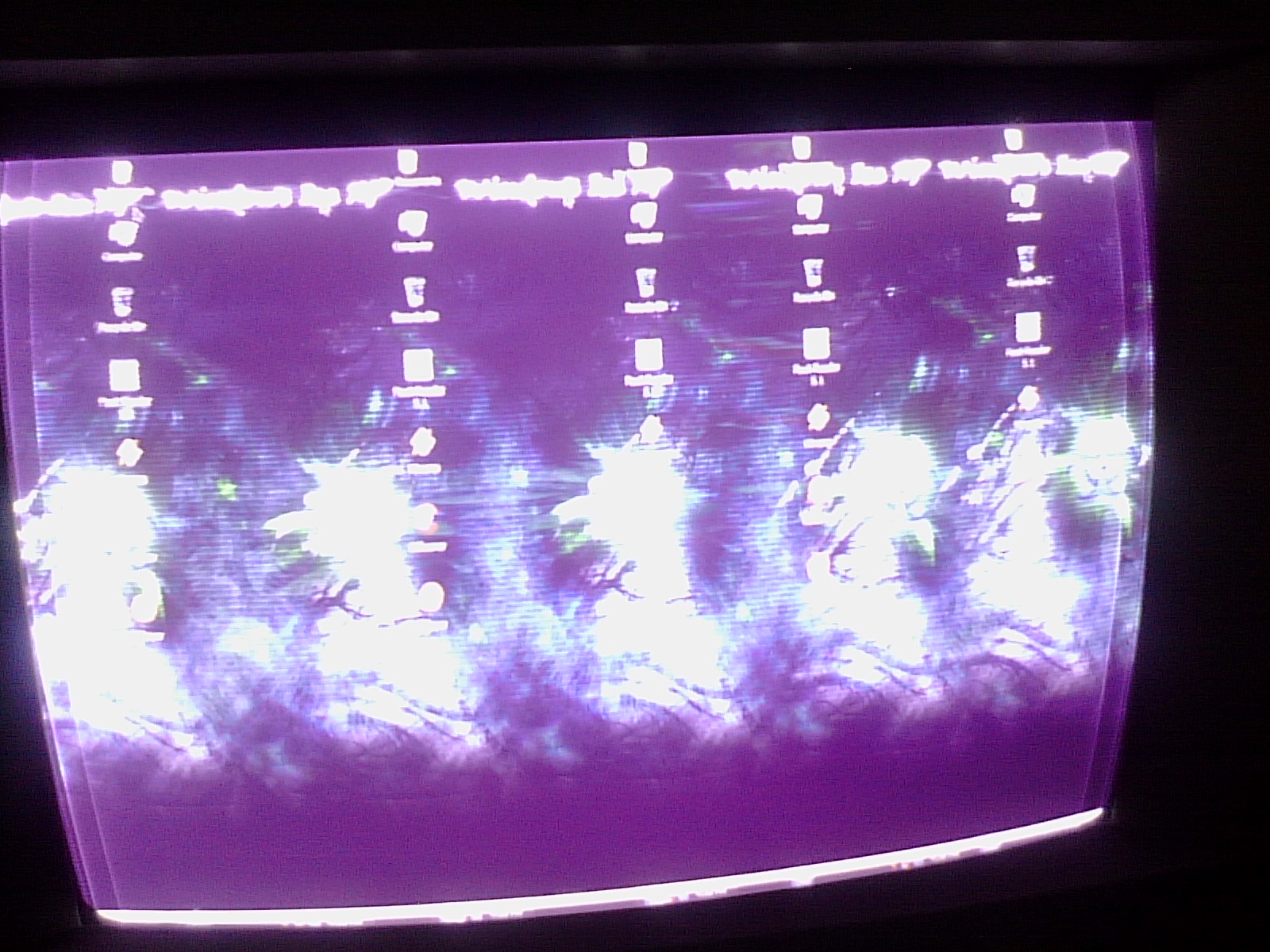

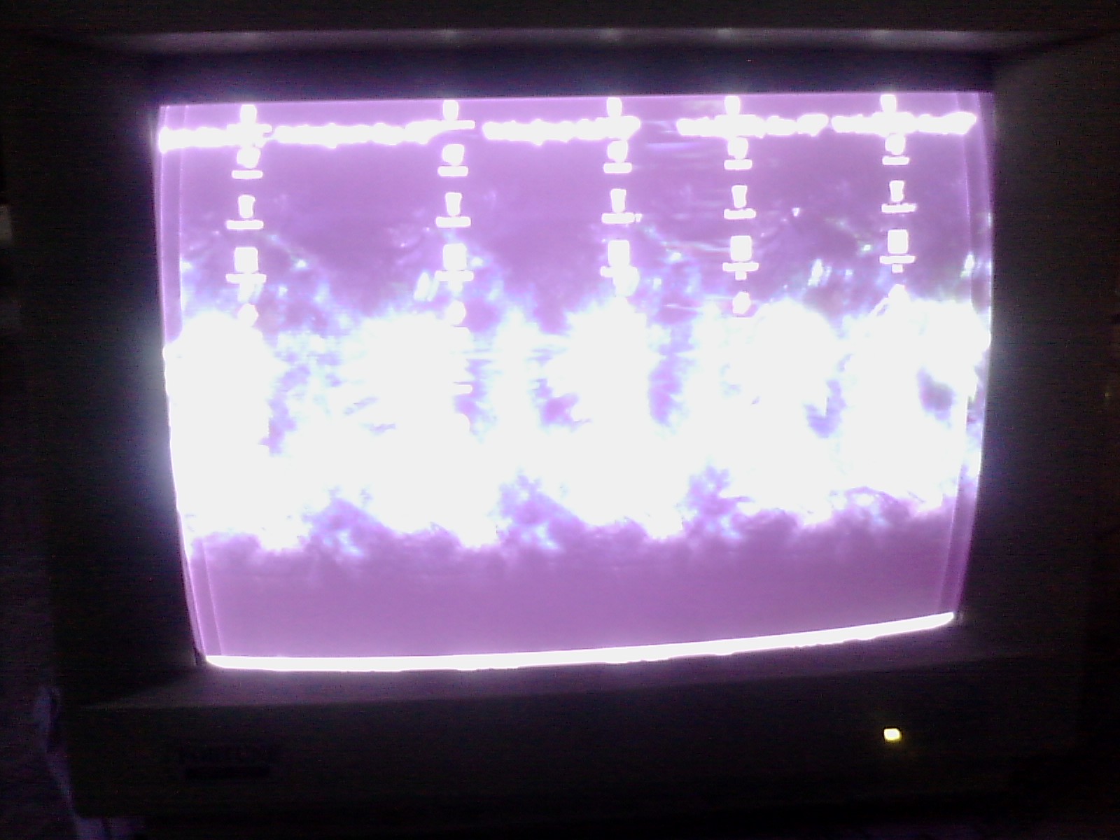

                                  I have test it connected to my CPU. it has a picture.. but it looks divided 4 parts horizontally. so I can't make this jumper permanently? I have to track a B+ trace to this IC TDA 9102 find for culprit?

                                    If there was NOT any jumper there to begin with ?? NOT the 'correct' way to repair set. 12 volts probably needs to be 'switched' to that trace. Quite likely will be something in the circuit you started drawing earlier.
                                    Can you post picture of "looks divided 4 parts horizontally?"

                                      Here it is..
                                      I have checked all surrounding components, except ceramic, polymer caps. I don't have capacitance meter. maybe the LM358 IC itself, but i try to measure between GND and VCC, no dead shorted..how do you think?

                                        Make sure computer is set to a resolution that the computer monitor is capable of displaying.
                                        Dual op amp IC is cheap. Worth a try.
