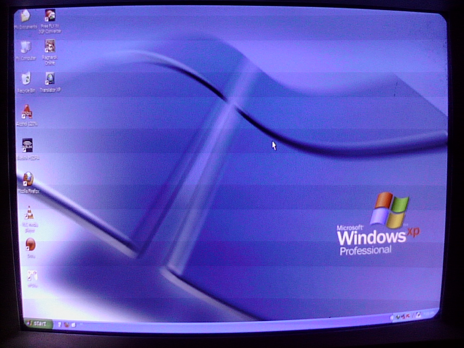

          yes, i have try front panel controls, brightness, widthness, pincushion, etc. I still get this screen. no change.
          this monitor input cable is VGA input like usual LCD monitor input. so how we call for this symptom for tv technician?
          I want try to read some site that has mention symptom like this I face but I don't know how they are TV technician call this symptom.
          I think like you before that this caps no problem, but after changes it with two parallel 474J, the screen looks like this (divided).
          for note : before changes caps the screen just like wave without any clear picture..

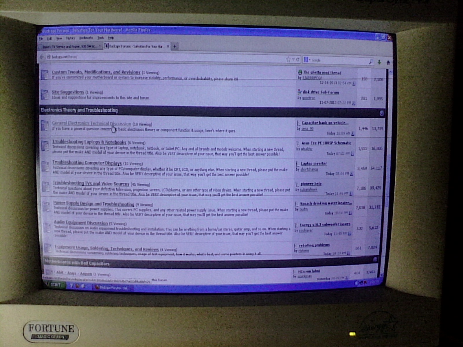

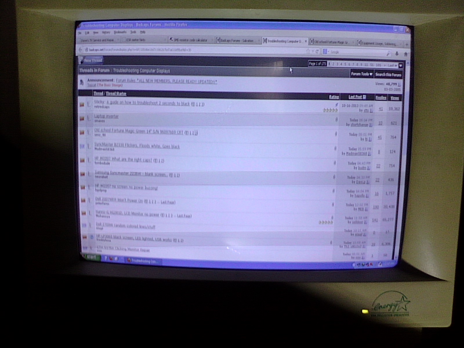

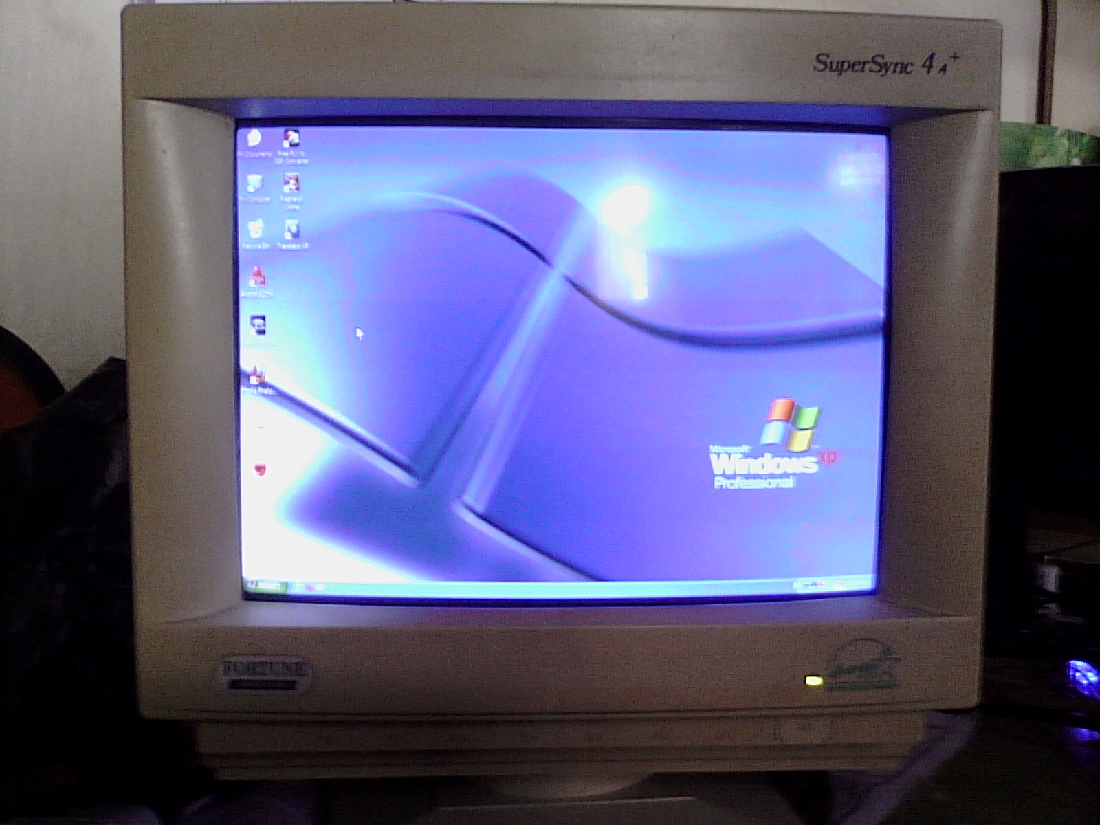

            Some update here, pardon me if digging out the old post, but i want to thank you for all of you contribute in this thread and help me out to find the problem.
            I am just too upset when get a bad picutre before, so I am just laying the monitor down on bench. A couple days ago I am success fixing my friend TV and the problem just a badcaps and failed HOT (he give me a reward ).
            Today I have many spare time and decided to try fix it again, I am trying the suggestion, replacing IC LM358 and caps 100uF 35v, the really one that messed me up is a cold solder joint on TDA9102 pins (forget to makes note) that I am missing !! I haven't change 824J caps (found no replacement).
            Yes, maybe the jumper is not supposed be there, but I have try the monitor on and watch a video about 3hours and just fine
            I have try all my best but they are no defective components as I checks, so I am still use this jumper method. Now the monitor run likes a charm regarding the jumper (maybe it should be there before??). The colors is very perfect and the lcd monitor that I used looks like a crap comparing with this monitor color. I would post some picture soon because the color is amazing beautiful.

                    this is likely too late to post the picture but New year and Christmas is a busy time
                    so here it is
