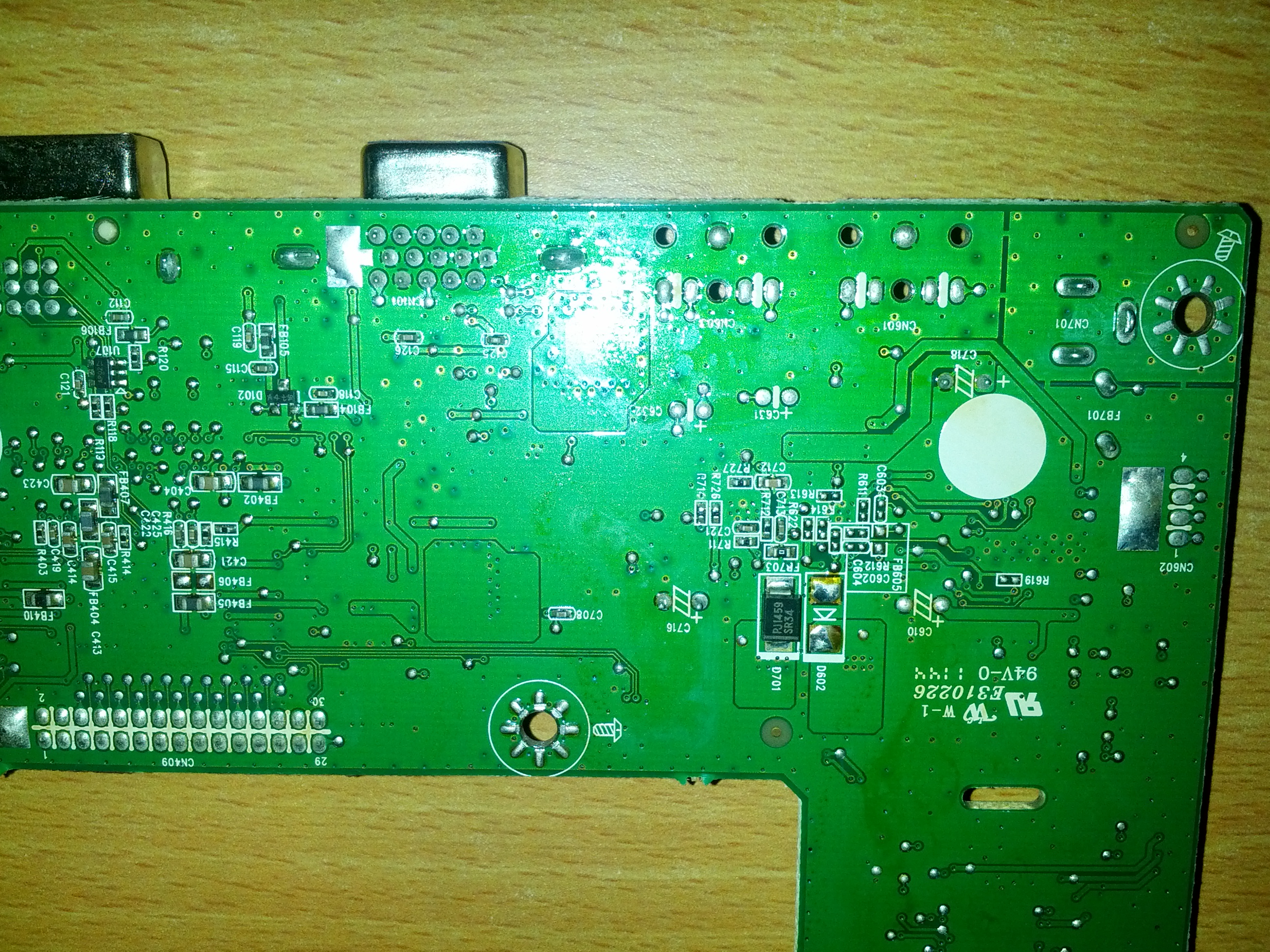

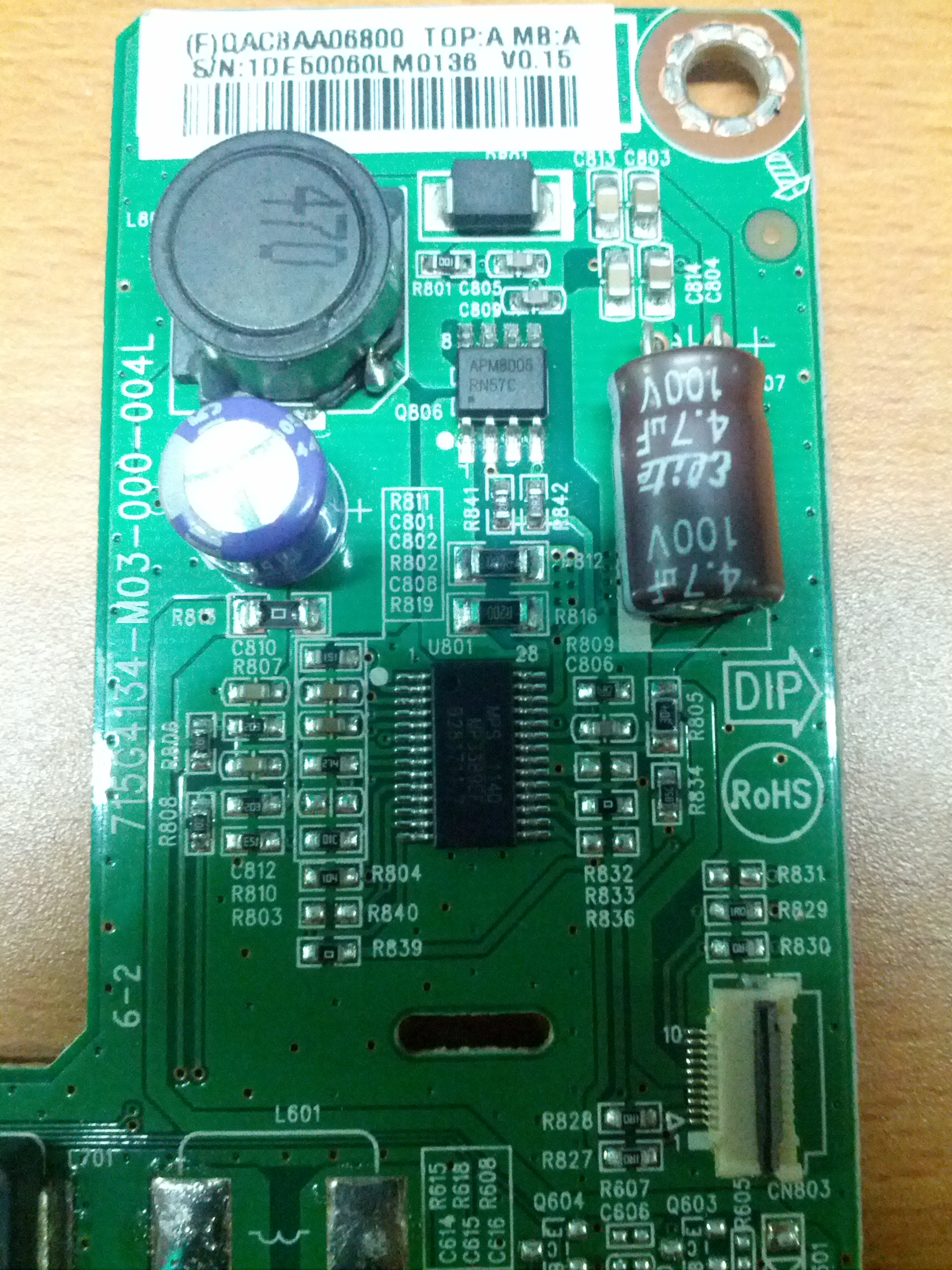

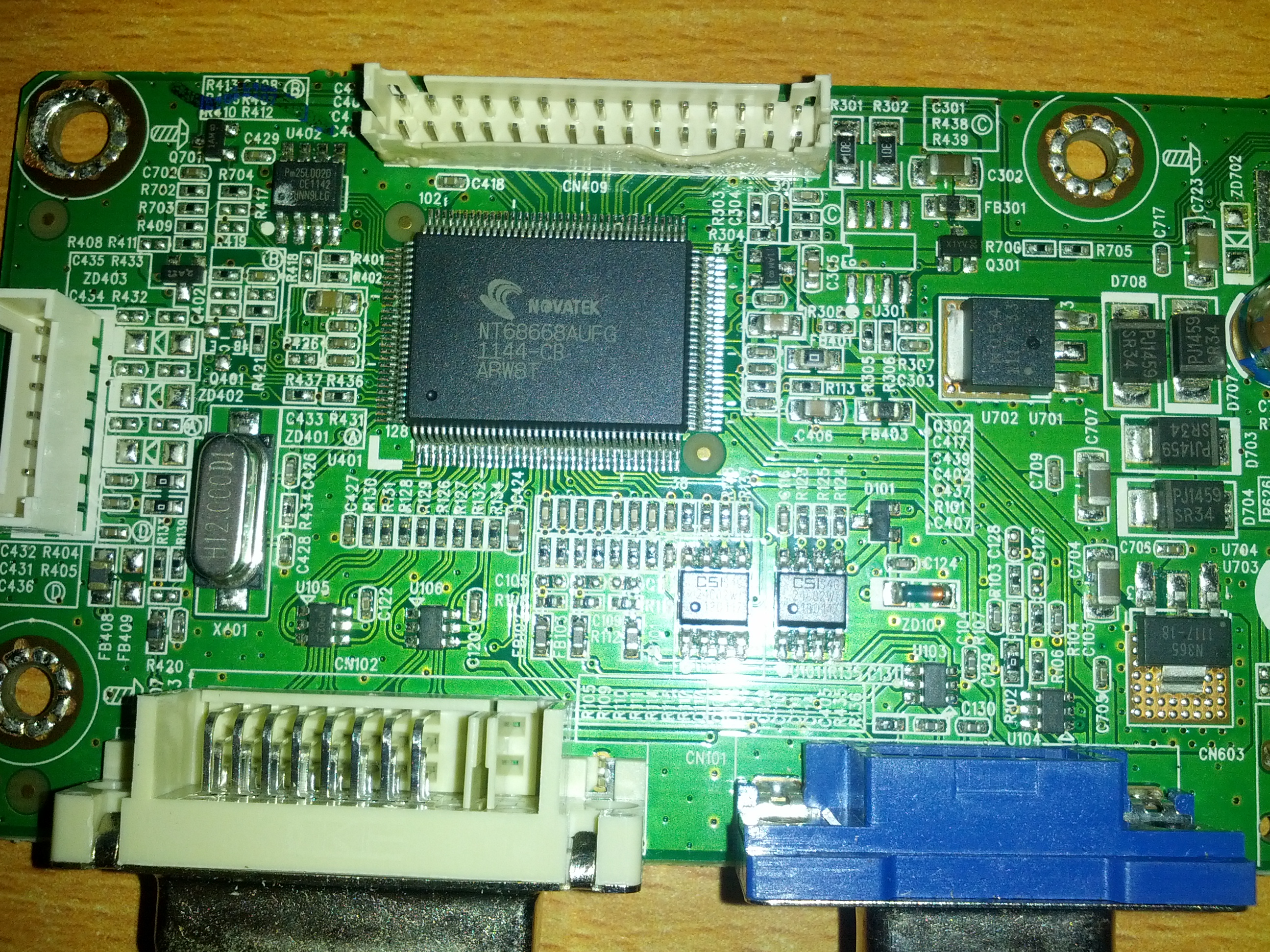

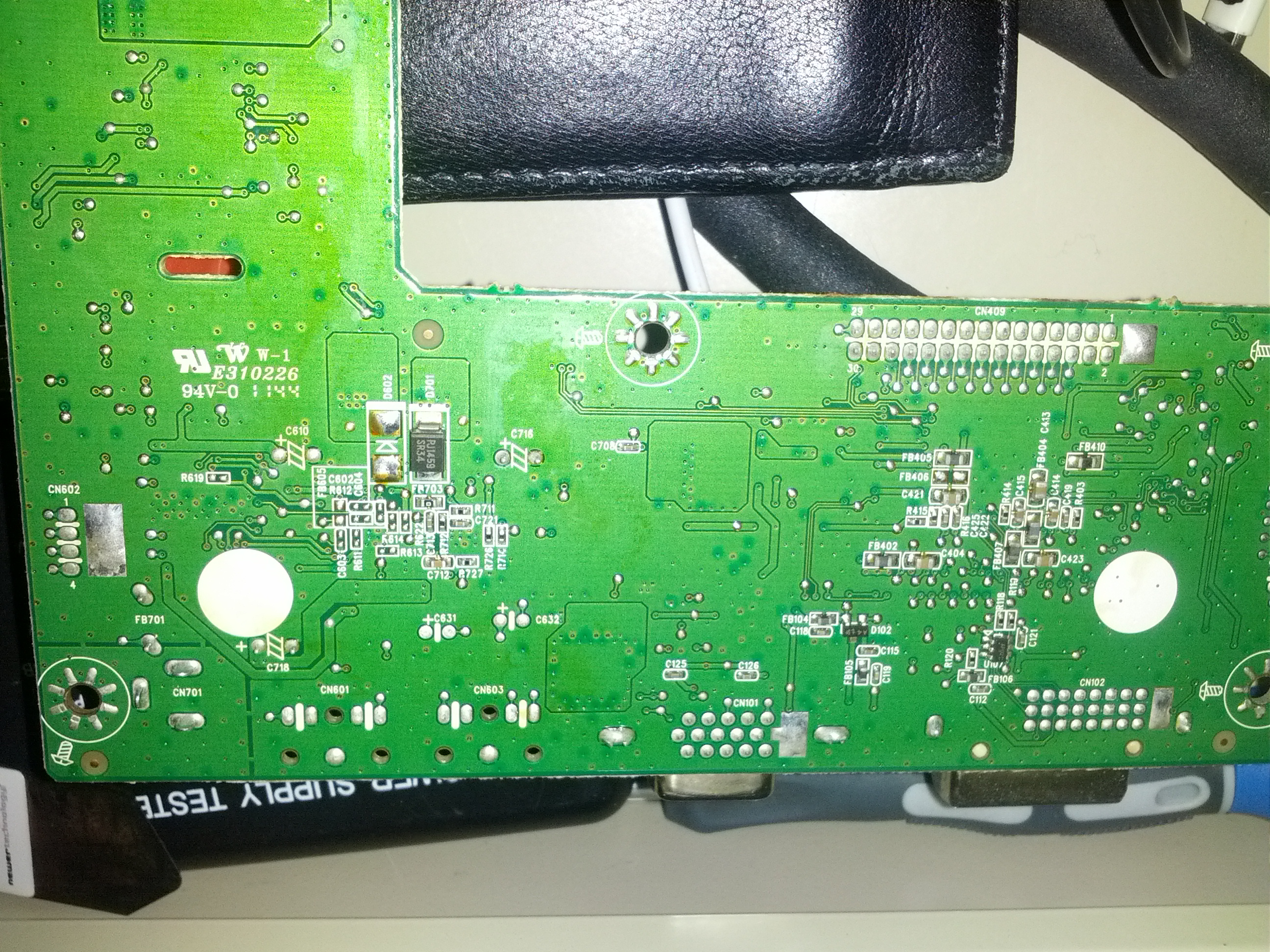

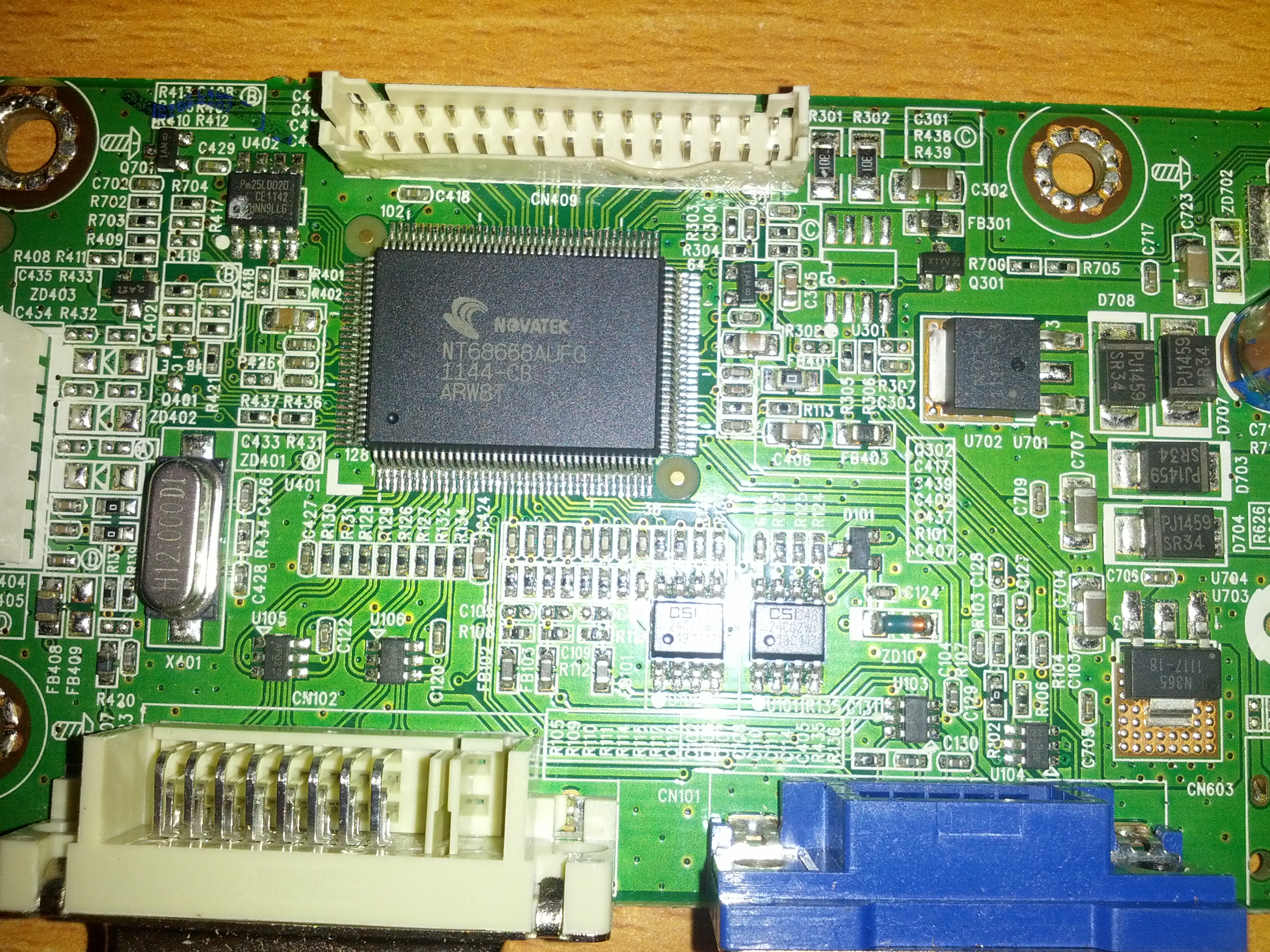

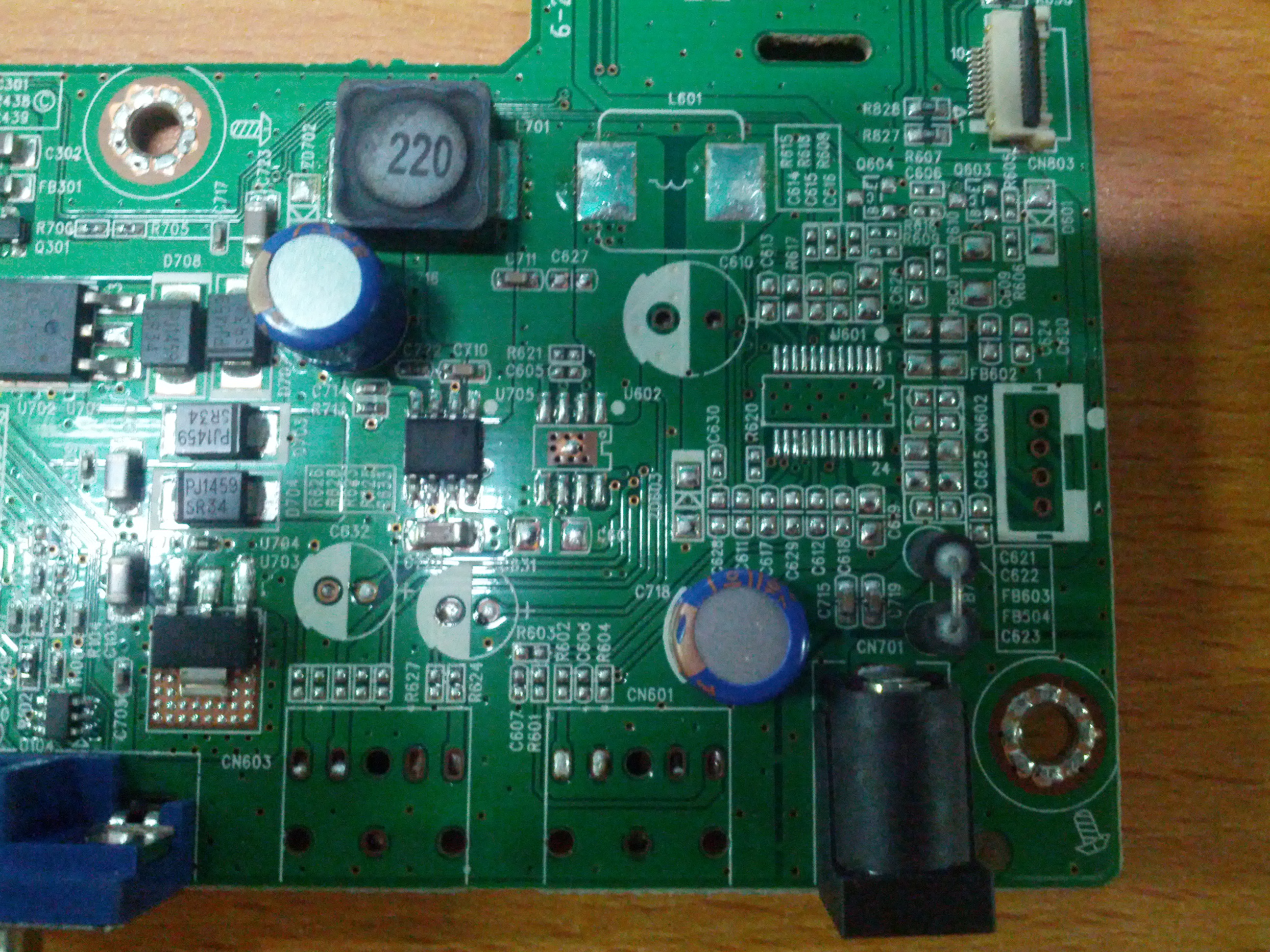

      Sorry, these are the best I could take.
        Re: AOC e2243Fwk
        Does it go to standby mode if you do not have VGA cable connected? Does it wake up from standby by when VGA from running PC is connected?
        There are two 3-pin regulators, U702, U703; report DC voltage reading of all 3 pins with ref. to the chassis (ground).

          Re: AOC e2243Fwk
          Hello budm, it does go to standby after showing "Cable Not Connected" (LED light turns to RED, White means it's on) and it won't come back from standby after plugging cable.
          Here are the readings:
          U703= 0v, 1.8v, 3v
          U702= 0v, 3.3v, 4.99v
