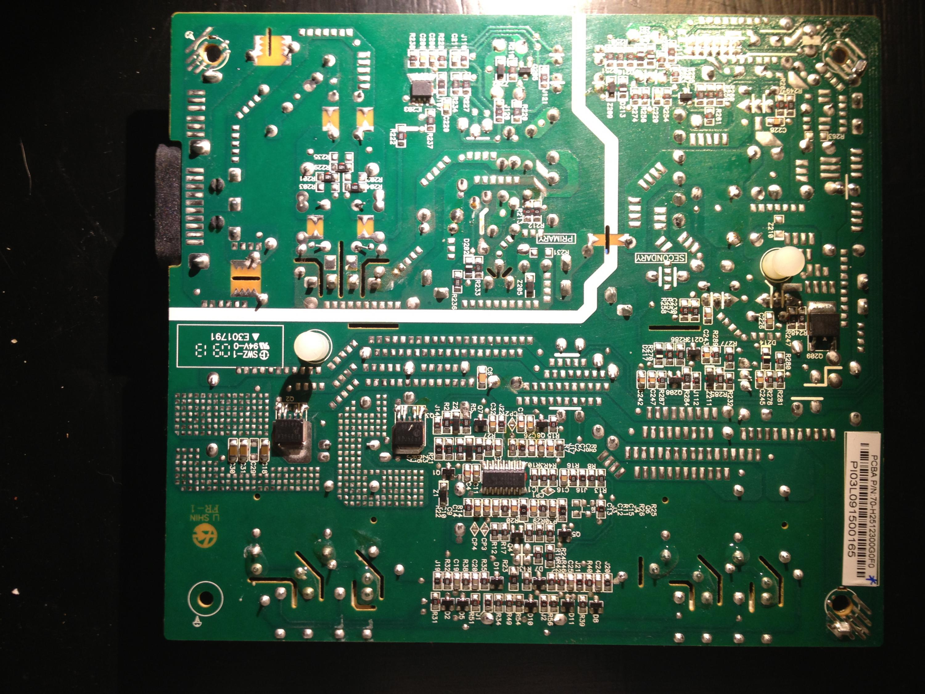

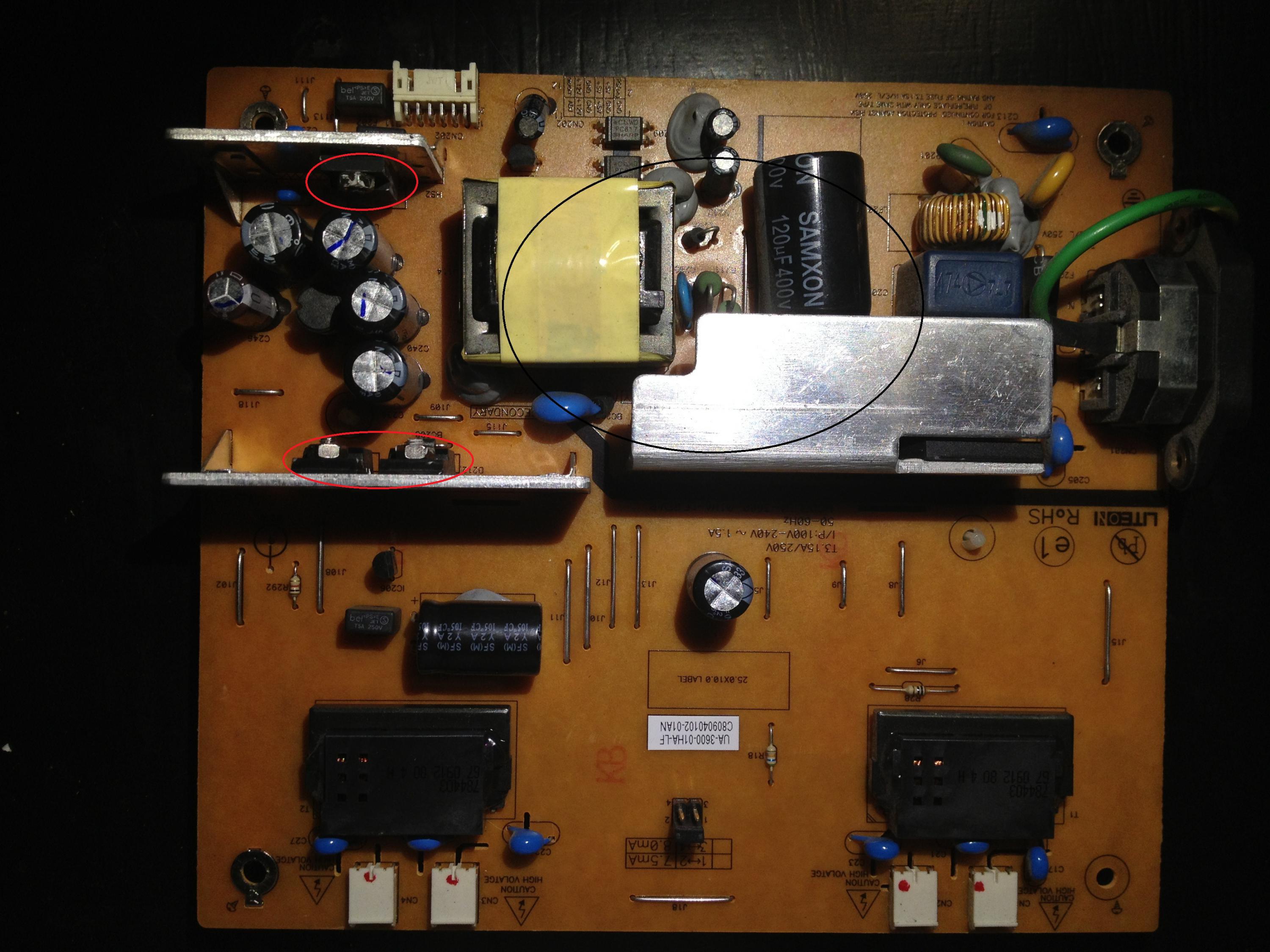

    • don't know if I got the reading wrong, but I found three transistor with some strange reading (circled red in the front photo)
      -Pin 1,2 and 2,3 show >20 Ohm
      -Pin 1,3 showed 0,4 Ohm
      At first I tought it was a short, but since I got the same reading on all 3 of them it seems like a strange coincidence, am I missing something?
    • I narrowed the source of the humming from somewhere in the black circle in the front photo (the component with yellow tape is some kind of transformer, right?)

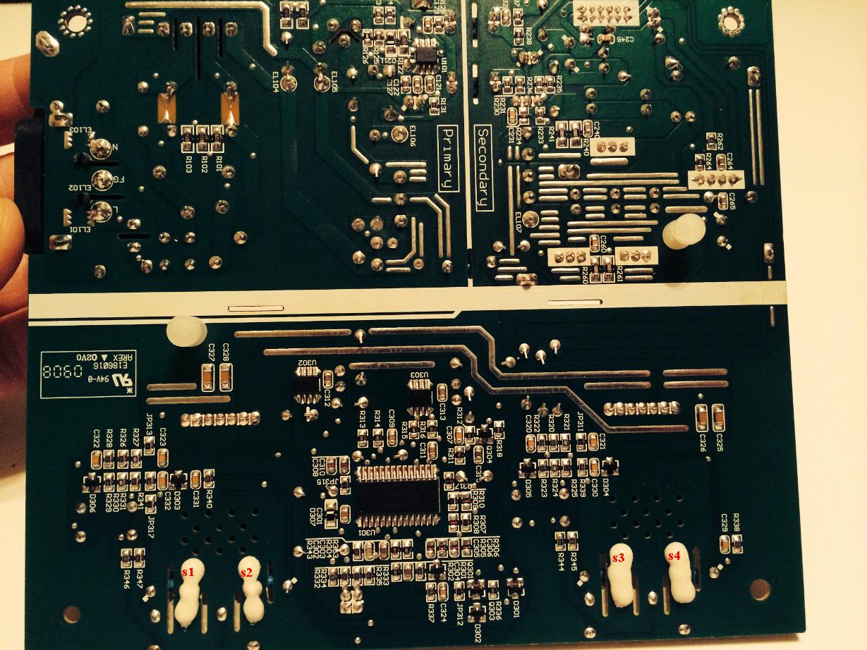

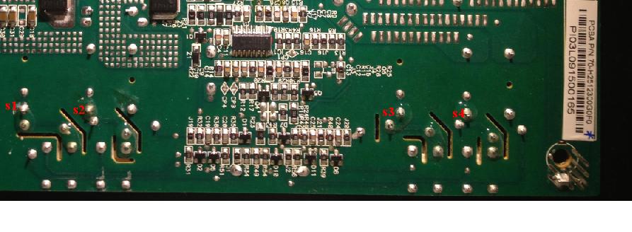

          I THINK the secondary winding posts are as in the pic.
          No power to monitor meter on ohms 2000 test s1 to s2 and s3 to s4
          and post the results.

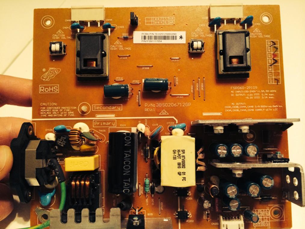

            The back of my board appears to be a little different, would you mind pointing out the test locations?
            Back:
            http://imgur.com/O2WffHZ
            Front:
            http://imgur.com/4oc8mDG
            Also I test all capacitors and some dont change at all on the multimeter and others will display 150ish,then 130ish, then 100ish and the to 1 or -1. Does this mean that all the capacitors are bad?

              You will need to scrape off/peel back the white insulation.

                I'll post results later tonight when I get home. However I did test test the 3 transistors last night. All 3 acting the same as below shows.
                Pin 1 & 2 - would flash a number between 100 and 150 and then go to 1 or -1
                Pin 1 & 3 - 0.8ohms
                Pin 2 & 3 - would flash a number between 100 and 150 and then go to 1 or -1
