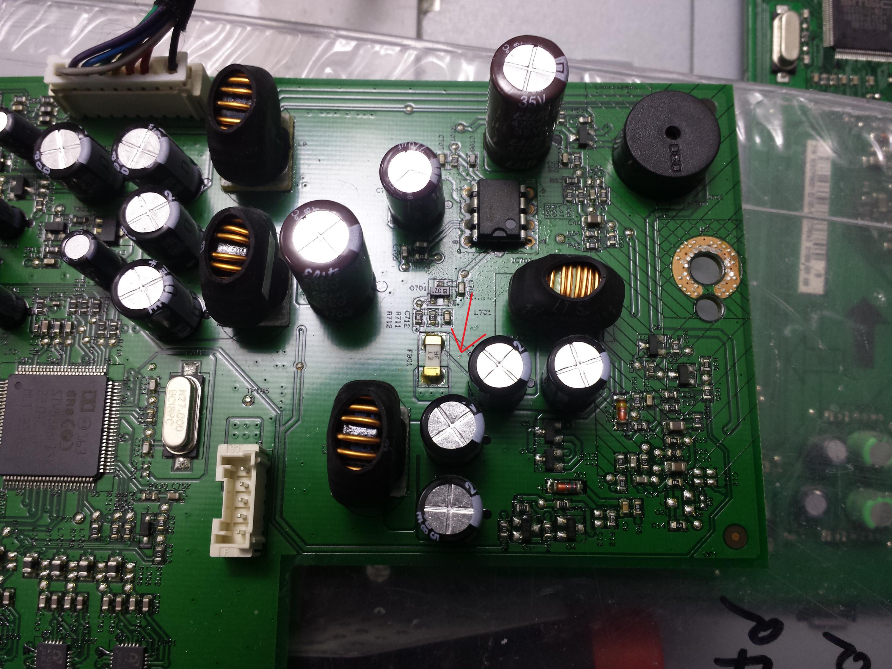

    Problem is that the monitor is completely unresponsive, i can't turn it off.
    I have had experience with replacing similar memories but simptoms were a bit different
    Can you get an oscilloscope onto the I2C lines for the keyboard? See last photo in post #4, it shows the SDA and SCL lines. Is there activity on these lines? Failing that a DC Voltage reading from a DMM.

      25lv020 is a flash chip but i think the fw is in the tsop memory near the bga device(29lv160) because it has bigger capacity. the 25lv is perhaps where the settings are sotred
      I'll get a scope in there later today.

        Just probed SCL and SDA pins, there doesn't seem to be any activity but they are both high at 3.2v

          Interesting. So you have a similar problem to mine. No I2C activity suggests that the main CPU has not initialized.
          I am very interested to know if your monitor will initialize by manually resetting it. See post #12. Can you earth the junction between R279 and R460? You can just use your multimeter on current with one probe on earth and briefly touch the junction with the other probe. Safest way is to use a resistor to earth just in case you accidentally earth the wrong side of R279 and short out the +24V.
          Also I hope it is not inappropriate for me to say that I'm very impressed with your English. It might be better than mine and English is the only language I know!

            Back with some more news.
            The grounding of that via didn't help(it went down to 0.4v when grounded via a 1k resistor) so i went and probed some voltages and i seem to be missing the 12v one.
            It seems to be obtained with a buck converter(L4978). I measured the potential at it's eneable pin and it's basically ground and accordin to the datasheet that means it's in sleep mode.
            Can you tell me if that 12v rail should be on at all times?
            Also, out of the 2 heatsinked cips only the bga one gets warm, the other one is stone cold

              The 12V and one of the 5V rails ONLY come on when the monitor is powered on. The fact that you have no I2C activity means that the monitor is not in the powered on state.
              I was hoping that the grounding of that point passed R279 would wake up your monitor.
              For me also it is only the BGA chip that gets warm. The other chip with a heat sink is only enabled when the monitor is powered on, the 27MHz crystal beside does not oscillate until the 24V and second 5V rails are enabled.
              Is the 19.6608MHz crystal near the BGA chip oscillating? I'm guessing it probably is because as you say the heat sink is warm.

                it's true, the main processor crystal is oscilating. i'm begining to think it's the processor that's gone.

                          Good news and bad news:
                          Good news is that the reflow did the trick and the monitor now sort of works.
                          Bad news: when connected to a pc on any imput, the picture doesn;t come on, it goes to stand-by, if i disconnect the cable(dvi vga or hdmi) it says x cable disconected and it goes to sleep.
                          I can get into the menus and the monitor seems to working except it doesn't display any picture from the inputs
                          There might be 2 things that cause this:
                          1 the fact that i replaced that 25lv020 meory and now i can't seem to find it anymore
                          2 the bga chip is toast and now is only half working
                          Neil, do you have any means to read that 25lv020 memory?

                              there's no need for reballing(or should i say no real advantage) just apply some flux and heat it up till the solder balls melt(be aware that those el caps won't like the heat and some will explode depending on how you do the reflow) .
                              The problems isn't with those balls but with those within the chip, so a correct fix is to replace the chip.
                              I have a small programmer( called minipro) that i use to read/program chips. It's pretty cheap and surprisingly(at least for me, a novice) it supports a great number of devices ranging from al sorts of memory chips to mcu's
