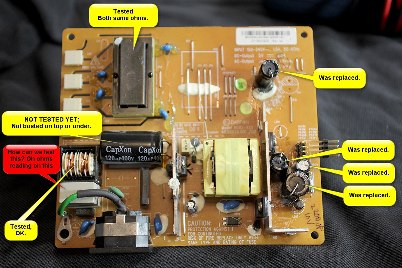

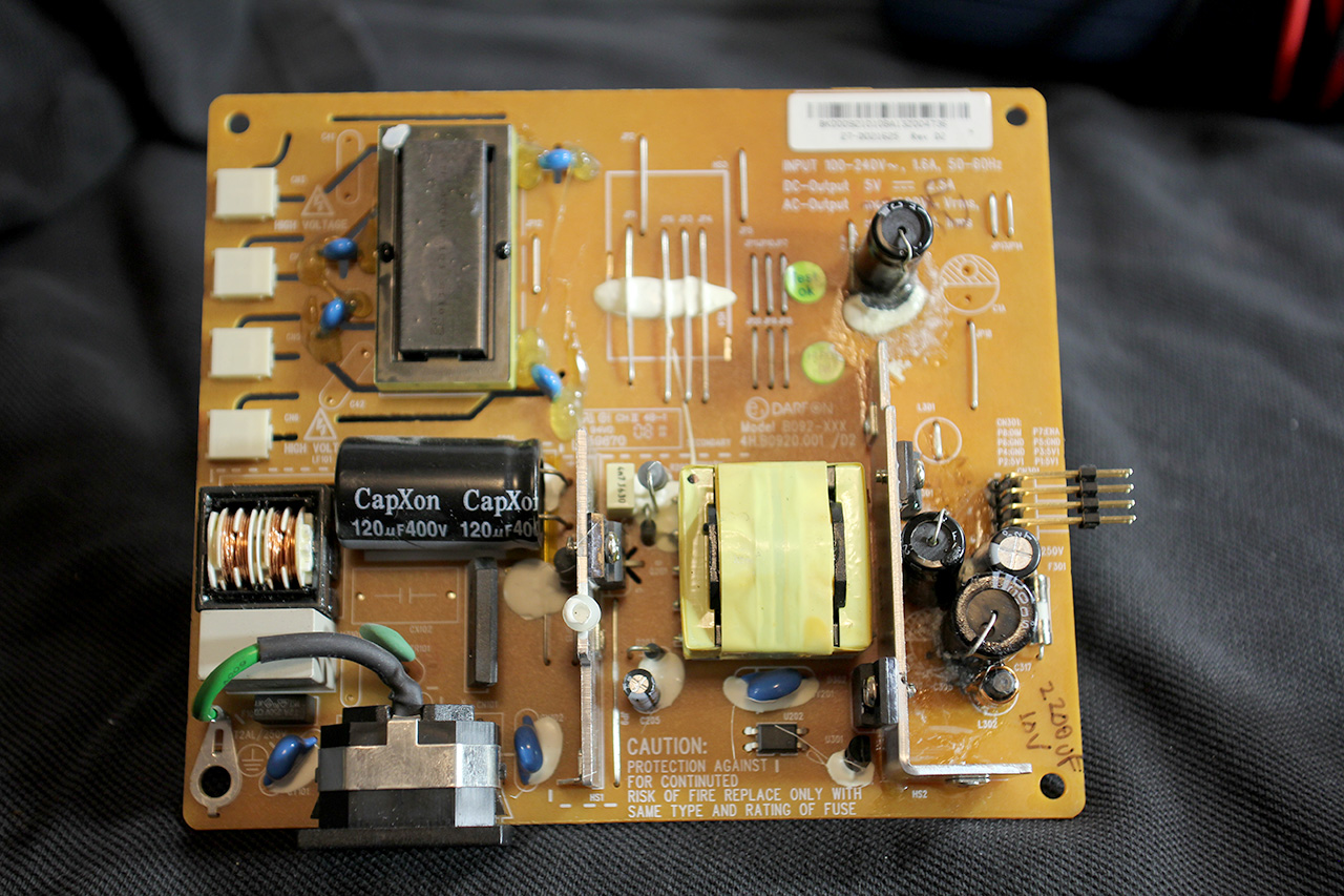

    Hi Eveyone,
    I had these monitor that is completly dead. No power on at all.
    I had change 4 capacitors, tested 2 transformers, ok.
    Still no power on this board.
    I've try to read something on the white box; #CX101 on the primary voltage section. How can we test that part? It seem to be an transformers or something like this.
    It's writen 250V/AC 0.4uf, KN81560;
    What can i do more to get this board working?
    Thanks.

    Those replacement caps look like regular general purpose caps. That Grey cap is for AC noise filter, it does not have to there for the power supply to operate.
    What DC voltage are you getting at that big filter cap in the primary side, measure the voltage right at the two legs?
    Do you also get any DC voltage on any of those caps that were replaced?
    Did you replace the small start up cap, the one next to the word 'CAUTION'?
    How about that small white fuse in the cold side of the circuit?

        Yes, this is an always on power supply, it will run the minute you plug it into the AC outlet.
        That cap in in the Hot side (deadly side) of the circuit, do not not touch ANY THING on the board with your hand. The voltage on that cap should be around 160~170VDC.

          OMG! Are those axial leaded capacitors?! Supposed to be radial leaded capacitors. Also, recommend using low impedance/ESR type capacitors as this power supply board uses SMPS topology.
          That "white box" is actually a "X" capacitor for power line noise filtering function. First, have you check the voltages across the outputs on the secondary side whether they are present and correct?
          Even without bulging, that big main 120uF 400V capacitor can be bad. The only way to tell is to remove it from the board and check it using either a multimeter (charging test) or capacitance meter. Always discharge the capacitor before checking.

          Yes, check the voltage across the big main capacitor on the primary. If the fuse did not blow then its unlikely for that "X" capacitor to be source of any problems. But first and foremost, get proper low ESR capacitors...

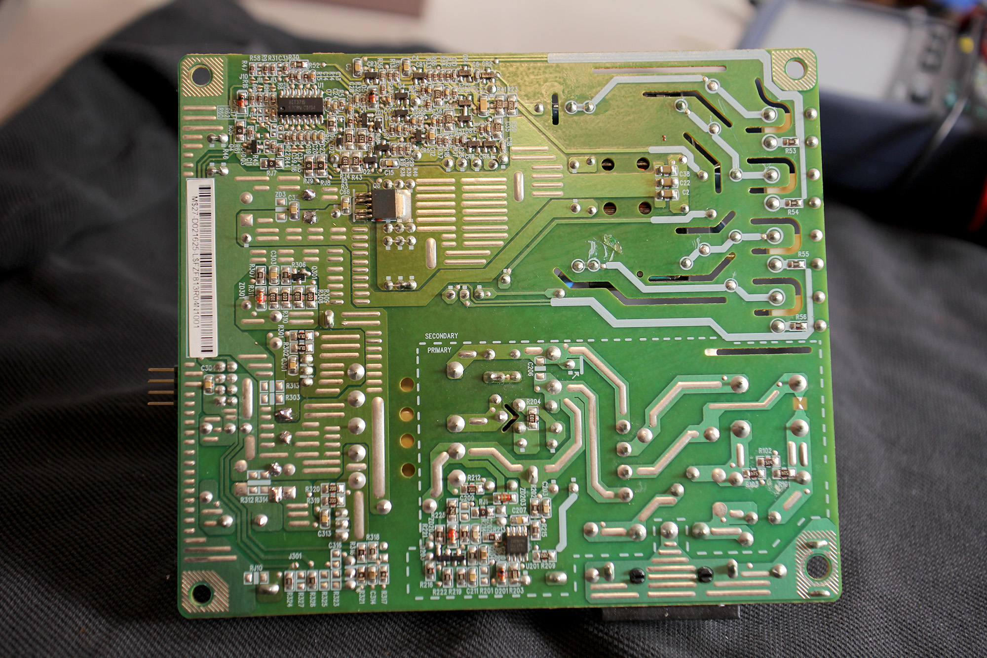

                              Can we have pic of back of the board?
