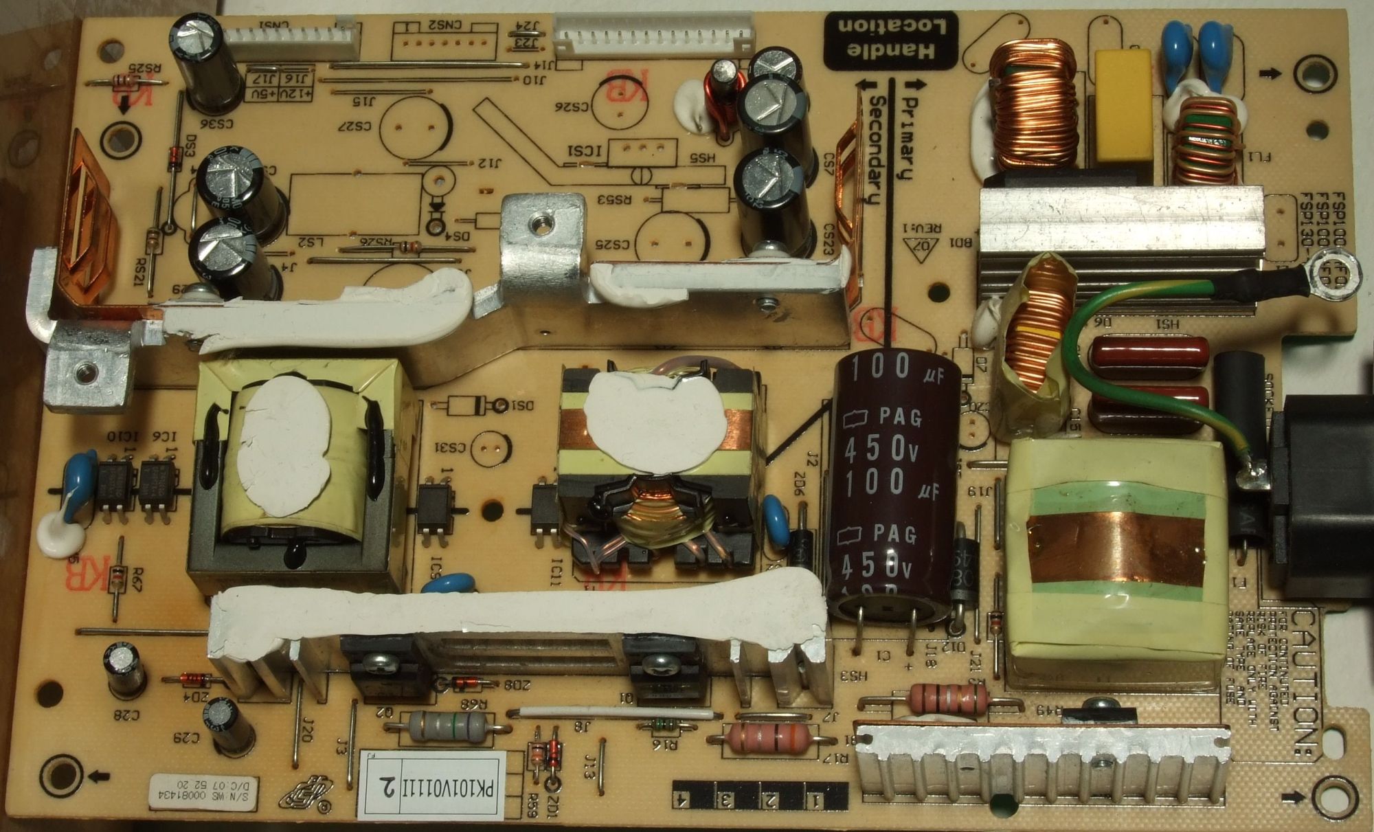

    My PC monitor "Acer AL2416W" has packed up. It is still in good physical shape and I am rather loathe to chuck it out. Was hoping through the advise and help of the many knowledgeable members in the forum to get it working again. I am a beginner wanting to learn more about electronics.
    Setup
    -known working computer and VGA cable as replacement monitor works fine
    Symptoms
    2 or 3 weeks before the Acer gave up the ghost, the OCD menu will come on on its own. This happened with increasing frequency for a few days. The problem with the OCD menu then disappeared and everything appeared to be normal. Following this the monitor simply died. On pressing the LED power switch:
    - the screen flashes very quickly (milliseconds). The screen remains black throughout and stays black.
    - No Acer logo can be seen with a torch
    - the power on LED never lights up and remains unlit

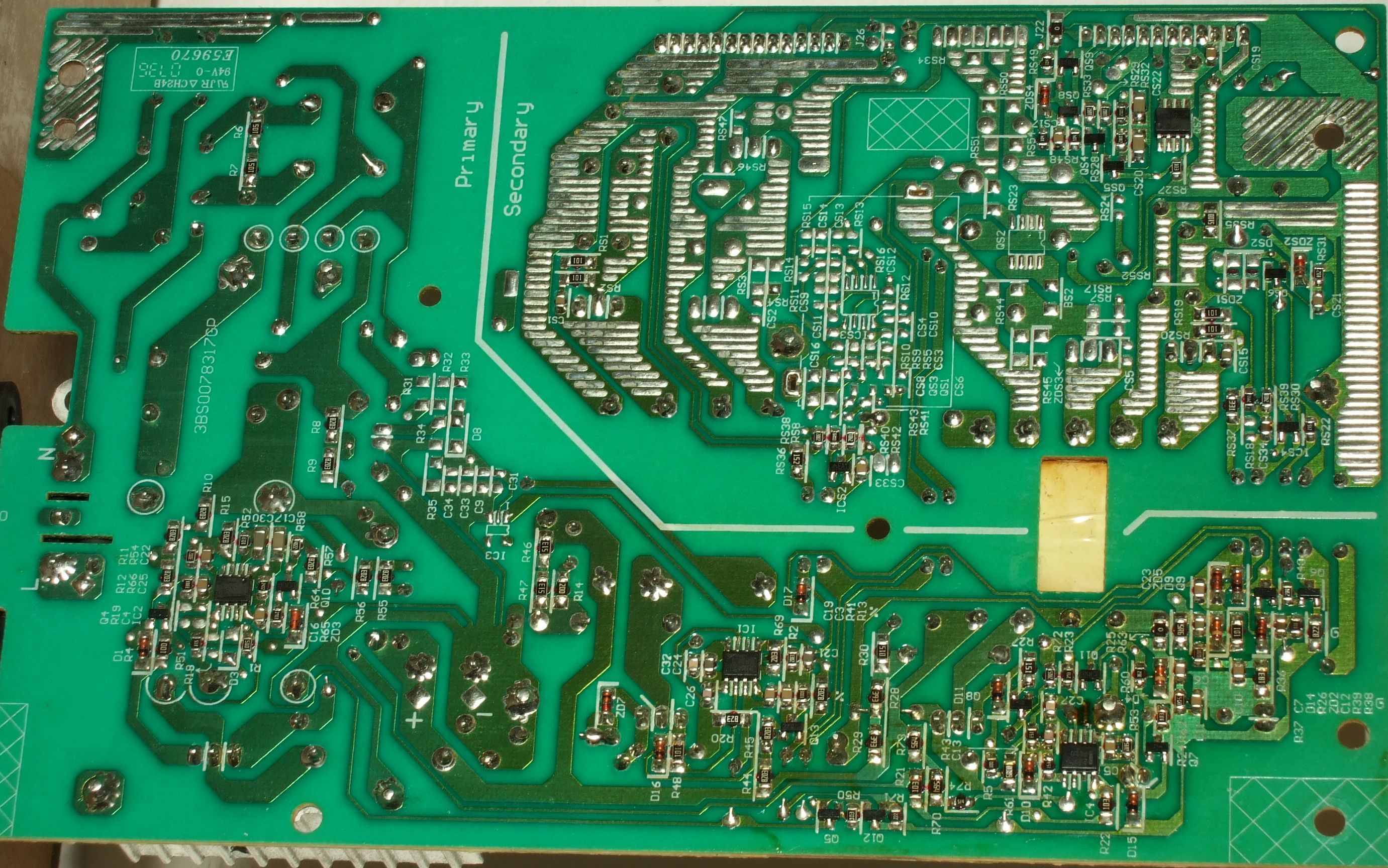

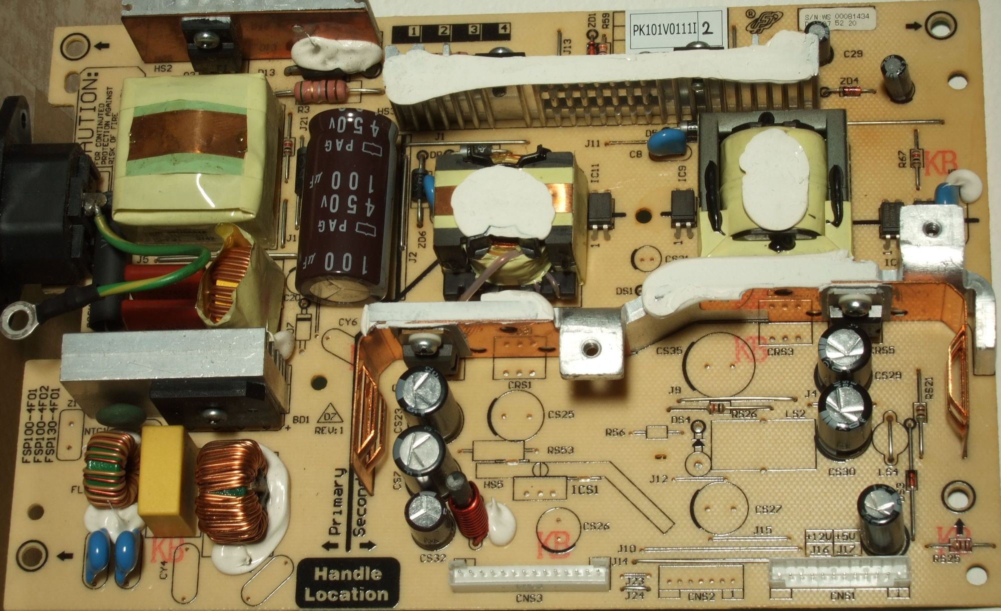

    Measurements
    1. Main capacitor after transformer C1 (100uF, 450v) measures 330v (UK)
    2. Measured all the capacitors on the power board with an ESR meter. They all appear to be within tolerance

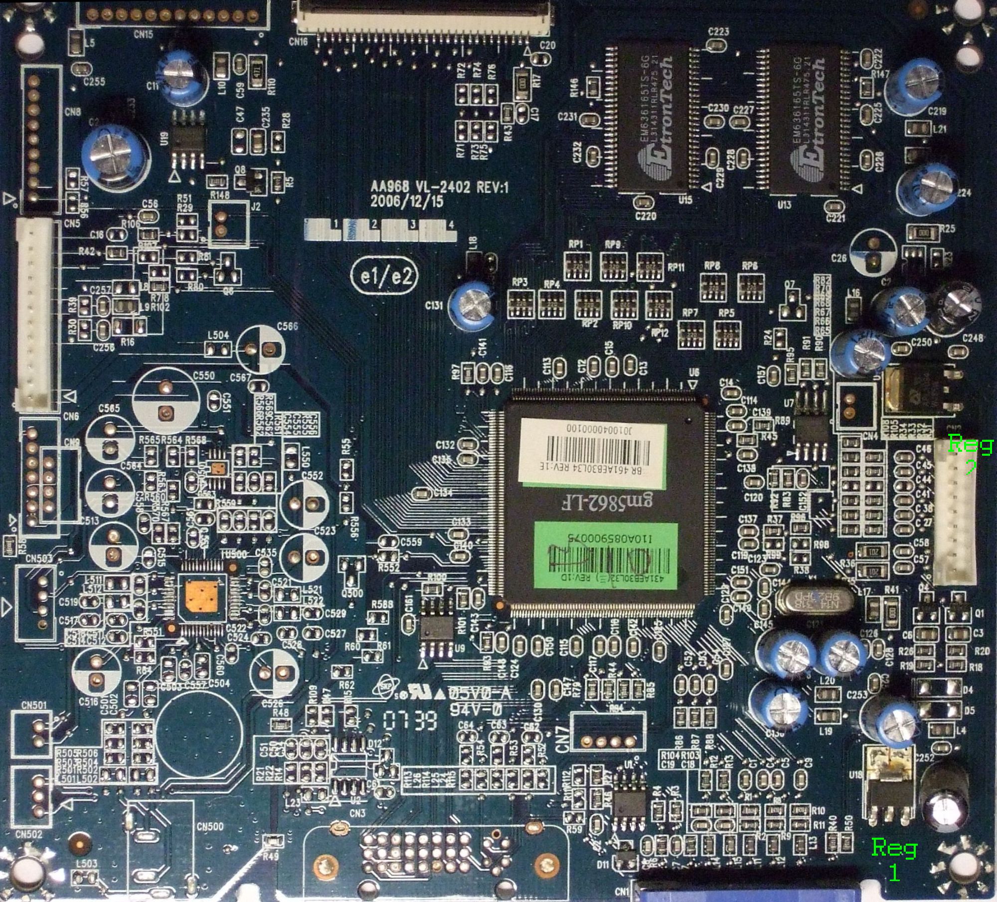

    3. Because of the the way the OCD and power LED behaved I suspect the problem might lie in the logic board. I tested the 2 power regulators following the instructions laid out in post by retiredcaps
    Regulator 1(see picture)
    APL 111
    GJ90518
    pin 1 = 0
    pin 2 = 1.799 V
    pin 3 = 3.286 V
    Regulator 2
    APL 1084
    WJ85W
    pin 1 = 0
    pin 2 = 3.286 V
    pin 3 = 5.09 V
    If my understanding of the data sheet is right (I could well be wrong however) Reg 2 seems OK. I cannot find a data sheet for Reg 1.

    Hello and welcome to Badcaps.
    Holy crap! You provided information that usually takes 5 or 6 messages to extract from a new poster. Well done!!
    I'm not too sure what to suggest, you've covered almost everything I'd check.
    Because you're not getting a power on led, we can skip the whole backlights testing for now, and probably focus on the mainboard or power to it.
    Are there any voltage markings on the connectors between the main board and power supply? You probably have 5v if you're seeing 5v on one of the reguators. Maybe check the 12v and 5v pins that are labelled on the power supply connector.
    I'll take a closer look at your photos in a few minutes.

          Re: Acer AL2416W monitor won't power on
          APL 111
          GJ90518
          pin 1 = 0
          pin 2 = 1.799 V
          pin 3 = 3.286 V
          Regulator is 1 good. Note the last two digits of the GJ90518 is "18" and pin2 reading is 1.799.
            www.ebay.com/itm/360661103594
            went without any bids.
            Check with seller if the part number listed "AA68 VL-2402 REV:1" is actually AA968 (like on your board/picture). If it is the same board, ask seller to relist with a "Buy It Now" price and get it. As a bonus, seller is in UK.
