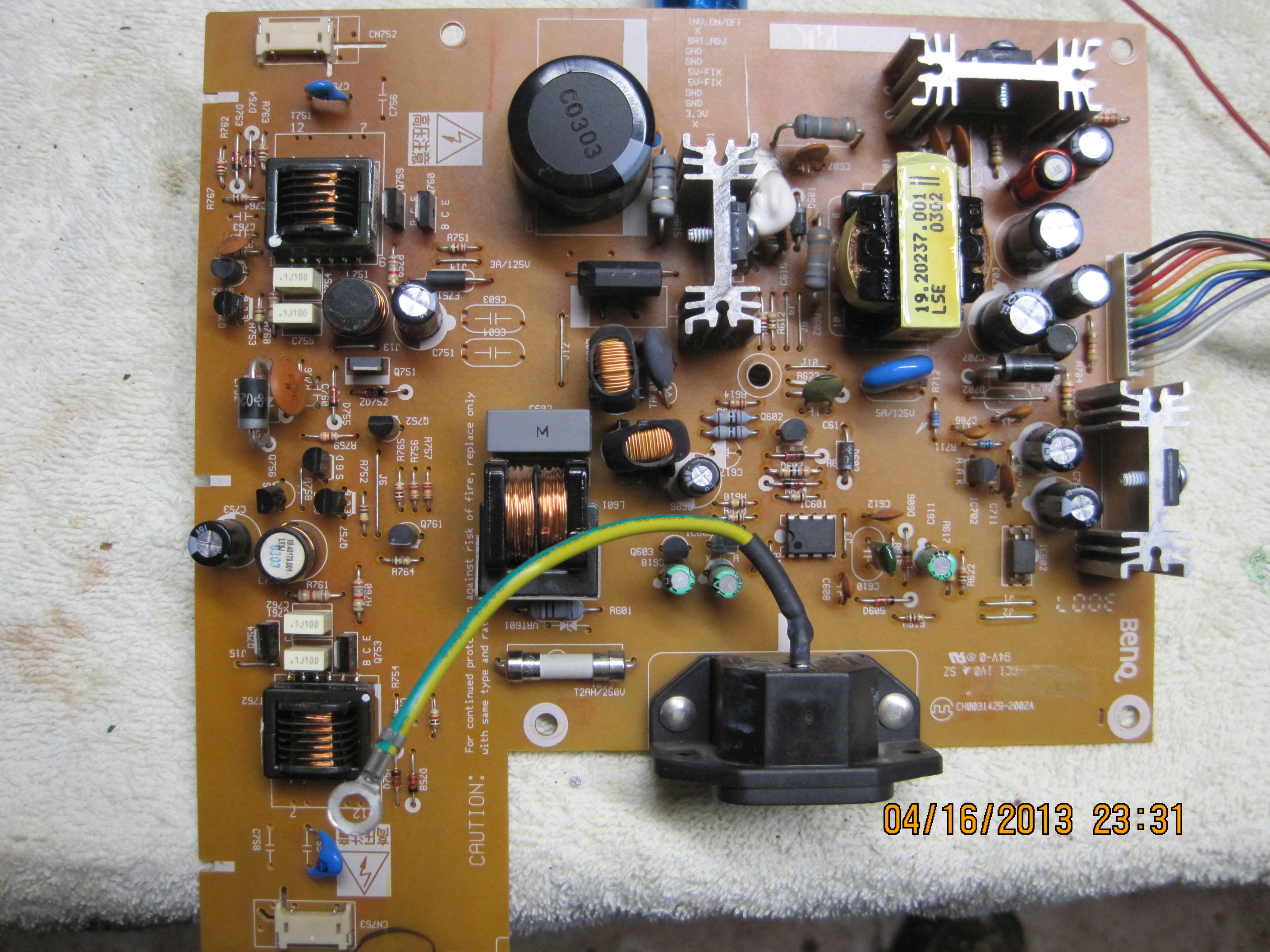

    I need help with Benq switching supply 48.L2903.A23 which has failed killing the two backlights. Have been looking for schematic but nothing found yet.
    Have removed and reinstalled the transformers finding the coil resistances reasonable and the solder joints fine.
    Have checked all diodes and transistors found sat and see no failed caps.
    Notice the high voltage inverters on the left side of the board seem isolated from the rest of the board and receives it's power from the right side of the board thru fuse F751 a 3 amp 125 vdc fuse. Found just left and down from the big fat cap at the top C605.
    The measured voltage supplied to the fuse is 12 vdc which seemed reasonable until I noted that the zener diode ZD752 is rated 24vdc so was setting at 0.65 vdc since not enough voltage is being delivered to the left side of the board
    1. What voltage would you expect the right side to be sending to the left side high voltage inverter?
    Investigation of the right side of the board is limited because I found all the voltages at the right side connector correct as listed at the top middle of the board (5v-fix, 5v-fix, 3.3v)
    I used a Fluke 87 III true rms dvm to take measurements around the big transistor in the middle of the board Q601. I find it is pulsing at 12 vdc about 60 HZ as measured by the Fluke. My current guess is the feedback signal controlling Q601 is failed so it is not oscillating at kHZ as it should.

    Have you tested Q759 , Q760 , Q753 and Q754
    Soldering around Q201 looks a bit odd can you check it out and
    the main transformer looks like it has been re touched but was all the old solder removed
    and replaced?

      I assume you mean D701 instead of Q201. The solder was that way as found. I tested the diode pair in circuit thinking it was a transistor and removed it thinking it was failed. When I realized it was a diode pair and ok I reinstalled it returning the solder to as found conditions. It seemed to me they might have wanted the solder thick near the diode pair to make up for the narrow trace in that area compared to the rest of the trace.
      Perhaps you meant Q601 instead of Q201. I just removed the solder from Q601 and resoldered with Kester 44 rosin solder. After doing so I powered up the board while monitoring the DC voltage at fuse F751. The voltage is still about 12.4 vdc however I note that the voltage is pulsed a couple times to almost 14 vdc when the AC power is first applied. It seems the voltage comes up to 12.4 then after a second jumps to 14 for a second then drops back to 12.4 for a second then back to 14 for a second then drops to 12.4 where it stays.

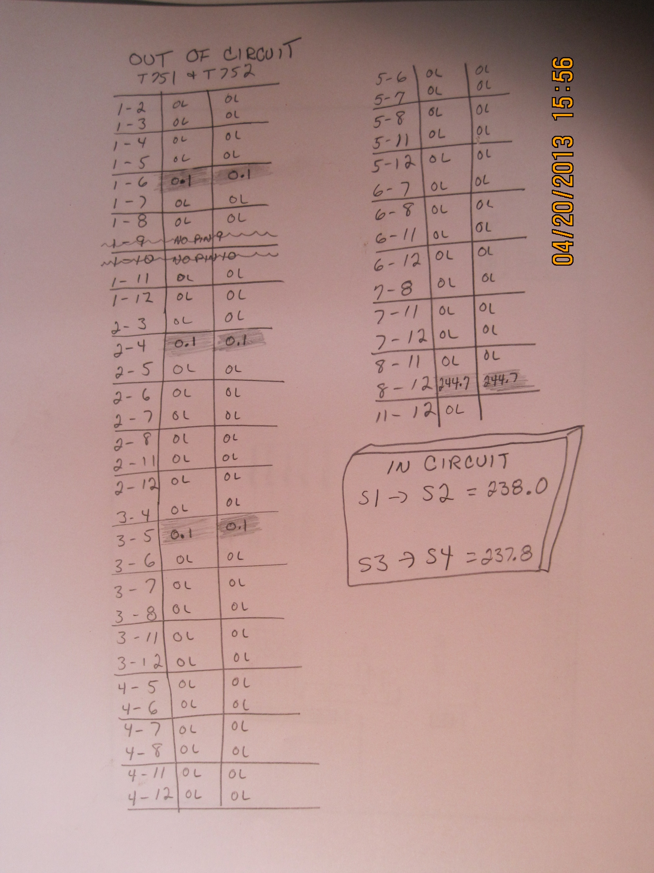

          OK perhaps not much point proceeding if the inverter transformers have gone (unless they are cheap to replace)
          I have marked what I believe are the secondary wiring joints - Meter on ohms 2000
          test S1 to S2 and S3 to S4

            Selldoor the data attachment shows your requested ohm meter readings of S1-S2 = 238.0 ohm and S3-S4 = 237.8 ohm with the transformers installed. I was wrong when I said all the readings were showing near zero ohms. The transformers are ok.
            Budm the data attachment shows all pin to pin resistance measurements taken with the transformers removed from the pc board. My Fluke was in the "relative" mode to eliminate test lead resistance while taking these readings. Looks to me the transformers are ok.

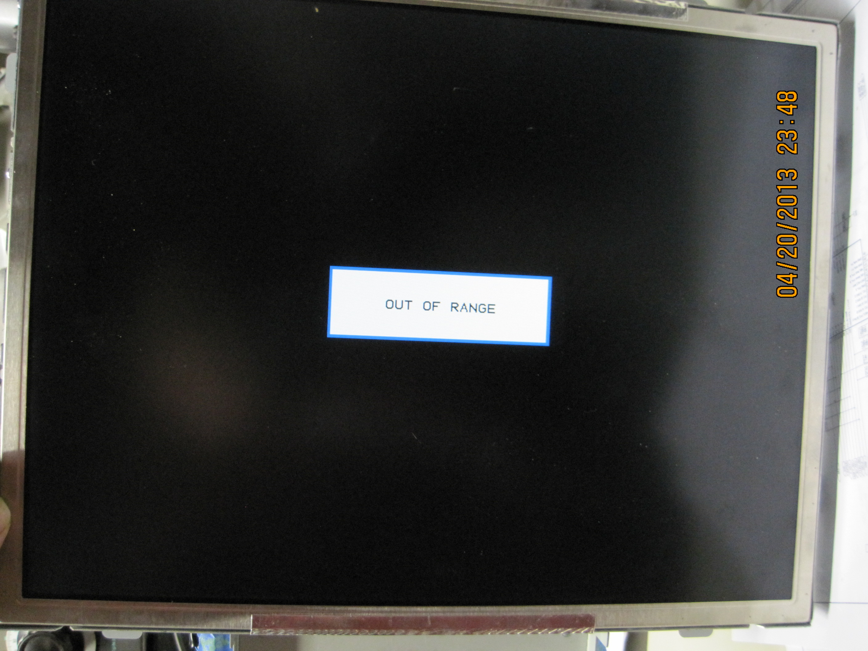

                Well I should have done some testing before I disassembled it. With the video cable disconnected the display works indicating "NO SIGNAL" for the 1 second then goes dark.

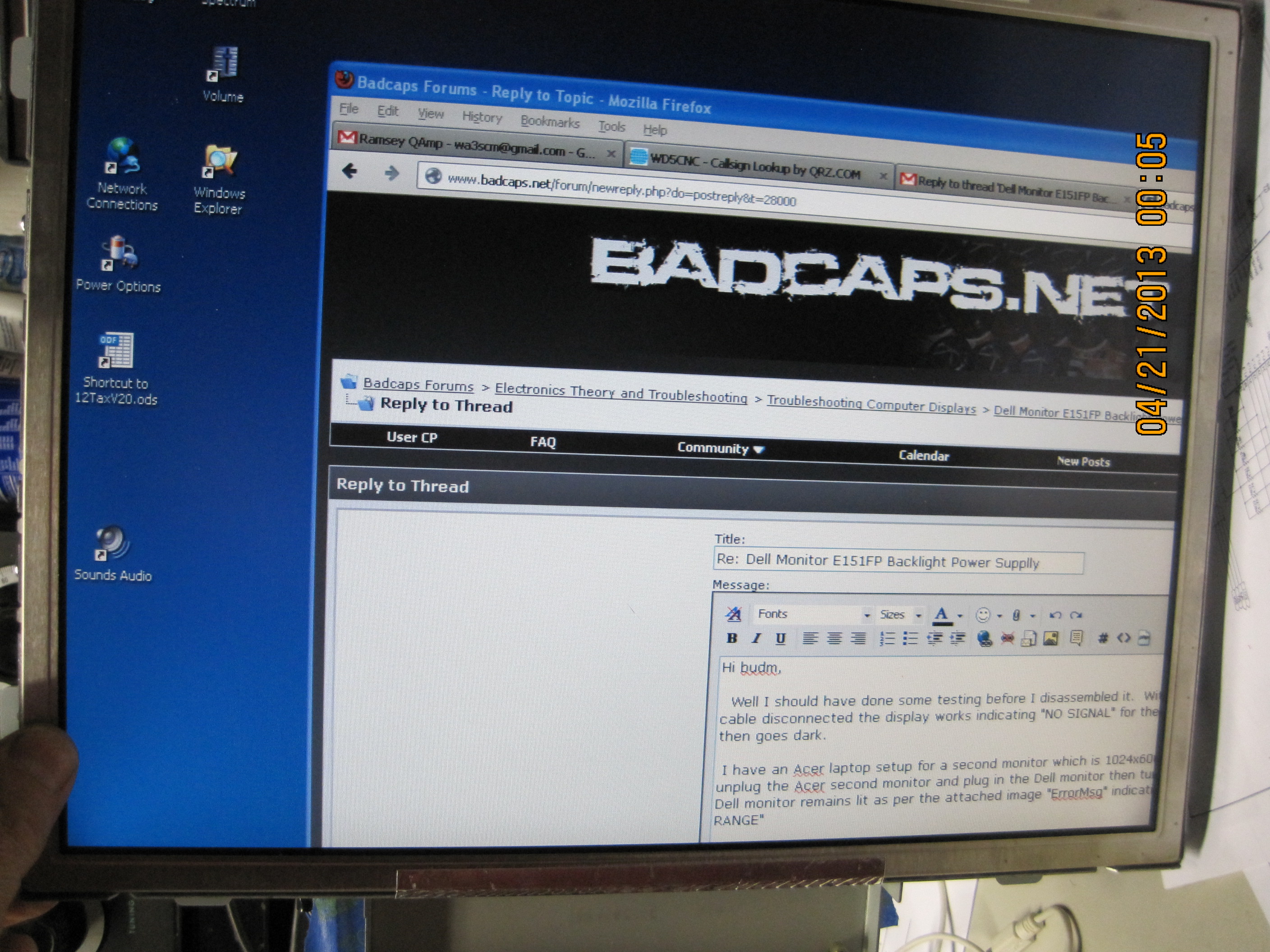

                I have an Acer laptop setup for a second monitor which is 1024x600. When I unplug the Acer second monitor and plug in the Dell monitor then turn it on the Dell monitor remains lit as per the attached image "ErrorMsg" indicating "OUT OF RANGE"
                Readjusting the Acer second monitor display setting to 800x600 then attaching the Dell monitor showed the monitor is now working as per the attached image "800x600Success, and the LED is Green.
                Sorry I did not start off cycling power and verifying the problem before I tore it apart. I did see the monitor operating in failure mode with no backlight and jumped to the conclusion it was busted. Pretty tough to find out what to fix on something that is not broken.
                Thanks for your help budm and I apologize for wasting your time.
