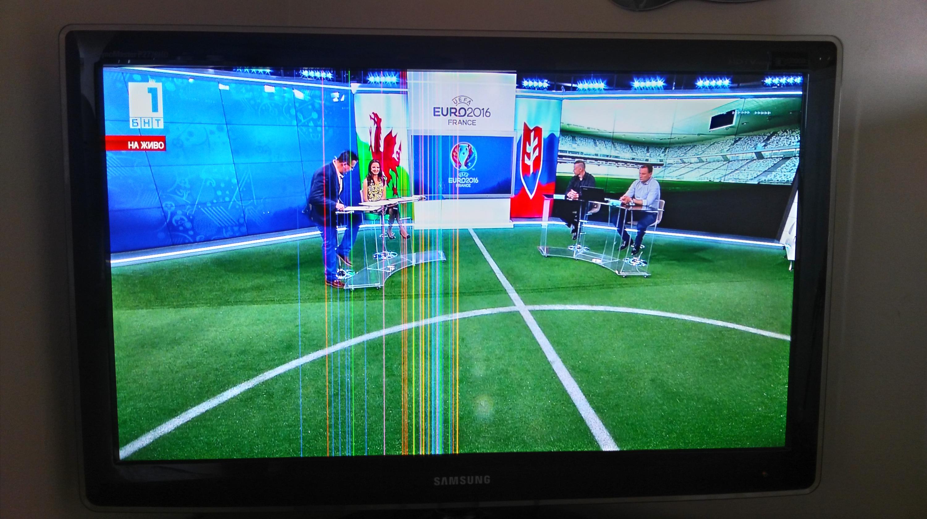

      Hi.
      I have a problem with this monitor.
      Can somebody tell me how cost me to repair this.
      Can i try to repair if is easy or find some electronic engineer.
      This need to me? -->http://www.aliexpress.com/item/Free-...046766802.html
      or new flat panel.
      Thanks and sorry for bad English
