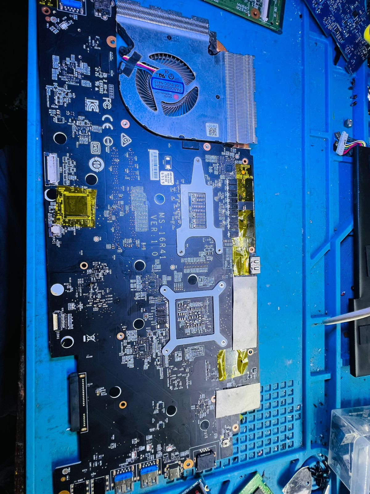

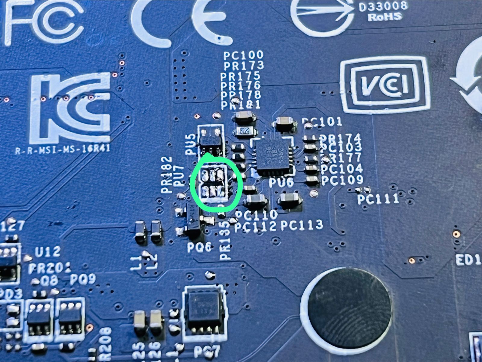

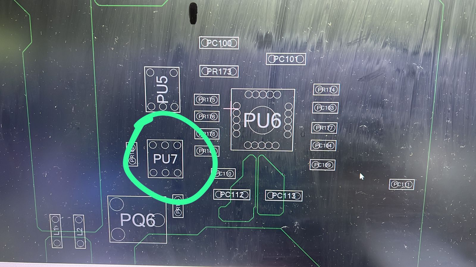

    ANYONE HELP ME TO FIND THIS COMPONNET...(​​​​​​​PU7)
    I MISSING THIS PART RECENTLY..
    I NEED TO FIND IC MODEL..AND SIMILER PART..
    PHOTOS ATTACHED
    THANKS

    Pu7
    ,STD LOGIC OTHERS,ON Semiconductor/NL27WZ14DFT2G,SC70-6pin,1.65V,5.5V,,RoHS COMPLIANCE
    STD LOGIC OTHERS,FAIRCHILD/NC7WZ14P6X,SMT/SC-70,1.65V,5.5V,,RoHS COMPLIANCE

          Originally posted by madushanka 1234
          NL27WZ14DFT2G OR /NC7WZ14P6X BOTH SAME??
          Yes

            HOW I FIND THIS CHIP?U KNOW THIS PART AVILABLE SIMILER BOARD MODELS??? THXX
            • mon2
              • Dec 2019
              • 14589
              1) Use lower case letters in your posts.
              2) Goto Google and search for 'NC7WZ14P6X'
              Here is one of many links to part suppliers:
              https://www.mouser.ca/ProductDetail/...hoCzwcQAvD_BwE
