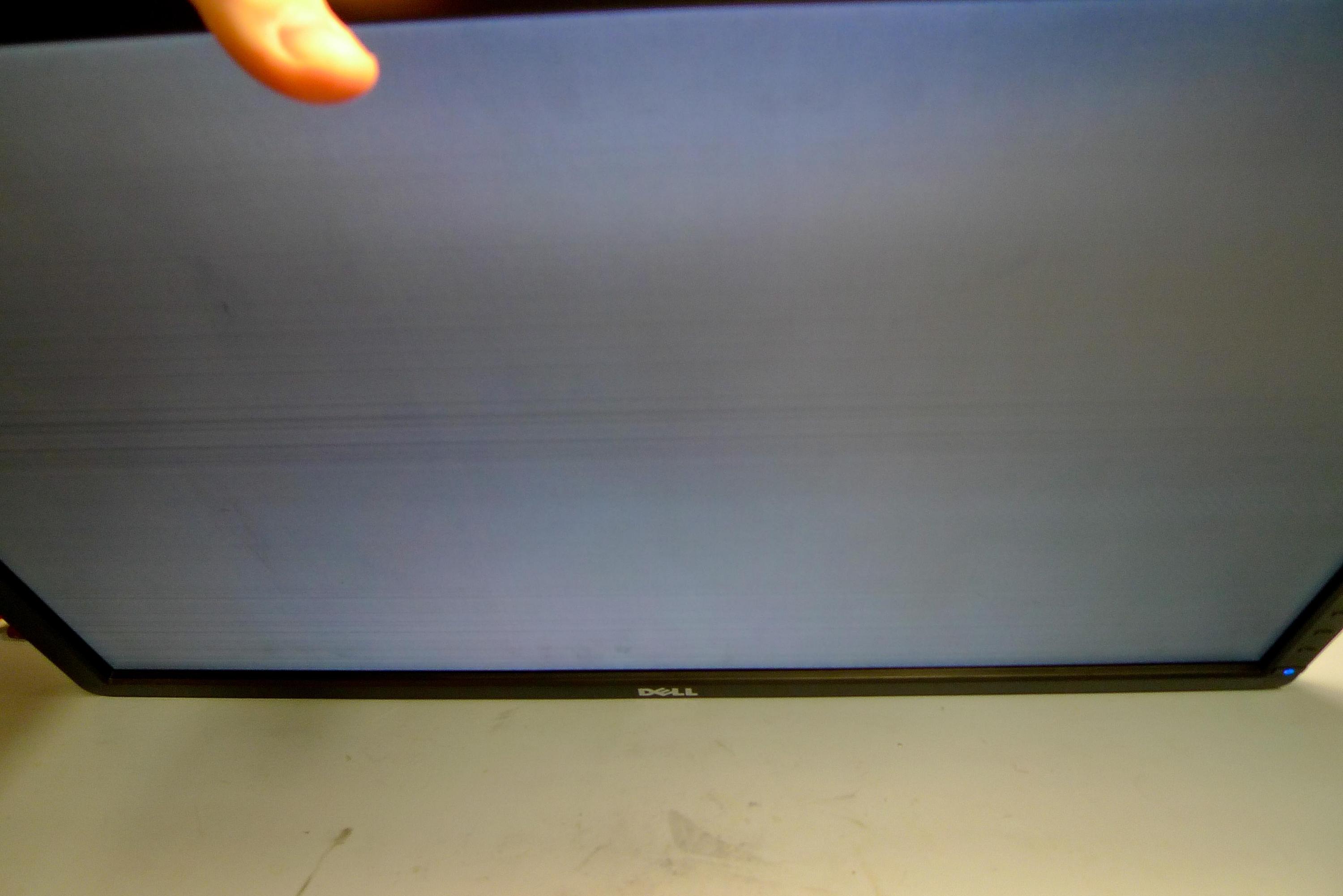

    So I actually paid for this monitor cause I was hoping it'd work, but then the person that sent it lied about the condition and ebay says too bad so sad... So now I'm stuck with it or resell it.

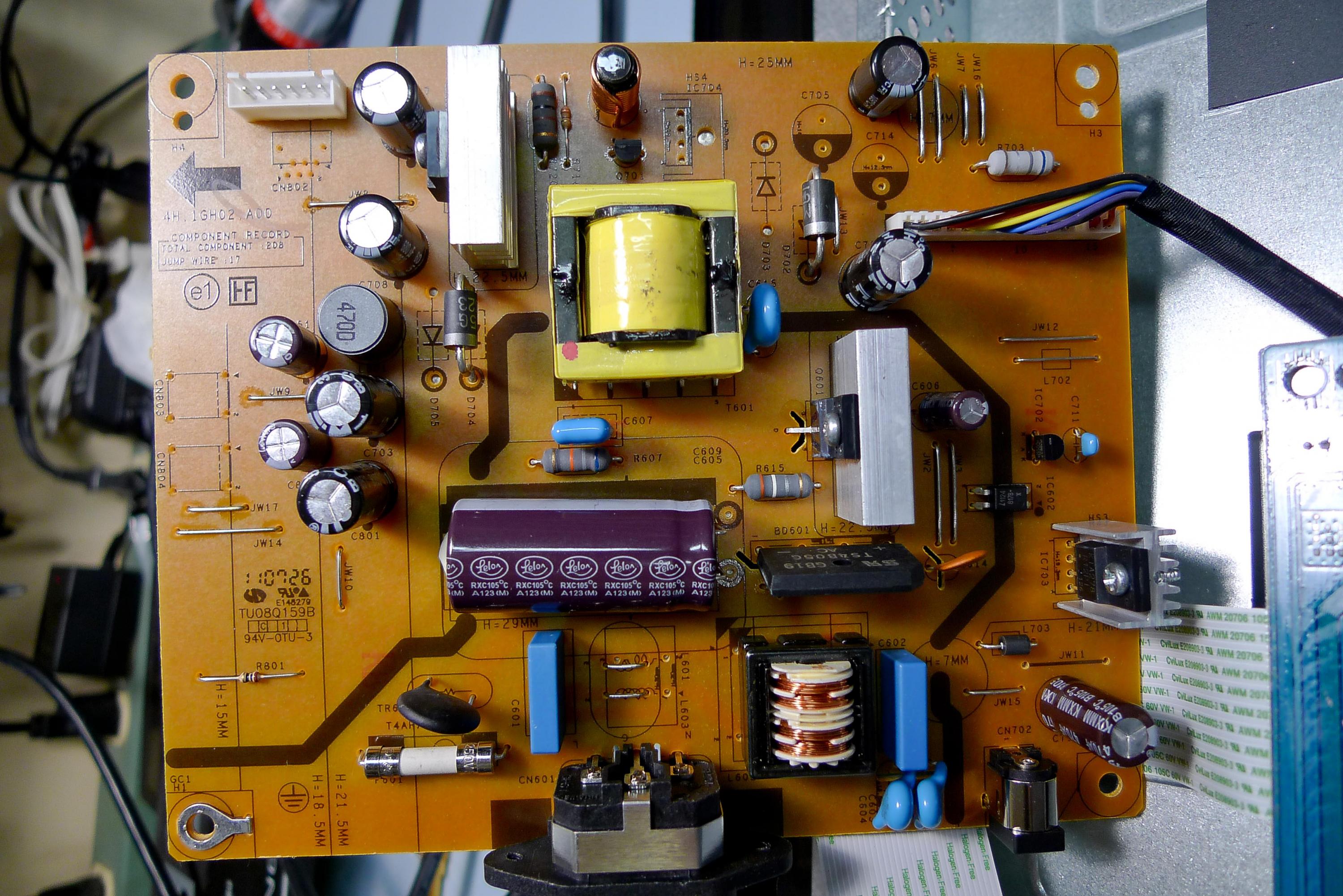

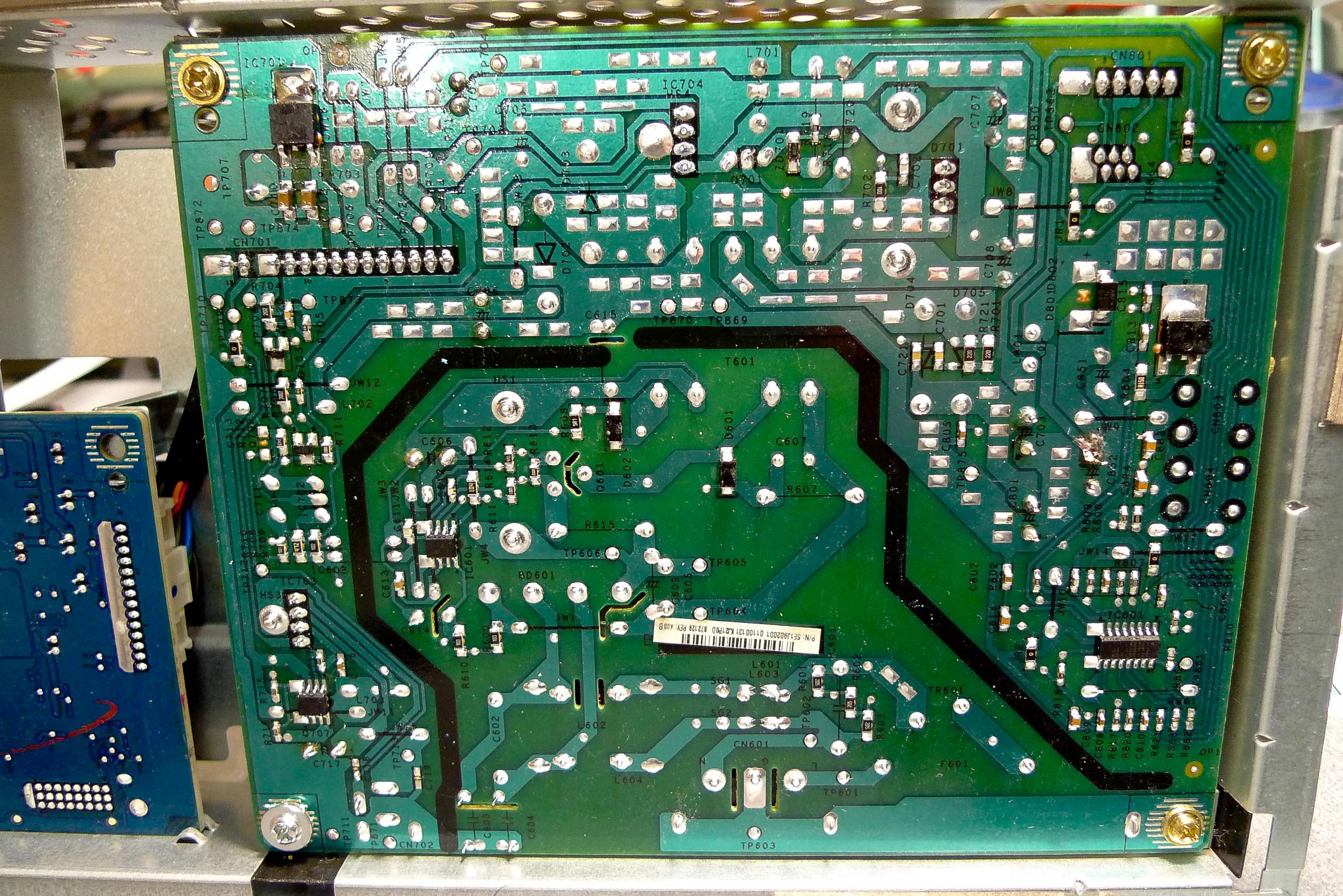

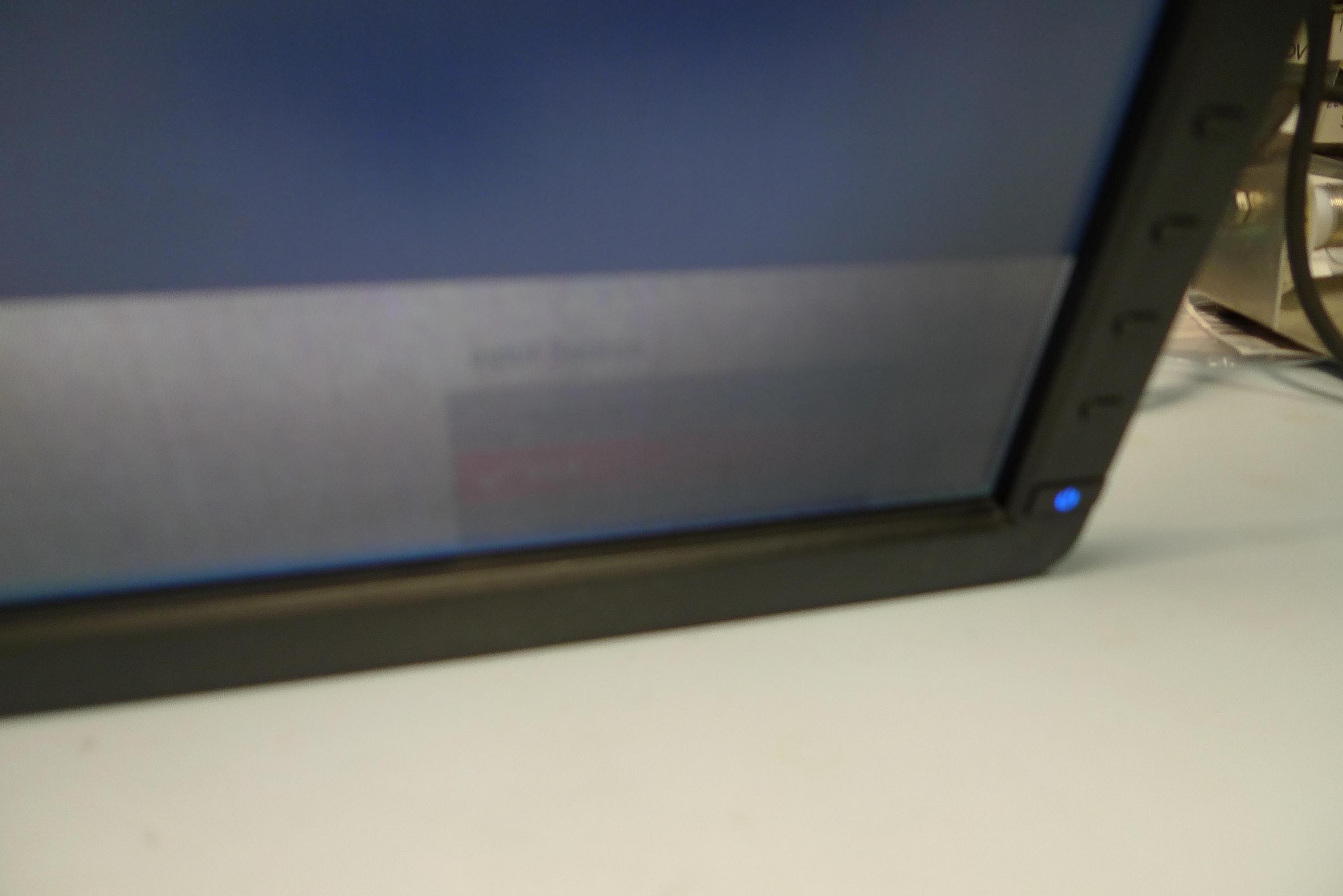

    Originally it didn't turn on at all, replaced all the caps on the power supply, and now it turns on but you see vertical lines across it and after a little bit the lines go away and is a solid color. So then I start pressing buttons and nothing pops up. Once in a great while, the lower have pops through and can see the menu.

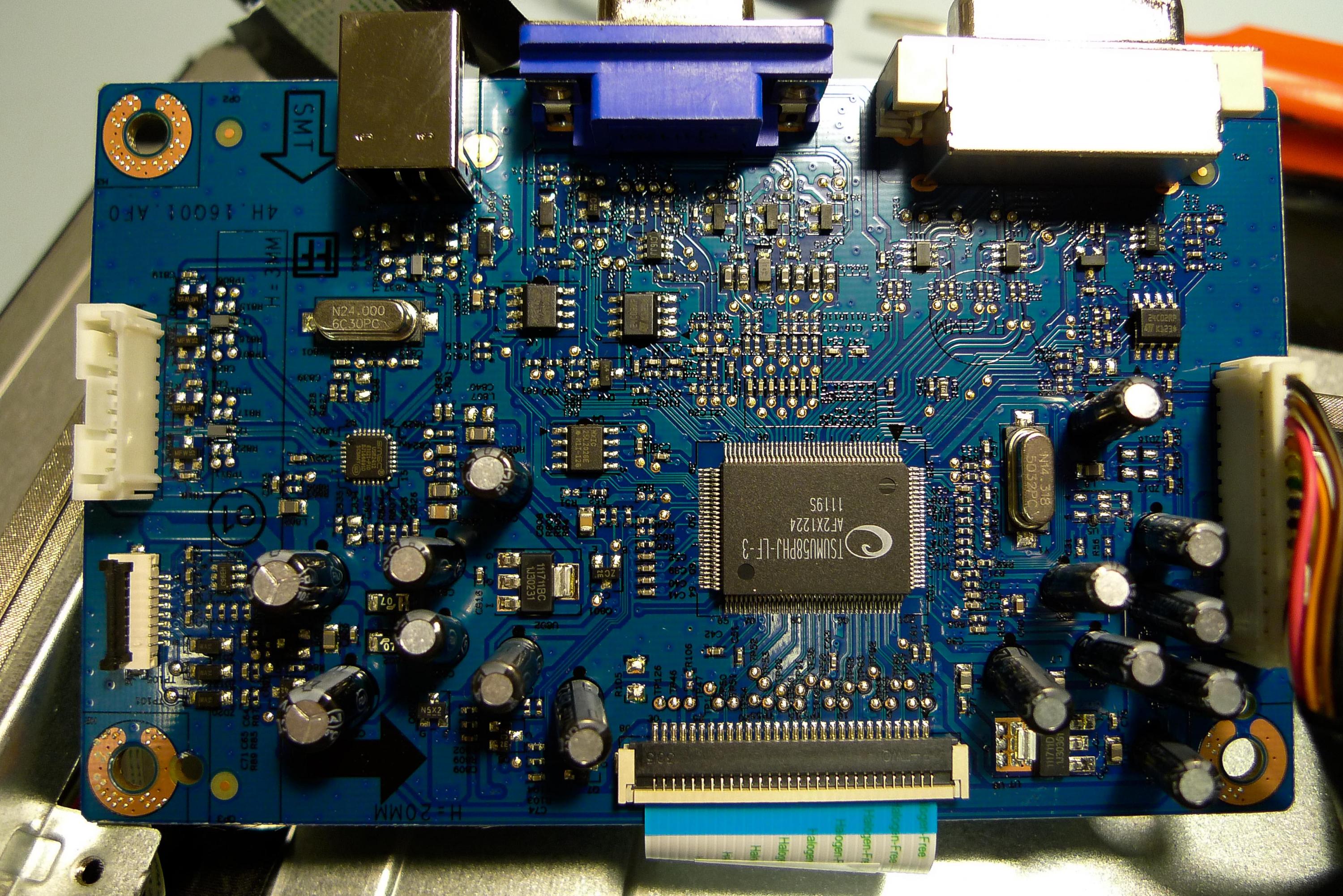

          Try heating parts of the boards with hairdryer, see if the monitor comes to life. Or try tapping the circuit boards. Sounds like a a bad connection somewhere.

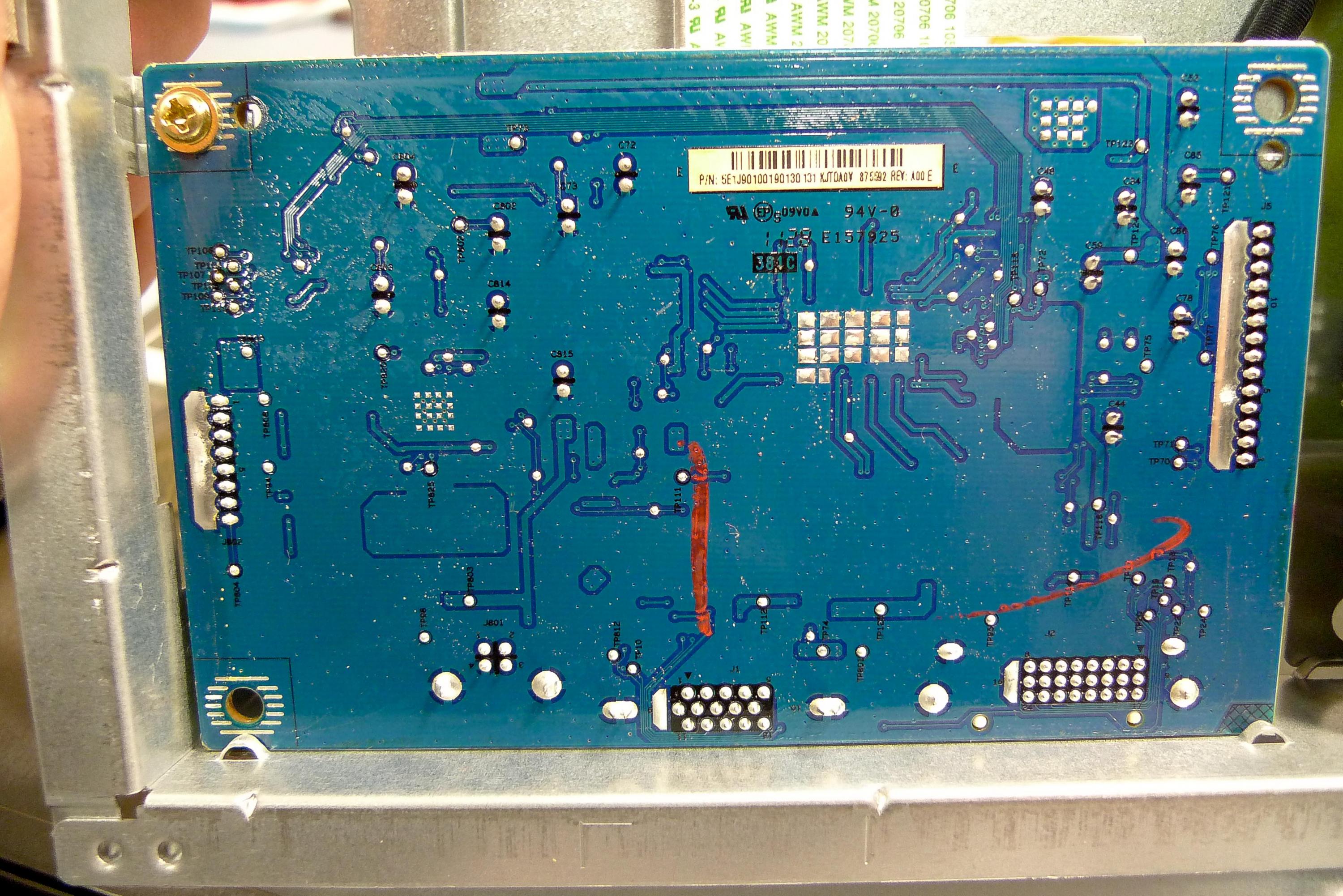

              As Ben 7 says - may be loose connection - try removing cleaning and reseating the LVDS ribbon - - both ends.
              There are two voltage regulators on the main board can
              you check them as per retiredcaps link. One is U602 cant make out the other.

                Is it the same using vga or dvi
