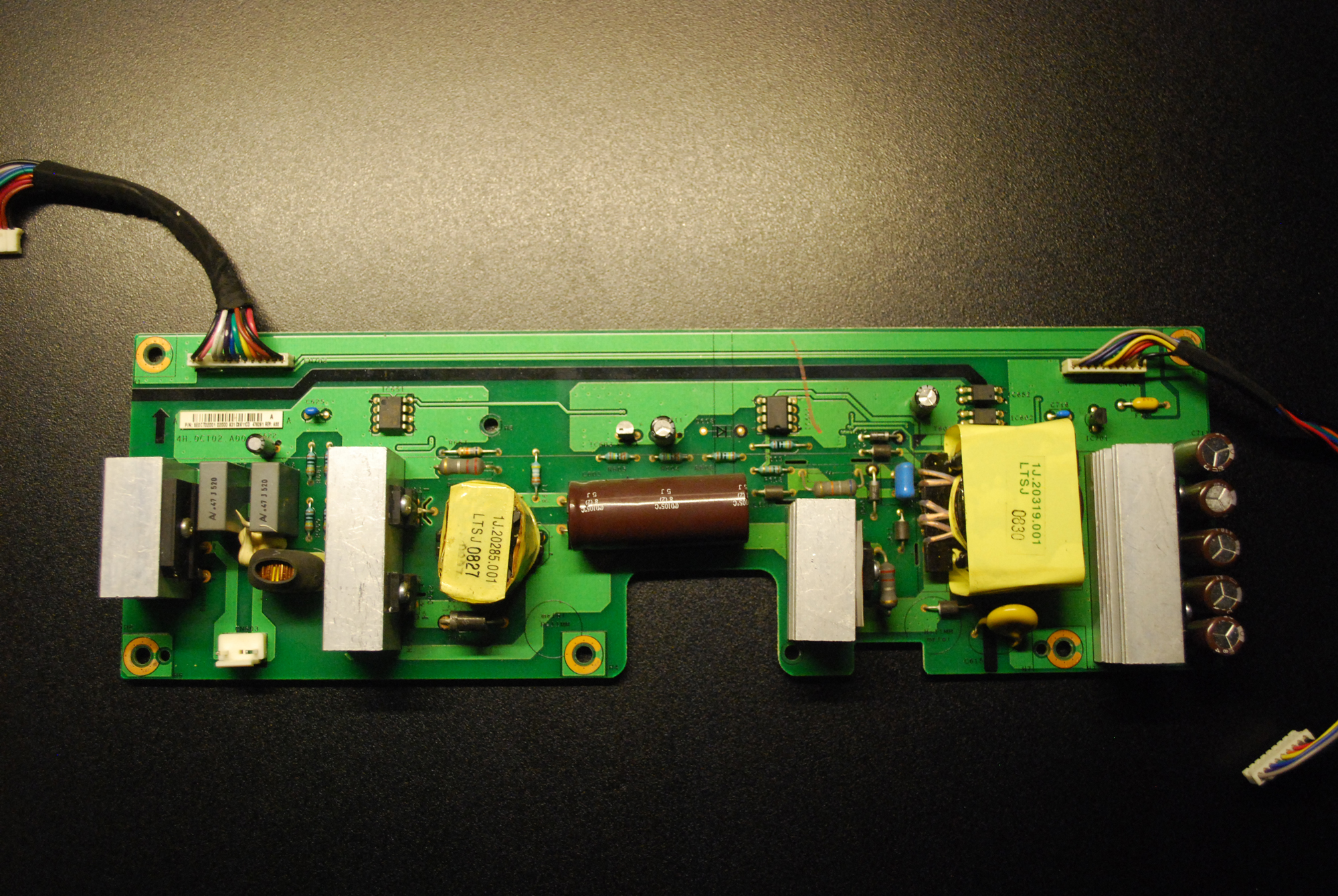

    Hi Guys
    Back again this time with the above monitor. It displays no power symptoms and I can hear a clicking sound from the right most transformer T601. This sound is present with and without mainboard or backlight board connected.
    The main capacitor reads 320v and there is no voltage on the cold side of the transformer.
    IC601 is marked 1203P60 CPET 0823G
    Pin6 is Vcc and voltages continually jump between 6 and 11 v.
    Torpedo fuse F701 is open circuit.
    The five cold side capacitors all gave reasonable readings although tested in circuit. I checked all obvious diodes for a short but found nothing.
    My research found another thread on this monitor
    https://www.badcaps.net/forum/showth...highlight=2408
    however it was a different problem and it ended without conclusion. It does suggest though I'm looking for 23v out to the mainboard whilst on standby.
    All help appreciated.

    Re: Dell 2408WFPb Monitor - No Power
    Clicking/ticking and a fluctuating voltage on IC VCC suggests one or more of the following:
    a) bad startup cap (maybe it is the one above the large filter cap)
    b) bad SMPS IC
    c) shorted component on the output side

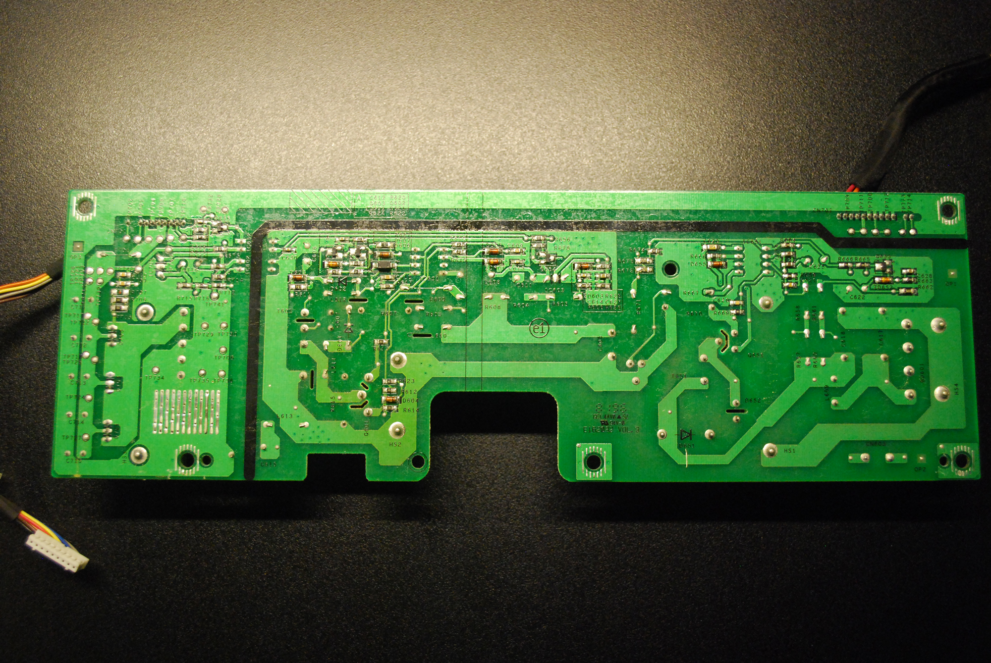

                                        Ok - Can we get back to checking the voltage at the BIG cap
                                        Carefully could be 400vdc set meter on 600vdc probe on each leg.
                                        Tets it for a while - does it vary in time with ticking.
                                        Can you post good clear picture of your boards
                                        whole chassis, and then pictures of each board, front and back (in the same orientation) and close up of connectors, (max resolution 2000x2000 and 2MB) using the manage attachments button, which is found by clicking "go advanced" under quick reply.
                                        Examples of what is needed
                                        https://www.badcaps.net/forum/attach...7&d=1280167246
                                        https://www.badcaps.net/forum/attach...6&d=1280167246
                                        https://www.badcaps.net/forum/attach...4&d=1280167246
