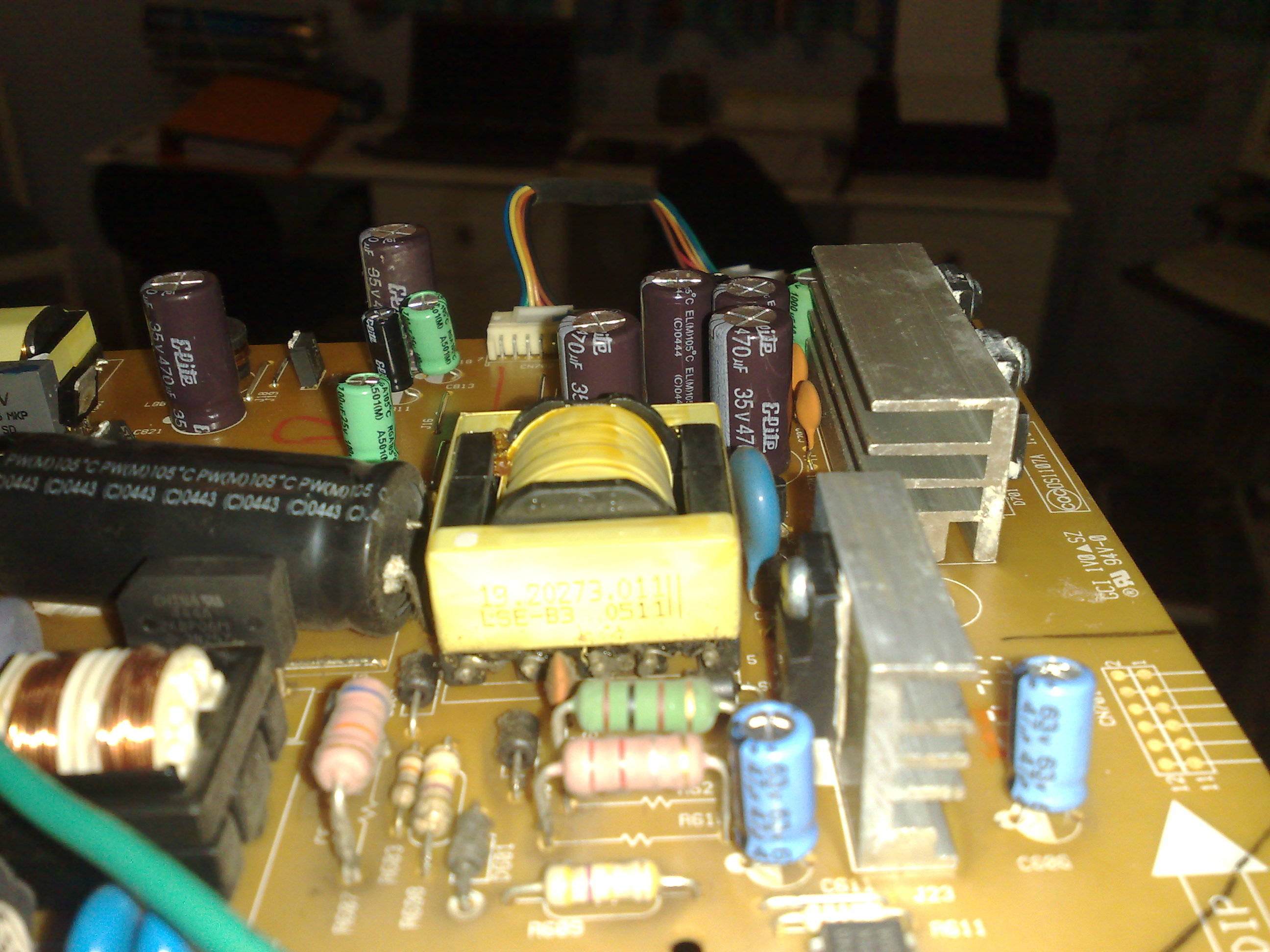

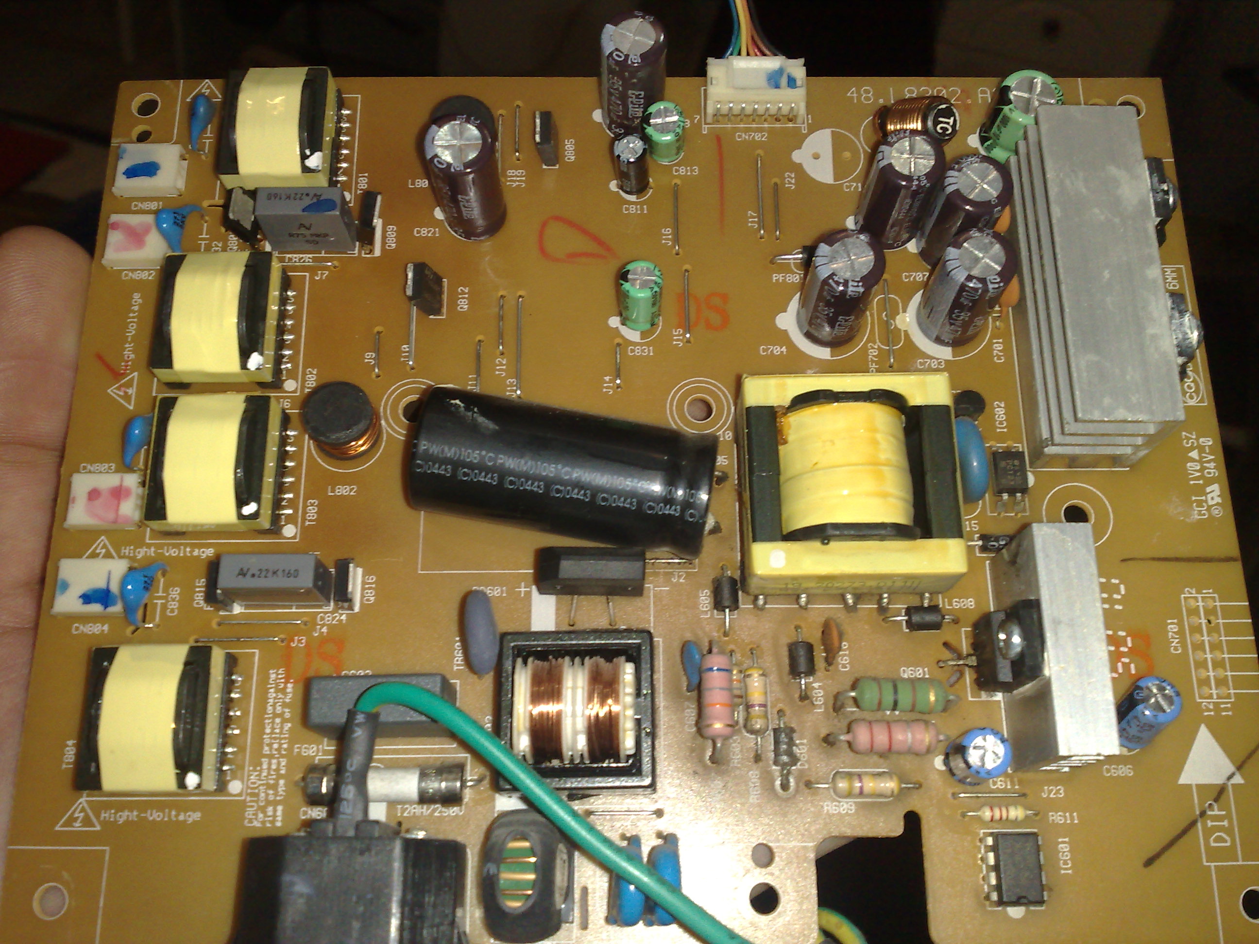

    I have this Benq Q7T3 monitor that has no power.
    What I have done:
    - I checked the fuse and it seems fine
    - I looked at the caps and their appearance is fine
    - I tested the C5707 transistors and their resistance is much more than 20 although at the back of the board they don't look good.
    - tested the big cap and the voltage is 320V
    Any help please?
    Thanks,
    Matthew
  • retiredcaps
    • Apr 2010
    • 9271
    Re: Benq Q7T3 - No Power
    Check Q805 and Q812 for shorts. They are likely FU9024. See if PF801 fuse is open or not.
    PS. This board is widely documented with all the known problems.

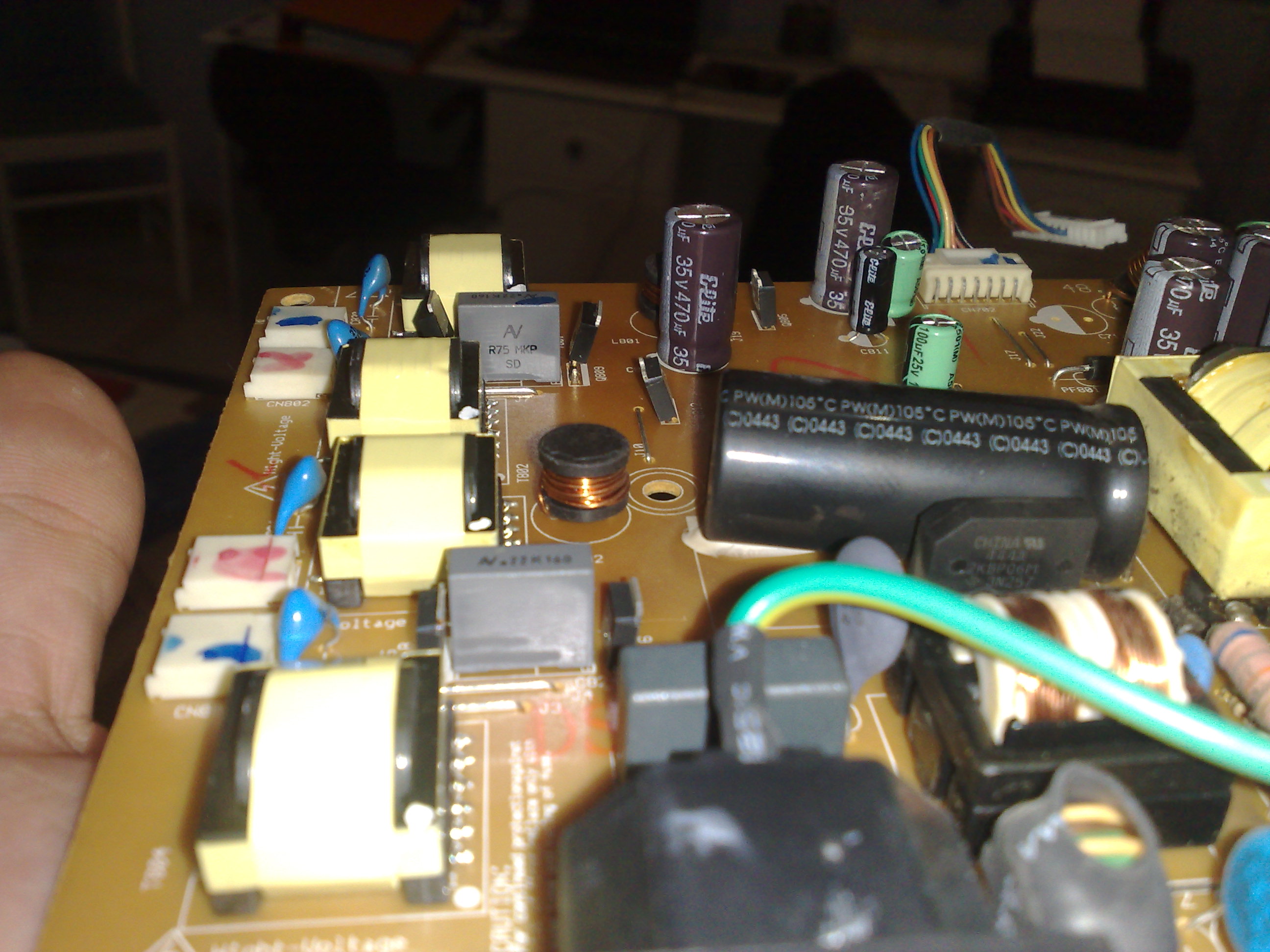

                • selldoor
                  Slow Learner
                  • Dec 2010
                  • 7870
                  Too many numbers - Transformer 4 looks definitely off ( your not having much luck)
                  I attach a pic which I think shows the joints for the secondary windings
                  Power off meter on 2000 ohms test s1>s2 s3>s4 s5>s6 s7>s8
                  looks like there maybe 2 pins for each S number - just check that that are
                  connected together. If it is one of these:
                  http://www.ipertronica.it/catalogo/R...26038001-35586
                  ti parlano italiano?
                  • matthmal
                    • Nov 2012
                    • 306
                    • Malta
                    we for every s number there is only one leg, the other is only solder.
                    Here are the readings
                    S1 to S2 -> 203
                    S3 to S4 -> 202
                    S5 to S6 -> 203
                    S7 to S8 -> 198
