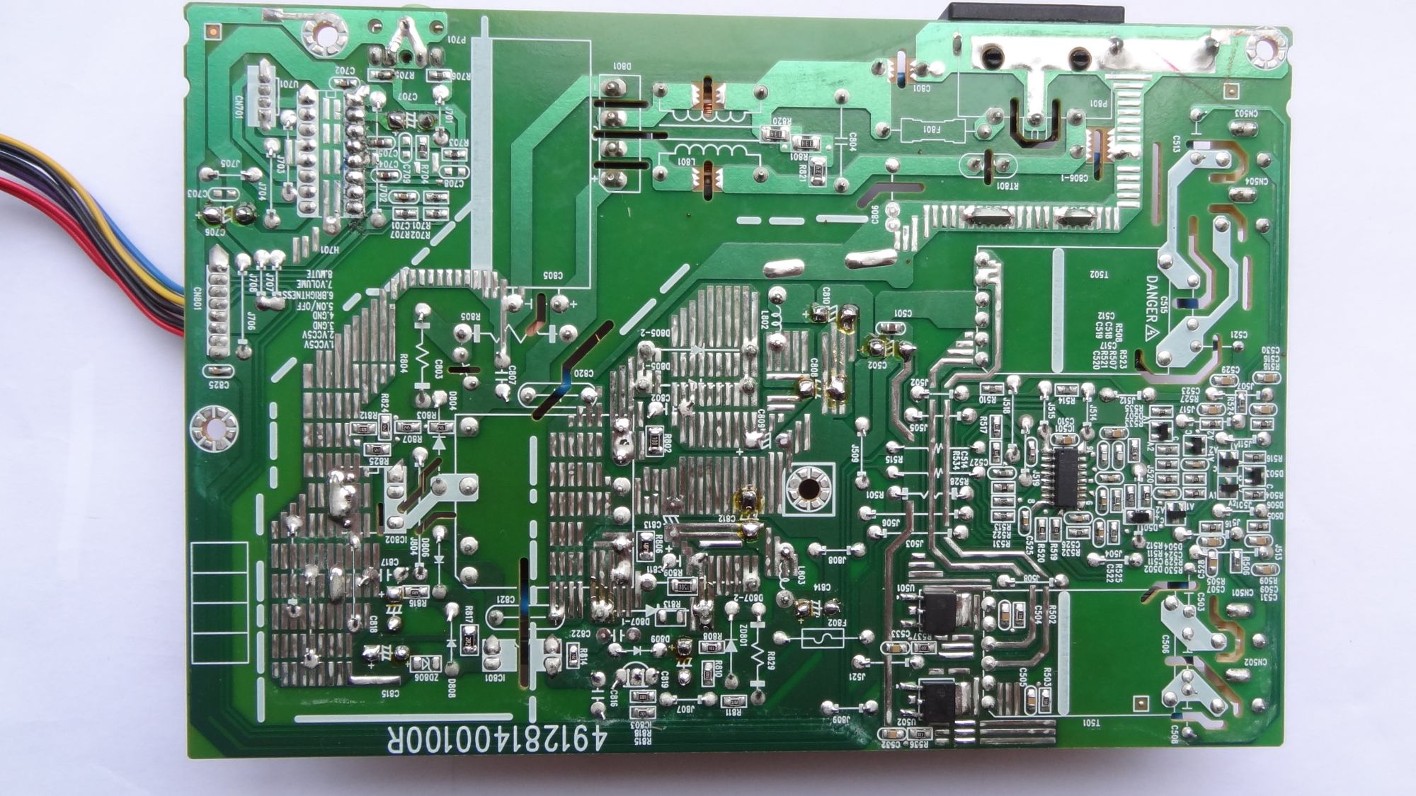

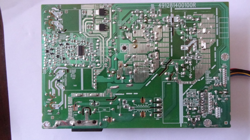

    I am trying to repair an Hyundia LCD : X93W
    When I turn on this screen, the picture is correct for two minutes, then a few blink and the picture disappear.
    But with a closed light, I can see the picture
    it is a problem with the backlight
    I have ordered the capa kit on the lcdalternatives site, changed them but the problem is still there, I was quite sure about these capas ???
    The only one, I have not changed, it is this one (100uF/450v) near the power supply, it was not in the kit
    I am not an electronicien, and I don't know what to do next
    I couldn't not find any information on this screen ?
    I put the photos of the platine
    If anybody has an idea, I will appreciate a lot

    Re: X93W lcd problem
    Hi - what is the part number on the Inverter Transformers (black rectangular components with yellow stripe on side.)
      thanks for your message
      on these two transformers I can read :
      SPW-099 Rohs
      DARFON 2080N 811087_A
        Ok - Power OFF set your meter on ohms2000 and on the end with two pins
        check the resistance on each transformer and post the results
        • yves67
          • Dec 2012
          • 16
          • France
          On the side of the connection to the CCLF, pins 7 and 8
          I found 484 ohms on one transfo and 473 on the other one
          On the other side, pins 1 to 6, found zero between any pins ??
          hope this help
            They look to be ok - we look for them to be within 3% of each other.

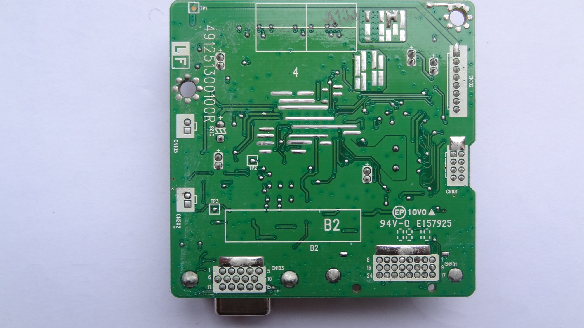

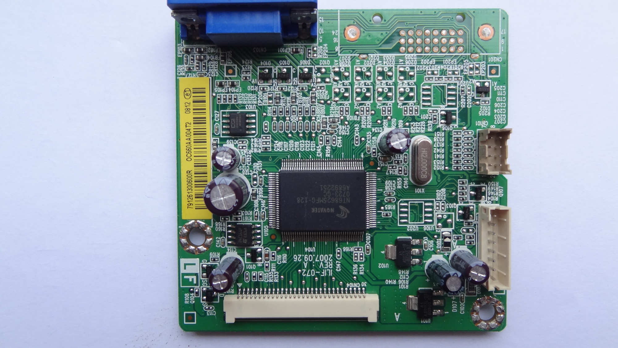

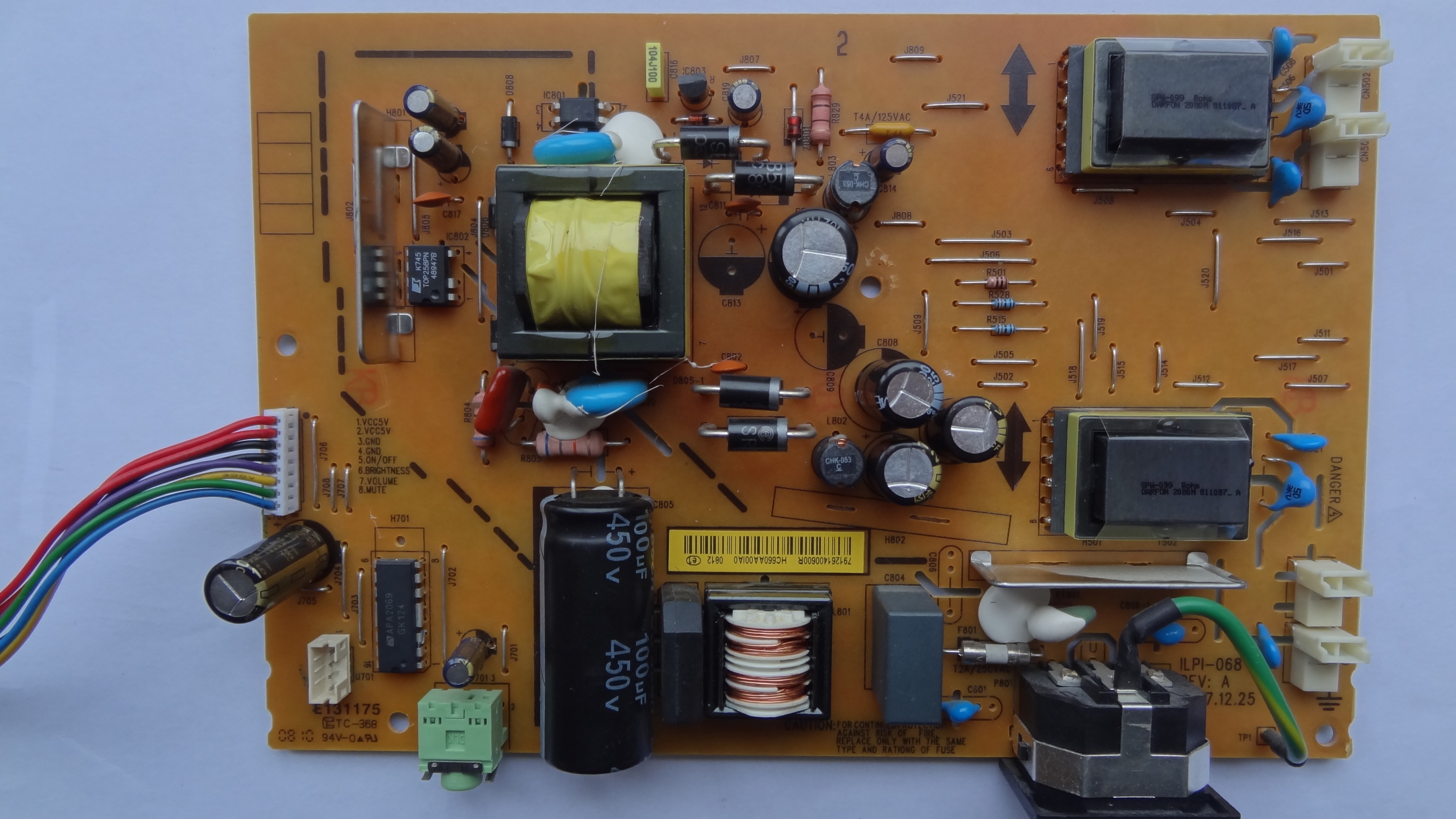

              Can you get a better picture of the bottom of the board and a picture of the top and bottom of the other (main) board
              • yves67
                • Dec 2012
                • 16
                • France
                Hello
                Here are the pictures
                The part number of the other board is : 791261300600R
                I hope these pictures are good enough
                Thaks for your help
                Yves67

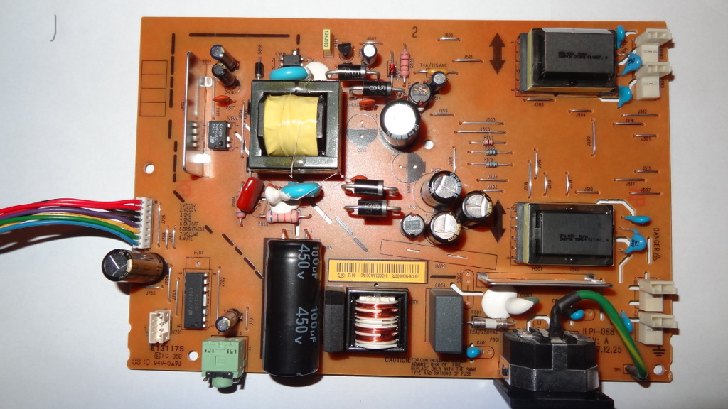

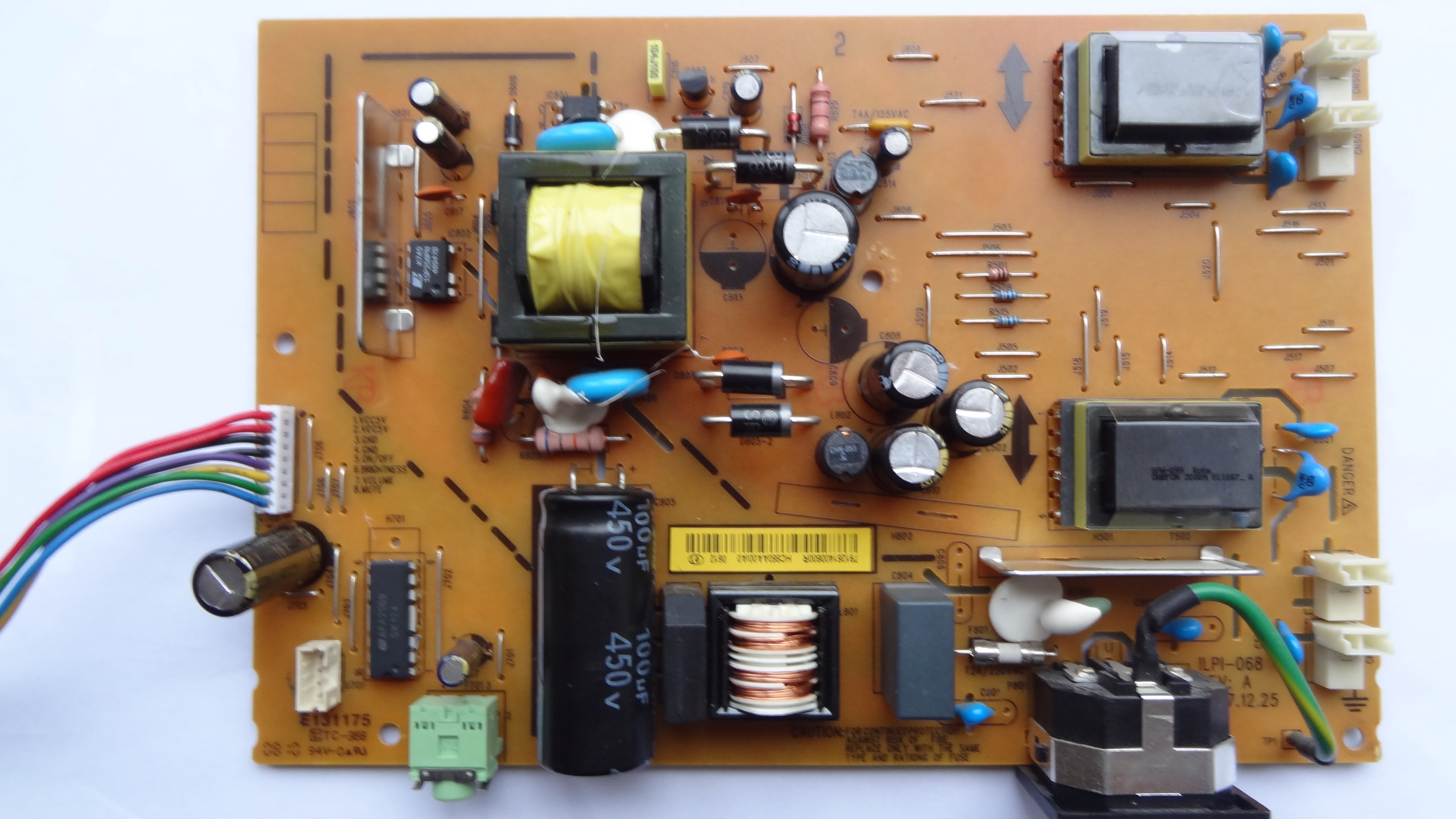

                  I put another picture with 3000 pixels
                  • yves67
                    • Dec 2012
                    • 16
                    • France
                    Another one, a little bit better
                      Do you have another monitor that you could try the ccfl bulbs in?
                      Do you have any spare ccfl bulbs or an old monitor or laptop even with a cracked screen?
                      • yves67
                        • Dec 2012
                        • 16
                        • France
                        I have one other lcd, which is working
                        but I don't have any spare ccfl bulbs
                        do you think it is the ccfl bulbs ?
                        at the start time, the four cclf bulbs are on and the picture is good
                        after two minutes, all the four cclf are off
                        • selldoor
                          Slow Learner
                          • Dec 2010
                          • 7870
                          It could be the bulbs or the wiring.
                          Turn down the brightness on the monitor and see if it stays on longer.
                            I have found on Ebay Canada the board ILPI-008
                            It is not expensive and I have ordered it
                            will see with the new board
                            I have read the posts about ILPI-068 but there is no solution...
                            I will post the result as soon as I got the new board
                            Thanks a lot
                              Thanks a lot
                              I hope that is a spelling mistake otherwise you may have the wrong board?
                              Perhaps you should have tested the bulbs/wiring first
                                Yes, it can be bad wiring on the lamp assemblies:
                                http://s807.photobucket.com/albums/y...klight%20lamp/
                                Test lamps:
                                http://s807.photobucket.com/albums/y...g%20old%20CFL/
                                  yes it is a spelling mistake, I have oredered it using the part number
                                  BTW I have found another hyndia LCD which is working and I will use it to test the lamps
                                  I will keep you inform
                                  thanks
                                  • yves67
                                    • Dec 2012
                                    • 16
                                    • France
                                    Hello
                                    I made some progress, I opened the other Hyndia LCD and connect the lamps to the other one, and it is working....
                                    that means that the problem is in the lamps
                                    may I connect one lamp from one screen and the other to the other one ?
                                    are the lamps independant ?
                                      Not absolutely sure what you mean.
                                      You can disconnect one lamp at a time and connect one from the other machine, to try and find which is faulty.
                                        or you can set up the second machine and test one lamp at time from the z93w
