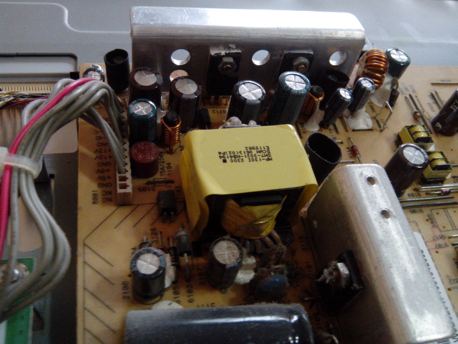

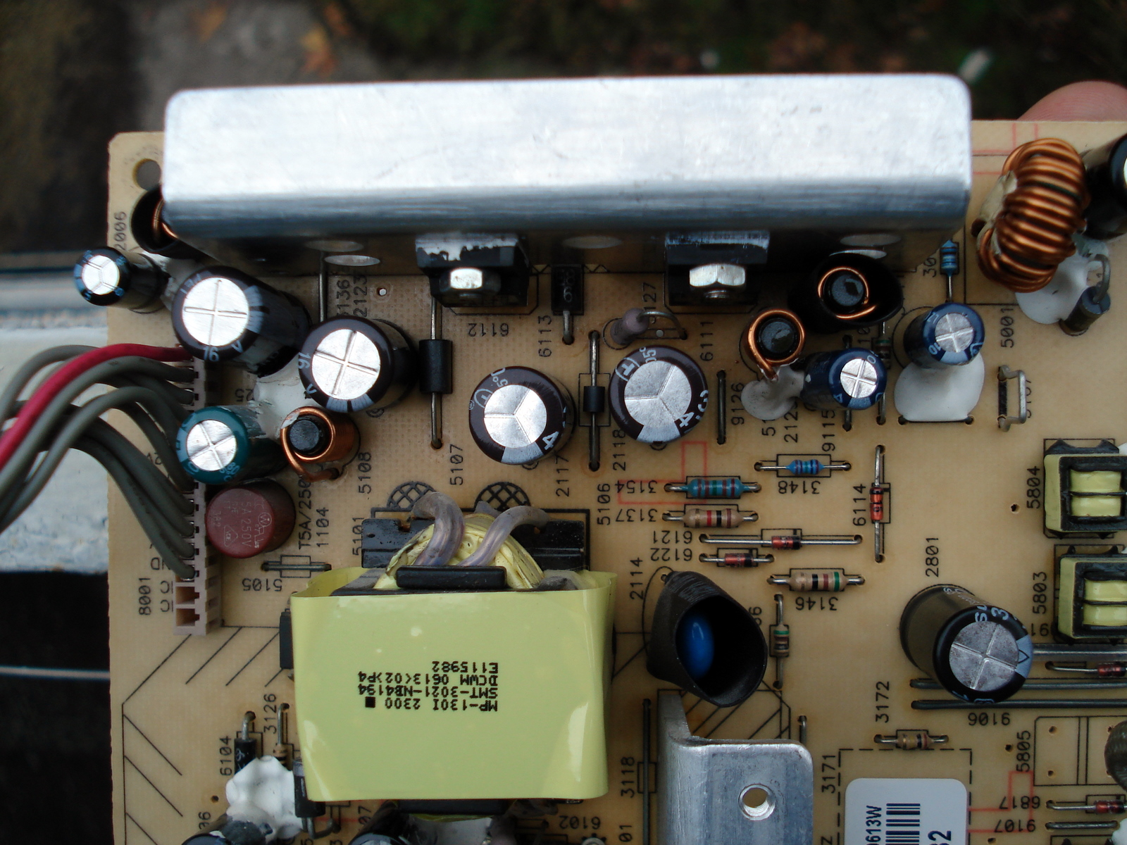

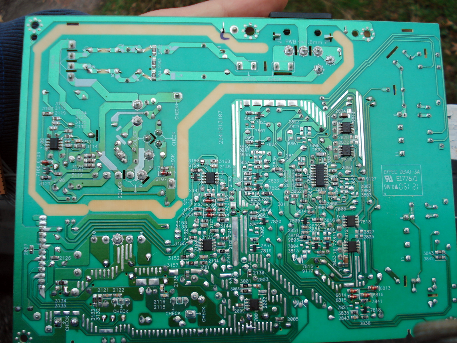

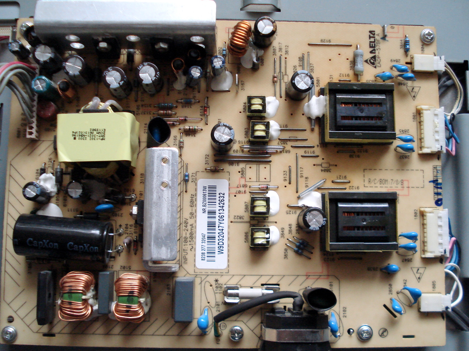

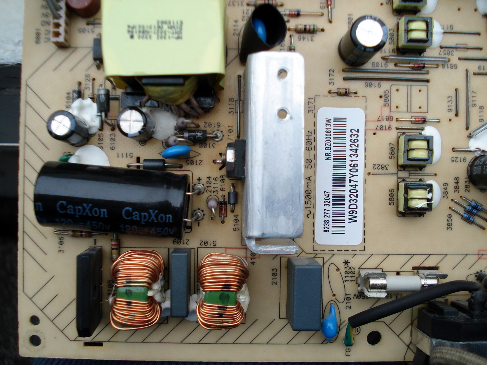

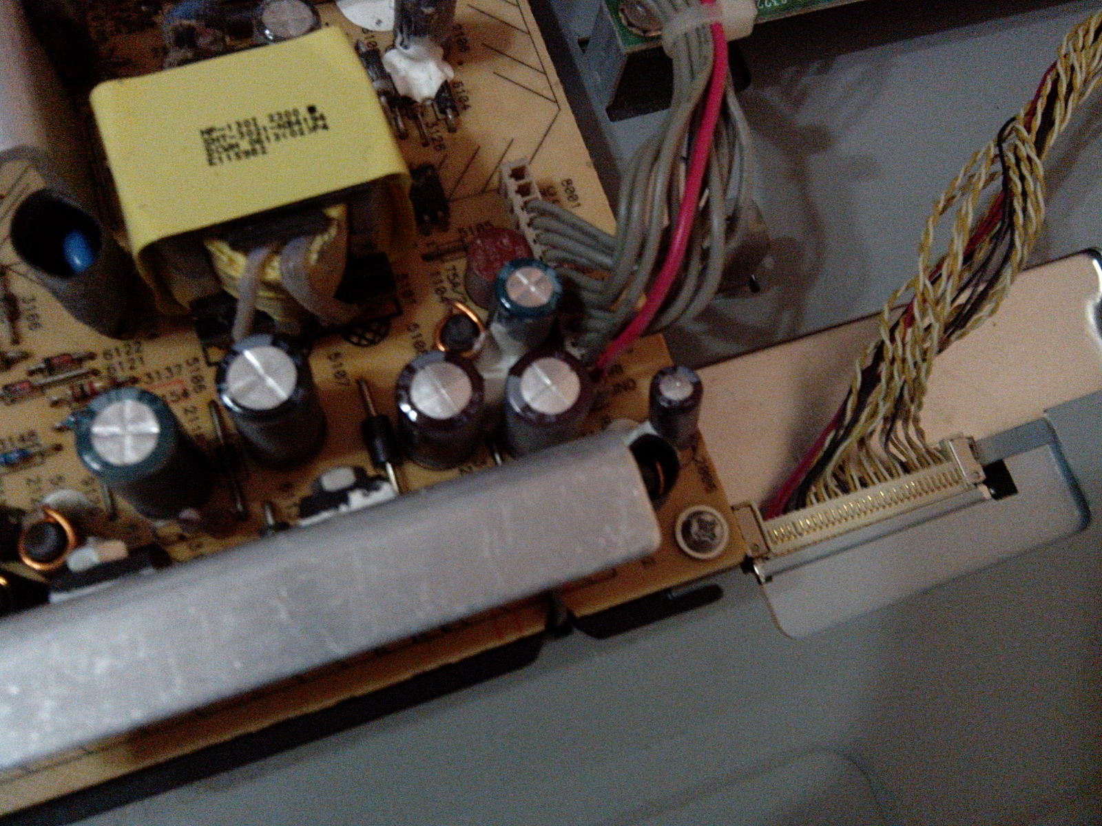

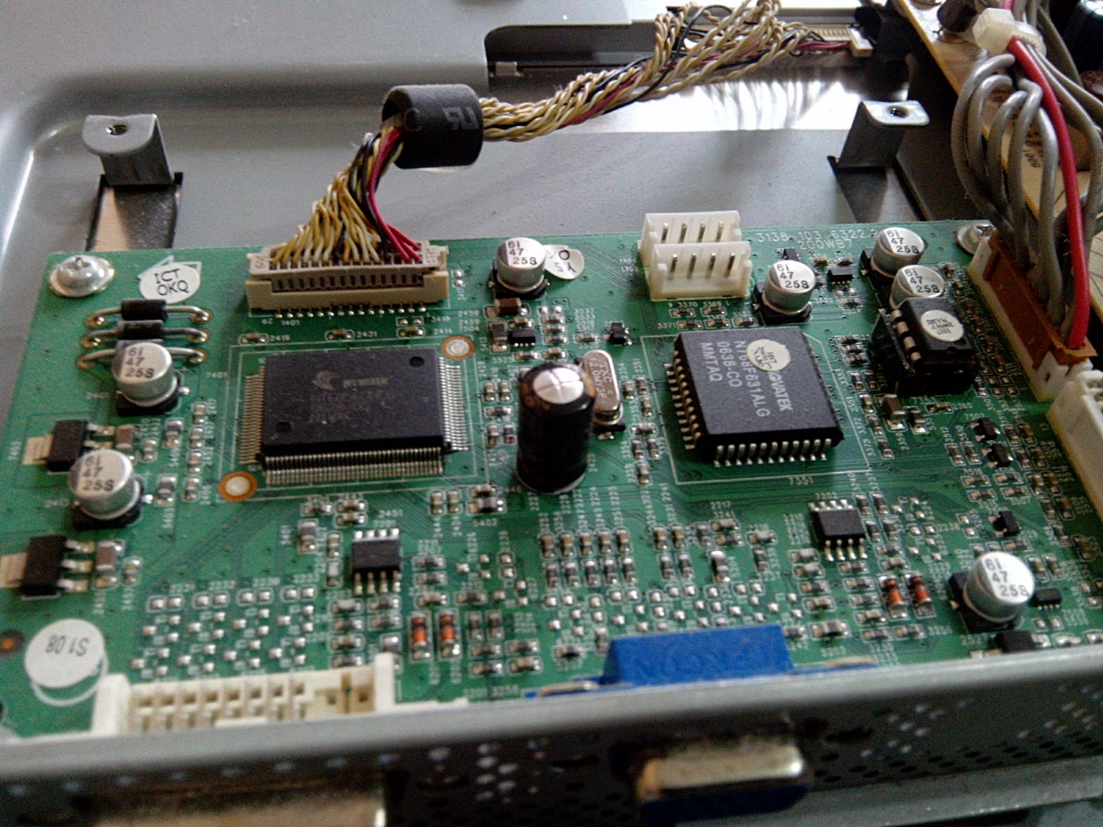

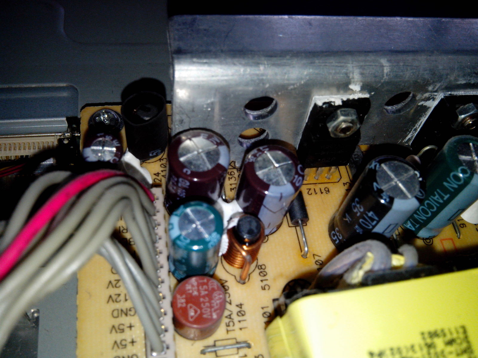

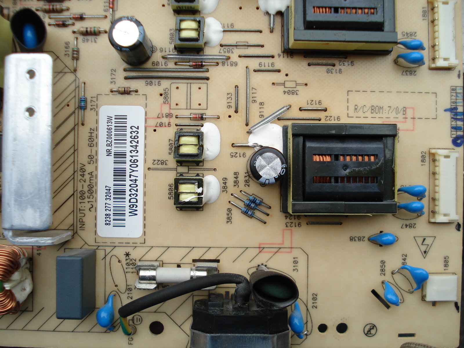

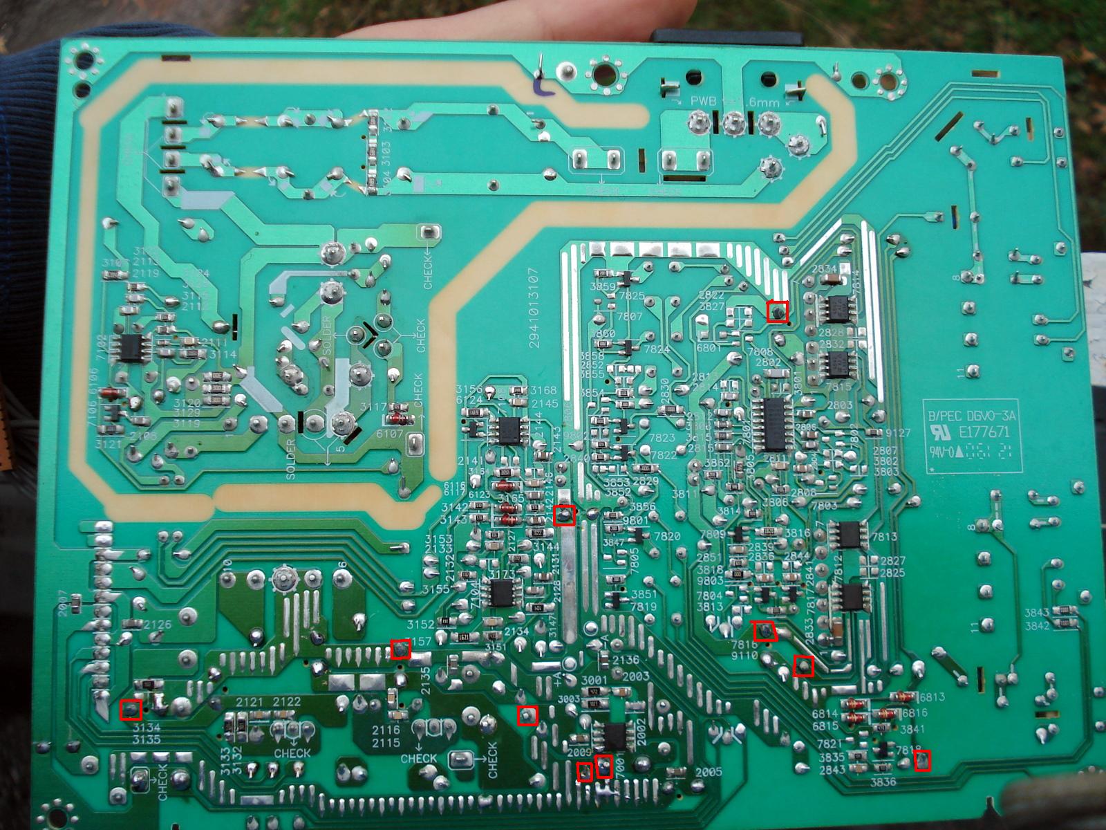

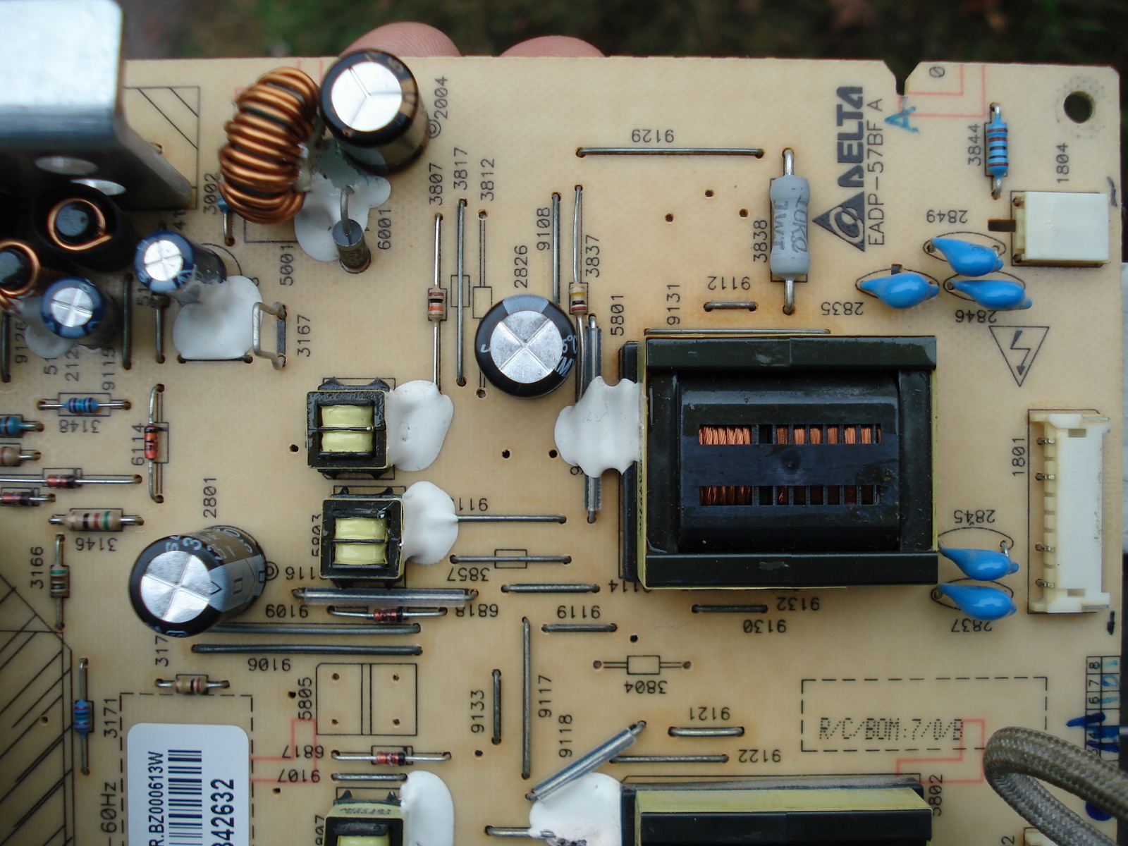

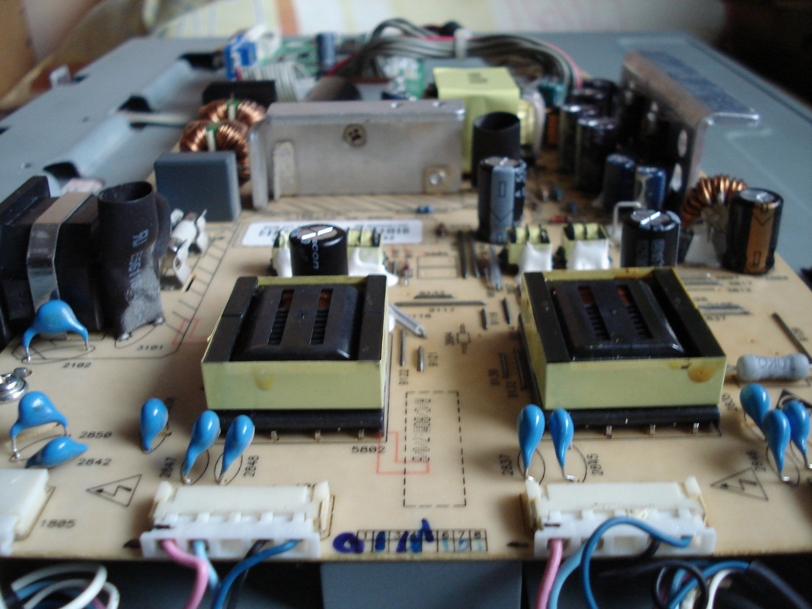

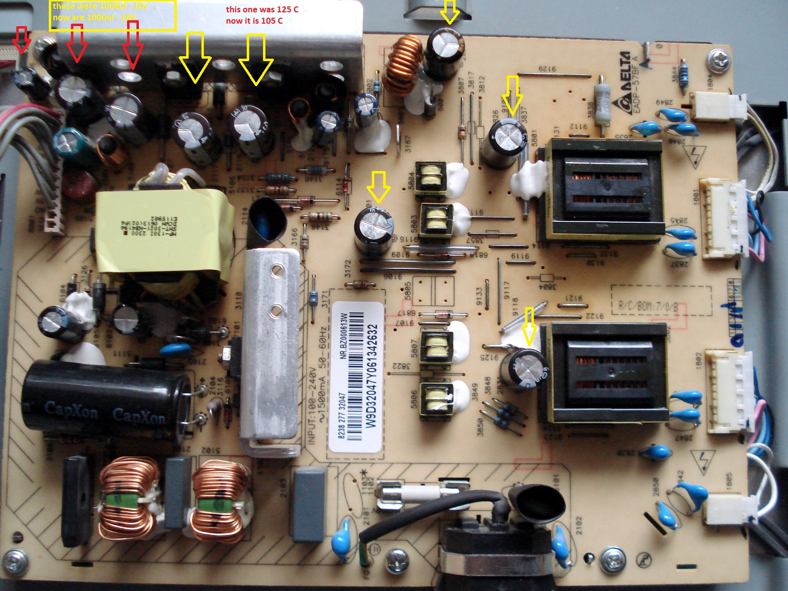

                      I took some pictures, I hope that they are good enough.
                      I have changed with caps I have found in the nearest techshop. I am not sure what is their quality.
                      Red arrows (on the 2nd photo) are the caps which were bulged and I have changed them first. Yellow ones are the second change. And there are 5 left, which I have not changed.
                      Last 4 pics are with the bad caps, I have shot with my phone, before changing them.

                        Re: Philips 200WP - random shutting down and "no video input" while PC is in sleep mo

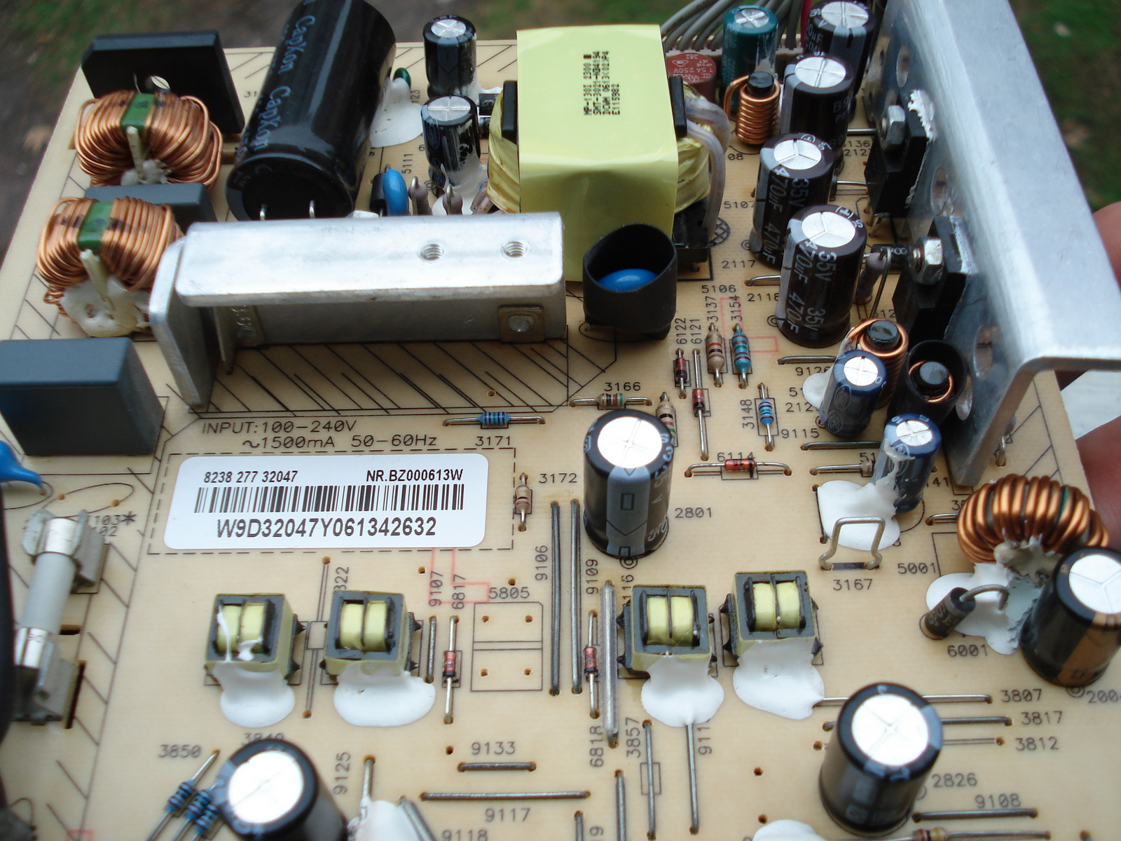

                        more detailed view on the top of the power board.
                        maybe it will be easier for me to buy a new board, but I am not sure if the problem is there.

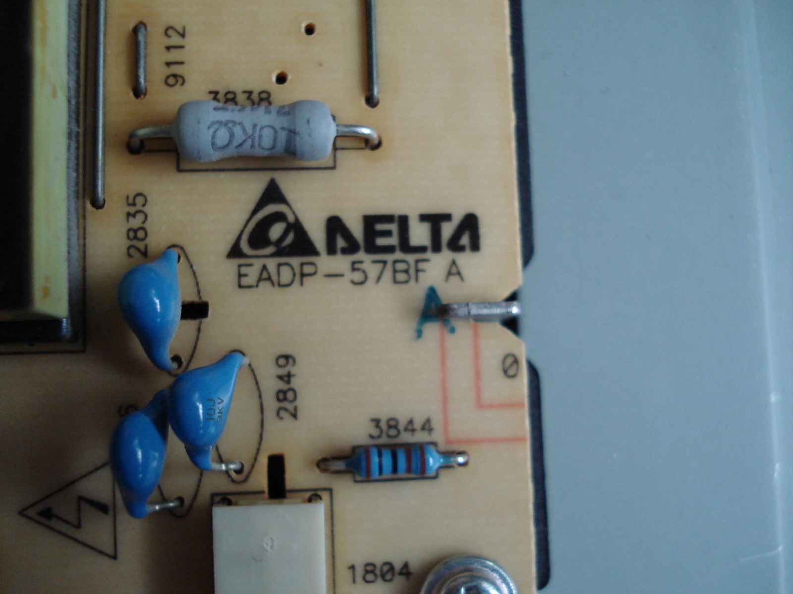

                          Pictures are quite good - thanks.
                          It is difficult trying to locate an intermittant fault.
                          I have marked some joints on the attached - can you check them -they may be ok they look a little odd - resolder any you think may be bad.
                          Generally we advise to resolder the joints on the inverter transformers and on the blue high voltage ceramic caps.
                          Following a recap a factory reset sometimes helps (if there is one in the menu)
                          I cant think of much else to try - perhaps check the ends of the bulbs and wiring fro blackening or arcing.
                          You could try warming parts of the boards with a hairdrier to see if you can get it to go black quicker. Then try and pinpoint the area where heating does this.

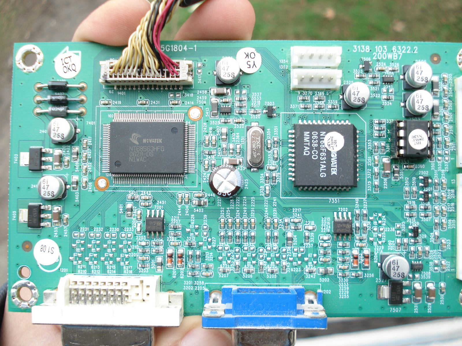

                                i would replace the sm lytics on that logic board.
                                they are likely dried out with 10k hours on them.worse they are often in paralell with mlcc which give good in circut esr tests.
                                lastly is the old novatek issue.
                                i replaced a bunch of those chips when these were newer.must have been a bad batch.
                                would randomly go no signal and sleep.
