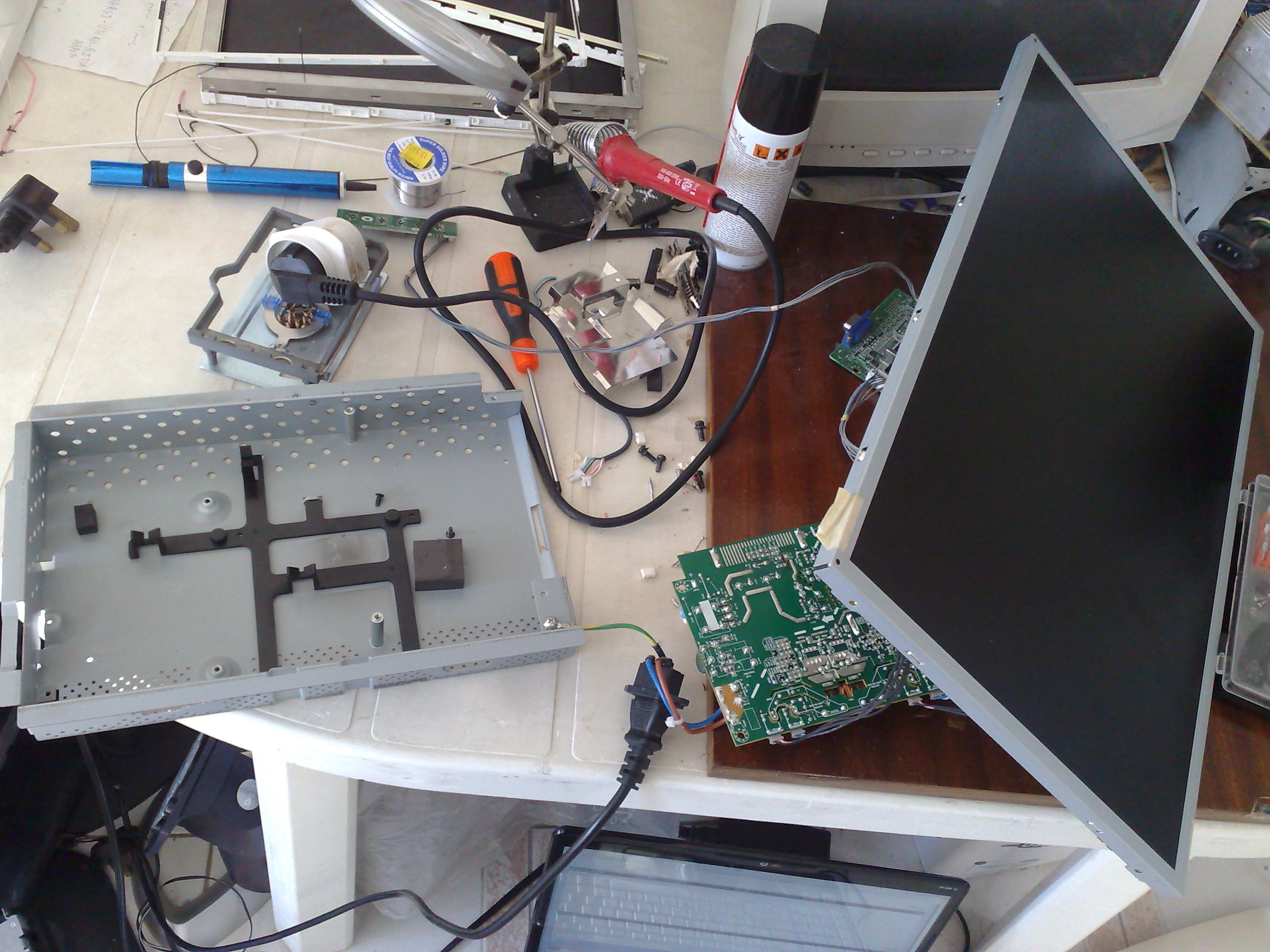

                        Ok so I have now tried the board on the desk and it didn't blow out the electricity for me. I have tried to connect a board every time and test it and it never blew the electricity even when connected all the components.
                        Now the problem is that it doesnt even turn on. I press the power button and no sign of life. I will try to do a small test and will get back to you.

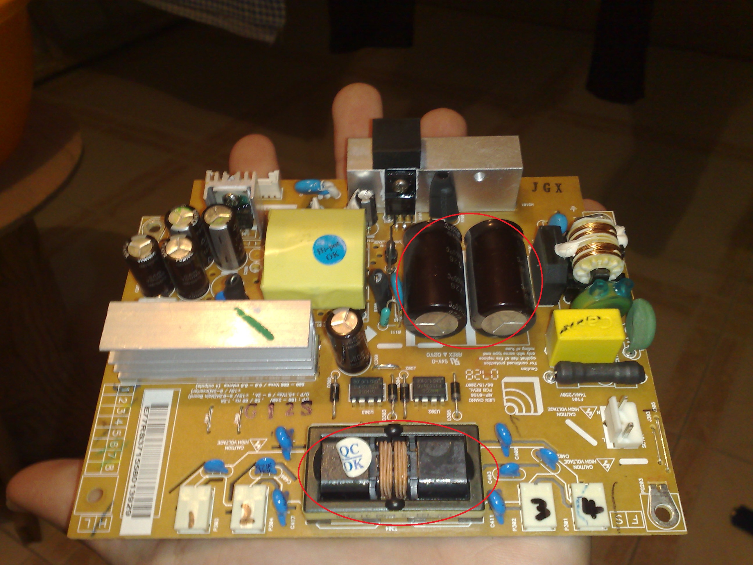

                          ok so I ran 2 tests and the results are as follows:
                          - I tested the big caps, POWER ON and VDC600. They both results 332V.
                          - I then tested the transformer, POWER OF, 2000ohms, the I touch pin 1->pin2, pin1->pin3, pin1->pin4, pin2->pin3, pin2->pin4, pin3->pin4 and all results where 000 and the meter beaped.
                          Hope that this helps a bit.

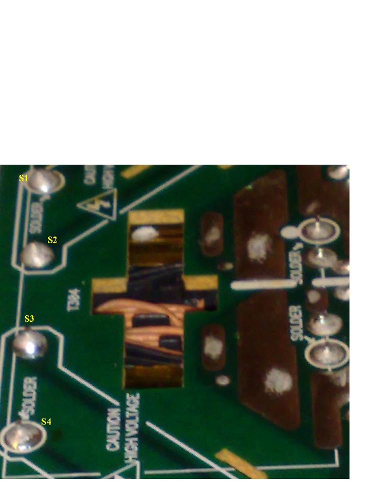

                              Ok the transformer is an odd one ( another odd one) I have marked on picture - NO Power to board meter on Ohms 2000 check S1 to s2 and S3 to S4.

                                  Test 1:
                                  S1 to S2 -> 903
                                  S3 to S4 -> 920
                                  Test 2:
                                  Pin 1-> ranging from -0.01 to -2.7
                                  Pin 2-> ranging from -0.01 to -2.7
                                  Pin 3-> ranging from -0.01 to -2.7
                                  Pin 4-> ranging from -0.00 to -0.01
                                  Pin 5-> ranging from -0.01 to -1.4
                                  Pin 6-> ranging from -0.01 to -1.6
                                  Pin 7-> ranging from -0.01 to -1.6
                                  Pin 8-> ranging from -0.01 to -1.7
                                  Pin 9-> ranging from -0.01 to -2.1
                                  Pin 10-> ranging from -0.01 to -0.03
                                  Pin 1-> ranging from -0.01 to -2.1
