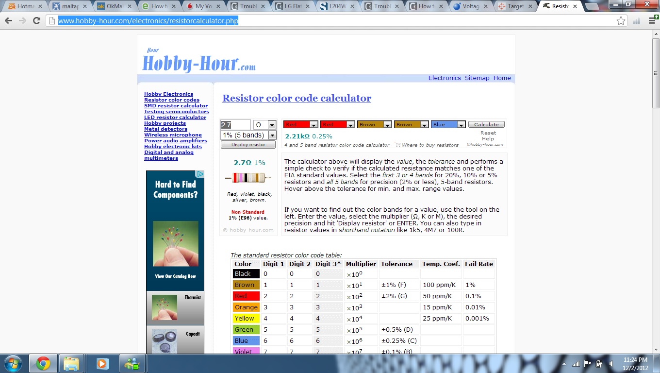

        i did check the site that you gave me. the big resistor is red red brown brown 2.21kΩ 0.25% so i had to choose 20k ohms
        As for the smaller resistor I seemed to me as the gold was brown, anyways I retried and now the result is the same as before.

                      Problem is there is no Red Red Brown Brown resistor so oh wait a minute there is a Brown brown Red Red 1.1kohms but then it would have done something on 20k
                      Yes - just try every range

                                There is a red red brown brown. Look: http://www.hobby-hour.com/electronic...calculator.php

                                  the link directs you to the homepage. look at this attachment

                                      Yes I saw that but it has a BLUE RING as well doesnt really matter as you have tested on all ranges right so it is either open or shorted if it is showing
                                      OL or whatever your meter shows for out of range OR 0.00
