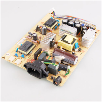

    I'm a noobie who has been successful in fixing a few LCD's with standard through-hole components, but this 1704FP LCD has quite a few SMD's, something I had not tinkered with before. It all started with a no power indication. Opened up the case and found power supply components to be ok, resoldered in places that looked marginal, and replaced the shorted four FET's in the top-side of the inverter section. Powering up the board by itself, I got the following voltages at the output diodes (mounted on heat sinks): 5.3v, 12.7v, and 20.0v. At the connector P802 with the wires that connects the main board: pins 1-3, 5.3v; 4-7, 0v (grd), 8-10, 0v. With such encouraging results, I reconnected everything and repowered to get the power led to light up and for a few seconds show the OSB on the screen. By examining of the underside of the board where the SMD's are found, resistors are easy to identify but condensers are not marked. I was also able to read the markings on the following three SMD components which I don't have details for:
    On the inverter side of the board,
    I801: SG6841SZ, KMA233305490g
    On the power supply side,

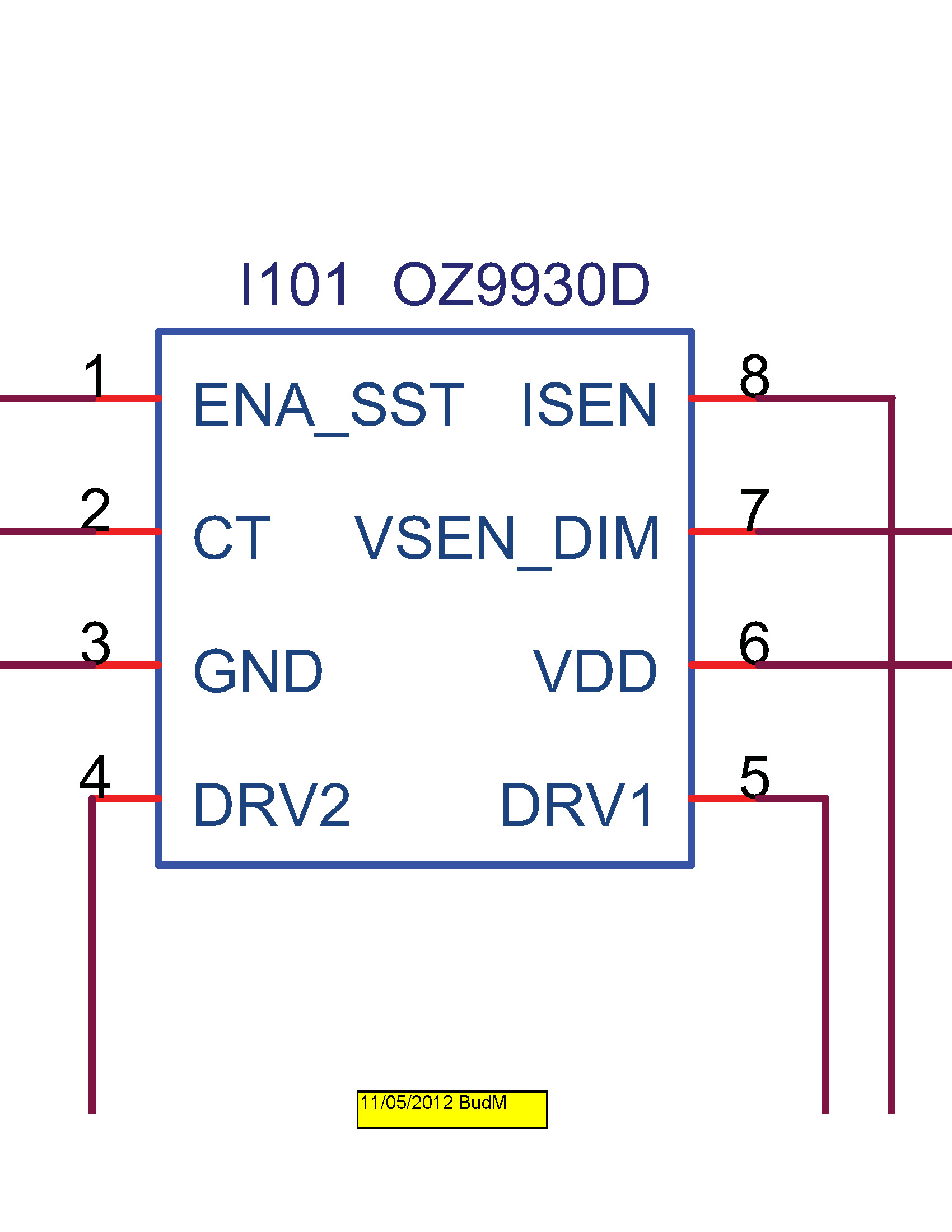

    I101: OZ9930g, S1090122T, 0S46A
    Q804: 13N06L
    Markings on the Power-Inverter board: 6832151100-02, PTB-1511, 8/19/05.
    Without a schematic and very little information on this model, it's hard to make much progress. The problem still seems to be in the inverter. Another burning question: are SMD components fairly easy to get and remove/install? Your insights and help to resolve this problem will be
    much appreciated. Thank you.

    Check the resistance reading of the transformers. No bad caps, bad cap can look normal but will have high ESR. May be bad lamp assemblies.

    SG6841SZ is SMPS IC
    OZ9930 PWM IC Pinout, see pciture/pdf

        Can you take the resistance reading on all the pins of the OZ9930 with ref to ground (black probe on the chassis).

            Hey smason. Isn't this the same board used in the Dell 1905FP and Dell 1704FPt where they used the wrong capacitor near the transformer? The manufacturer missed a decimal point and they used a 22uF 50v where it should have been a 2.2uF 50v and it took out the transformer?
              Readings are as follows. 1: 5.67M, 2: 5.68M, 3: 0 (GND), 4: 5.12M, 5: 5.12M, 6: readings are unstable; starts at about 1.5M, goes down to about 2k, comes up to about 0.5M, then comes down again in a period of about 2-3 mins., 7: 0.94M, and 8: 0.78M.
                Re: Dell 1704FP LCD w/pwr but 2 secs to Dark
                Thanks! I am trying to see which one is the correct reading.
                https://www.badcaps.net/forum/showth...697#post280697
                What voltage are you getting on those pins. We may be able to fix both monitors.

                    So it does have a 2.2uF on one side and a 22uF on the other? Yes, I have repaired a few of these. The 22uF 50v needs to be replaced with a 2.2uF 50v. The boards where there was a 22uF was present tended to take out the inverter transformer.
