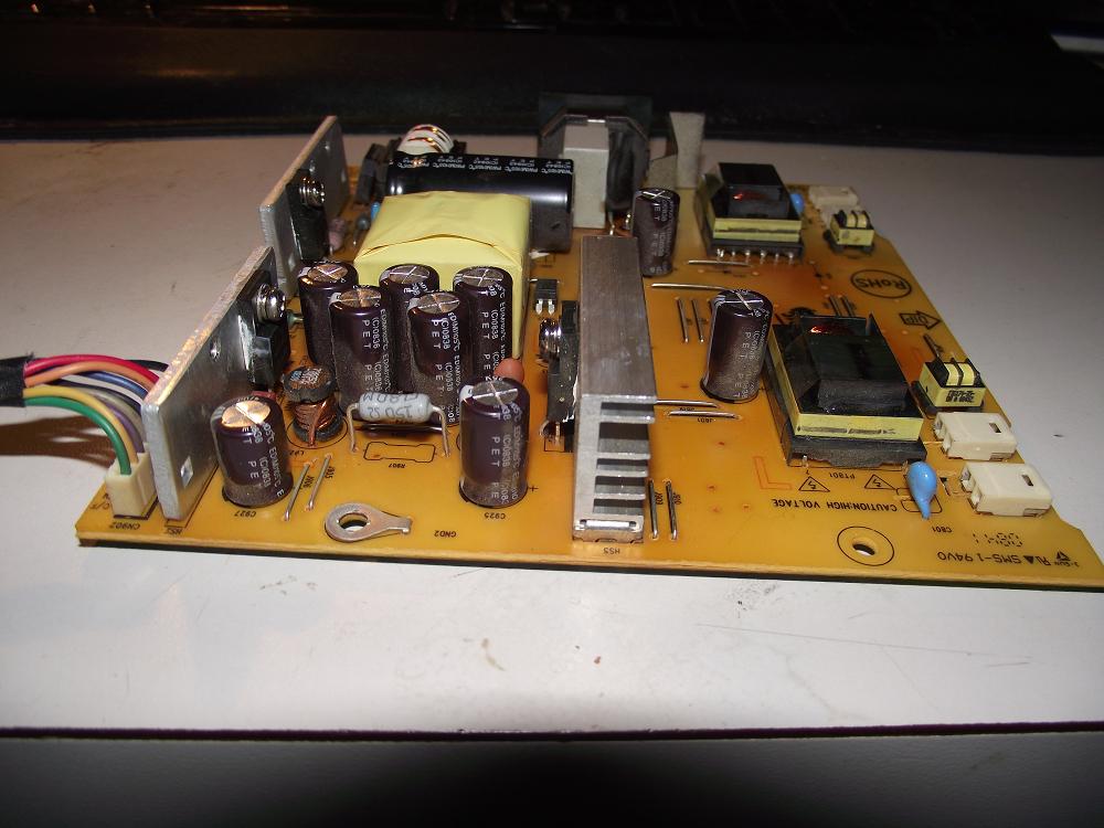

    Asus VK266H Monitor rebuild.
    I have to replace the caps on the power board. The main board caps look ok and only one on the power board shows signs of swelling.
    the caps on the board are:
    3- 680uf 25v
    2- 1000uf 16v
    3- 470uf 25v
    1- 470uf 16v
    It is one of the 680's that has the swelling and I belive it it the cause of the problems with the monitor.
    My question is just what caps to replace them with. I want the best I can get for the job but I am not sure which ones to order.
    The main board.. All the caps look good on it.

    Re: Asus VK266H Monitor rebuild.
    Suggest you replace them all on the ps board - look to be Ost which are not great.
    Order panasonic FR FM or FC in that order from digikey - check that the physical size will fit Width AND height.
    Many regulars would prefer pics posted using manage attachments rather than in line.
      I ordered all 9 for the power board. I went with the fr ones. Pretty sure I got the correct ones based on size. all are 10mm round so that made it a bit easier.

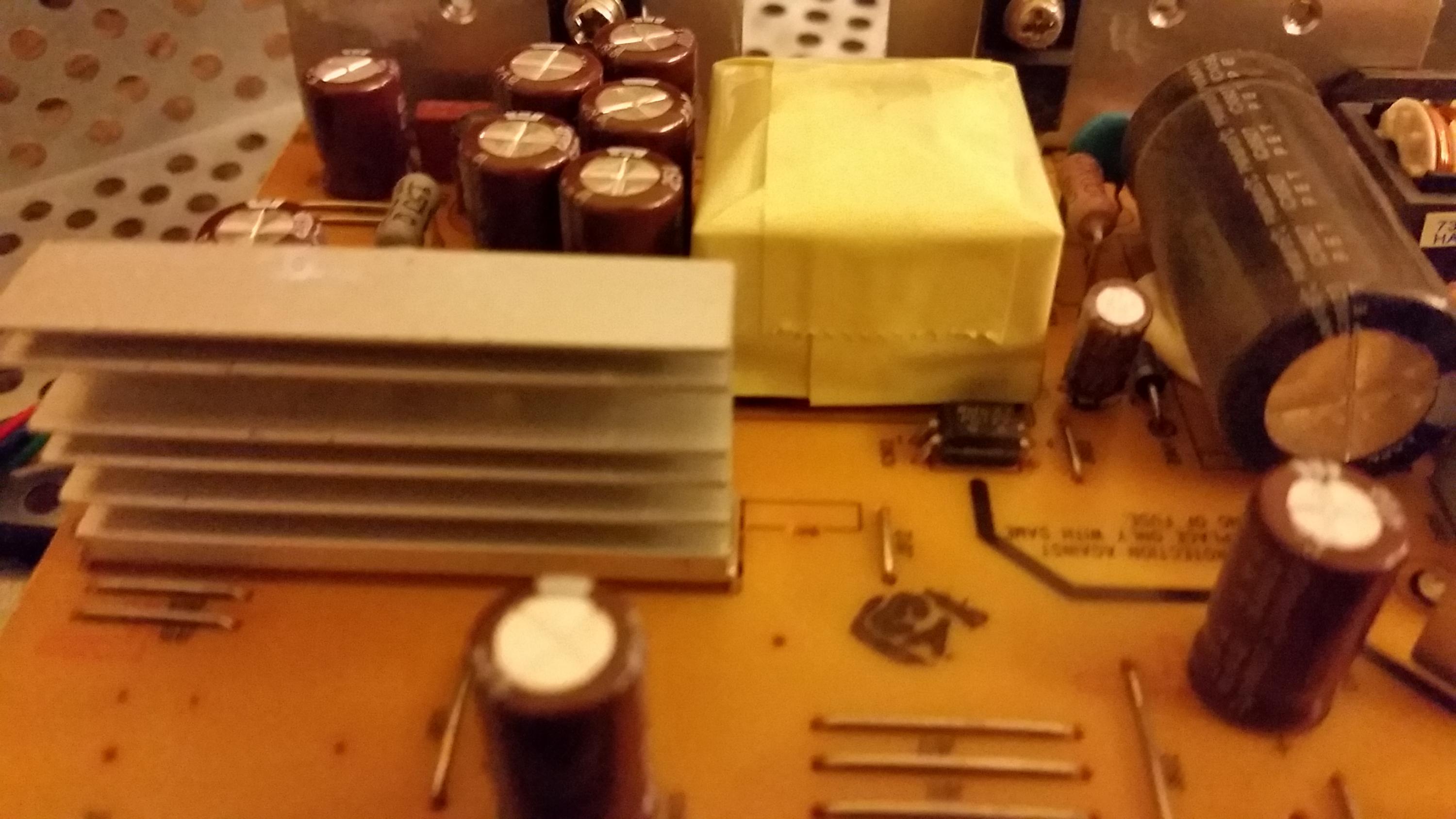

                          My VW266H is failing too, I get a similar power up issue as this:
                          https://www.youtube.com/watch?v=JqHGihXIzaE
                          I've found after slowly cycling through the display modes (HDMI, VGA, DVI, ect) 2 or 3 times, it's been progressively taking more cycles, it will eventually display correctly with no visual problems.
                          However... It causes my speakers to create MUCH more power humming noise, and my other display to flicker/pulse noticeably at about 1HZ(and much worse when it's displaying more white). Also, my video card will hum as well. All of these symptoms gradually get less serve the longer the failing VW266H is left on. After the VW266H is off for awhile it starts back up again and this has been gradually getting worse.
                          Obviously failing Caps in power board, would there be any others to replace too, or just the bad ones in the power board?
                          Thanks so much!
                            Just replace every capacitor on the power board except for the very big one, since it rarely fails.
                            The capacitors on the video/logic board *usually* do not go bad as often as the ones on the power board, but if you feel like it, you could replace them as well.

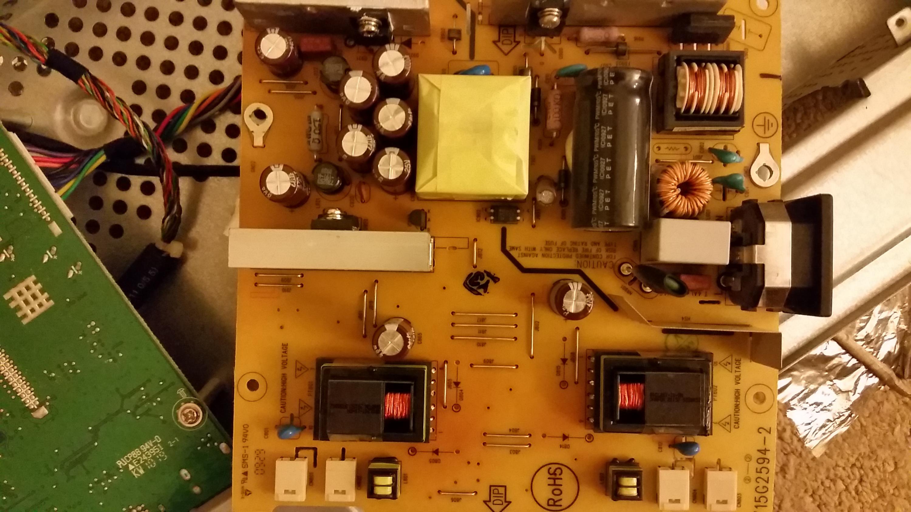

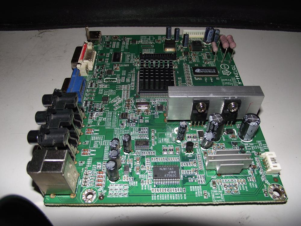

                              To my dismay I don't see any bulging on any of the caps on the power board. Do you see anything wrong with this power board?
                              Should I still replace all these caps?
                                Bad caps can look normal but the capacitance may have drop or the ESR are high, you cannot really tell by using visual inspection alone.
                                  If those are CapXon caps on the mainboard, I'd definitely replace them.
                                    Yes, the mainboard has 12 little ones, and 2 470uF ones, all CapXon. You'd replace all of them? They also show no physical signs of wear.
                                    The ones on the powerboard are all eLite.
                                      Yes, I would replace them. As budm said, caps don't have to look physically bad to be bad. And CapXon caps are of low quality and should be replaced on sight.
