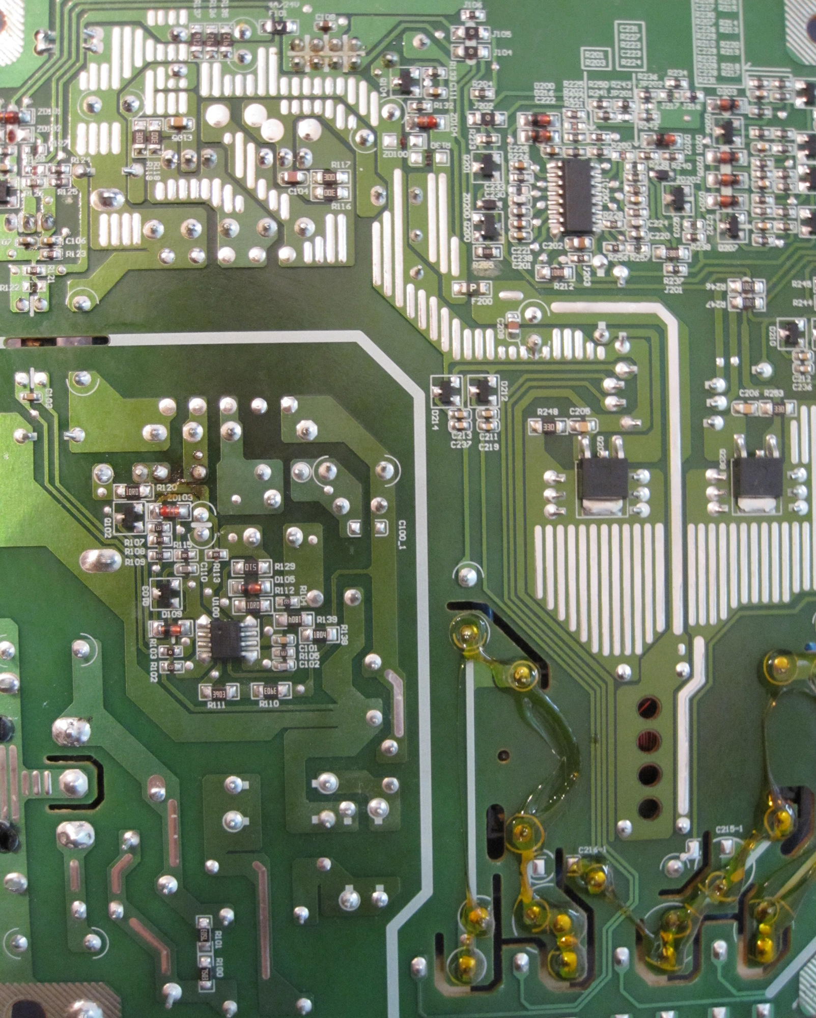

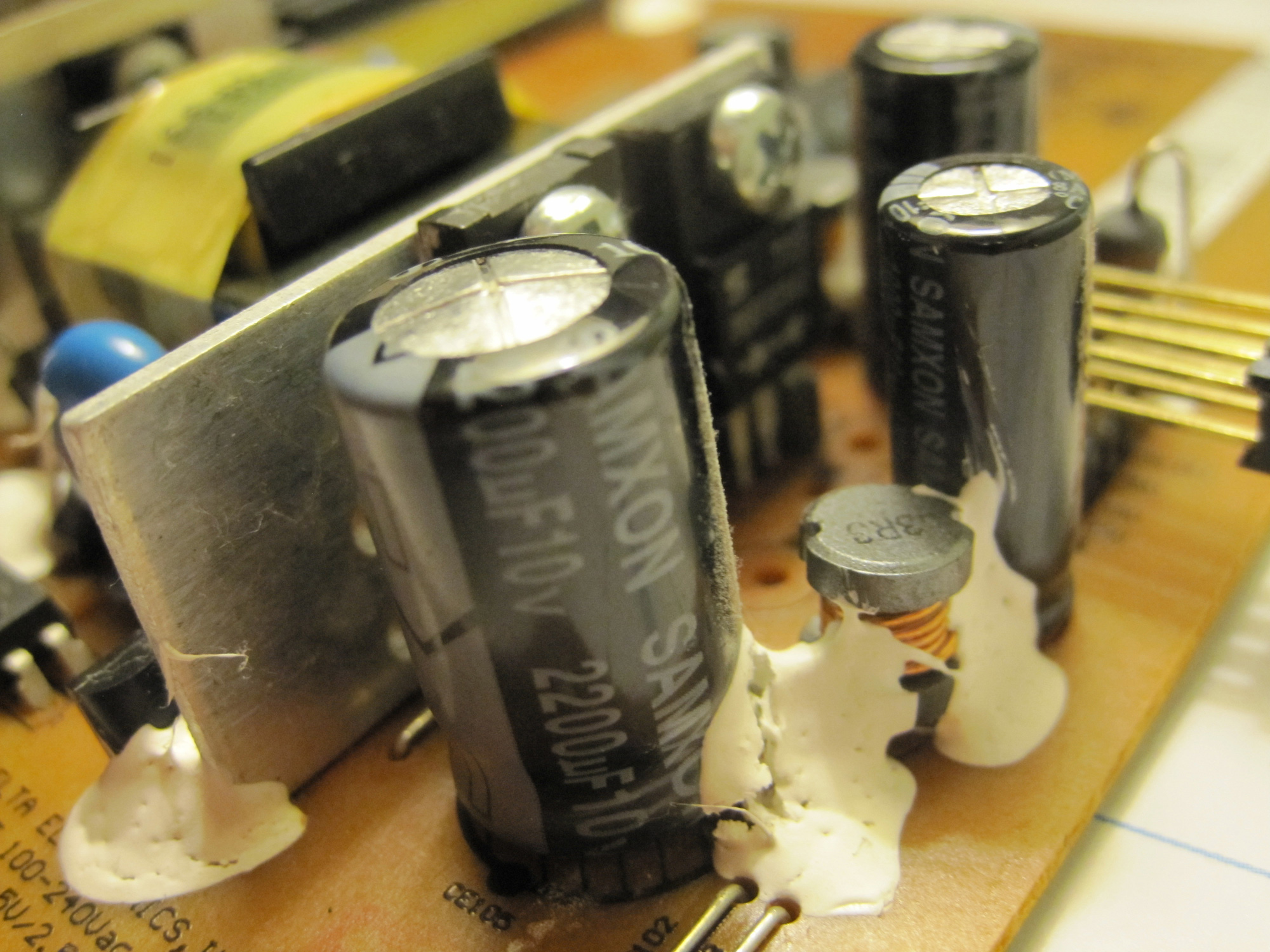

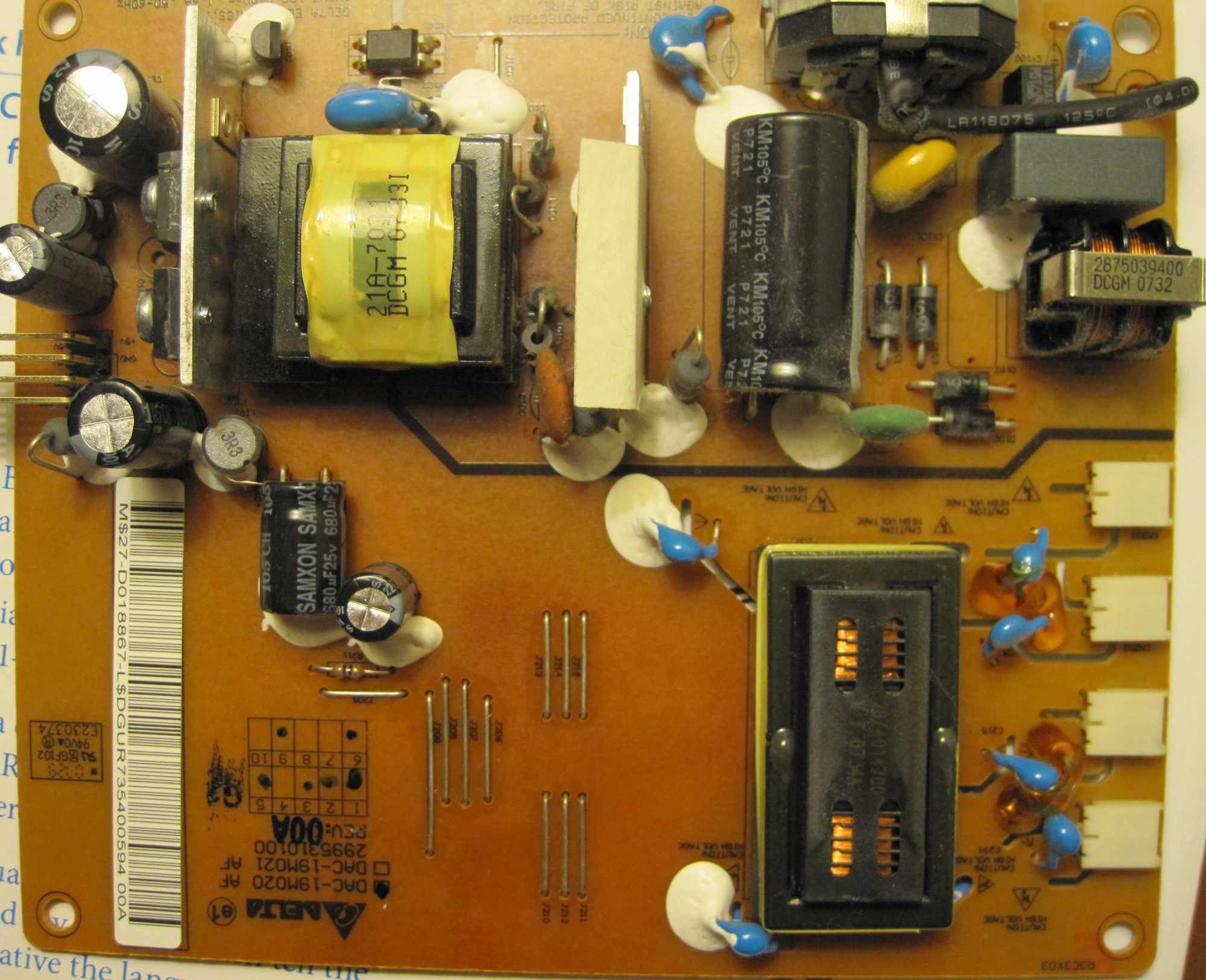

    There is at least one bad cap on the board. I don't have a multimeter or soldering iron/supplies, so I could buy what is needed and attempt to replace them, or grab a new board for $25 off of ebay.

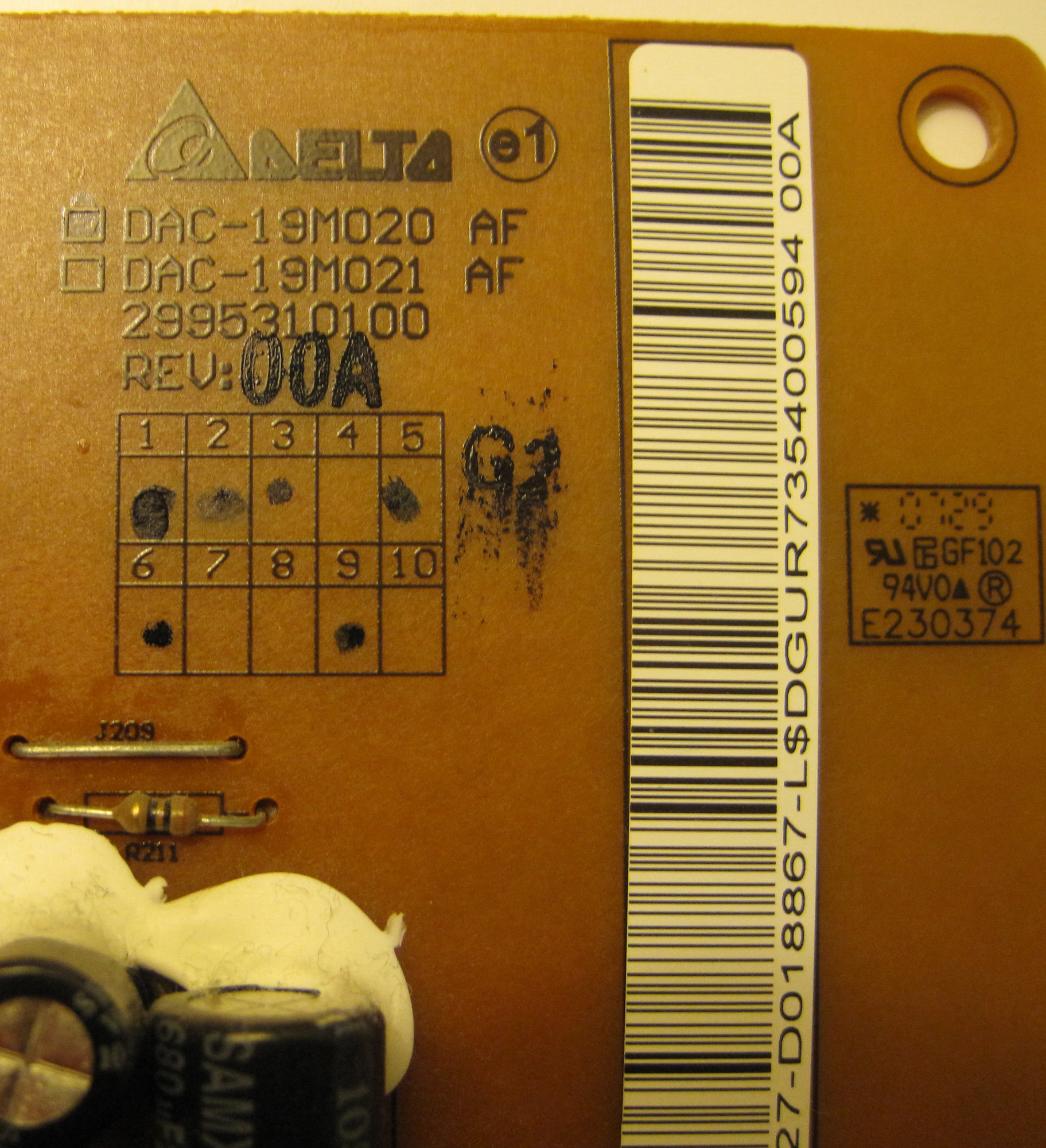

    Also concerning is the black mark on the back of the board under the inverter (?). Not sure if that is something to be worried about or not.
    Thanks!
    Re: Acer X223W - Repair or Replace
    The above needed supplies will probably cost you around $25. If this is a one time fix, maybe new board is your better option.

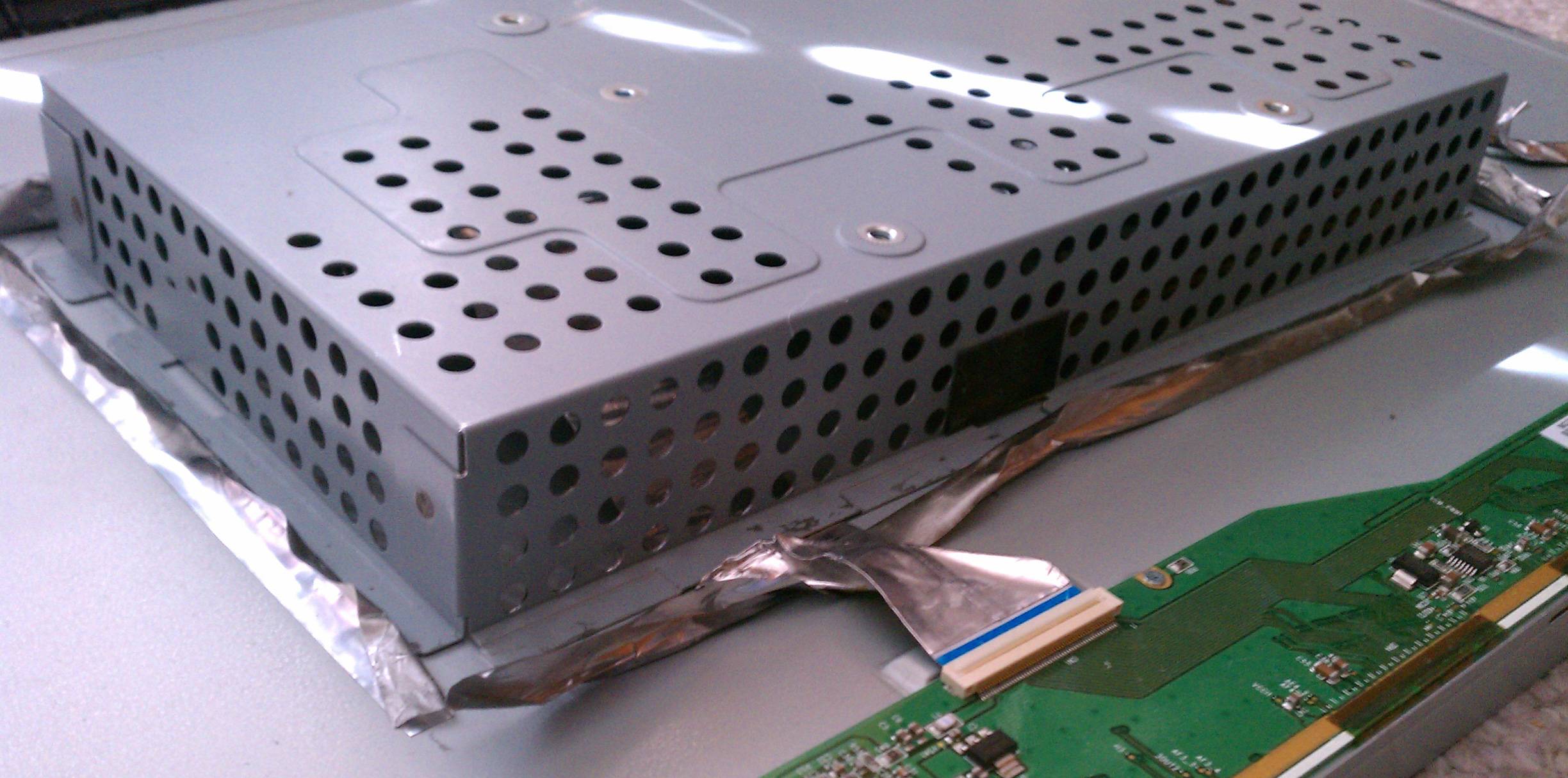

      Got the new board and it worked fine, but now I need new tape to replace the old dried up tape. Will any aluminum sticky tape do or is it something special?
        Just an aluminum tape from HD.
          Or none at all if there are bolts/screws holding the chassis to the screen.

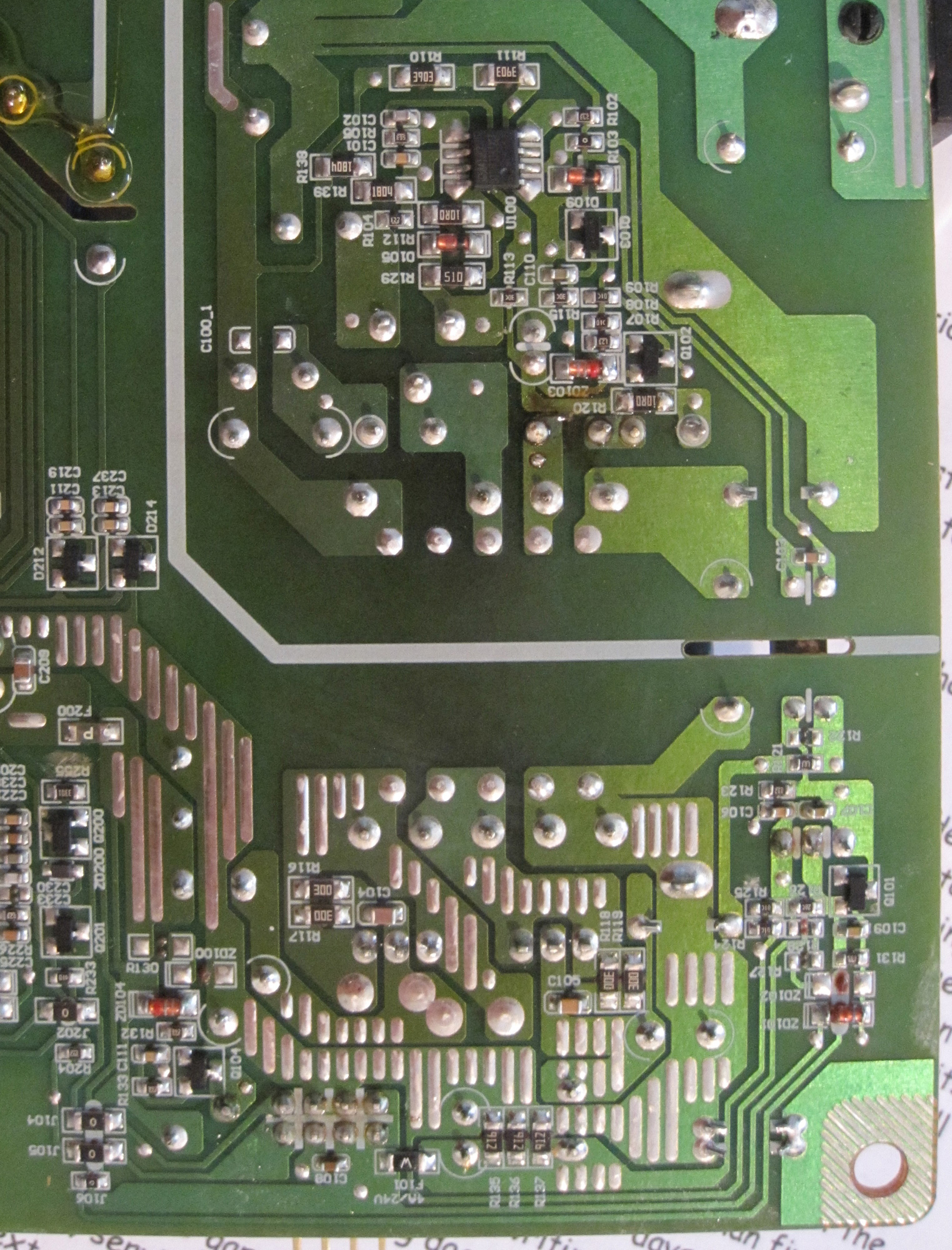

                  I think the person in the YouTube video was mistaken and it's not an LED-backlit monitor, and it wasn't just a year old. That model seems to be from 2008. The wires to the backlights in the video were only a pair, which is very unlikely for LEDs which use several strings and thus several wires. Those were CCFL wires. Back of power board also looks like that of a CCFL power supply, with several far-spaced components on the right side.
