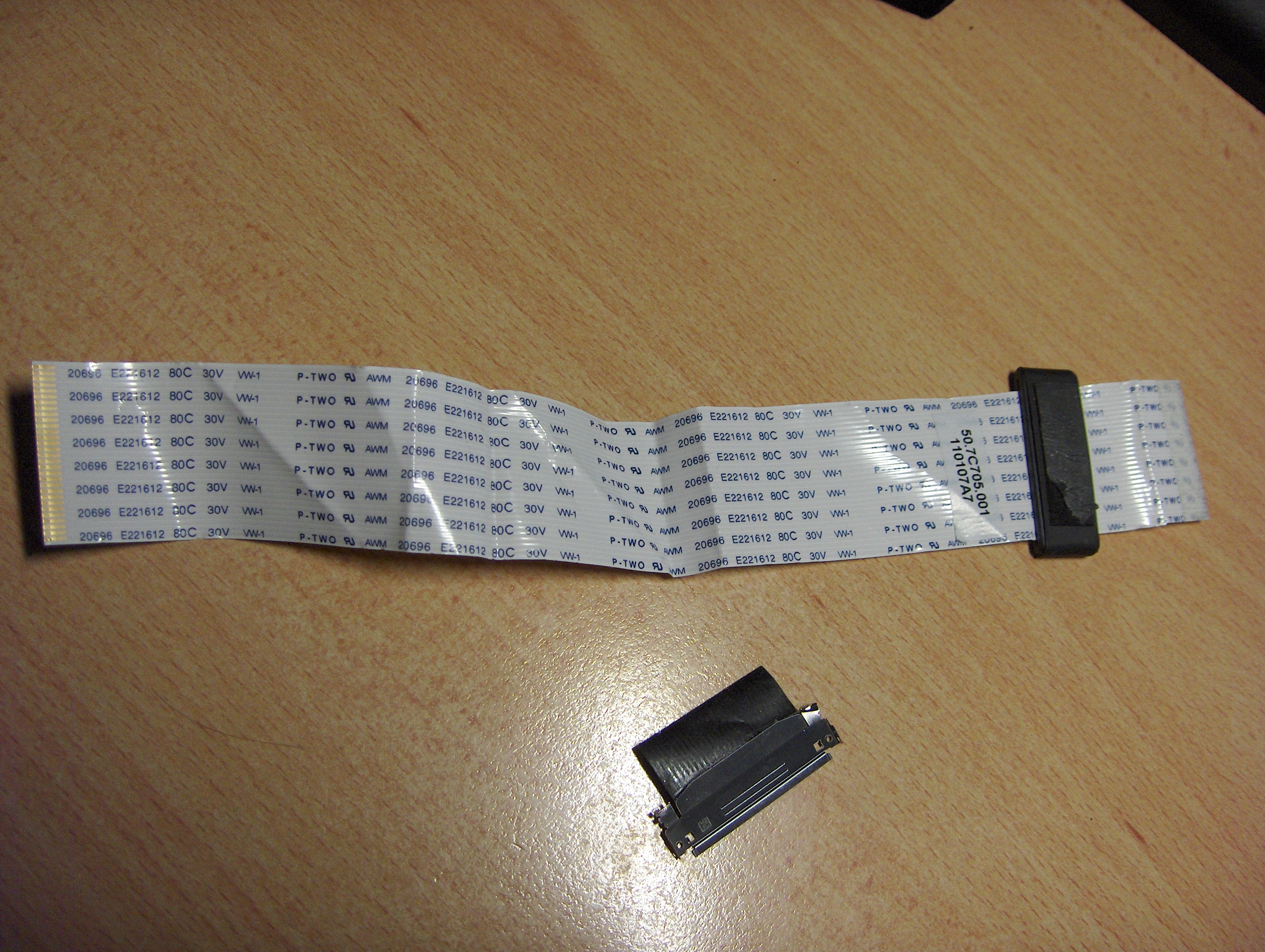

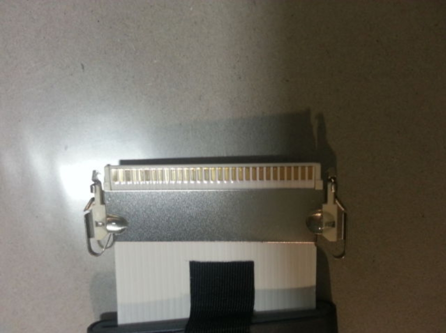

    Hello guys,
    recently I picked up this monitor from ebay, described as having a "white screen" problem. After opening it up I discovered the seller tried to do some "repair" himself: LVDS-Cable is broken, connector ripped off. On PSU board caps were changed with ones that didn't fit at all in height so the board was bent - to almost break apart - and with partial contact to the chassis. This **** even used CapXon caps for replacement
    Sorry, had to first get rid of my frustration about this. Well backlight turns on. A quick check on the T-Con board showed no shortings on the power rails. But of course without a working LVDS cable no further troubleshooting is possible. So first step would be getting a proper replacement for it. The panel used in this monitor is a AUO M270HW01 V0 : http://www.panelook.com/M270HW01%20V...view_1084.html
    The connector specified there is "FI-XB30SSL-HF15" from JAE. Looking at the socket soldered on the T-Con I find the marking "STM K1034".
    Anybody got an idea where to get a new LVDS cable?

    Nobody got an idea?
    I came across this cable on ebay: http://www.ebay.de/itm/270924803853?...84.m1436.l2649
    What do you guys think? If it could fit?!
