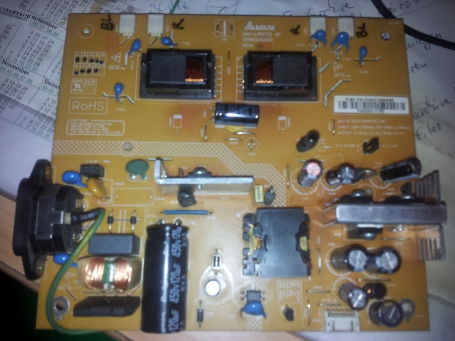

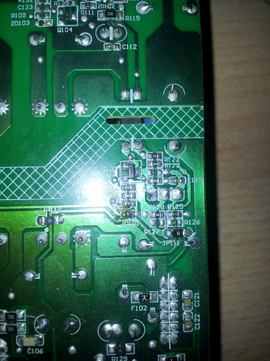

    i found a blown Fuse on my powersupply can someone tell me which fuse to use to exchange F102 in the Attached Picture?
    The Label on the Board says its an Delta DAC-12M070 AF Rev 00A

    I'm not sure of the answer to your question but you shouldn't assume that this will fix the problem. Something caused the fuse to blow and it is highly unlikely to be a power surge from the mains that did it. There will most probably some failed component(s) on the board that caused it to blow.

          The 'Y' on my list is 5amp..BUT suspect there a lot more wrong with it than that,suggest you add photos of top and bottom of the Board !!

            nevertheless i have to replace that fuse at some point in time
            and i have no idea which one to order

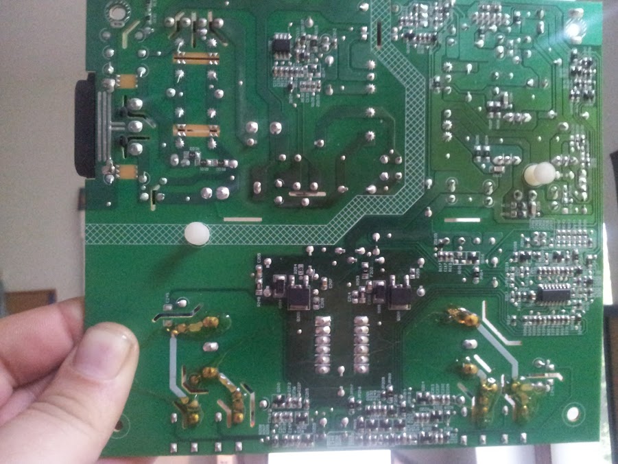

            • cholzberger
              • Sep 2012
              • 29
              Re: Hans G HH251 - 3 seconds to Black

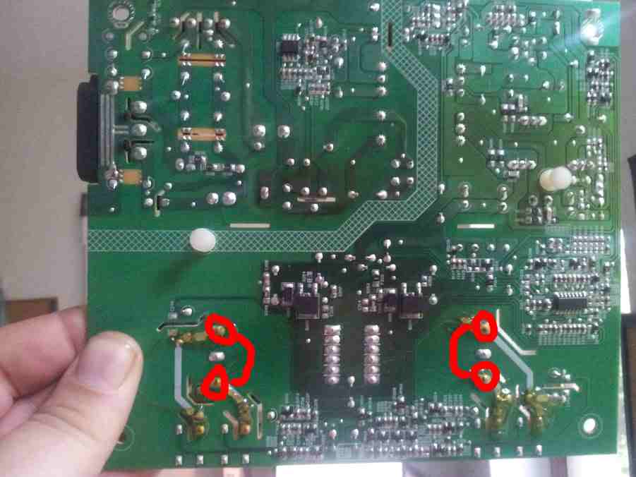

              Top and Bottom of the Board attached
              i dont know which are the secondarys on this transformators?
                These points.
                  Ok,
                  both measure 530 Ohms
                    The fuse goes onto a connector ??? does it say on the Board what voltage is supposed to be on there ???
                      Yes the Fuse does go to the connector cable between logic board and power supply. i guess its 5.2 V.
                        Take the resistance reading on the output side of the fuse and the circuit ground that feeds the main board to see if it has really low resistance.

                          Ok i replaced the Fuse, now i have another problem, the monitor stays on for a while, then goes of after a few seconds, the higher i set the brightness the shorter the time to poweroff will be.
