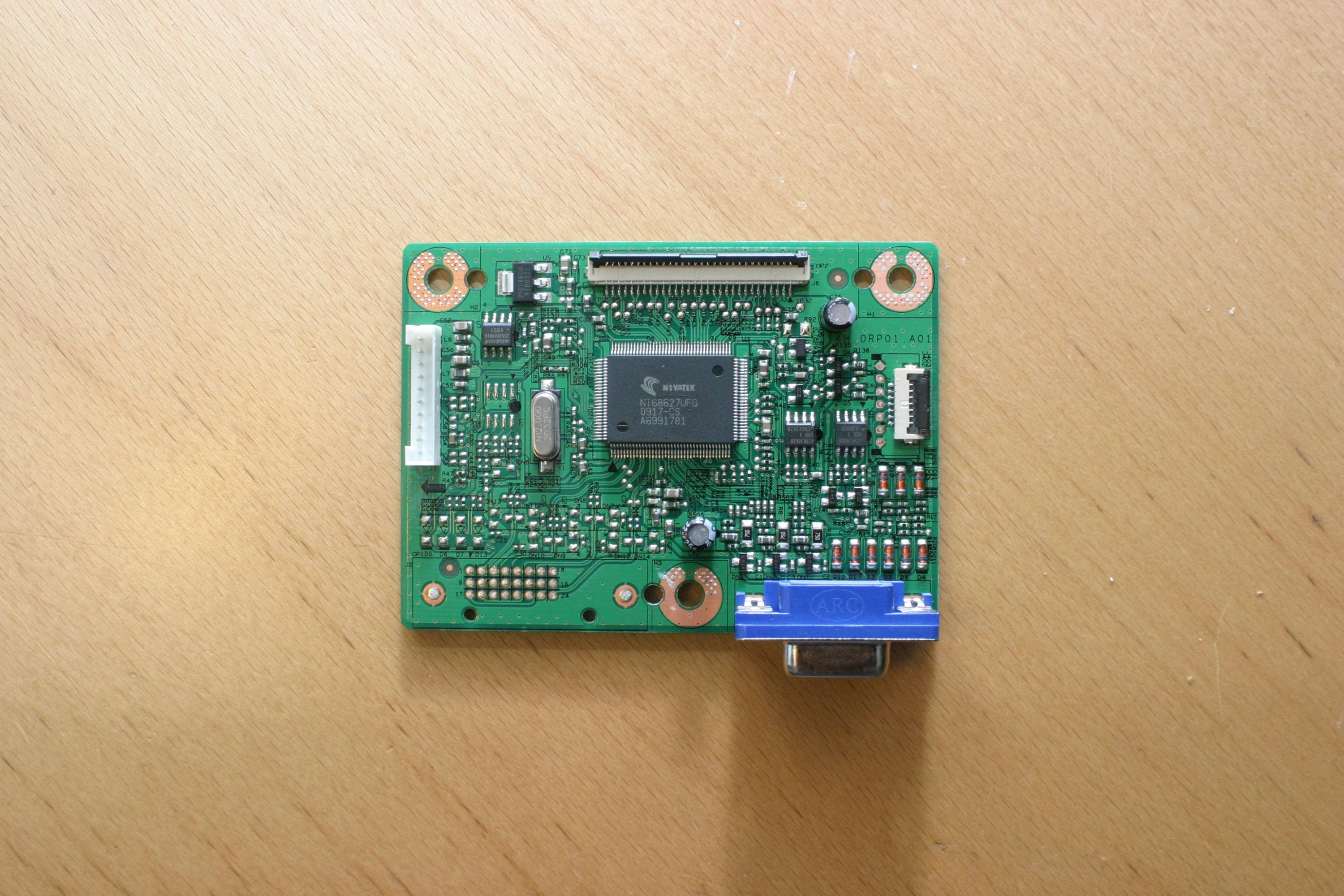

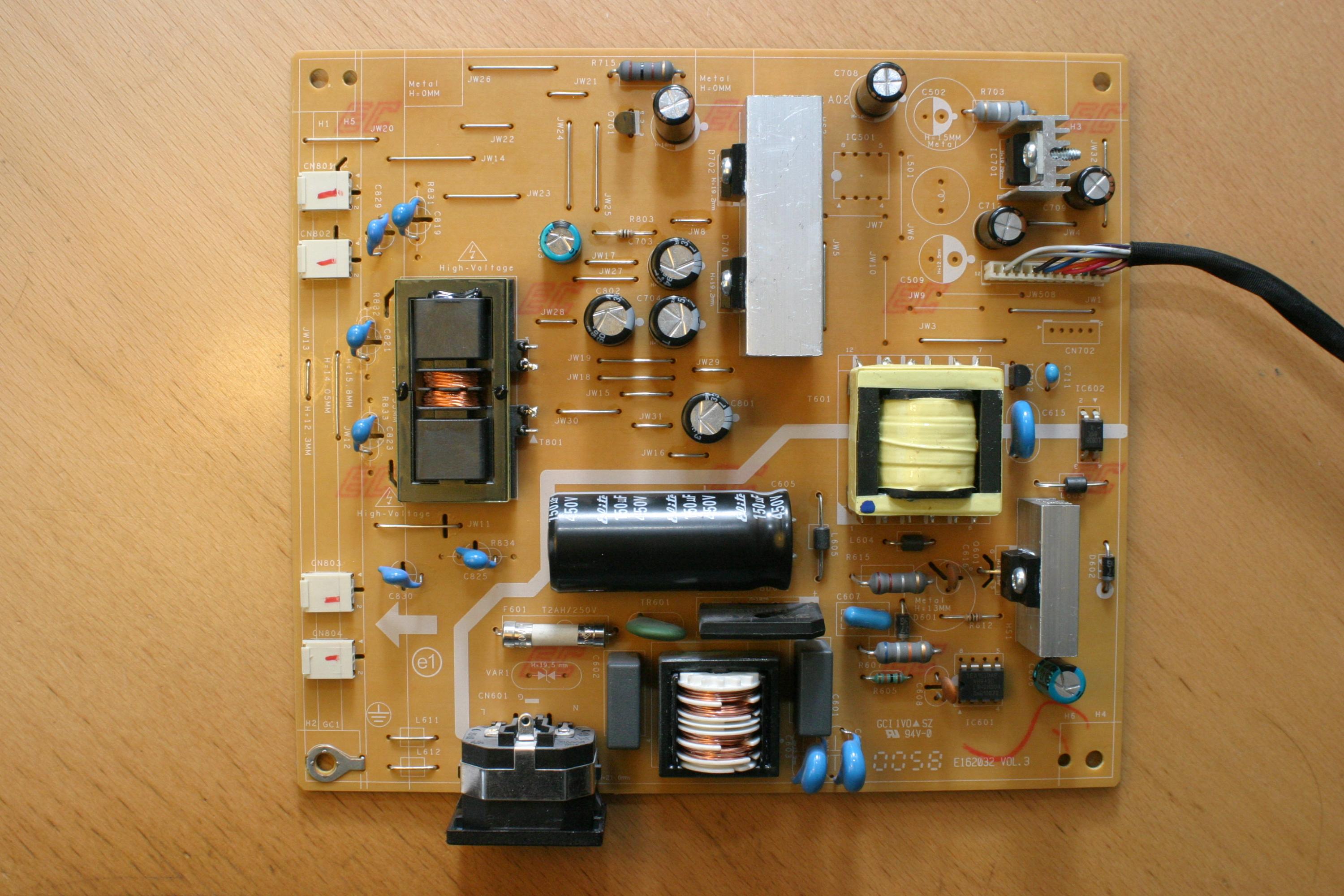

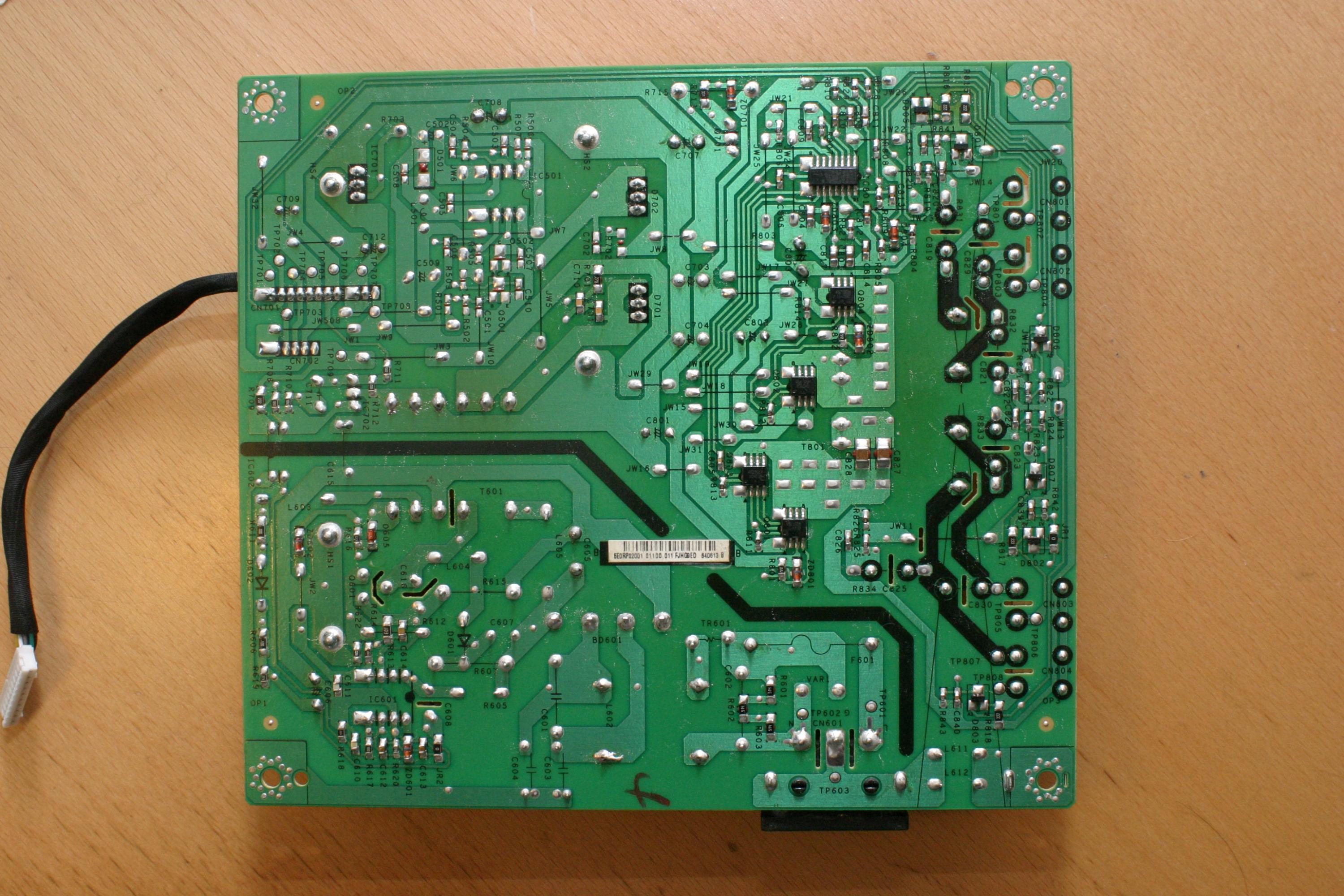

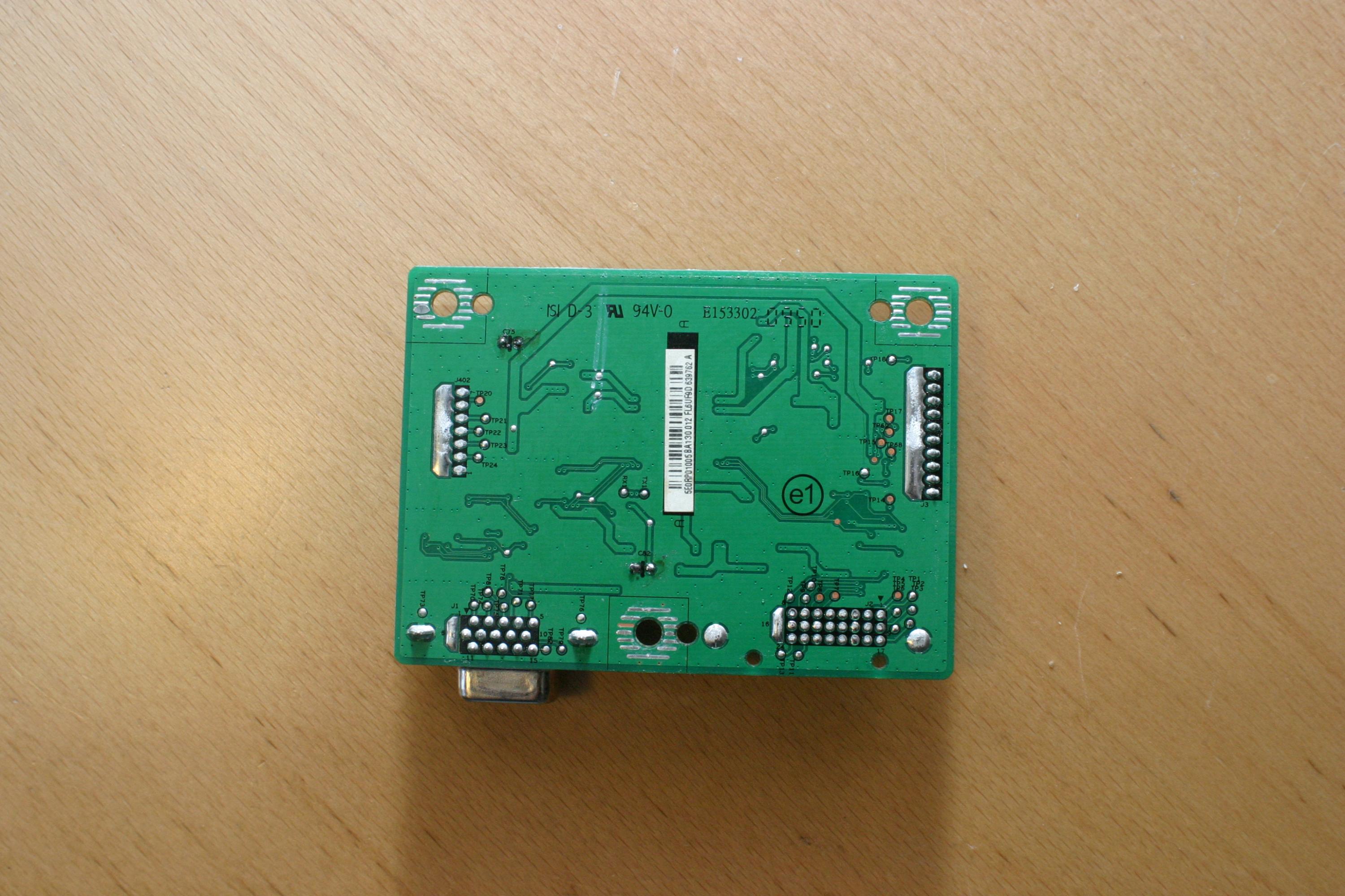

            Re: BenQ G2220HDA, white screen after cap replacement
            Here are photos of the two boards. What I'm trying to seek here if we assume that the panel/logic doesn't get the right voltages?
            I'm not totally new at this but I'm not a pro, so please explain clearly.
            • retiredcaps
              • Apr 2010
              • 9271
              1) U5 is a voltage regulator. My sig file has instructions below on how to test it.
              2) Check your soldering for cold joints.
              3) Those are excellent pictures.
              Last edited by retiredcaps; 09-26-2012, 02:15 AM. Reason: edit: Changed #2 completely

              • retiredcaps
                • Apr 2010
                • 9271
                With the voltage regulator readings, you want to take the 2 sets of measurements: when it is working properly and when you get the white screen.
                There may be a voltage regulator on the panel board as well.
                  Thank you very much for the info.
                  Ok, but now we'll not measure anything. Power just died on me. It went with "bzzzzzzup" and a little smell. Dunno exactly what burned, but everything is visually okay. Nothing burned or blackened.
                  The problem now is what died? No power led or anything anymore.
                  Bridge rectifier and all the other diodies read "infinite" other way and ~0.480V the other, this is okay then.
                  Black trafo near IEC measures:
                  pin 1-3 = 00.5 ohm
                  pin 2-4 = 00.5 ohm
                  pin 1-2 = 1.5 Mohm
                  pin 3-4 = 1.5 Mohm
                    Check out parts around Q601 0.22 Ohms R615,R612 etc as also smd components below in this area with a continuity tester and u may find cause of breakdown.

                      I am a total newbie here (as my post count will show), but on the small board, is that solder joint on C75 bad? In the pic it doesn't look quite right so you may want to check it.
                        Samir
                        Thanks.
                        R607 reads 62.9kohms and it should be 68kohm.
                        R605 is 10kohm.
                        R612 is 9.9ohm.
                        But with continuity test R615 beeps and reads 00.0 - 00.3 so that's burned right? Little SMD components give nice readings. Those L604 and L605 those coils beep too, should they? They have almost no resistance at all.
                        I've done it several times now. The foil got somehow destroyed while taking the old cap out but it holds so I assume it's OK.
                        • Undead
                          • Mar 2012
                          • 64
                          If the foil was destroyed then it will not work even if it is holding, it has to make a proper connection to the foil. You will either have to make a bridge to another component in the same section with a wire, or someone mentioned carefully sanding down to the foil in the same section and making a bridge to there.
                          • Rtech
                            • Jul 2010
                            • 1095
                            If R615 beeps, it is because it is so small,so it will probably be fine
                              More easily said than done. Dunno where I could connect it with a wire because this seems multilayerboard.
                              Anyway, logicboard ain't the main problem now because the power died.
                              • OniJon
                                Computer Expert
                                • Jun 2012
                                • 82
                                • Finland
                                Any ideas what to measure next? It's funny how something burned with little whizzing/buzzing but nothing seems broken. Didn't arc or anything.
                                Need closer pics of something, let me now. I got good equipment to take photos, it's a good day to be a photographer.
                                • OniJon
                                  Computer Expert
                                  • Jun 2012
                                  • 82
                                  • Finland
                                  By the nose, I would say the yellow transformer on the powerboard is the burned one. I put an ESD pack from motherboard between the metallic panel casing and the board so I could test out the regulator. Then it zipped, could it be the transformer only because the high voltage, it jumped even with through the plastic. Should've used cardboard, damn.
                                  • OniJon
                                    Computer Expert
                                    • Jun 2012
                                    • 82
                                    • Finland
                                    Updates on this, can't edit older post.
                                    I'm getting ~320V on the main cap.
                                    No AC or DC on the fuse, but it's fine otherwise.
                                    around 190 volts K3530 and a exploded R615 with a nice arc. Must have shorted the K3530 legs by accident. I'm doing more damage than repairing this unit, hehe.
                                    All in all, pretty sure K3530 is done and R615 also. Two legs on the T601 have burnings too. I'm almost done with this shit, maybe I'll just throw it to garbage and sell the panel which is fine. I'm more of a "prevention" kind of guy than repairman. I'll change the caps before anything dies, not too fond of this measuring this and that because I don't know what the heck I'm doing.
