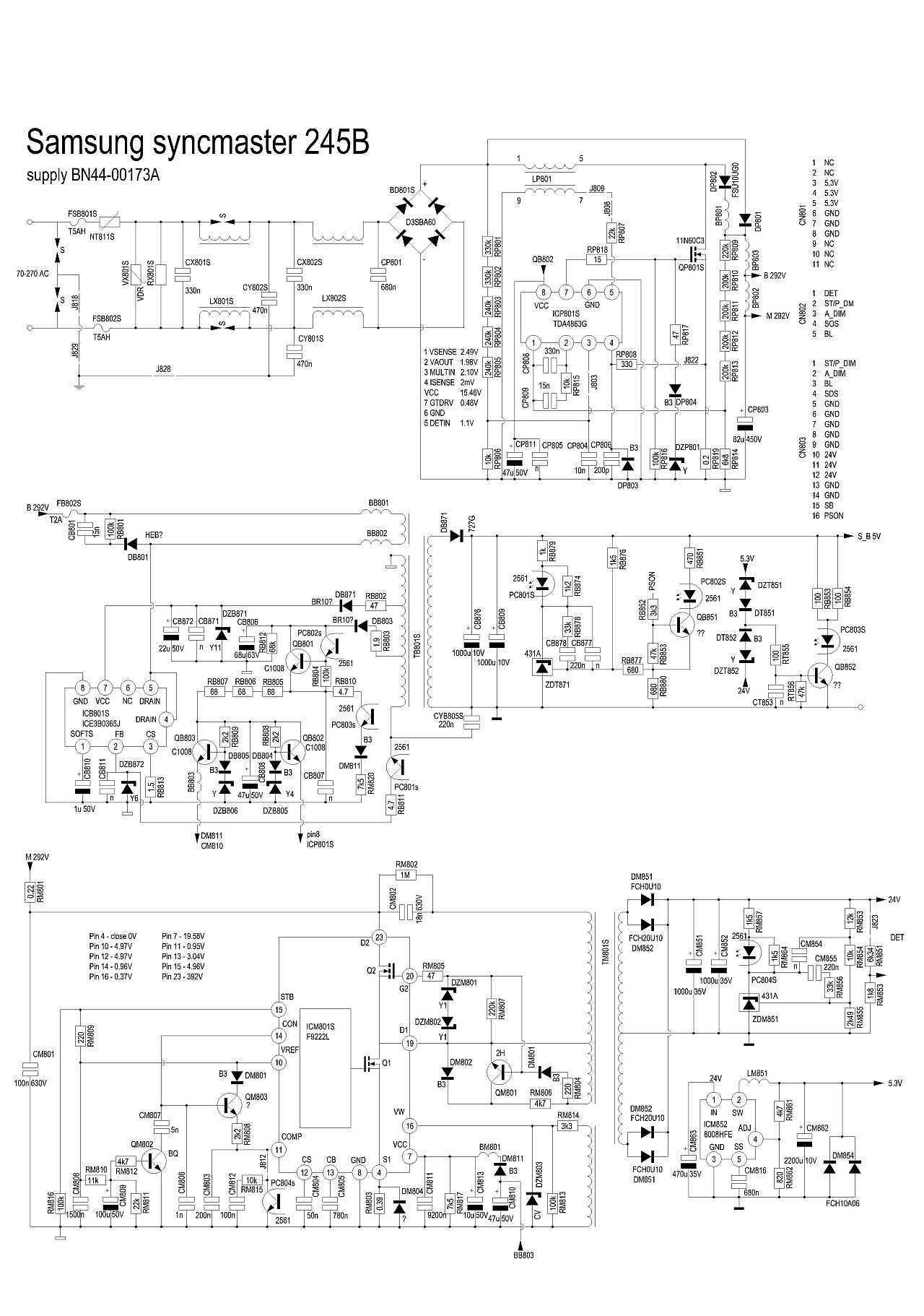

    Re: Samsung 245bw No Power No LED
    Here is a circuit diagram for the power supply

      the ones you have me reading are all turned into eachother and pushed up against eachother, it looked like 100uf when i wrote it down this time too but i noticed antoher 0 just as i was about to turn the flashlight off..
      Glad you mentioned somethin about the 200uf, looked REAL hard, keep in mind im tryin to see this without touchin anything all plugged together cause not sure if it has power..
      but i finally saw 10v 2200uf..

                                  Is it possible that the problem is commin from the board next to power board in metal backing? (not the ballast board but the only other one heh)
                                  Also can the regulators be checked before the caps are replaced?
                                  If anyone is willing to help me verify these parts, the list starts with someone elses partial list and the ???? are my added needs and attempts to find. i have a large fear of accidently ordering the wrong parts.
                                  Are the parts already picked good quality parts?
                                  Heres a good pic of the same board i have, if you need to see a visual of the parts for any reason
                                  https://www.badcaps.net/forum/attach...1&d=1327123373
                                  And Also a Schematic that seems to be identical
                                  https://www.badcaps.net/forum/attach...8&d=1346612309
