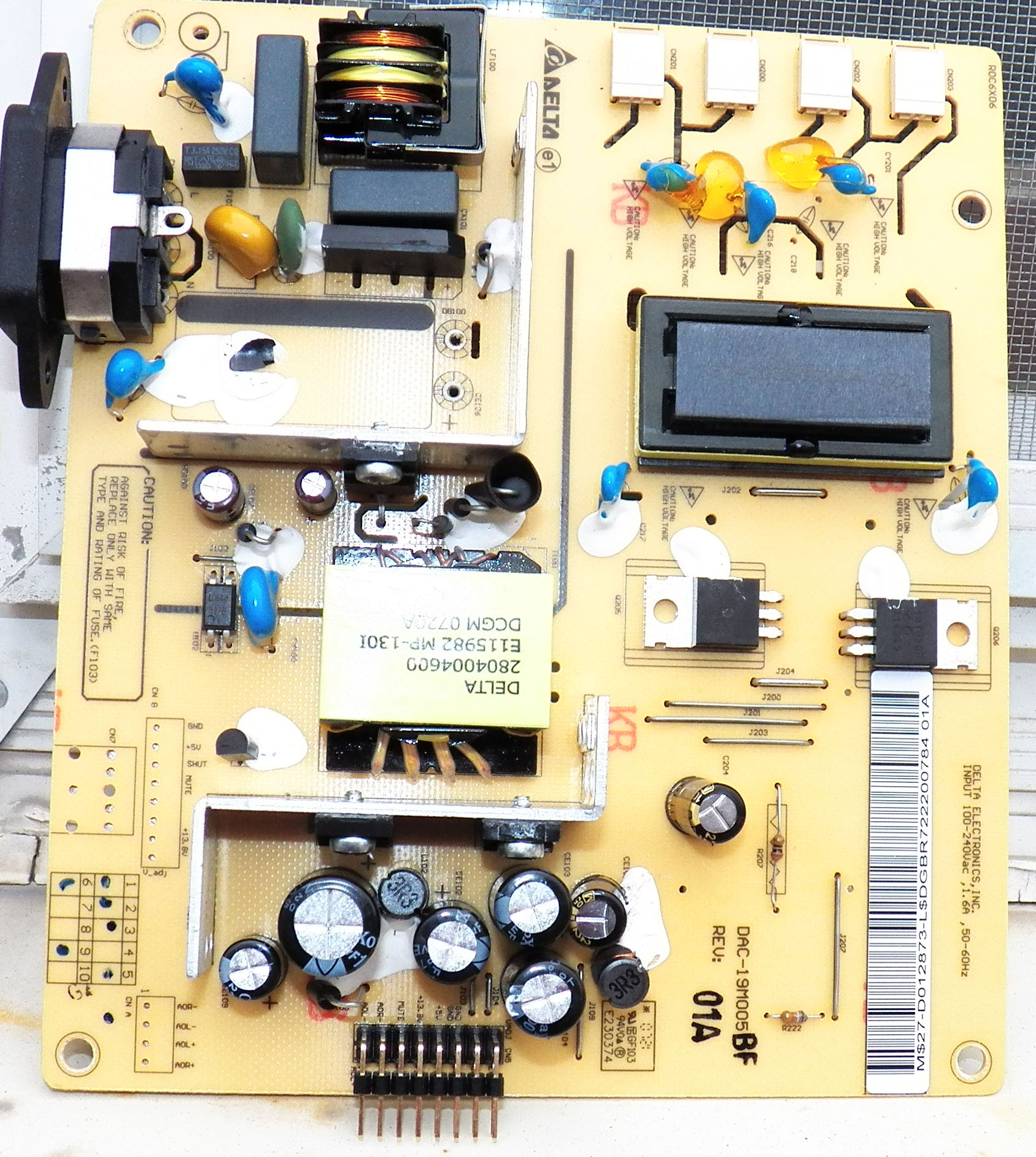

    Hello all before getting into this I did take a look at the AL196W thread that already exists but I didn't quite see anything that resembles the issue I have with the one I am trying to fix ( Either that or I am blind lol)
    Briefly C204 is a new cap, and the cap beside C103 is also a new one.
    After I replaced these caps and turned it on, all I got was a very brief flicker and that was it. I have a set of working CCFL's as testers, I plugged them in and they didn't even fire. However the green/orange power light was on.
    The main filter cap is missing because I initially thought it was bad, will be replacing it.
    I have about 6 or 7 of these monitors to look at.
    Tested the main fuse.. seems to be okay.. I'm a bit rusty with this been away due to medical reasons..
    Any ideas?

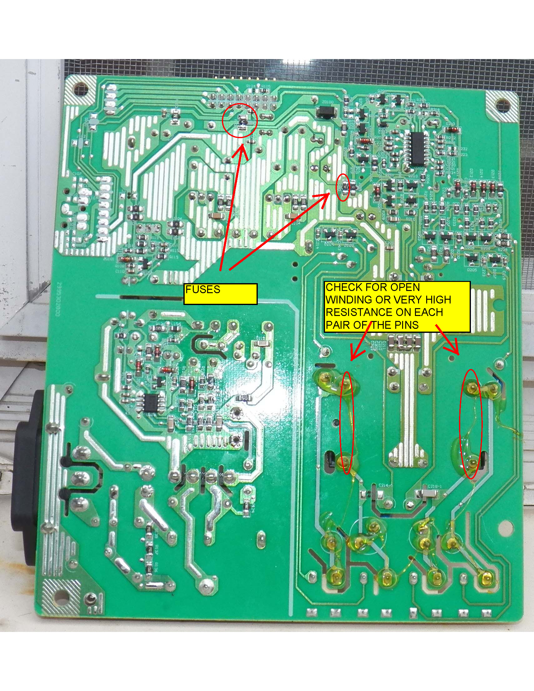

        Below the inverter transformer in your first photo are two mosfets, Q205 and Q206. Check them for shorts as they are a known problem on your board.

          And if my memory serves me correctly there is also an SMD fuse on the bottom that blows when the Mosfet/s fail.

            There is a fuse its a small black one marked N top left in the bottom board picture. Test - meter on ohms probe each end of fuse - should read same as touching the probes together.
              Re: AL196W Acer Monitor- Slightly Different Issue
              Yes, there are two fuses, as jetadm123 has indicated, those two MOSFET's usually shorted out nad blown the surface mounted fuse and some time also takse out the Gate drive resistors and Diodes with them also.
              Also check the secondary of the transformer windings.

                  Hmm in that case there are 3 (Three! ) fuses. 1x N and 2 x W
                    Darn selldoor, your good set of eyes see the third fuse, where?
                    Never mind, I see it now close to the top left.

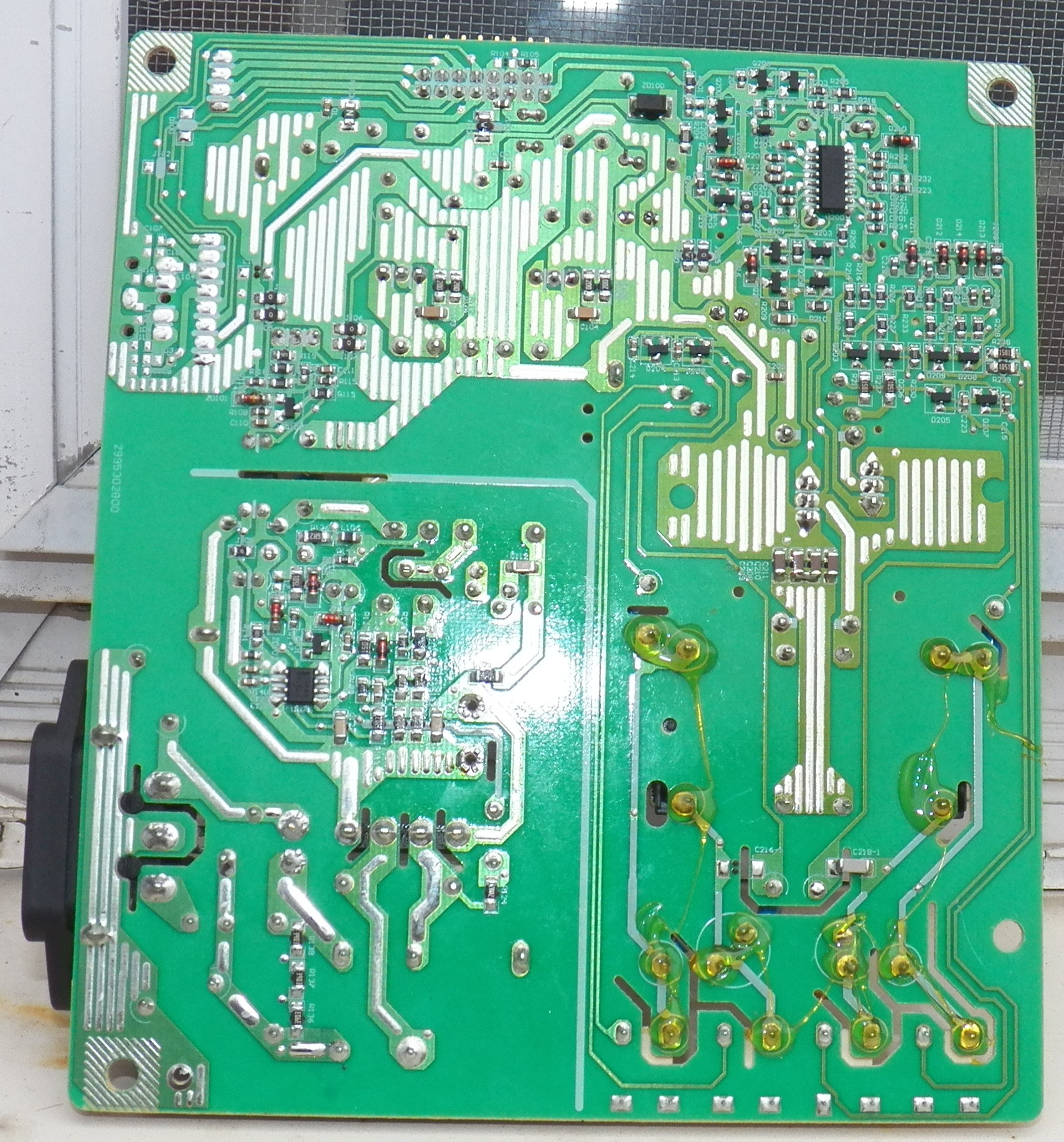

                      I've had a chance to do some measurements:
                      The N fuse reads normal
                      The W fuses all read normal as well.
                      On the transformer it read open on both measuring points as indicated in the edited photo.
                      The 2 MOSFETS near the transformer both read that they were shorted ( not sure if I tested them right though)
                      Last time I tried to get a replacement transformer from Delta, they told me I was out of luck.

                        Can you do a close up pic of the w fuses
                        Mosfet test from retiredcaps 2 seconds to black guide
                        https://www.badcaps.net/forum/showthread.php?t=10419- worth reading
                        start at post 19
                        Mosfets
                        If you have a manual range multimeter, set it to 200 ohms (two hundred). This is for 3 pin ICs only. You can test a mosfet (Q, IC designation) "in circuit" by (power off and unplugged)
                        a) black on pin 1- red on pin 2 - record ohms
                        b) black on pin 1- red on pin 3 - record ohms
                        c) black on pin 2- red on pin 3 - record ohms
                        If any reading is less than 30 ohms you might have shorted mosfet. Remove from circuit and repeat the tests to verify.
                        Some mosfets are more than 3 pins. To test those, identify the part number and search for its datasheet. Once you find the datasheet, the pins will be designated source (S), gate (G), and drain (D). It will probably be documented as S1, S2, G1, G2, D1, D2.
                        Simply test
                        a) black on pin S1- red on pin G1 - record ohms
                        b) black on pin S1- red on pin D1 - record ohms
                        c) black on pin G1- red on pin D1 - record ohms
                        Repeat for the "2" pins. That is S2-G2, S2-D2, G2-D2.
                        Note: a shorted mosfet would likely cause a very brief flash of the backlight or no backlight.
                        Transformer - Unusual for BOTH to be open check that your meter was on 2000 ohms
                        and also that there was no lacquer on the pins like in Budms picture scrape down to bare metal

                              a) black on pin 1- red on pin 2 - record ohms Open
                              (b) black on pin 1- red on pin 3 - record ohms Open
                              (c) black on pin 2- red on pin 3 - record ohms Resistance varied then read open.. 2nd Mosfet read 176 then instantly read open
                              I used my digital MM with a selector switch obtained reading of 751 and 749 OHM respectively
                              I retested the SMD fuses again this morning.. I did find one of the W fuses that read open.
                              Tried taking a close up of the W fuse in question turned out blurry. If I can get a clear closeup I will post a pic.
