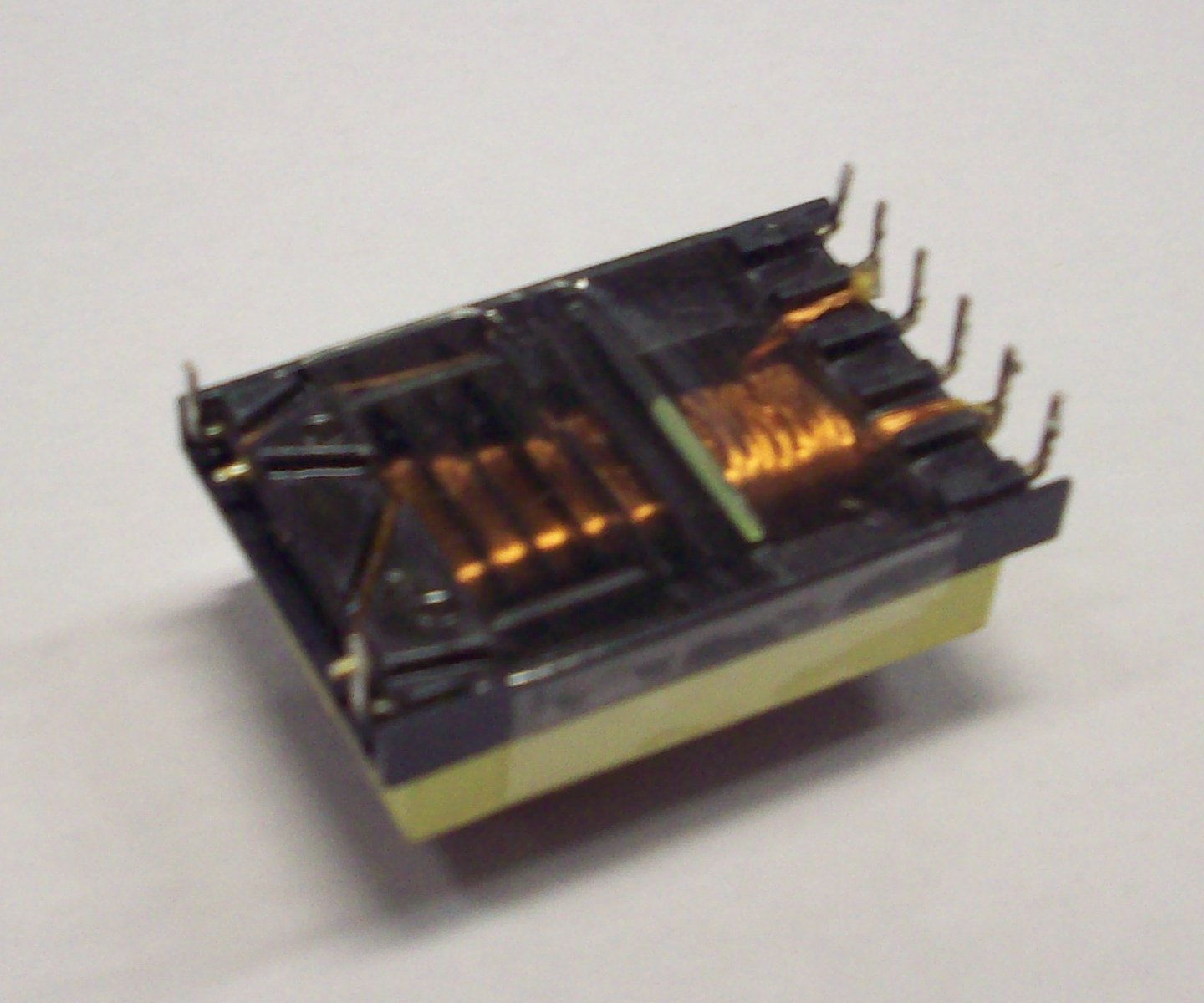

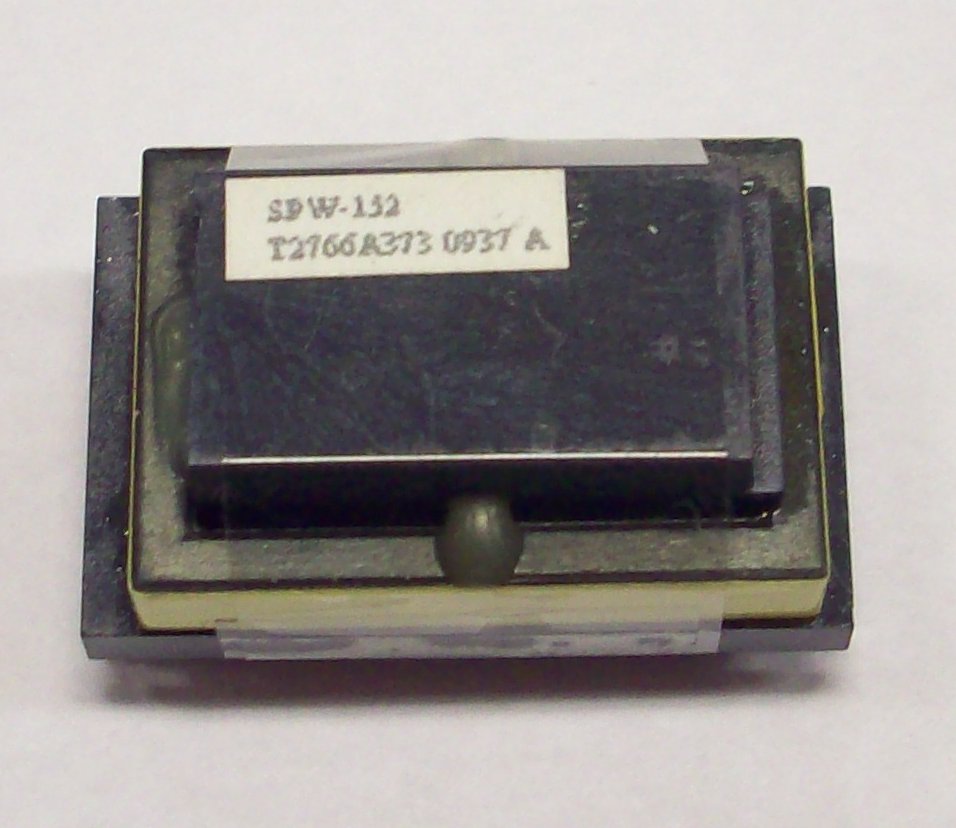

    I am trying to repair a Samsung Syncmaster 2333SW. I need help in identifying a transformer, finding a replacement, and a couple of questions answered and I am hoping some of forum members will point me in the correct direction. I will post a picture of the CCFL transformer and the schematics of a board that is really close in design to what I am repairing. I cannot find a datasheet on the transformer so I do not know how to find an equivalent if there is such a thing. I am open to any suggestions on identifying this one and possible sources or replacements.
    I also have a few capacitor questions that I hope can be easily answered. I apologize if the following questions belong in another thread I am not sure if they will be considered off topic for computer monitor troubleshooting. If these questions are covered elsewhere in this forum I apologize but I could not find them.

      This set has appeared before but possible with different boards and transformers.
      We can help a lot more if you please post good clear pictures of the whole chassis, and then pictures of each board, front and back and close up of connectors, (max resolution 2000x2000 and 2MB) using the manage attachments button, which is found by clicking "go advanced" under quick reply.

        The fault is two seconds to black. The primary windings on both transformers are shorted. They read the same as putting the two multimeter leads together. I have used this forum (reading not posting) to fix other monitors doing this same thing. I realize there is most likely more wrong with it than just this but if I cannot find replacement for the transformers more troubleshooting will be a waste of everyone's time which I want to avoid.
        I posted the best pictures that the camera I have available could take. I am sorry the camera is crappy but it was all that I had to use. I can post pictures of the boards later if it will help but without working transformers I do not see the point.
        I really appreciate the quick responses and I apologize if I did not include enough information in my original post.

          Primary should always read shorted. Secondary should be high ohms from 500 ohms to 5k ohms.
            Re: Please help Identifying this CCFL transformer and answering few questions
            That reading is normal for primary because you are reading DC resistance (will be less than than one Ohm) not Reactive resistance that the drive circuits will see.

              I knew the resistance should be low but it is less than 0.1 ohms. The meter with leads together reads 0.2 ohms and the primary's read 0.2 -0.3 ohms. Since the primary's are driven at ~25V this resistance seemed low to me which made me think they are bad. If this is a normal reading then I will have to go back to square one of my troubleshooting.
                It is driven by 50~70KHz AC switching circuits. At that frequency, the inductive reactance will be very high.

                    In 2+ years of participation, I have never seen a bad primary winding on the inverter transformer. 100% of the time it is the secondary winding that is bad.
                    I suggest you start testing your ccfl lamps as per my guide.
