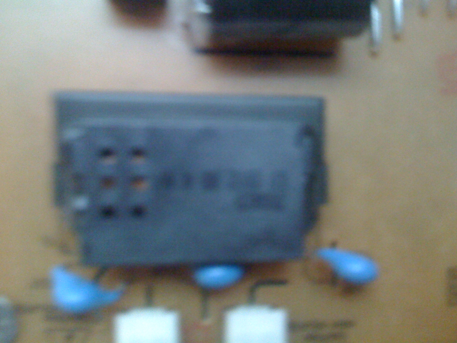

    My monitor will work for about 10 minutes, then flicker and the backlight will go out. Sometimes, this particular component will make a very high pitched buzzing sound. I'm not really familiar with these kinds of things. What is this, exactly? Sorry for the atrocious image quality.

    can ya get a clearer pic? has copper coil wrap?
    • jetadm123
      • 2169
      Re: HansG HH251 - What's this thing?
      It appears to be a inverter transformer. And yes, a clearer photo would help. Also, please provide overhead photos, top and bottom, of the entire power board.

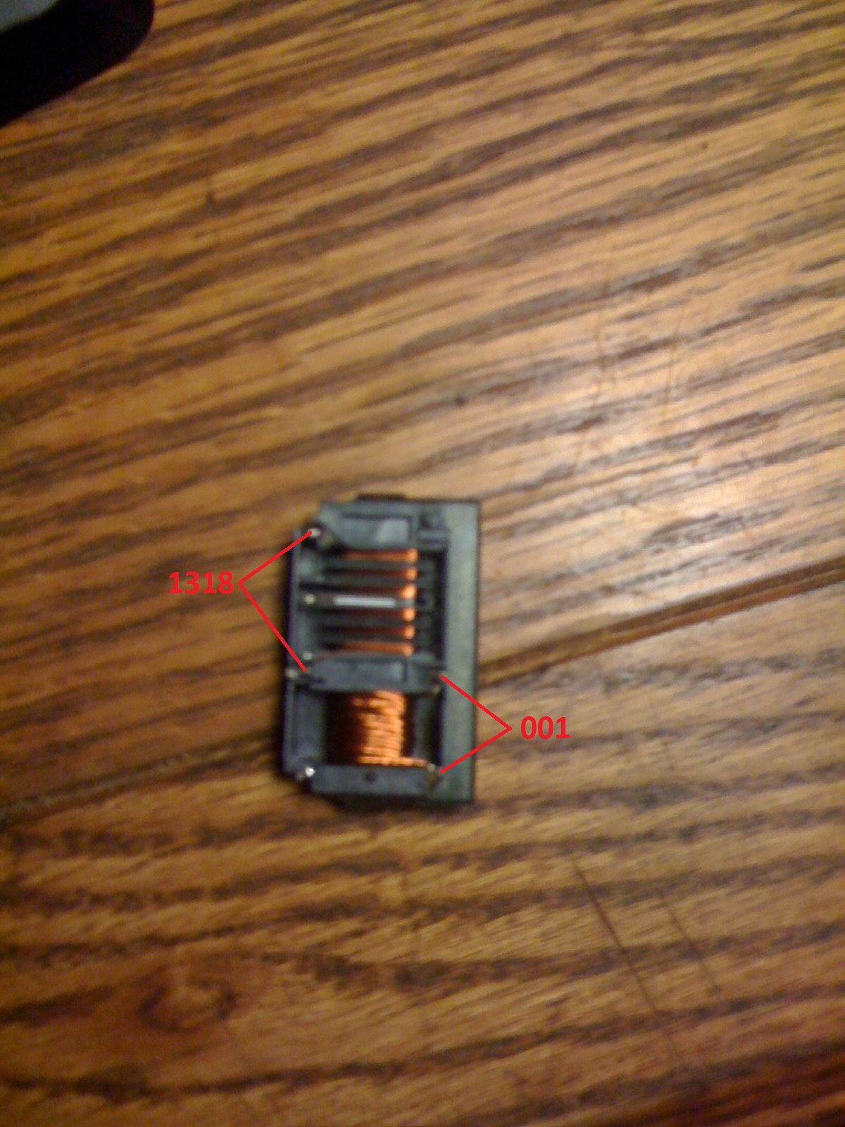

          Sorry for being so short in my first post, but I was in a rush to get it on here before I had to leave for work.
          The only thing I've got to take pictures with is my phone, but I've taken a few more. Hopefully they help. Third picture shows the power board with the bad part in the upper left corner. Fourth is the back side, with the inverter transformer removed, and the solder points in the upper right.
          Also, there are two lines of numbers printed on the inverter transformer:
          784403
          61 0912 80 4 H
          Is this something I can pick up at the local electronics store?

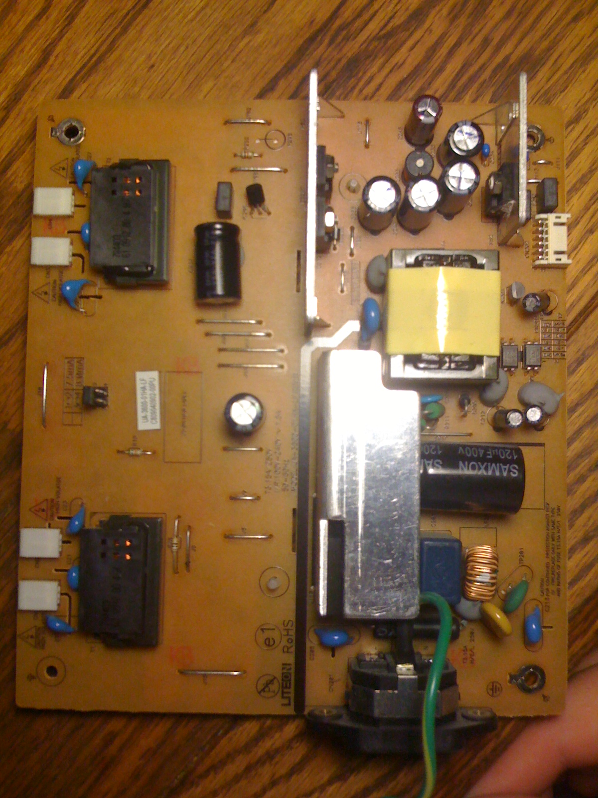

                  If I let the monitor sit unplugged for a while, it's good for another 10-15 minutes.
                  These are not a usual signs of a faulty transformer, it would not normally come on -sounds more like faulty ccfl or the wiring.
                  It could also be a cold solder joint or a bad cap - one in the top right
                  in your picture has an odd shading - one segment of the top of it is reflecting the light ( but it may just be the picture)
                  May as well do the resistance checks on the transformers as it is easy

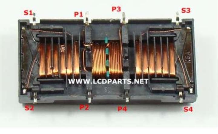

                  Looks like its a standard layout so the secondaries are likely to be S1>S2
                  and S3>S4 in the attached.
                    I believe you're just seeing a blue marker mark that's on the top of all the caps on this board. As far as I can tell with my limited knowledge and experience, the caps LOOK fine, in that I see none that are obviously bloated.

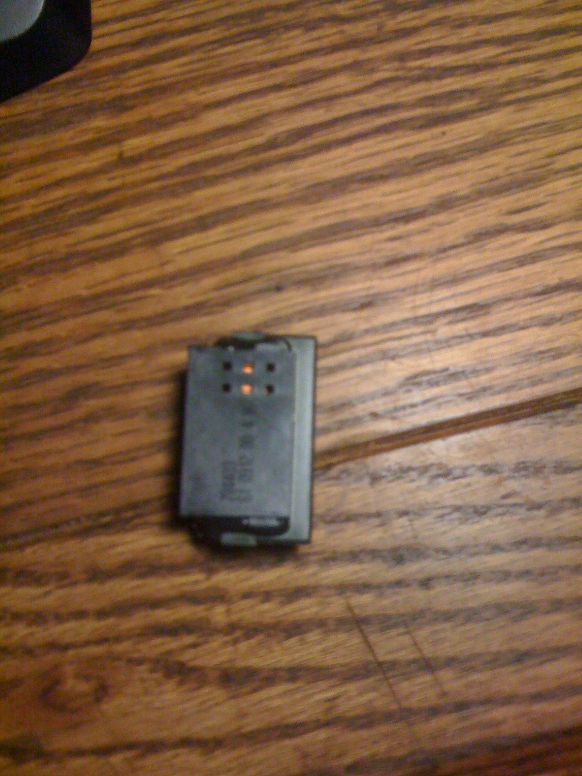

                              Do I need to remove it to test it, or can it be done while in the board? I had already pulled the other before starting this thread, thinking I'd be replacing it.
                              I did put the first transformer back in and swap the wires around, as suggested, and the display stays on! For nearly a half hour, now, anyway. The display is quite dim, though, and the brightness will not adjust.
