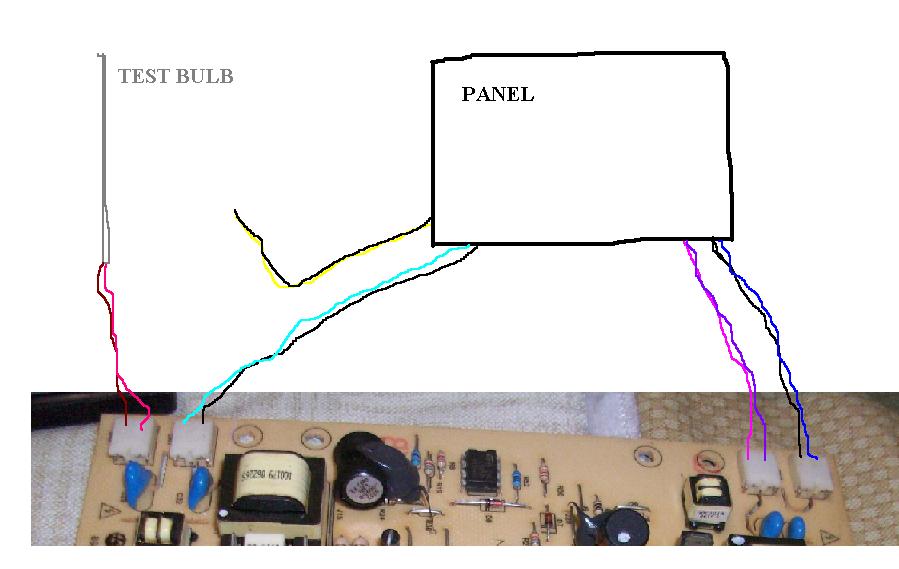

                    This is the test you should do
                    You have a LCD with 4 CCFLs (numbered 1 to 4) and a spare.
                    Pay ATTENTION as there is a VERY HIGH VOLTAGE (600V to 1000V)! As a safety precaution, it might help to have someone around when you are doing this if something screws up.
                    a) TURN POWER OFF and unplug the monitor and wait 1 minute
                    b) disconnect CCFL #1 and plug in spare CCFL into spot #1
                    c) plug in monitor and turn monitor on - note if "2 seconds to black" occurs
                    d) TURN POWER OFF and unplug the monitor and wait 1 minute
                    e) reconnect CCFL #1 and disconnect CCFL #2 and plug in spare CCFL into spot #2
                    f) plug in monitor and turn monitor on - note if "2 seconds to black" occurs
                    g) TURN POWER OFF and unplug the monitor and wait 1 minute
                    h) reconnect CCFL #2 and disconnect CCFL #3 and plug in spare CCFL into spot #3
                    i) plug in monitor and turn monitor on - note if "2 seconds to black" occurs
                    j) TURN POWER OFF and unplug the monitor and wait 1 minute
                    k) reconnect CCFL #3 and disconnect CCFL #4 and plug in spare CCFL into spot #4
                    l) plug in monitor and turn monitor on - note if "2 seconds to black" occurs
                    If you have a bad CCFL, one of the tests above should show you which one. If you still have "2 seconds to black", then we can assume it is not due to a bad CCFL.

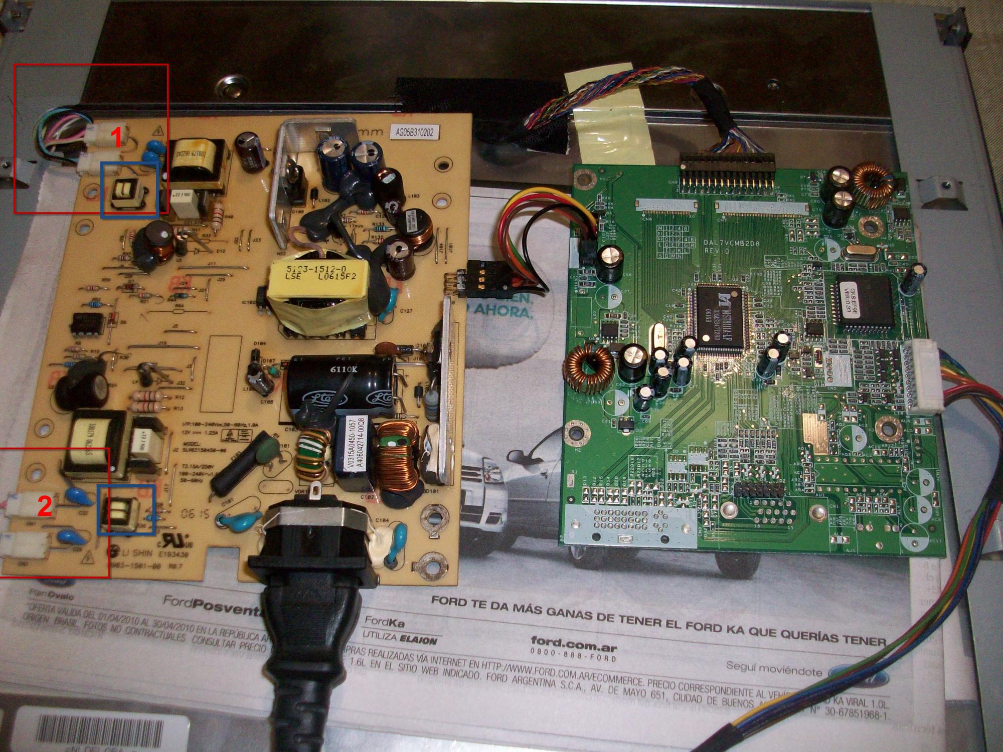

                        If I connect the lamp in 1 (see pic) the lamp won't turn on (but I can year the "tick" noise). Now, if I connect the lamp in 2 (see pic) the lamp blink 2 times and after 5 secs repeats the sequence.
                        The "tick" sound seems to come out from the trfrms marked with blue square (see pic).
                        What reading must be ok on those small transformers?

                            Ok -I dont think you understand the test - and I cant say it in Spanish.
                            I will stay online and take you through it
                            To do the test you HAVE to have 4 lamps connected.
                            First -Connect up all 4 that are in the panel.
                            Unplug 1 and instead plug in (connect) the test bulb
                            Advise what happens.

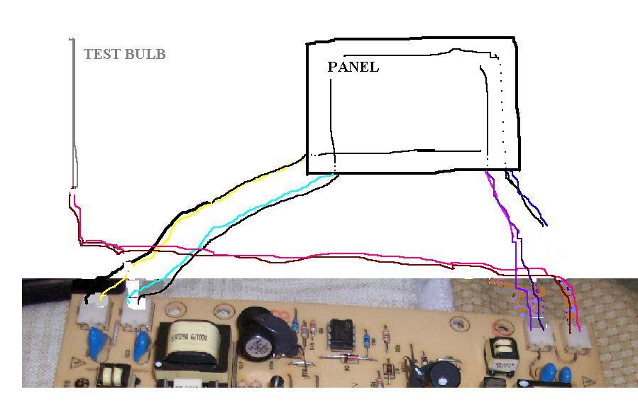

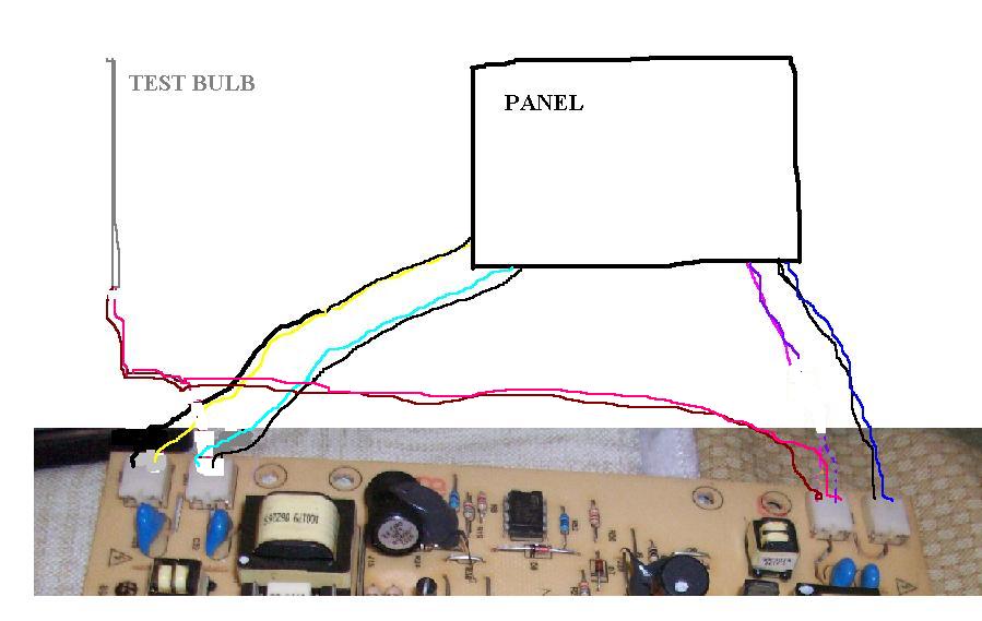

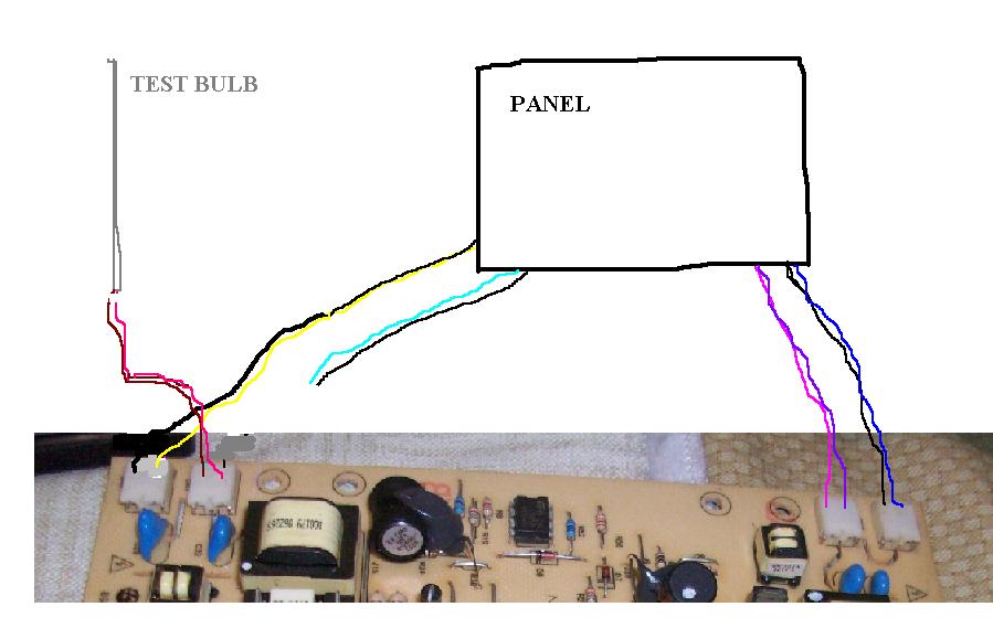

                                      Re: Viewsonic VE710b Power on black screen
                                      I am still not convinced.
                                      See pictures attached - have you done these 4 tests and you get the same result each time.
