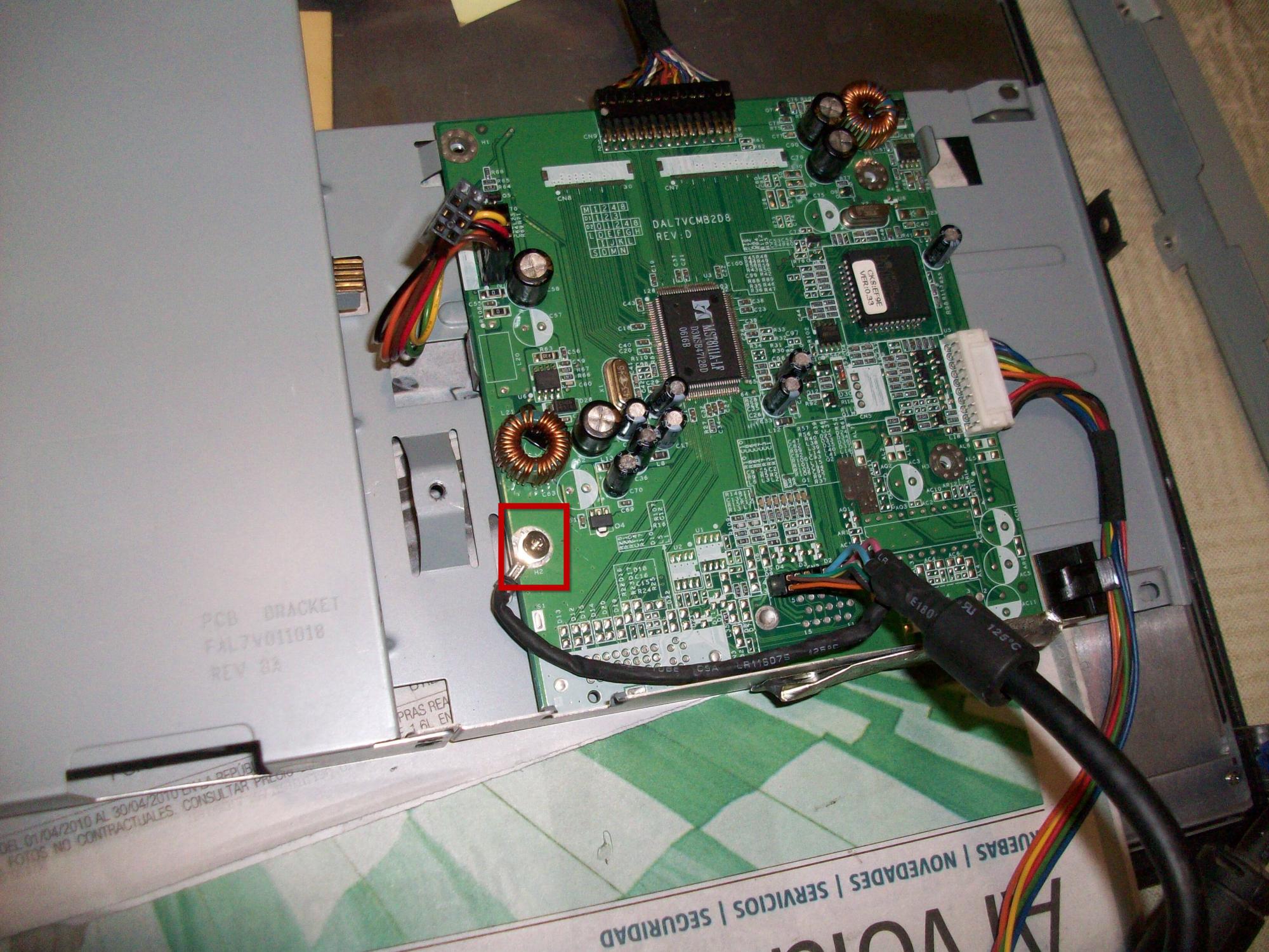

    The vga cable have a ground connector to a screw of the mainboard (not connected right now). Could be this important?

      When we are doing remote troubleshooting, I have no idea what you are looking at. Thus, clear focused pictures are always a good idea.

        I'm taking about the connector from the mainboard that ends in a DB9 blue connector (VGA). The connector has a ground cable. More pics.

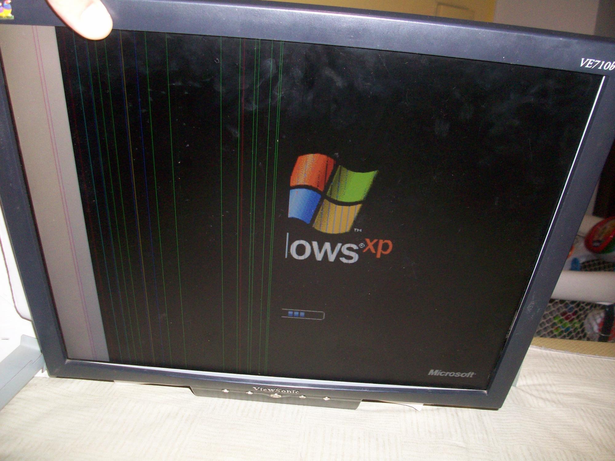

          I put back all the connectors and everything looks worse now including the right side of the screen...

              I think inverter is working ok with the replacing of the two c5707 (with the source connected now the image appears). The half screen image may be caused by a faulty t-con (mainboard) or a faulty screen (COF). I'm right?

                    I replaced 2 of the 4 c5706 transistors. Now backlights are working but i've half screen. So, I must to try something new, or the lcd must be damaged, maybe when the power board failed it damage the lcd cof (chip-on-film)? I must stop trying to fix this, and the solution is to replace the entire lcd screen?

                        Ok, but i'm still wonder if half screen behavior can be due to inverter problem...

                          The two resistances near the c5707s are shorted also...so I think I must to change everything to leave the power board ok, but I'm concerned about the half screen image...

                                      The resisitors you mention are probably not short, resistors of this type do not go short, and no doubt, you are reading them in circuit, which is causing the anomaly.The fault now that you finally changed the transistors, is more than likely to be the LCD panel itself.
